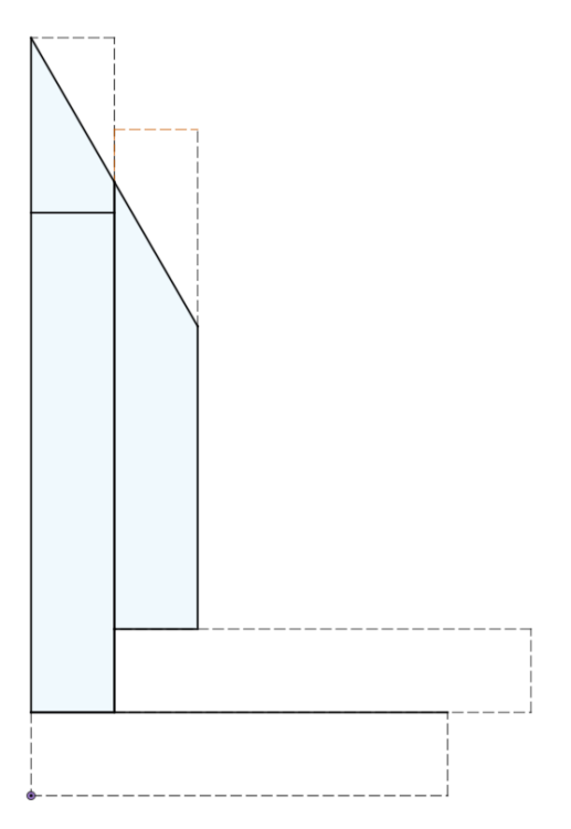

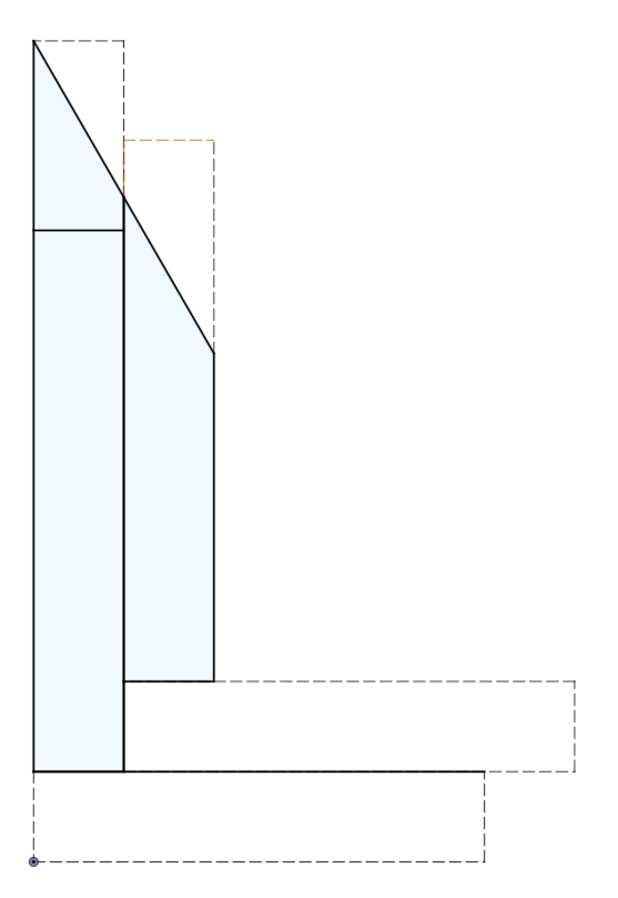

I have a bunch (~72m) of Ravatherm XPS blocks 100mm x 600mm x 1,250mm I need to make some cuts reasonably accurately at 30 degree angles. Something like below, if you're looking from the ends of the boards.
Anyone have a great method? The cut surface on the slope is 200mm long.
Can you make one cut and flip the cut-off over to be the second piece?

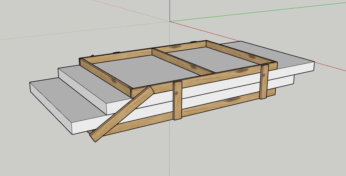

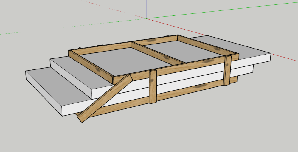

build a sled if you have loads to do? a sled and a hardpoint saw is what i used.

Intend to build a jig somewhat like @Super_Paulie 's.

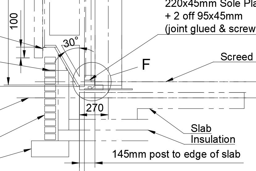

What's it for?

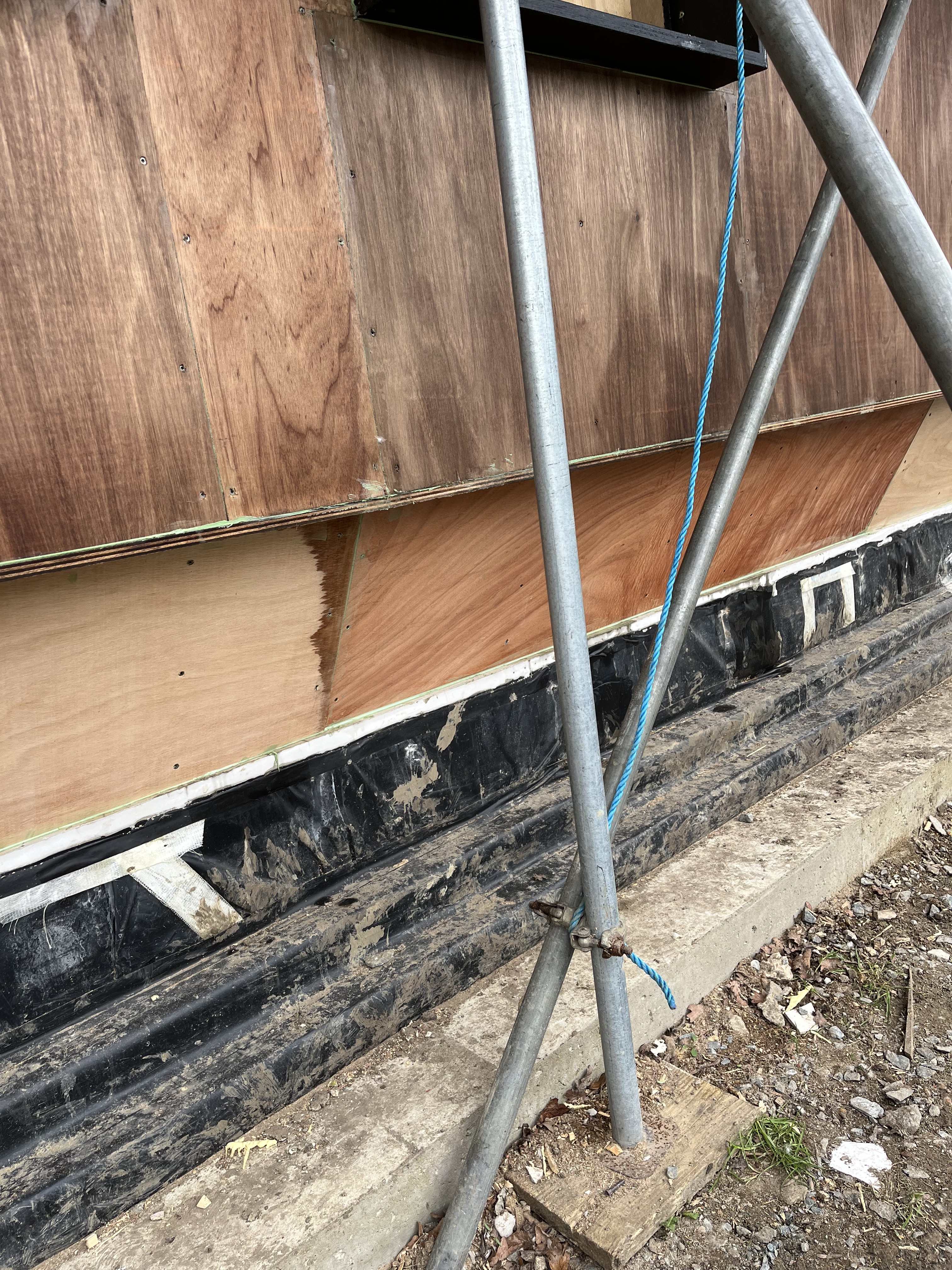

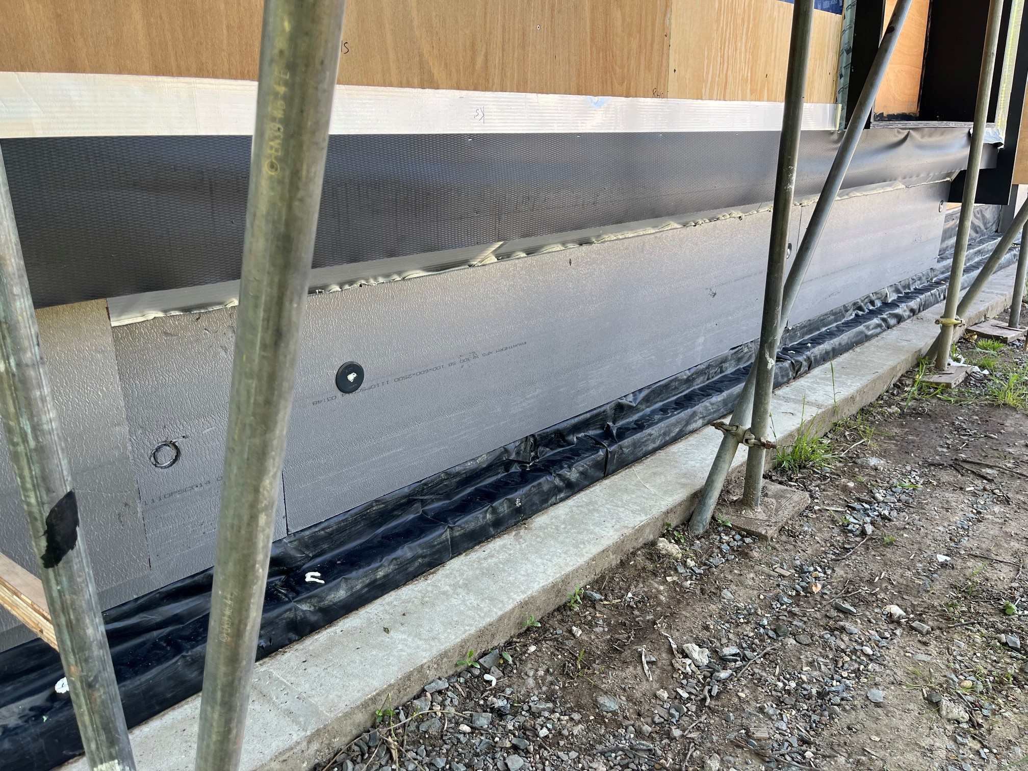

The way I read the diagram it’s to reduce the cold bridging at the sole plate.
Otherwise cold air gets behind the plinth bricks.
I assume there will be wall ties linking the walls and the plinth bricks.  Not sure how that will work with polystyrene sheets.
Good point about wall ties. I had thought about those, then forgotten about them…

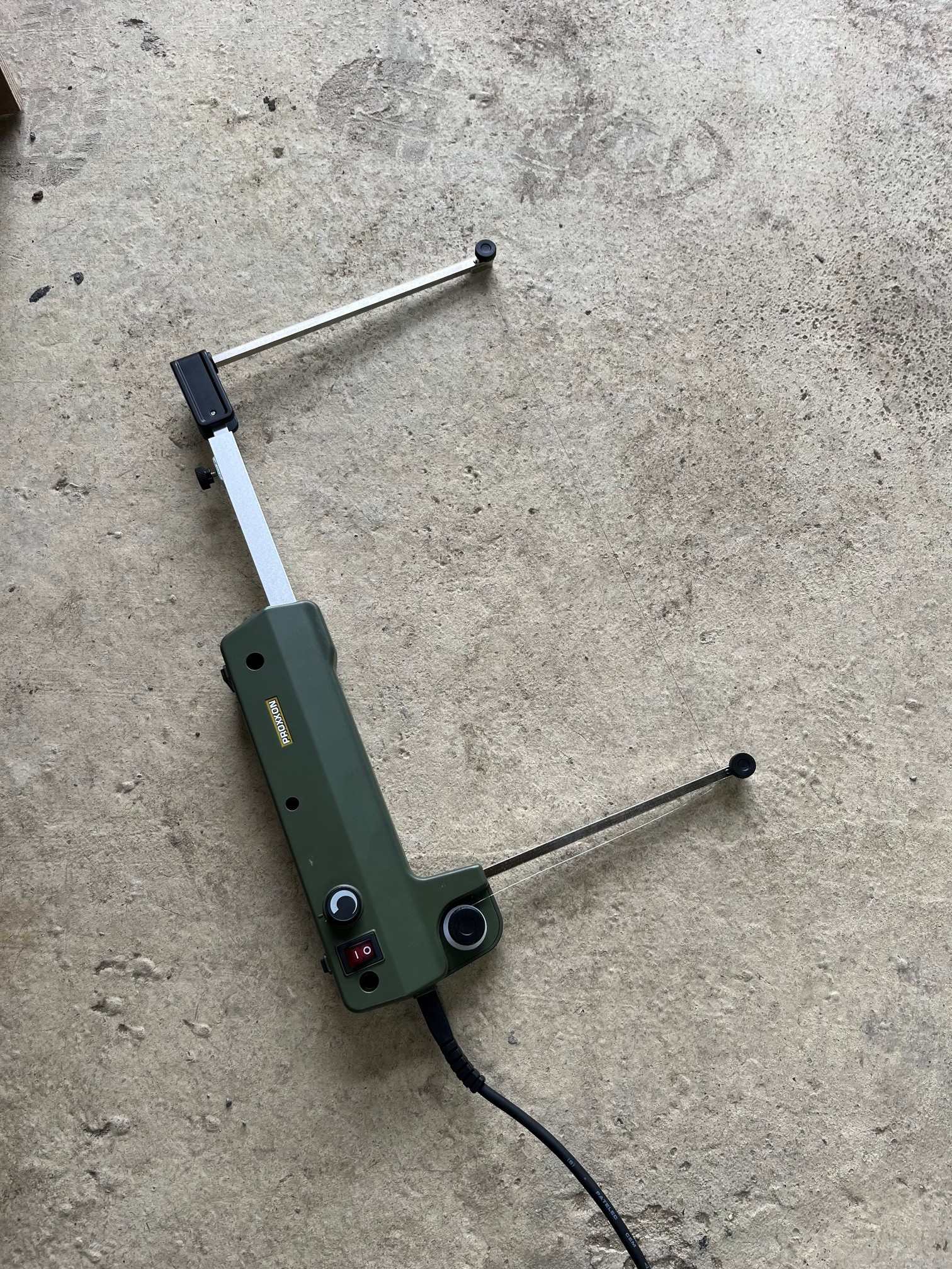

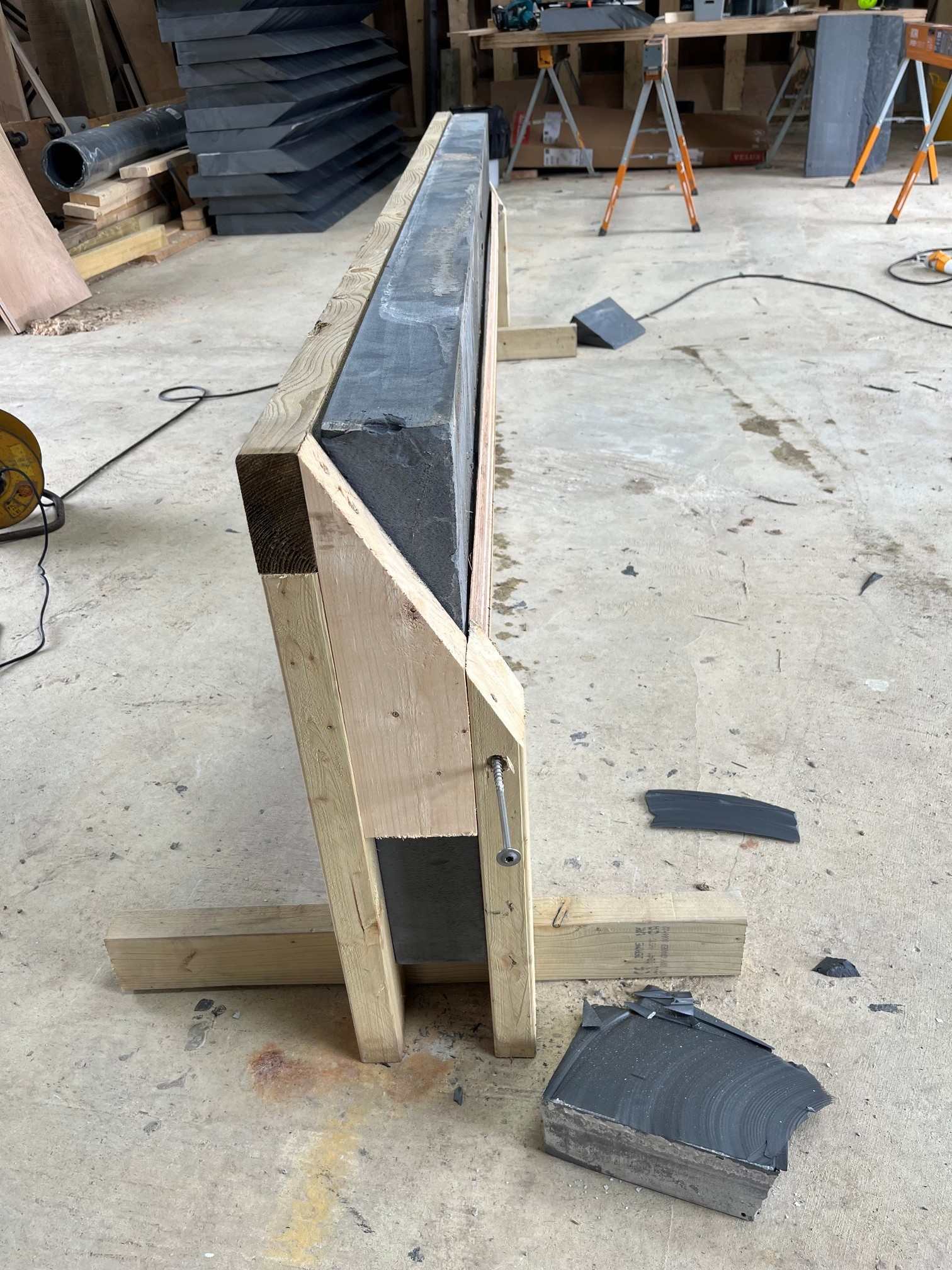

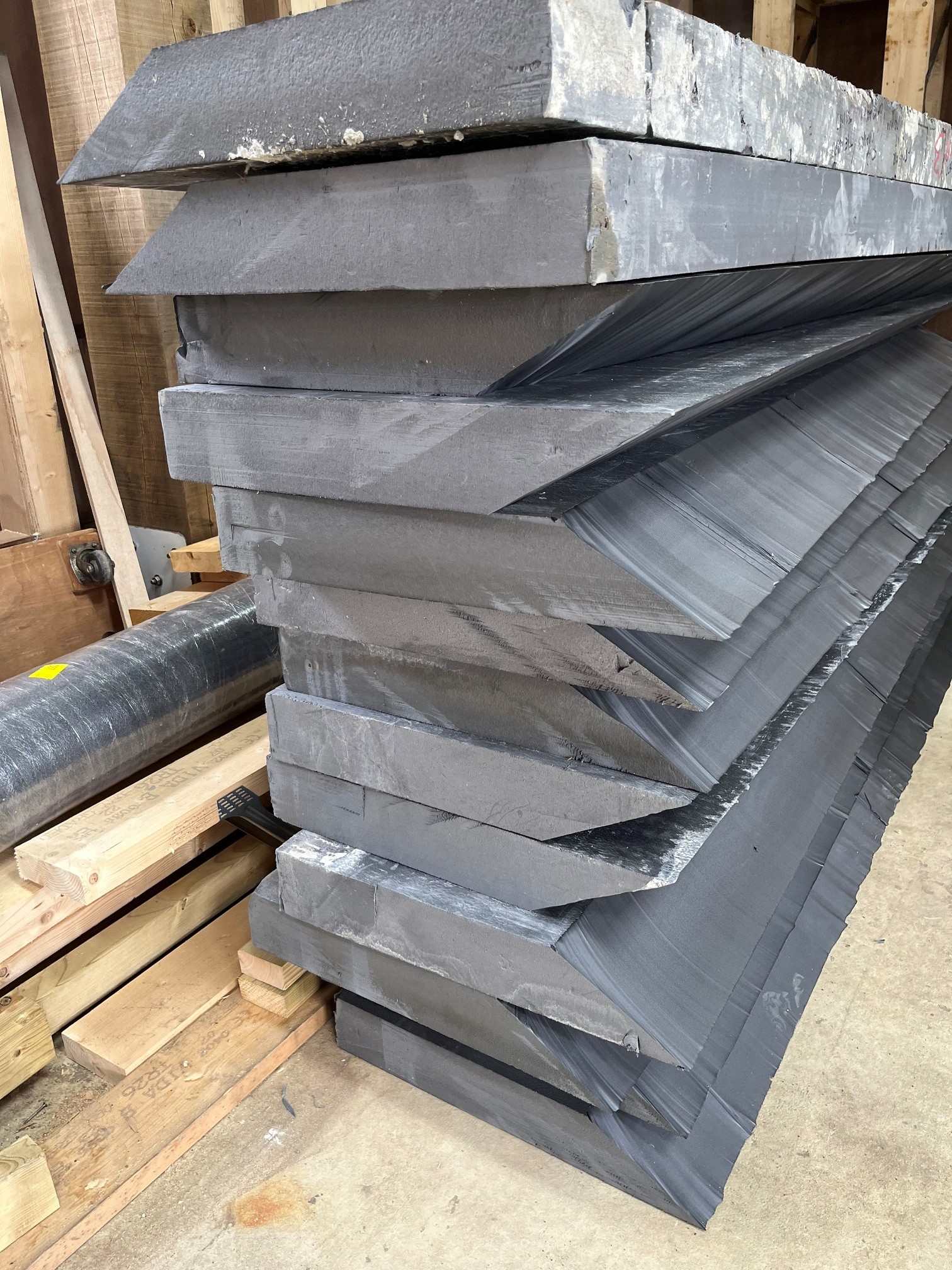

OK reporting back: after trying out lots of options, we cut the angle with a Proxxon Thermocut 650 and a home made jig. It lacks a bit of oomph and was fairly slow, but the flipside was that it didn't burn or smell much. We made the straight-through cuts with a big-assed circ saw - not crazily messy. You can get bigger hotwire cutters than the Proxxon and specifically for insulation, but we wanted to specifically cut 200mm deep.
p.s. the wire is very thin and breaks quite easily. Although it comes with 30m of wire on a little spool, you might want some extra.
Edited by Alan Ambrose
8 hours ago, Alan Ambrose said:
was fairly slow
How slow? Any accurate method is slow, especially when done twice,  and your cuts look very tidy.
