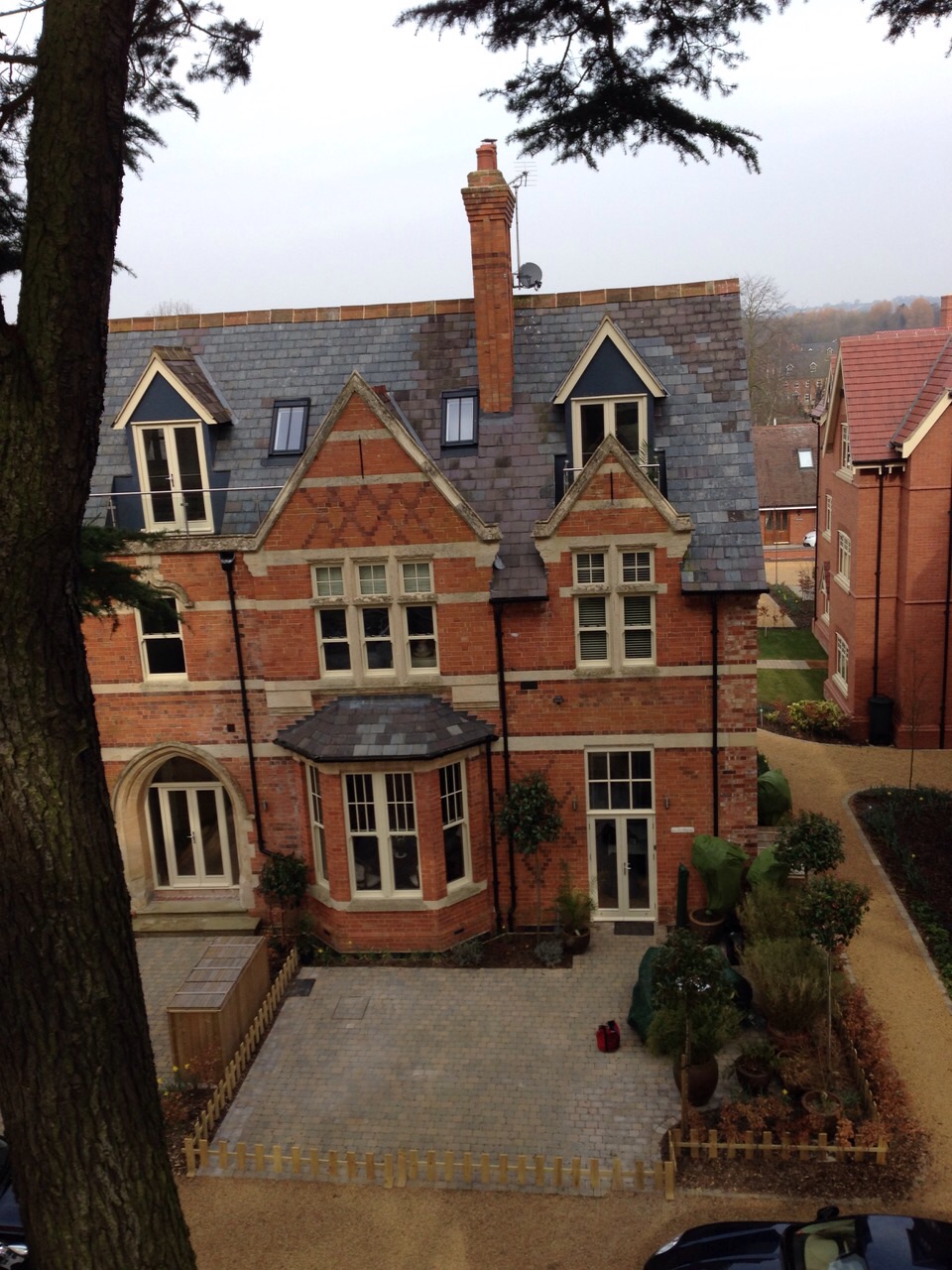

SteRob Posted January 29, 2018 Share Posted January 29, 2018 Hi, wonder if anyone can point me in the right direction. We have bought an old property and have been getting quotes on windows. I have attached a picture of the window sizes and house elevation with an example of the chosen design. The property has 15 windows, two bays, Front entrance, rear door, and French doors to garden. We have a open mind as to what to go for and have looked at and had quotes on wood flush casement windows, double glazed Engineered redwood (most expensive (£45,000) , Aluminium heritage style (£39,000), and I have recently come across Rationel Forma Plus. We like the Rationel but the quote for Rationel Forma plus in double glazed units , came in at £23,828 but the company in question had a total fitted price including cills of £33,173, which to me seems an awful lot for fitting. I am going to look for other Rationel suppliers and try them, but would anyone know if this price is usual ? From some of the other older forums the price seems a bit expensive for what we are looking for. Any help would be greatly appreciated. Windows 1.pdf Link to comment Share on other sites More sharing options...
le-cerveau Posted January 29, 2018 Share Posted January 29, 2018 Why only double glazing, are you not looking at triple? Fitting is the key, otherwise you are wasting money as all the heat you save with good windows runs through the edge and you get condensation issues. However my windows were almost twice this cost and I had more windows and doors and they were fitted for less so I suspect something is not quite right here as mine also included airtightness taping. On your windows with modern units (not standard British designs) you could get nice tilt and turn windows without all the bars (cold spots) for example you could have a single pane of glass for each face of the bay windows, same goes for a lot of the other windows, single pane or just one mullion on the 2m wide ones. Don't be limited by standard British windows, look at other options. 1 Link to comment Share on other sites More sharing options...

SteRob Posted January 29, 2018 Share Posted January 29, 2018 7 hours ago, le-cerveau said: Why only double glazing, are you not looking at triple? Fitting is the key, otherwise you are wasting money as all the heat you save with good windows runs through the edge and you get condensation issues. However my windows were almost twice this cost and I had more windows and doors and they were fitted for less so I suspect something is not quite right here as mine also included airtightness taping. On your windows with modern units (not standard British designs) you could get nice tilt and turn windows without all the bars (cold spots) for example you could have a single pane of glass for each face of the bay windows, same goes for a lot of the other windows, single pane or just one mullion on the 2m wide ones. Don't be limited by standard British windows, look at other options. Thanks for the advice, I think from what I have been told so far that Double glazing would be sufficient. We aren't exposed and it is an old property and many of the advantages of triple glazing would probably be lost from other areas of the house. As for the design, the house is circa 1920/30 and sits in between lots of Victorian villas, and to be honest the single pane look isn't one I particularly like (just my preference). I have emailed another two Rationel suppliers today for quotes and will see what they come back with. Thanks again Link to comment Share on other sites More sharing options...
