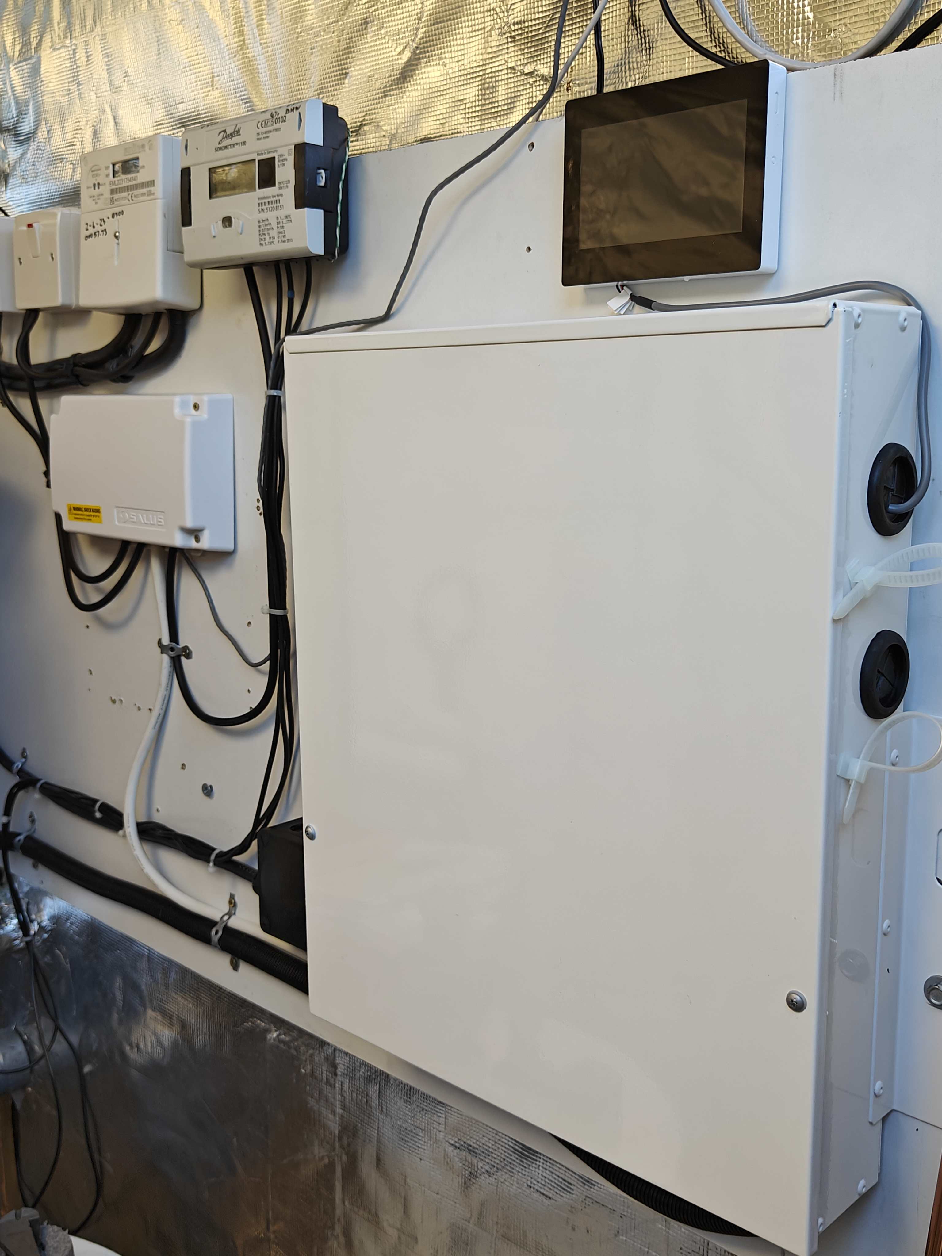

So wiring is complete. Have retained the smart grid switching to allow flow temp boost if I need it for the summer house, have retained the open source monitor system (energy and performance monitoring). So wiring actually done by me, power cable, SG switching 2 core cable, which then connects to inside house via existing trenched SWA cable (already in place for existing HP), this connects to UFH controller, so I have remote (hardwired) manual temp over-ride for summer house temperature.
Once outdoor unit in place it's just power cables and shielded comms cable. A some basic pipe work mods.
Image below left to right, isolation switch wiring center and performing), electric meter for heat pump, heat meter for heat pump, Hiaer controller, below that, simple wiring center, then the main control/wiring center for Hiaer heat pump.

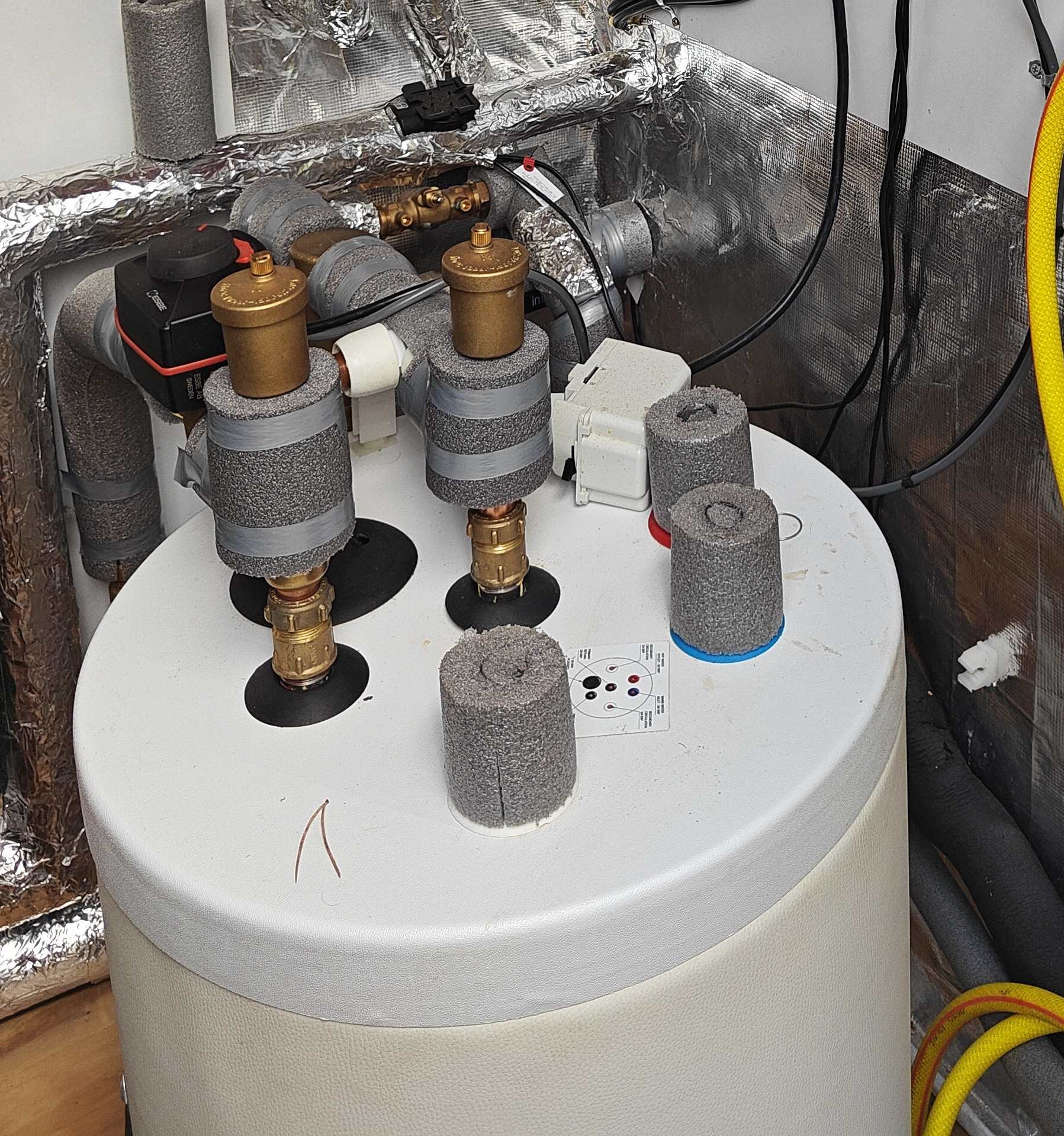

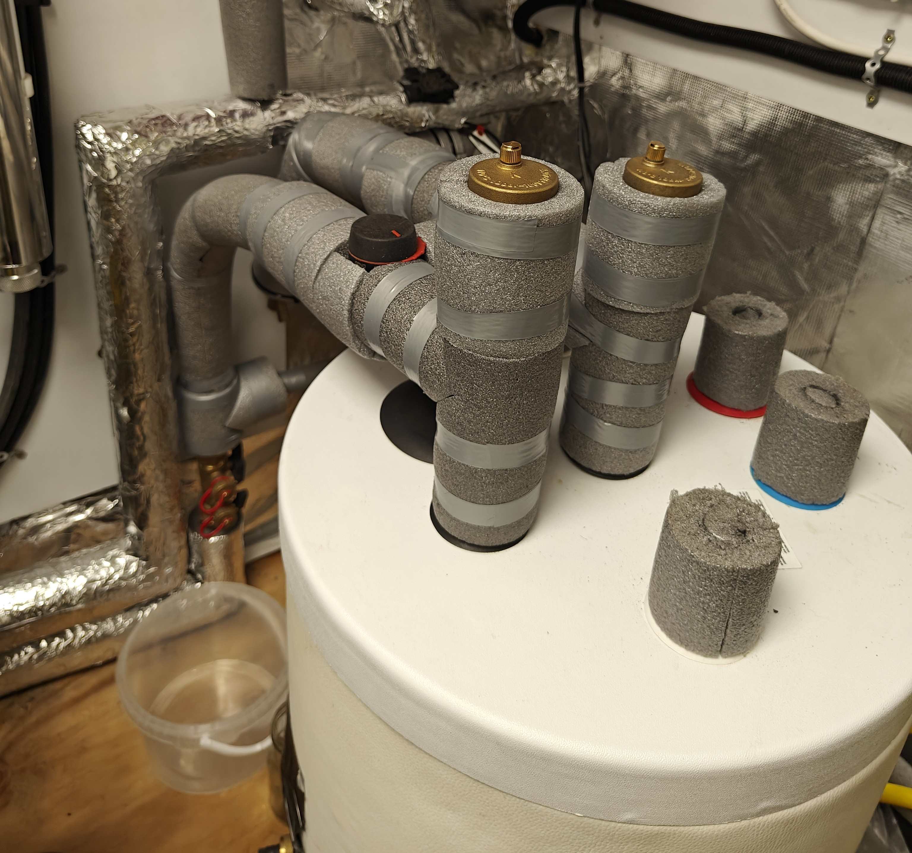

So will be keeping the volumiser, it's in the return line, but after the diverter valve due to because retrofit. So it also had an ESBE diverter, which allowed the volumiser to be bypassed during the production. That bypass isn't needed, so actuator removed and all the insulation tidied up.
Before
After
Not perfect but much better than it was.
Still a filling/flushing valve to sort out, but in the difficult basket

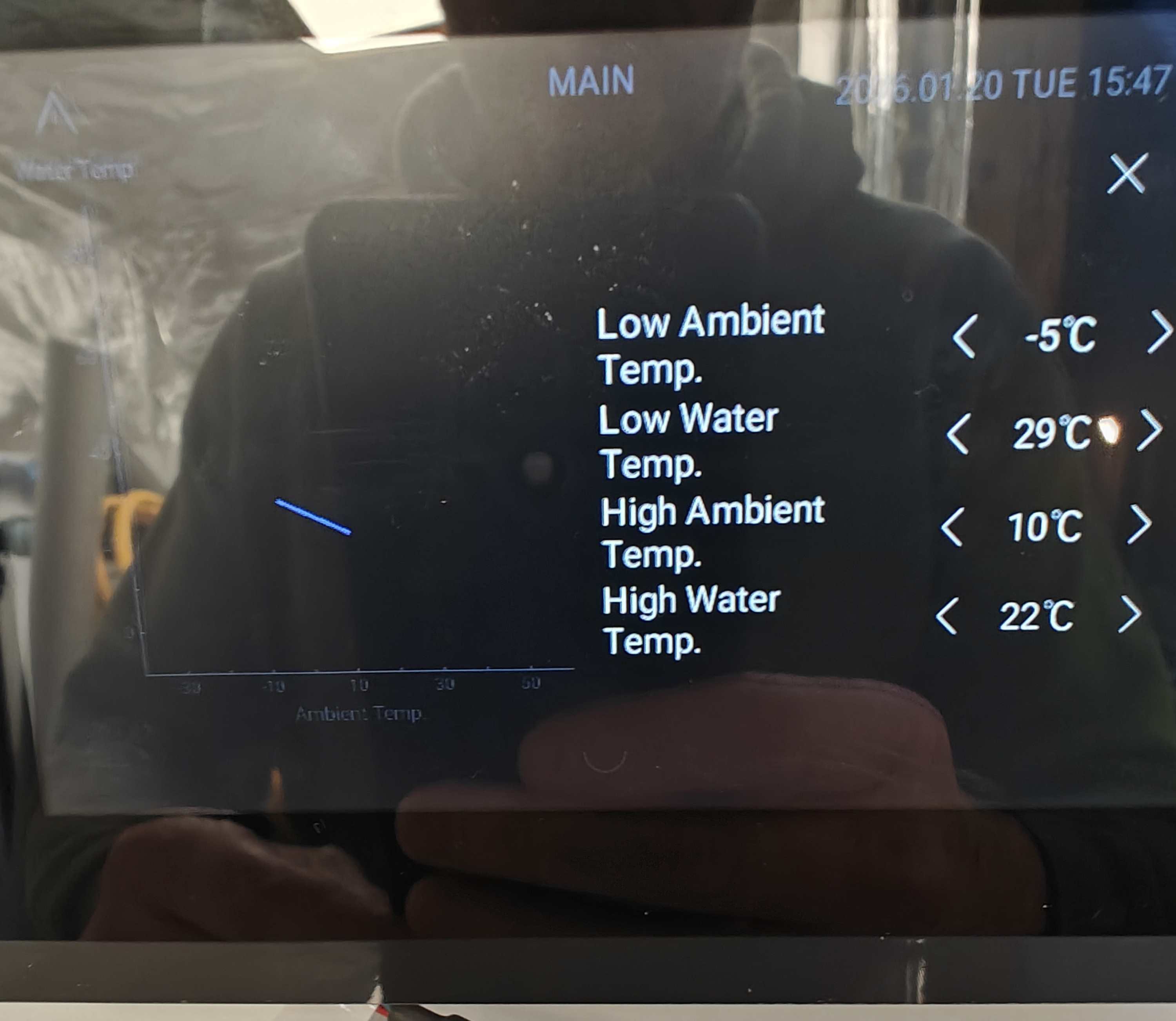

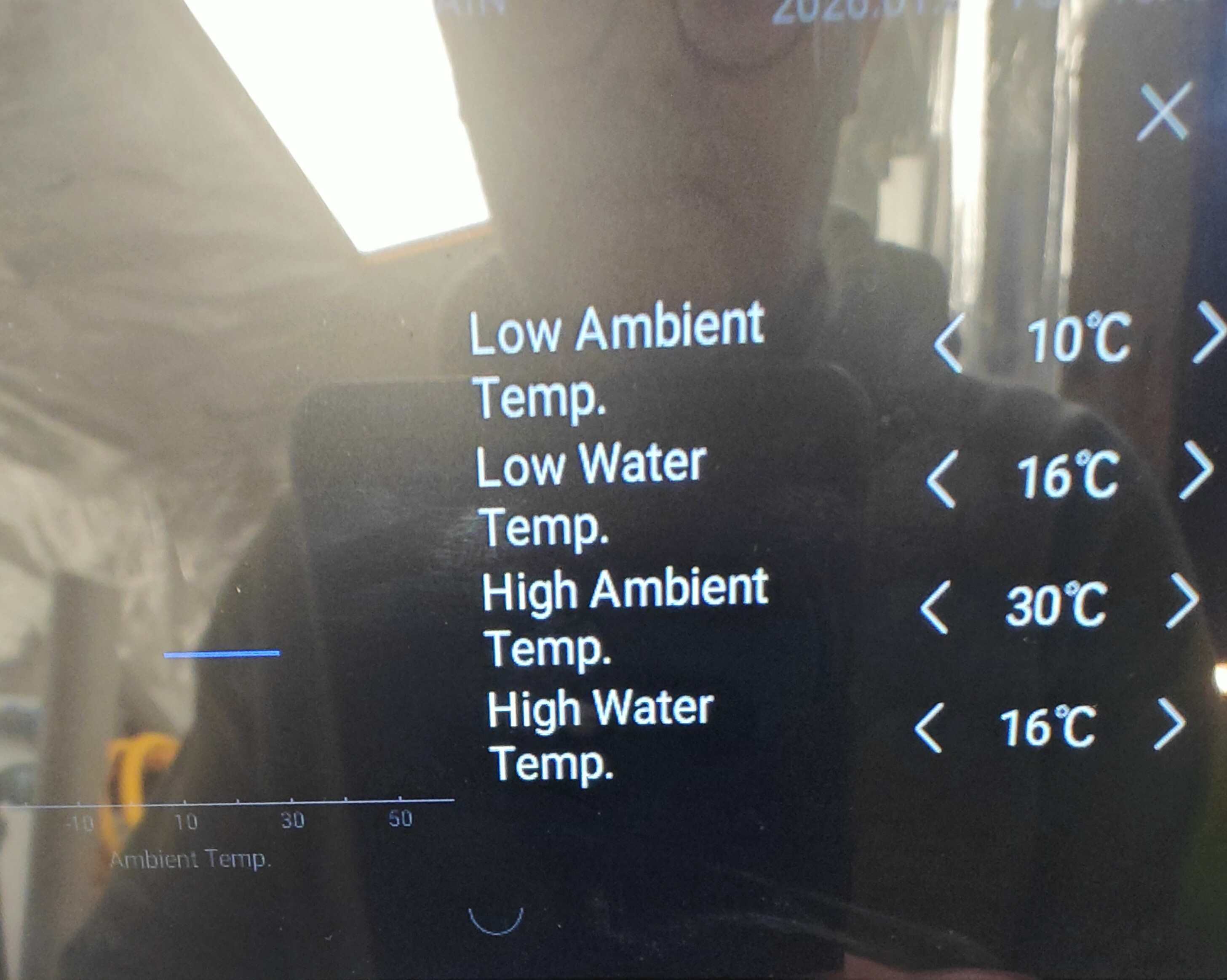

Been scratching my head how to set WC curves, one for heating the other for cooling, however I found because the unit was set to auto (auto switching between heat and cool) the menu wasn't visible. However switch to heat or cool and WC menu pop up. Very easy to set, so set a flat curve for cooling 16 deg (well above dew point) flow temp and heating the more normal curve.
IMG20260120154728.thumb.jpg.d47f617eb6c4f9e7089721c06b30e835.jpgIMG20260120154712.thumb.jpg.d7f6f7530e6da10b3c5f950a3ad3477e.jpg
Will most likely need some adjustment once up and running.

I decided to change this wiring and use zone 1 and zone 2 control via 3rd party thermostat control. This gives a few advantages
Heat and cooling is switched manually, so use a simple light switch to trigger seasonal changes, it's connected to ASHP and UFH controller, so both are always in exactly the same mode - this is hardwired.
Hydraulically the system runs fully open, zones is purely for different running points and flow temps.
Zone 1 terminals are fitted with a jumper wire, so always on pure WC, so runs in heat or cool depending on seasonal switch position.
Zone 2, is a wireless switch controlled by UFH controller, in winter it allows me to boost summer house temp (only if needed via manual setpoint change on UFH controller), increased flow temp being buffered in to house slab (been doing this for the past year, works well). In summer it allows two set points for cooling, 19 degs flow background via zone 1 temp, if house goes above 23, it moves the flow temp to 17 via zone 2 setpoint. It also includes control set point for humidity, so if house goes above 60% it removes boost function via zone 2 (this will require tuning).
A further advantage is zone two has its own WC curves for heating and cooling. Certainly for heating it allows me to fine tune the boost temp uplift required at different outside temps, for summer house which runs a fan coils and not UFH.

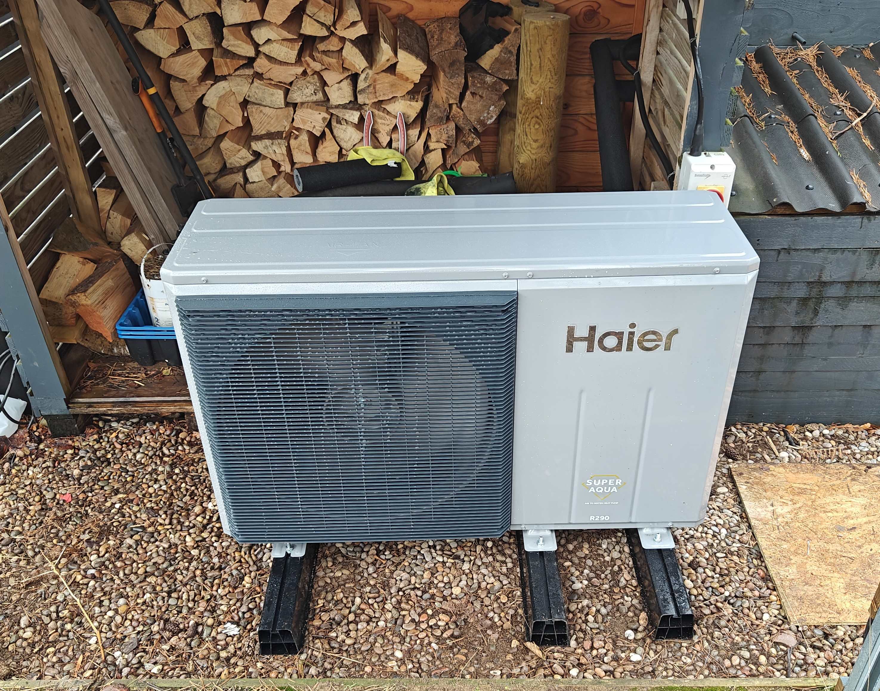

That's the heat pump up and running 4.5 hours from switch off to switch on. Been running for a couple of hours. It seems to testing how the heating system responds. It's keeping return temp, rock steady stable but adding and reducing load, first hour slowly ramped down to 1700W output, then ramped up to 3000W. Now its got a cycle time between peaks of around 30 mins. Pump flow rate is also slowly being decreased at about 8L/mine it was at 20L/min when it first started.
Before and after, Haier unit quite a bit bigger and heavier.

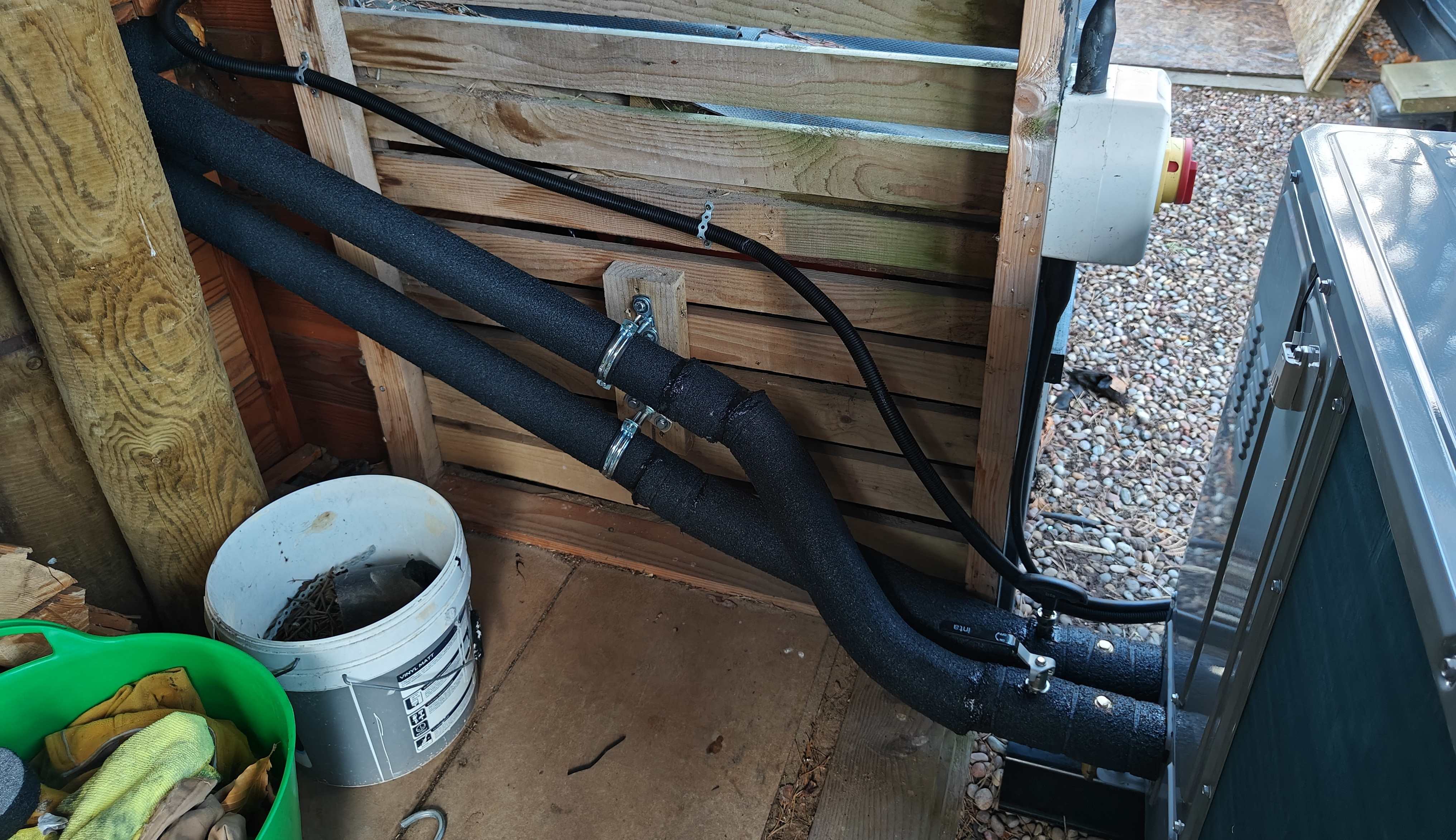

Photo showing rear of unit and piping, lagged with primary pro insulation. 2 x antifreeze valves (warranty requirement) and 2x isolation valves, then flex hoses and then 28mm pipe.

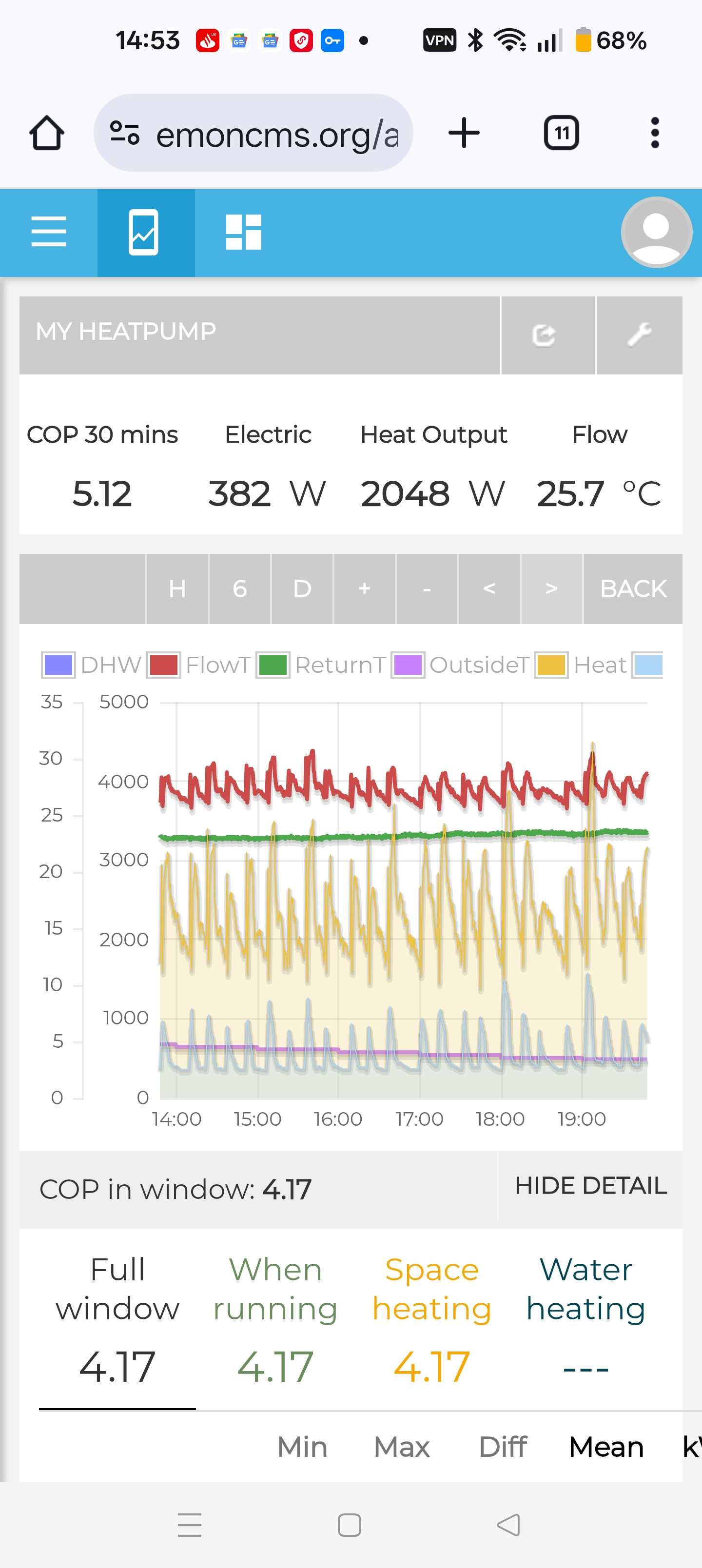

I have now been running for a couple of days, and have now got it running in a stable manner.
Out the box settings are fixed speed pump and 100% speed setting. There is also a selection to be dT controlled and variable speed circulation pump. If you set to dT control the default being dT of 5 degs.
Initial run was on a setting dT of 4 and variable speed. Problem I found was floor return temp was a very stable 23 degs and I had a target of 26 flow temp. So the controller was trying to get return temp to drop while maintaining a target flow of 26.
Screenshot_2026-01-26-14-53-32-76_40deb401b9ffe8e1df2f1cc5ba480b12.thumb.jpg.ba0c239ecd2e13f3d65362903aa0a51c.jpg
A bit of a mess, plenty of overshoot, then undershoot outside was between 5 and 3 in the 4 hours window, CoP 4.17, ok but not great. Tried fixed pump speed similar results.
This morning house was warmer than I wanted, so lowered WC curve and set to dT control and lowered dT setting to 3.
Screenshot_2026-01-26-14-37-56-29_40deb401b9ffe8e1df2f1cc5ba480b12.thumb.jpg.0c51ab356f28f5aa979d63bbb829de03.jpg
Last 6 hours of running - 3 hours spent bring floor temp down a degree, think the spike maybe the energy integral adding energy to floor to catch up. When you zoom in, it's very controlled and deliberate. Then 3 hours running steady state and a CoP 4.96 over the 6 hours. Actually outside temp over the 6 hrs was between 2 and 4 degs.
Defrosts, seems very resistant to freezing, only one defrost cycle so far. Took 4 mins and used 0.27kWh of thermal energy.

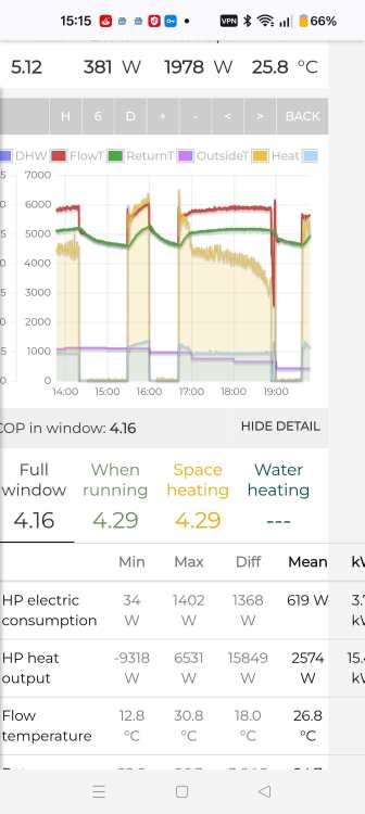

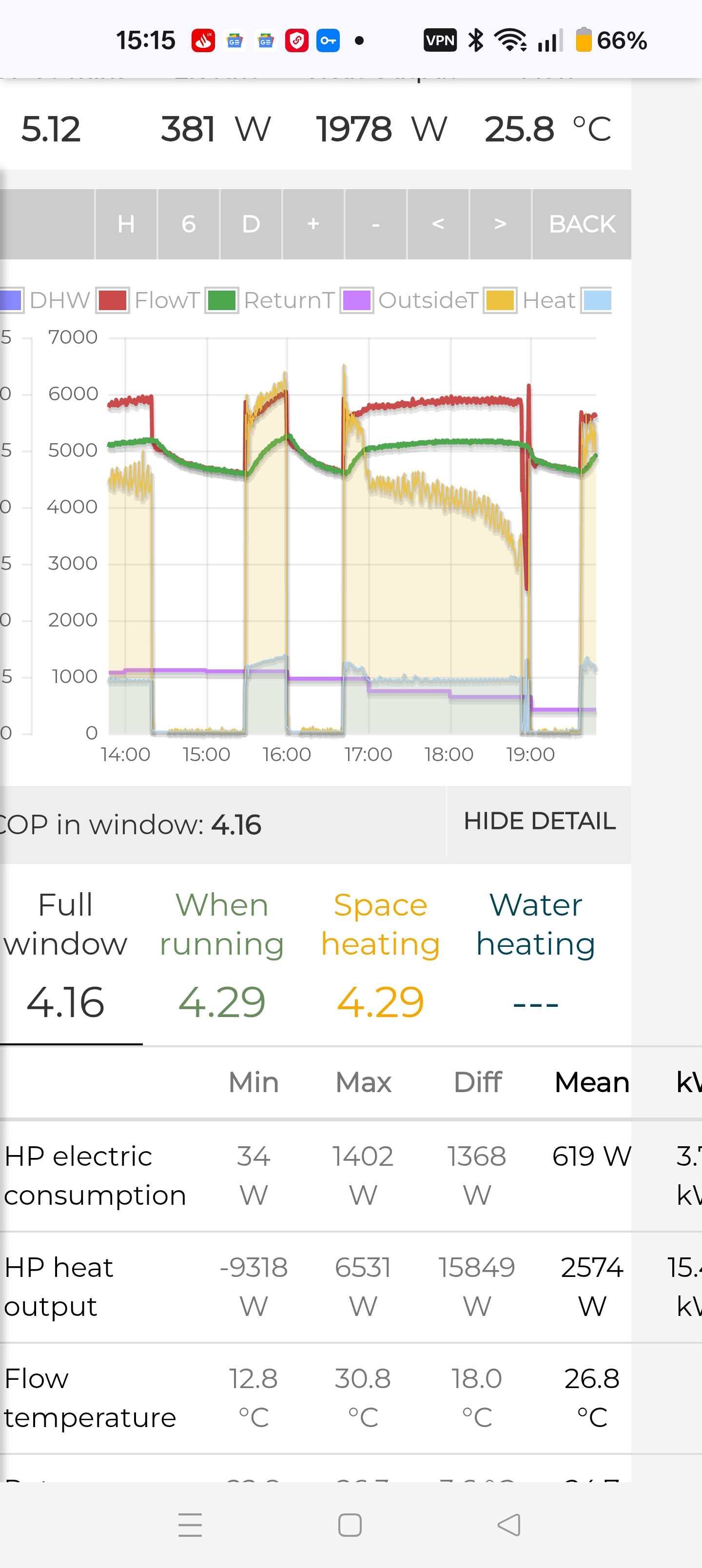

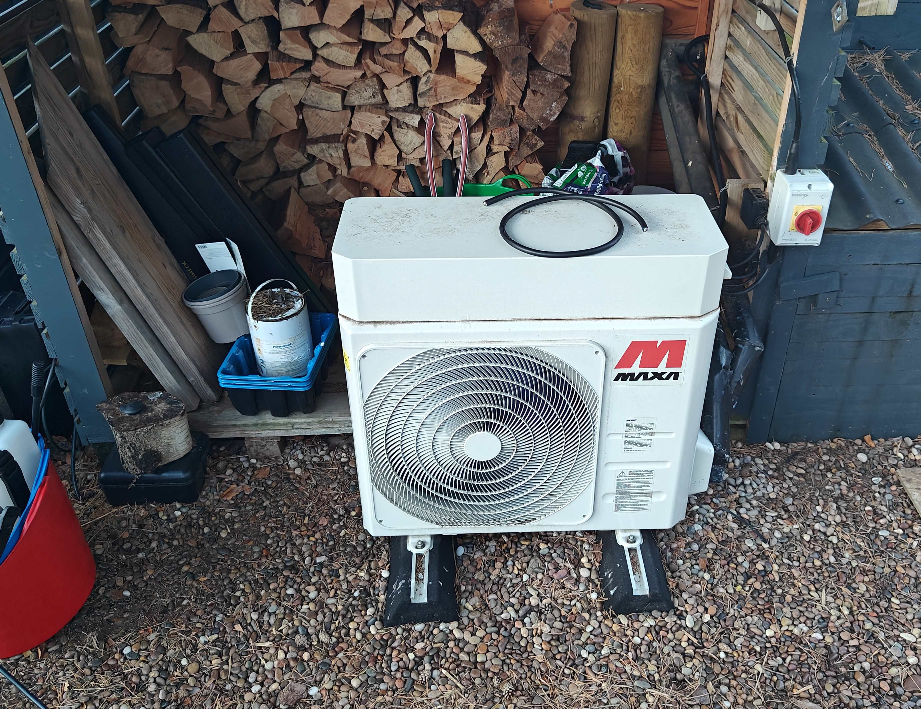

Just went back and looked for a similar period of running for the Maxa heat pump, similar outside temperature,
Screenshot_2026-01-26-15-15-01-00_40deb401b9ffe8e1df2f1cc5ba480b12.thumb.jpg.191f5ba7001fd7539fecdebc8d1cf25d.jpg
CoP here is 0.86 lower, doing the same heating. Flow temp was up to 30 degs to compensate for cycling. Haier is flowing between 25 and 26.

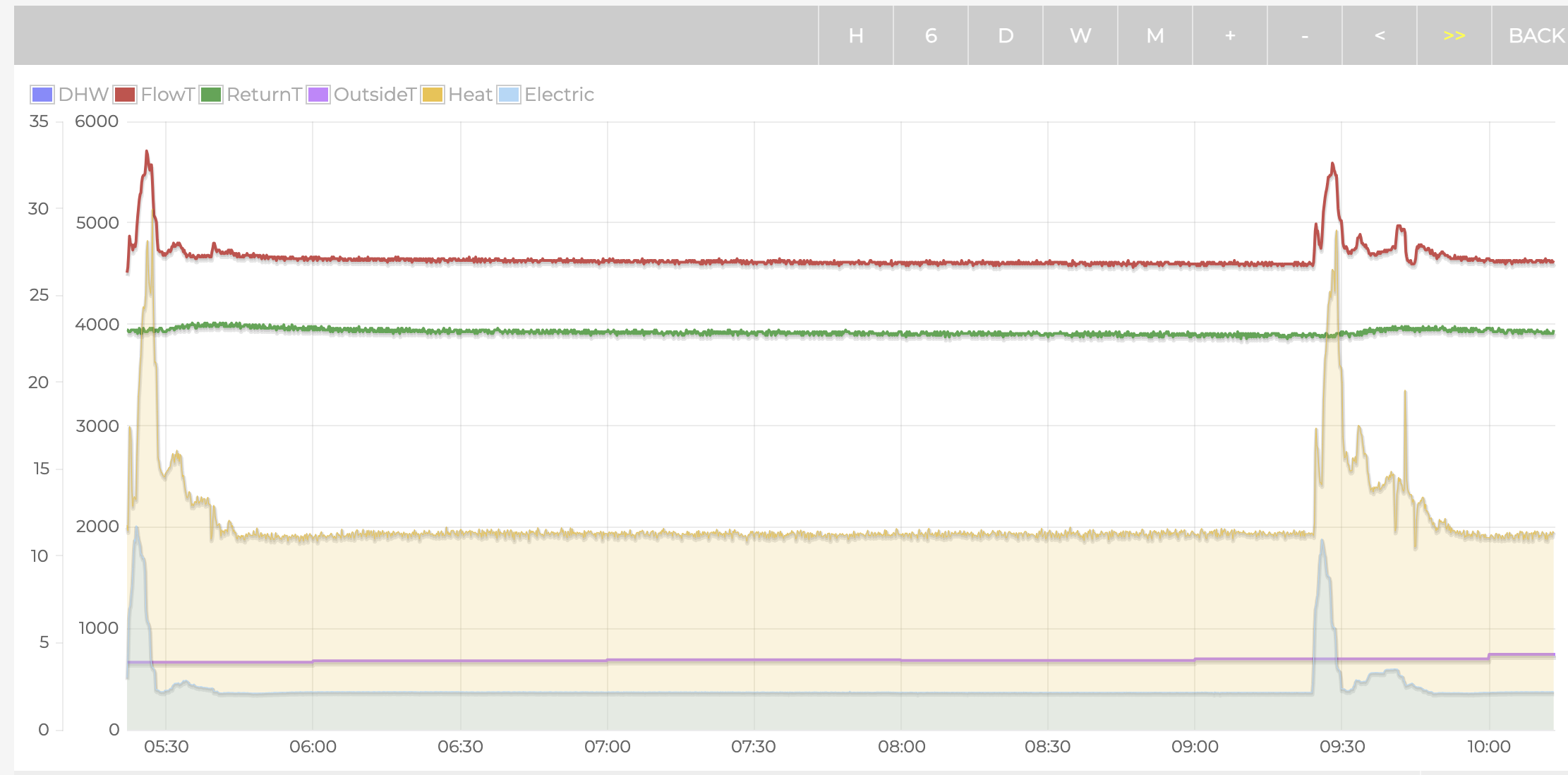

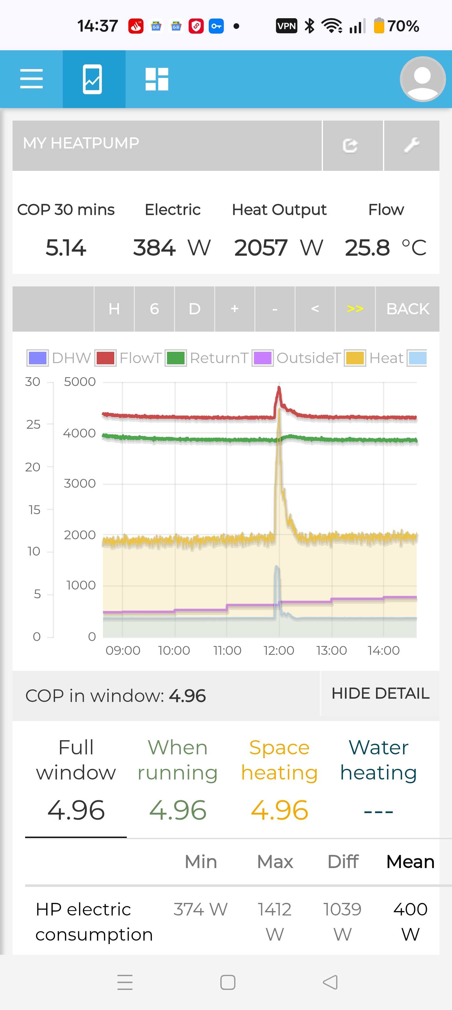

Plot of the last 5 hrs, one thing I have noticed is, every 4 hours it does a full load spike. Not sure if thats to test the sensors are all still working, adding a little heat to the lube oil to stop refrigerant saturation or combination of all these, plus some others. But seems part of the hardwired DNA of not wanting to stop running and cycling.
