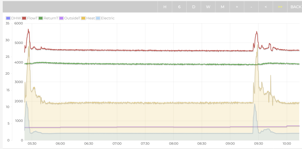

February 5Feb 5 Author So final update on commissioning. 1. Circulation pump has 3 modes AUTO/ON/OFF. In AUTO mode, the pump speed modulates and it goes off when no call for heat. In ON mode pump runs full speed all the time even when no call for heat. With thick screed and a fan coil, AUTO mode for pump does not work well, flow rate goes down to circa 6L/min and controller can't cope and under and overshoots modulation. It cannot find find the correct running mode. In OFF mode ASHP trip with flow error. Have set to ON and it seems to work well. 2. Control mode can be either dT mode, fixed speed (speed can be selected), or dT control with circulation pump in full speed fixed speed (depending on point 1. and setting to ON above). Have set to dT control. 3. Target dT is selectable, best one my heating setup is to target dT 4. dT2, 3 and 5 didn't respond as well. dT actually sits nearer 2 to 3 but controller seems happy with that. 4. Restart hysterisis, found the controller reacts badly to a premature restart, found I was chasing issues due to forcing a start early. dT4 for restart was acceptable, dT 3 lead to unstable running as the heat couldn't dump heat well. 5. Volumiser in, out or part out of system doesn't make much difference, have left in place. 6. Heat meter reads 0.6 degs higher temperatures, than the Haier controller 7. Final WC curve is 12 OAT 22 flow, -5 OAT 31 flow. 8. Controller set up to use 3rd party thermostat, this allow a 'stove on' over ride, to switch heat pump off when stove is on. It also allows a single switch to move between heat and cool on ASHP and thermostat. It also allows cooling to be temperature driven. Wiring is, from house to wiring centre - 2 core cable for winter/summer change over, wireless switch from thermostat Then from wiring centre to heat pump a 2 core cable to heat pump. No DHW connected. 4 degs outside delivering an average CoP so far today of 5, currently doing 5.2.

May 14May 14 Author On 05/02/2026 at 08:13, JohnMo said: So final update on commissioning. 1. Circulation pump has 3 modes AUTO/ON/OFF. In AUTO mode, the pump speed modulates and it goes off when no call for heat. In ON mode pump runs full speed all the time even when no call for heat. With thick screed and a fan coil, AUTO mode for pump does not work well, flow rate goes down to circa 6L/min and controller can't cope and under and overshoots modulation. It cannot find find the correct running mode. In OFF mode ASHP trip with flow error. Have set to ON and it seems to work well. 2. Control mode can be either dT mode, fixed speed (speed can be selected), or dT control with circulation pump in full speed fixed speed (depending on point 1. and setting to ON above). Have set to dT control. 3. Target dT is selectable, best one my heating setup is to target dT 4. dT2, 3 and 5 didn't respond as well. dT actually sits nearer 2 to 3 but controller seems happy with that. 4. Restart hysterisis, found the controller reacts badly to a premature restart, found I was chasing issues due to forcing a start early. dT4 for restart was acceptable, dT 3 lead to unstable running as the heat couldn't dump heat well. 5. Volumiser in, out or part out of system doesn't make much difference, have left in place. 6. Heat meter reads 0.6 degs higher temperatures, than the Haier controller 7. Final WC curve is 12 OAT 22 flow, -5 OAT 31 flow. 8. Controller set up to use 3rd party thermostat, this allow a 'stove on' over ride, to switch heat pump off when stove is on. It also allows a single switch to move between heat and cool on ASHP and thermostat. It also allows cooling to be temperature driven. Wiring is, from house to wiring centre - 2 core cable for winter/summer change over, wireless switch from thermostat Then from wiring centre to heat pump a 2 core cable to heat pump. No DHW connected. 4 degs outside delivering an average CoP so far today of 5, currently doing 5.2. Due to instability caused by heat pump hunting, I had to make some slight changes. Using the thermostat for heat pump permissive, the hysterisis was widened to 0.3 degs, the WC curve was changed also, 26 flow at 10 degs and 29 at -5. This seems to give a good balance house temperature and running stability leading to great CoP. Have run cooling also, have set target flow temperature to be 14.5, this was giving a CoP of around 7 in the warm spell a few weeks ago and zero condensation. Overall with cold spell over the last week, we got an average CoP of 5.4.
