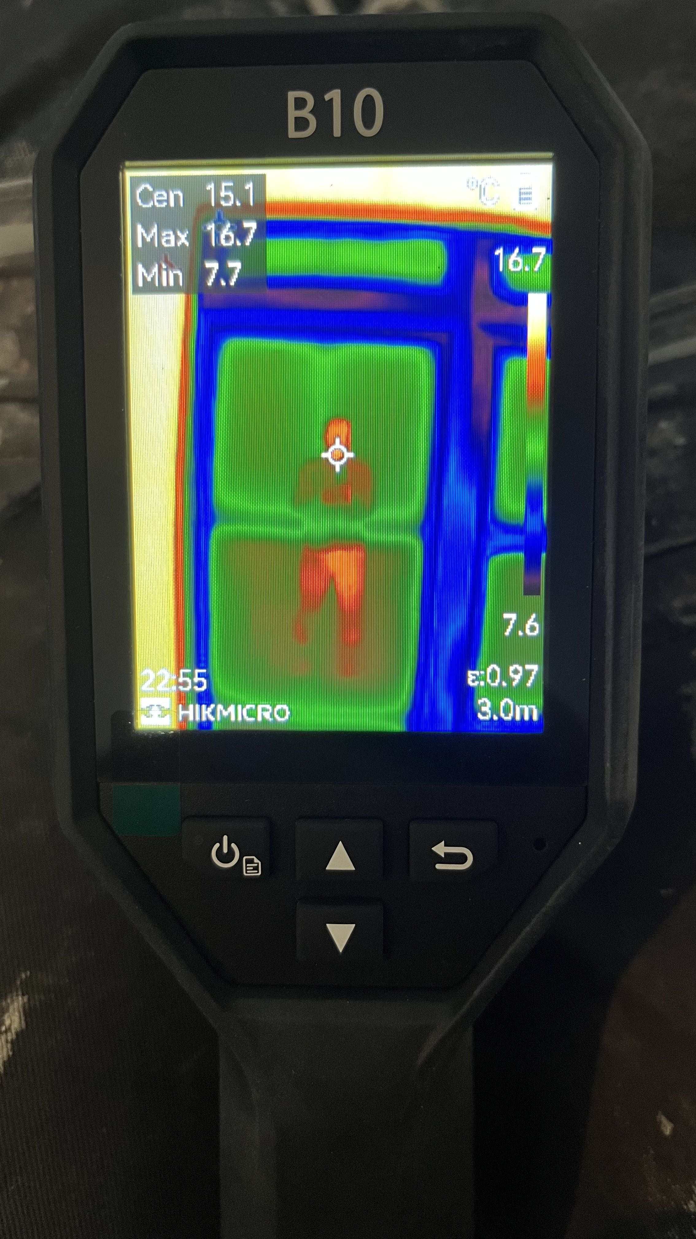

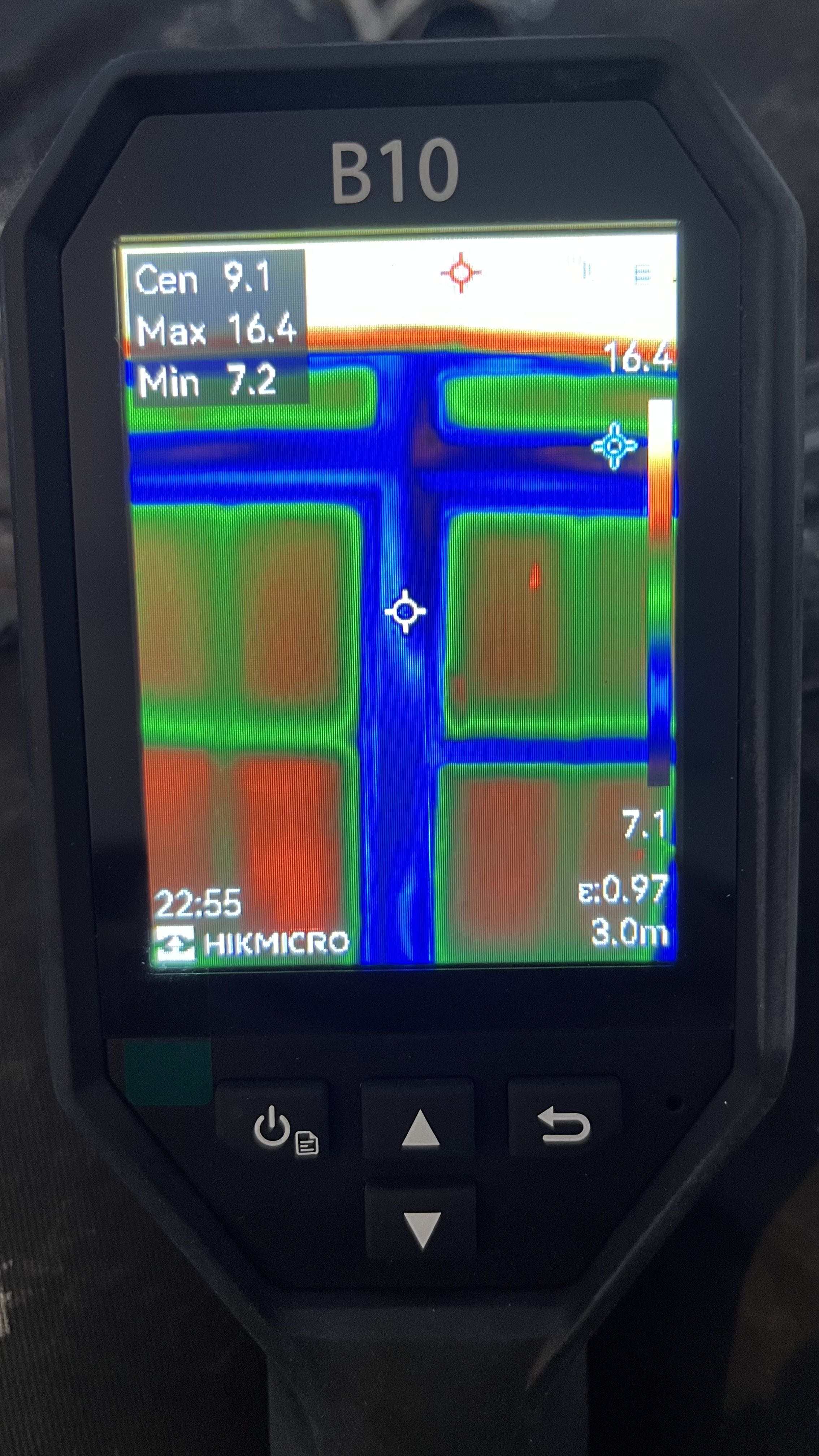

Good day for a test. (Did this about 95min ago)
Outside temp according to the ASHP is 2°C.
House Internal air temp is 18.4°C
Here is a photo from my thermal imaging camera. The window pane glass is at 12°C, look at the heat outline of my body showing the reflected heat, which is 15.1°C. The frame is at 9.1°C.
