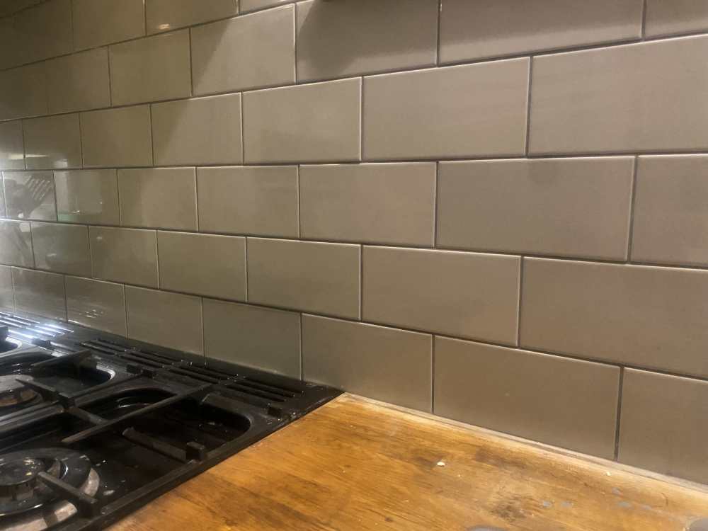

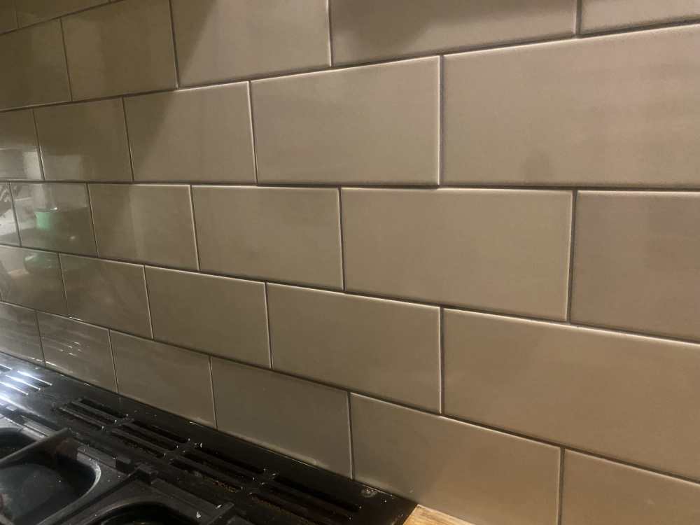

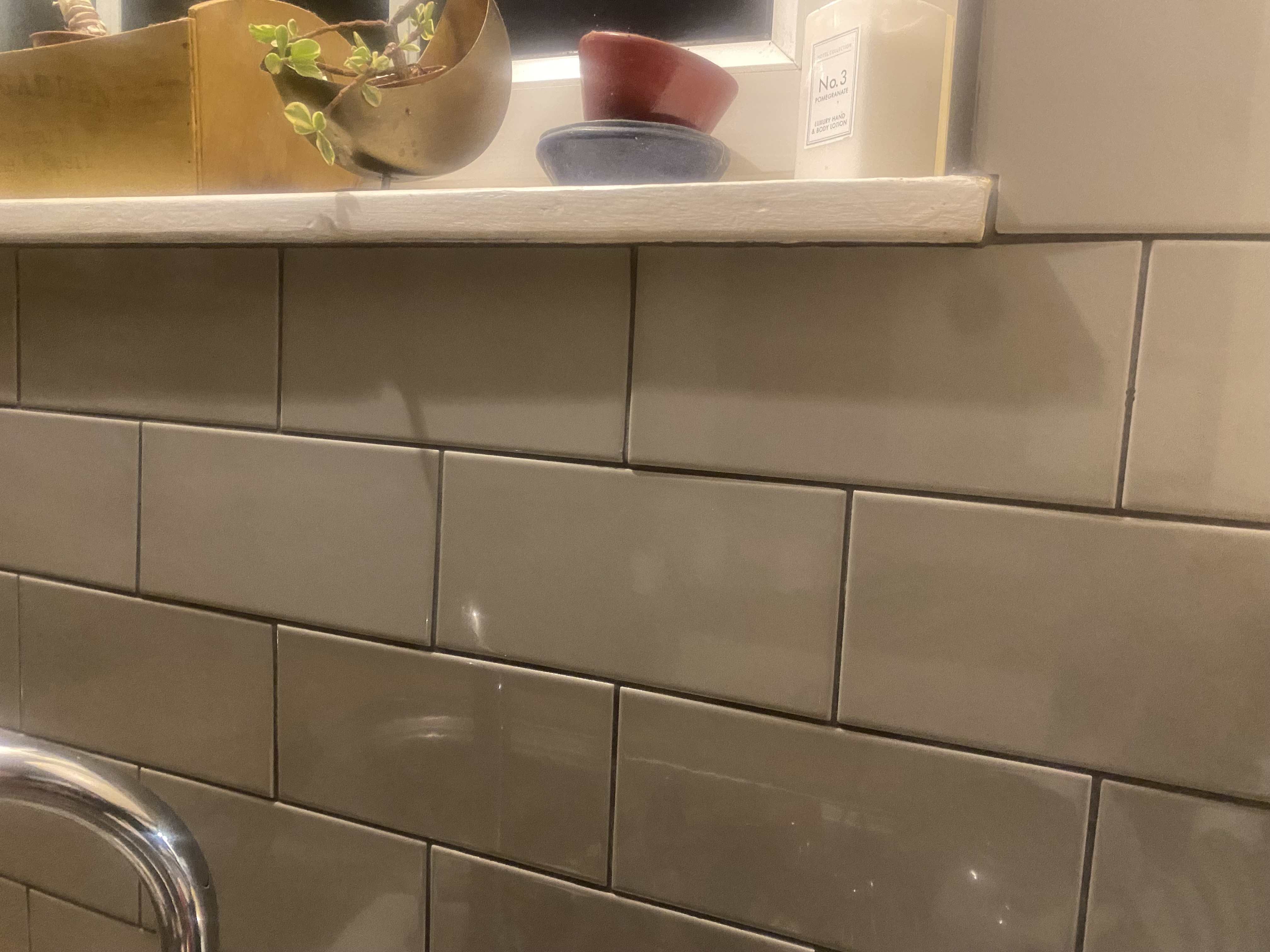

Lilneenz Posted 7 hours ago Posted 7 hours ago Hi all, I’d appreciate some professional opinions on a recently completed kitchen wall tiling job. I hired a tiler who was highly recommended, but due to unforeseen circumstances the actual tiling was carried out by another tiler working on his behalf. I removed the old tiles and had the wall bonded and levelled by my plasterer. Before the job, I asked if the walls should be skimmed and was told skimming would be ideal but that tiling onto bonding would be fine. The day before tiling, the walls were checked and approved. On the day, the tiles went up very quickly. Spacers were used but nothing else. The tiles were due to be grouted the following day and I noticed noticeable lippage and raised this, but was reassured it was normal and would look fine once grouted amd that the walls were to blame. When they left in the daylight the tiles looked ok ish. But now the unevenness is noticeable and very visible under lighting. Is this acceptable ?? What could have caused this ? What should I be saying to the tiler ?
Thorfun Posted 5 hours ago Posted 5 hours ago 1 hour ago, Lilneenz said: Is this acceptable ?? No 1 hour ago, Lilneenz said: What could have caused this ? Bad tiling 1 hour ago, Lilneenz said: What should I be saying to the tiler ? “I’m not paying for that” and then go and find a new tiler to do it properly 1
Gone West Posted 5 hours ago Posted 5 hours ago 2 hours ago, Lilneenz said: I hired a tiler who was highly recommended, but due to unforeseen circumstances the actual tiling was carried out by another tiler working on his behalf. I would go back to the tiler you originally hired and ask his opinion. If he accepts the other tiler was working on his behalf, then it may encourage him to sort it out. 1
Mr Punter Posted 5 hours ago Posted 5 hours ago Are the pics you took with your under cupboard lights? Can you do a photo in normal daylight?
Conor Posted 4 hours ago Posted 4 hours ago Where did you get the tiles from? We had similar format tiles years ago, cheap from B&Q. Tiler immediately showed us how uneven and warped they were and that he wouldn't be able to do a perfect job. But this looks more than irregular tiles
MortarThePoint Posted 4 hours ago Posted 4 hours ago I was thinking the other day that a poor tiler can make expensive tiles look cheap, a good tiler can make expensive tiles look expensive but a great tiler can make cheap tiles look expensive. Hard to be sure, but from the picture the tiles themselves look fine.
Nestor Posted 3 hours ago Posted 3 hours ago (edited) 24 minutes ago, Conor said: Where did you get the tiles from? We had similar format tiles years ago, cheap from B&Q. Tiler immediately showed us how uneven and warped they were and that he wouldn't be able to do a perfect job. But this looks more than irregular tiles As @Conor Can you confirm the quality of the tile, even thickness at either end and centre. Perfectly flat or any bowing? Can you run a straight edge across the vertical surface for a photo. Edited 3 hours ago by Nestor
torre Posted 59 minutes ago Posted 59 minutes ago Not a professional tiler but an amateur who would be unhappy if my own tiling looked like that, even though the lighting is probably amplifying faults a bit. Bad tiling, but do you have a few leftover tiles so you can prove to your original tiler that the tiles themselves are pretty flat? Plus ideally a picture of the wall before it was tiled onto. If you pointed out the lippage was that to your original tiler or the guy on site? They had the chance to get the tiles and adhesive off before it was fully set and it's a shame they didn't take it. I'd suggest to the original tiler that they need to come off - that you'll bear the cost of replacement tiles as needed but they need to redo the work at no extra charge. Hopefully you've not paid him and he's not paid the guy he subbed out the job to.
