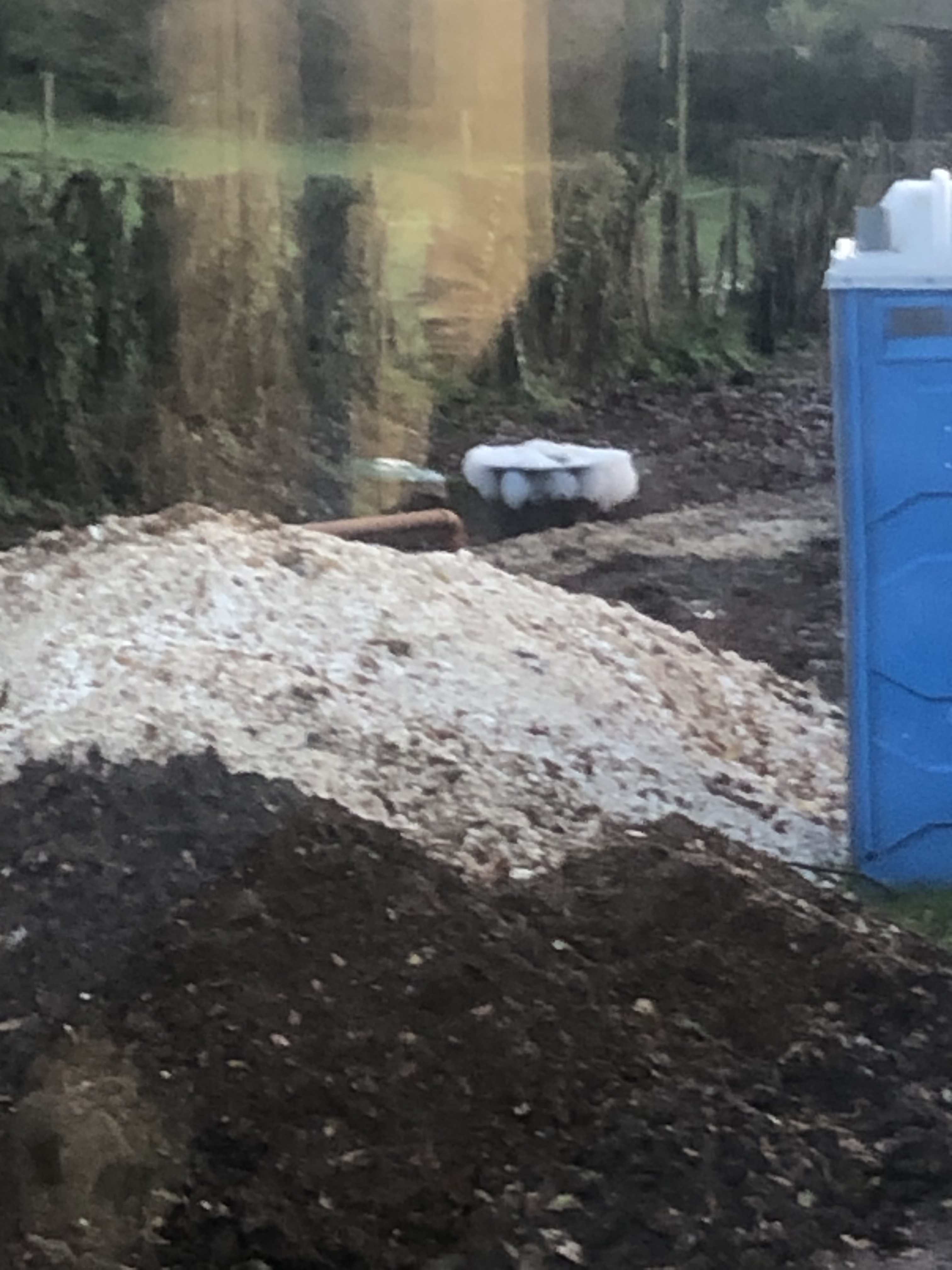

flanagaj Posted December 2, 2025 Posted December 2, 2025 I looked out of our static caravan this morning to see the below 😞  can anyone advise.  We have a 7PE tank and it’s just my wife and I.  Â
markc Posted December 2, 2025 Posted December 2, 2025 I’m guessing detergent .. looks too white for anything else 1
Mr Punter Posted December 2, 2025 Posted December 2, 2025 Have you used washing up liquid? Maybe the air treatment has made it bubble up. 1
flanagaj Posted December 2, 2025 Author Posted December 2, 2025 1 hour ago, Bonner said: What does it smell like? Smells fine. It's only been in operation two days.
Redbeard Posted December 2, 2025 Posted December 2, 2025 19 minutes ago, Mr Punter said: Have you used washing up liquid? Maybe the air treatment has made it bubble up.  Looks very like it. Try to get rid of the bubbles that are there and do a 'controlled experiment' with significantly smaller amounts of detergent.Â

ProDave Posted December 2, 2025 Posted December 2, 2025 I can't imagine the quantity of washing up liquid you would have to add to a 7PE tank to get the air blower to make it foam up like that. Normally after doing the washing up, there are hardly any bubbles left in the water to send down the drain.  Are you sure the tank has "started"? Folklaw up here says throw a dead Rabbit into a new tank to get things going, you can even buy chemicals to put in to start it if you don't like the former idea.  If the lid you are talking about is where the air blower is, then it needs a vent so can't be sealed. 1
saveasteading Posted December 2, 2025 Posted December 2, 2025 Did it start empty or did you fill it with water? If the latter then the drainage to date is a tiny proportion and the clean water will foam up, as in the difference of the frothy water before you start the washing up, and the lack of foam after. I don't know the science of detergents, but it is along the lines of it clinging to fats etc, and the rest forming bubbles. It will be going back up the inlet pipe too. Â Less detergent* (which will help digestion anyway) and a bit of patience is all, I think. Â And maybe turn off the bubbles for a few days while the festering gets going. Â But do keep us informed as I have never seen this... Â * we all know there is only one way to wash dishes and everyone else is wrong. I use little, as and when. I've seen other people use maybe 10 times as much... a great big scoosh and there is still loads of foam when finished. Â Â Â Â Â
flanagaj Posted December 2, 2025 Author Posted December 2, 2025 (edited) 10 minutes ago, saveasteading said: Did it start empty or did you fill it with water? If the latter then the drainage to date is a tiny proportion and the clean water will foam up, as in the difference of the frothy water before you start the washing up, and the lack of foam after. I don't know the science of detergents, but it is along the lines of it clinging to fats etc, and the rest forming bubbles. It will be going back up the inlet pipe too.  Less detergent* (which will help digestion anyway) and a bit of patience is all, I think.  And maybe turn off the bubbles for a few days while the festering gets going.  But do keep us informed as I have never seen this...  * we all know there is only one way to wash dishes and everyone else is wrong. I use little, as and when. I've seen other people use maybe 10 times as much... a great big scoosh and there is still loads of foam when finished.      The tank was full with clean water when we moved in.  I’m going to buy some muck muncher sachets.  it seems to have settled down now, but it was a shock to see it this morning.  I have also reiterated to the wife that you don’t need a massive amount of washing up liquid. Edited December 2, 2025 by flanagaj 1
saveasteading Posted December 2, 2025 Posted December 2, 2025 4 minutes ago, flanagaj said: settled down now, OK that's good. No need to send a new photo of nothing happening. And you're going to save money on detergent while improving the efficiency of the kit... cleaner water coming out the other end, and less sludge. 1
