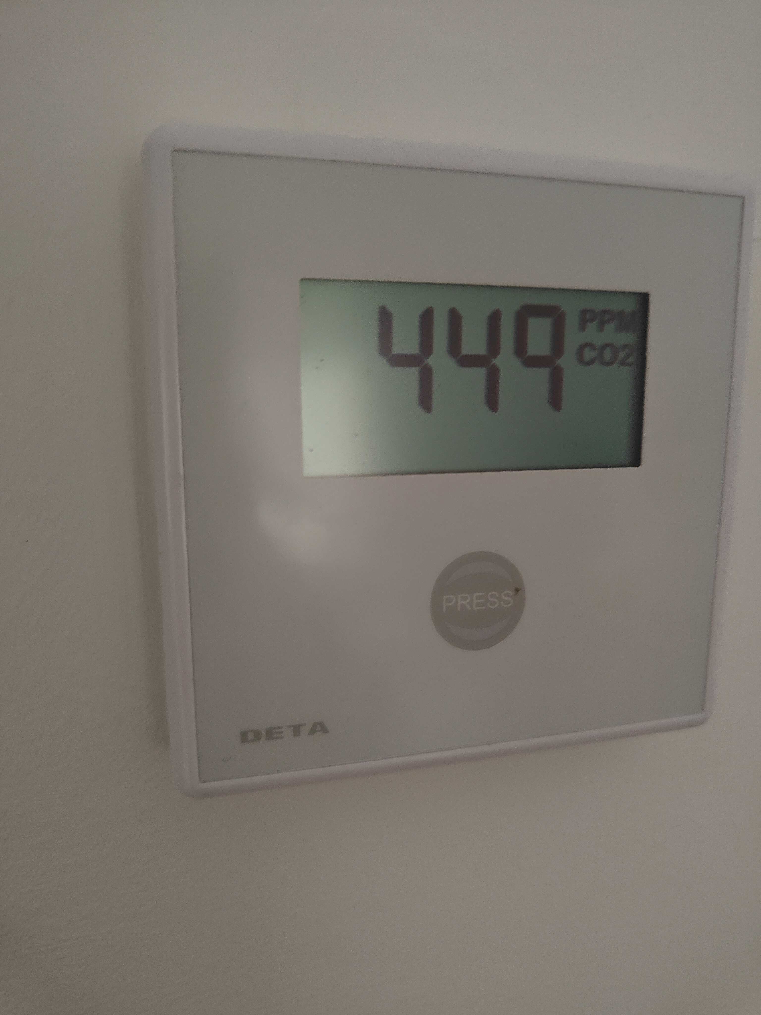

JohnMo Posted November 29, 2025 Posted November 29, 2025 1 hour ago, Russell griffiths said: carbon monoxide Wrong thing all together. CO2 is what you need. There are a couple I'm selling on eBay. https://ebay.us/m/MC8XHB

JohnMo Posted November 29, 2025 Posted November 29, 2025 3 minutes ago, Russell griffiths said: Fark me there expensive. how much to a mate 😉 I have some different ones (Deta) not listed yet, Scottish building regs compliant. Normal cost is £150 each. They do temp and CO2 instant readings and list CO2 average for last 8 and 24 hrs, plus peak over last 24 hrs. I have one new, still in box, and one used - £70 and £30 each. Can post, PM if interested. They look like this
