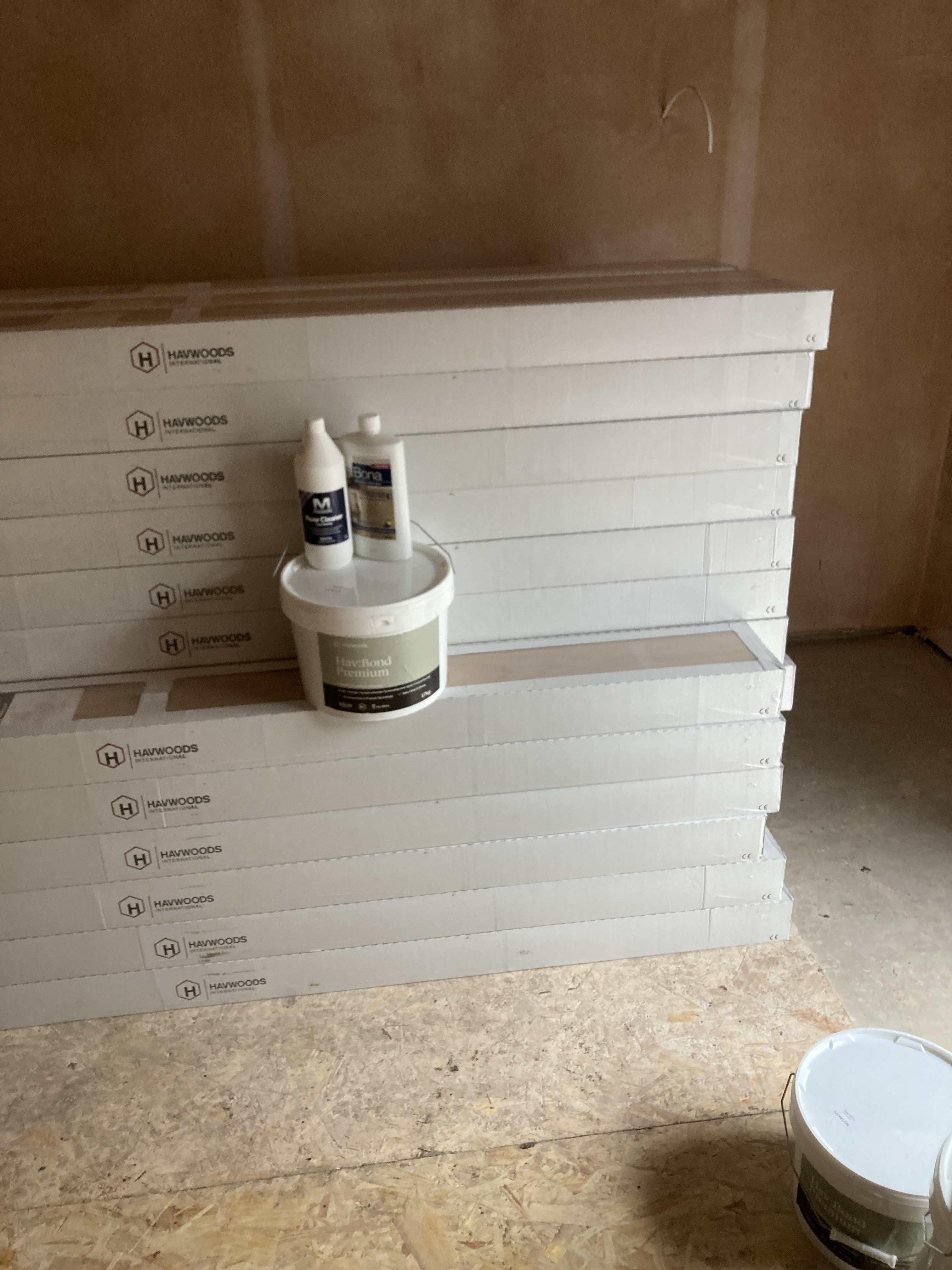

nod Posted Monday at 11:34 Posted Monday at 11:34 I’m doing some micro cement at a job in a couple of weeks Walls and floors Similar cost to tiles I’ve also some engineered flooring at a job I’m at today Glued down But you will still need perimeter expansion gaps
