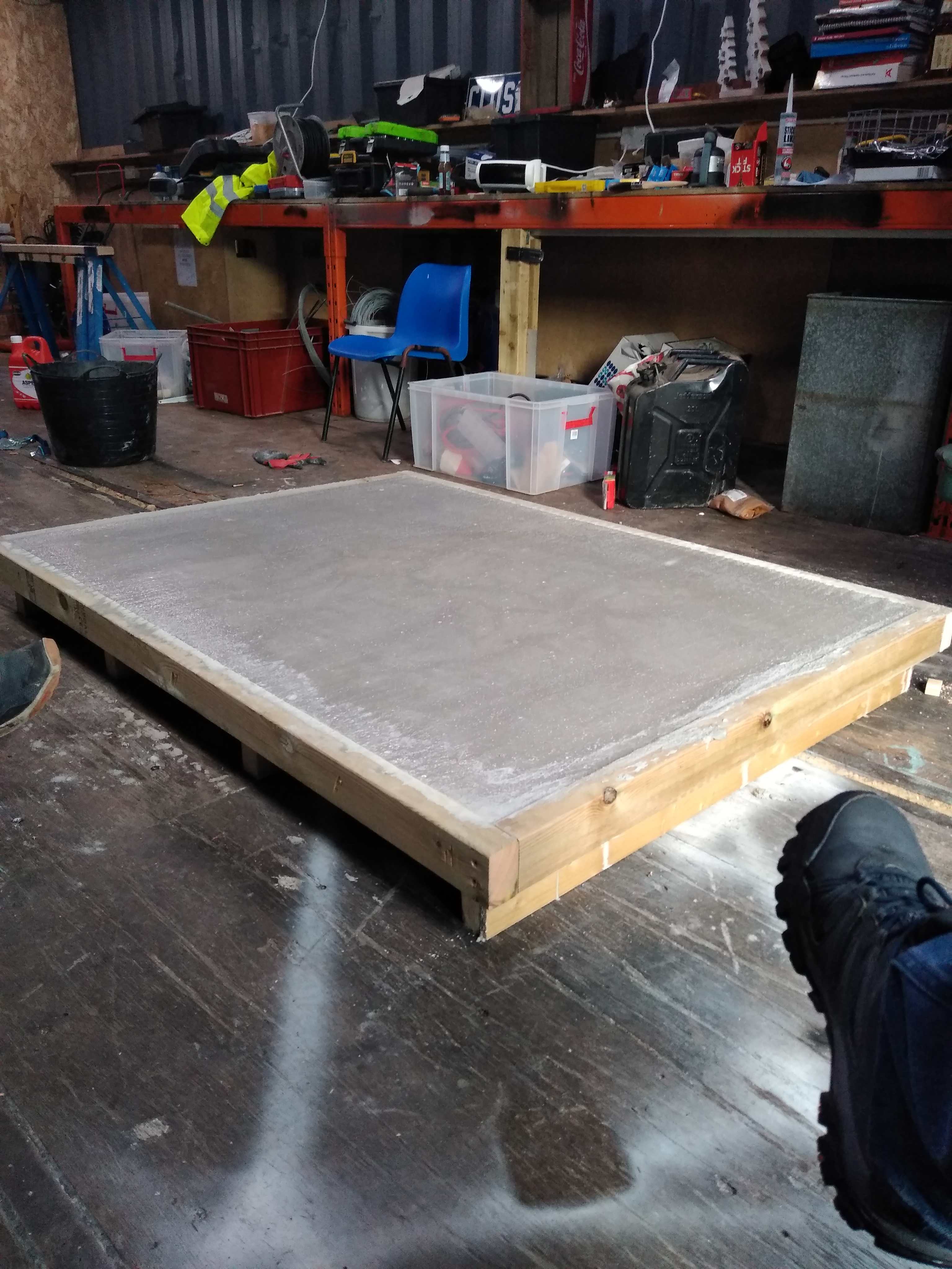

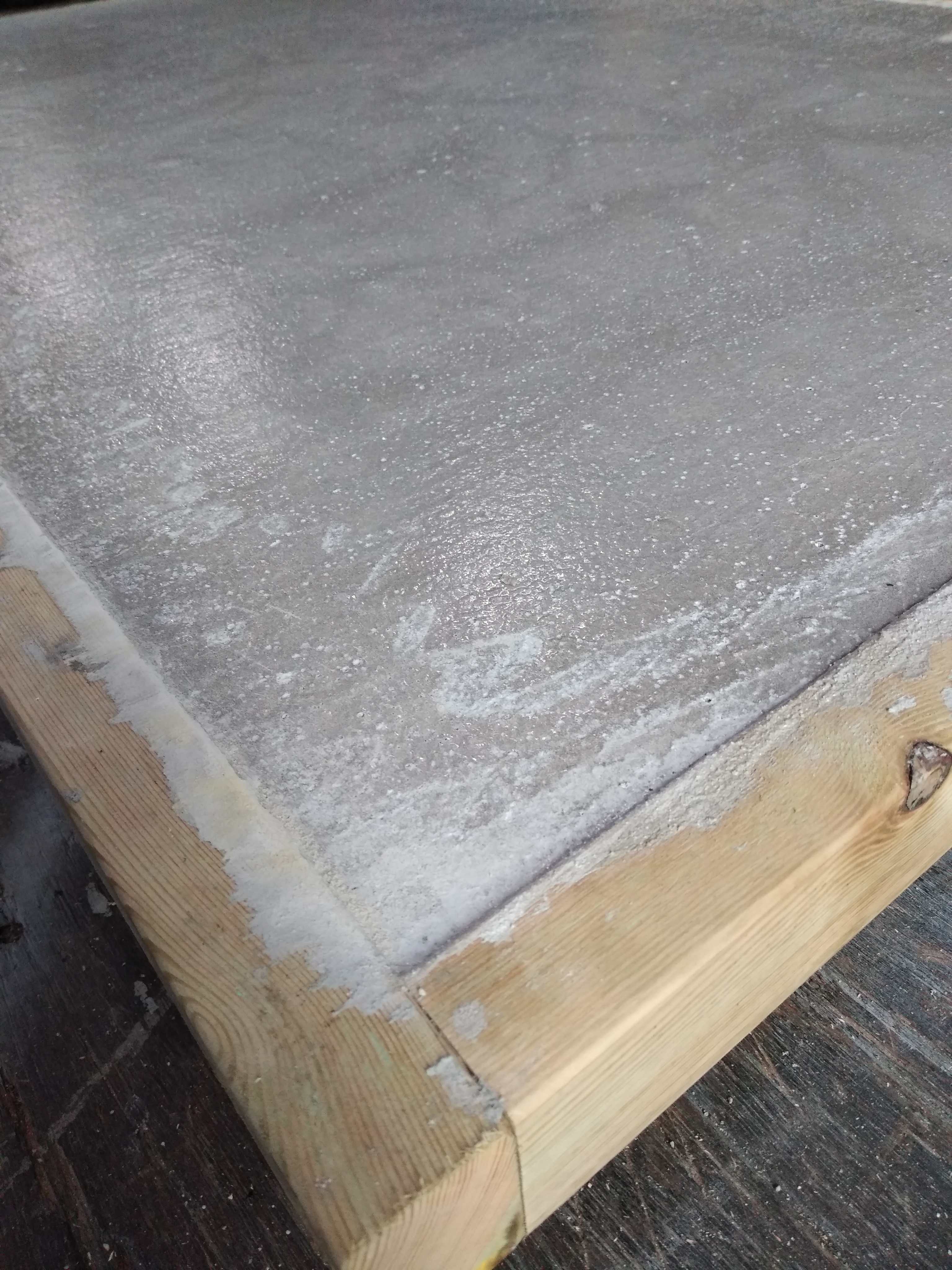

SteamyTea Posted 10 hours ago Posted 10 hours ago We cast a bit of concrete couple of days ago. This is just a test piece. Do these bull floats get a really good finish on the surface?
-rick- Posted 7 hours ago Posted 7 hours ago 2 hours ago, SteamyTea said: We cast a bit of concrete couple of days ago. This is just a test piece. That looks fun to move

SteamyTea Posted 3 hours ago Posted 3 hours ago 3 hours ago, -rick- said: That looks fun to move About 300kg. The size we want will be about 700kg.
