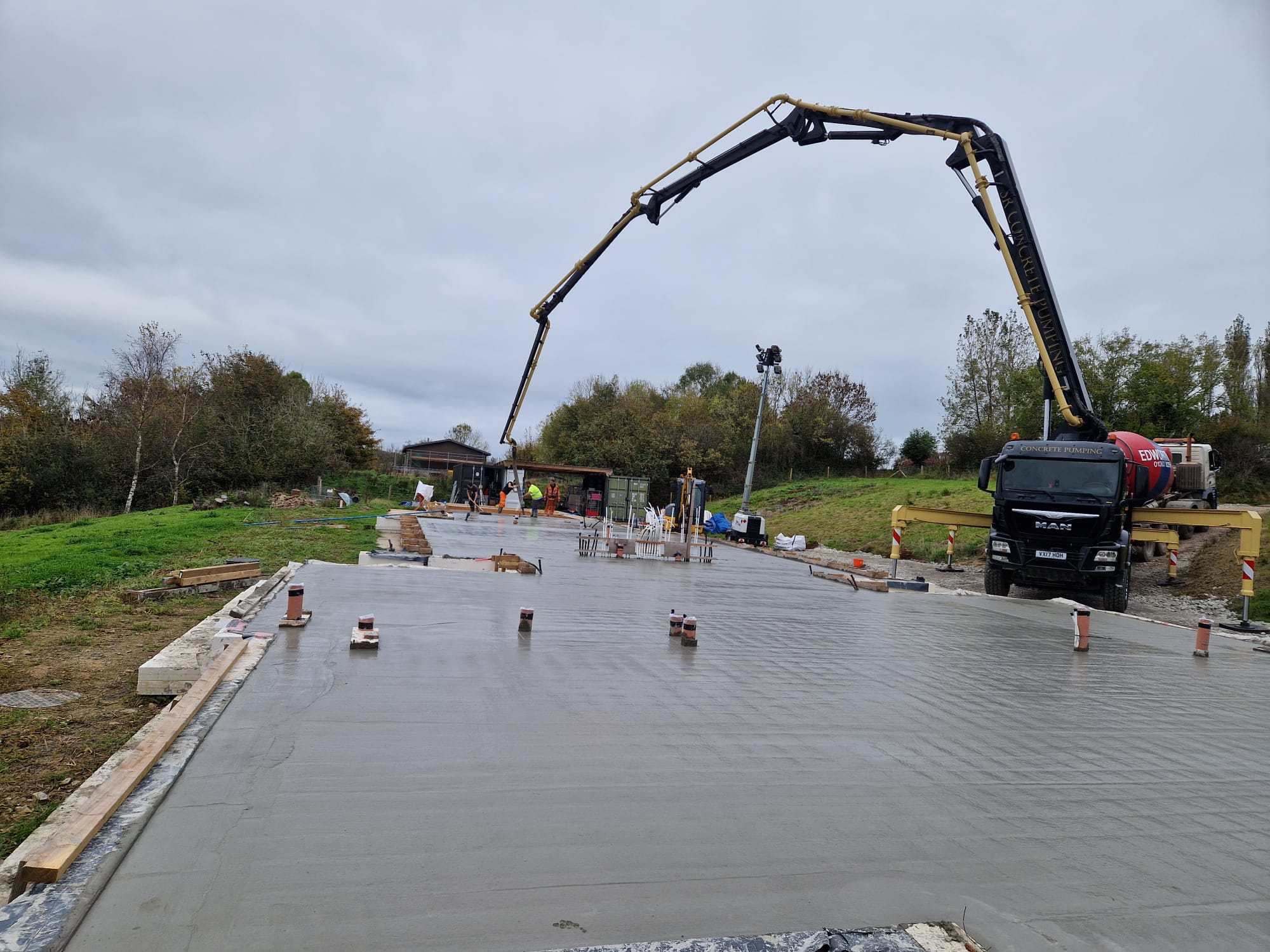

Just had 400 sqm of raft foundation poured leveled and power floated, all in one sitting.
Guys turned up at 6.30am and left the following morning at 3.40am.
Really good job.
£4k.
Really good job.
£4k.

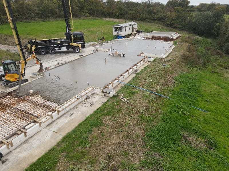

250mm thick. 15 lorry's 😢
I paid for the pump, they brought all the other kit.

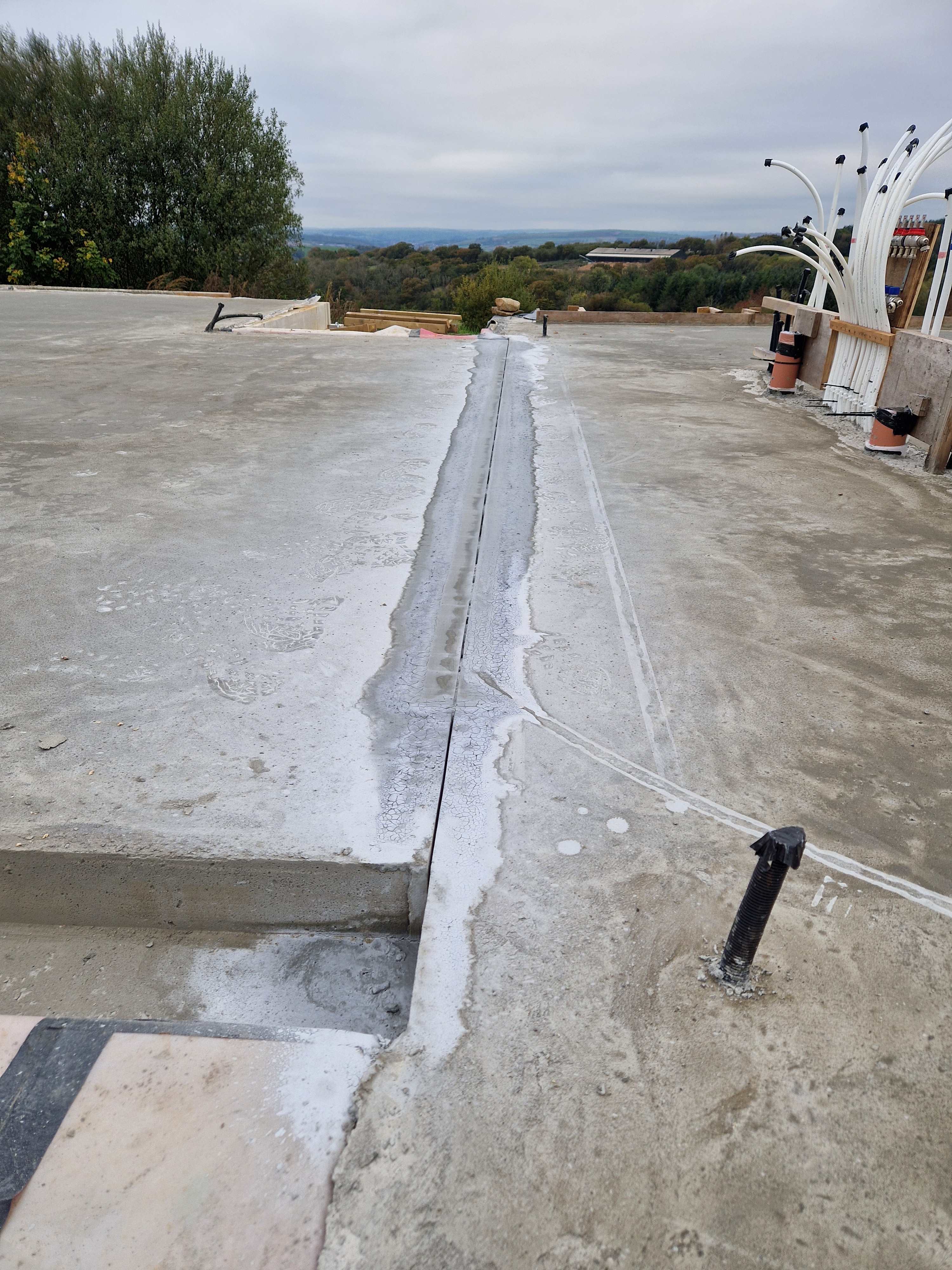

I cut the contraction joints 36 hrs later.
It'll rain later today and it's to big to cover so fingers crossed 🤞.
If it all goes bad then plan B is a 2-3mm epoxy finish.

Yes, definitely overkill by the SE.
Nearly killed me doing 66 sheets of A393 and 2.5 tons of reinforcement ground beams, solo.

Greenraft (great company)
SE specified the reinforcement to mitigate anything up to a 5m diameter void appearing under the raft.
