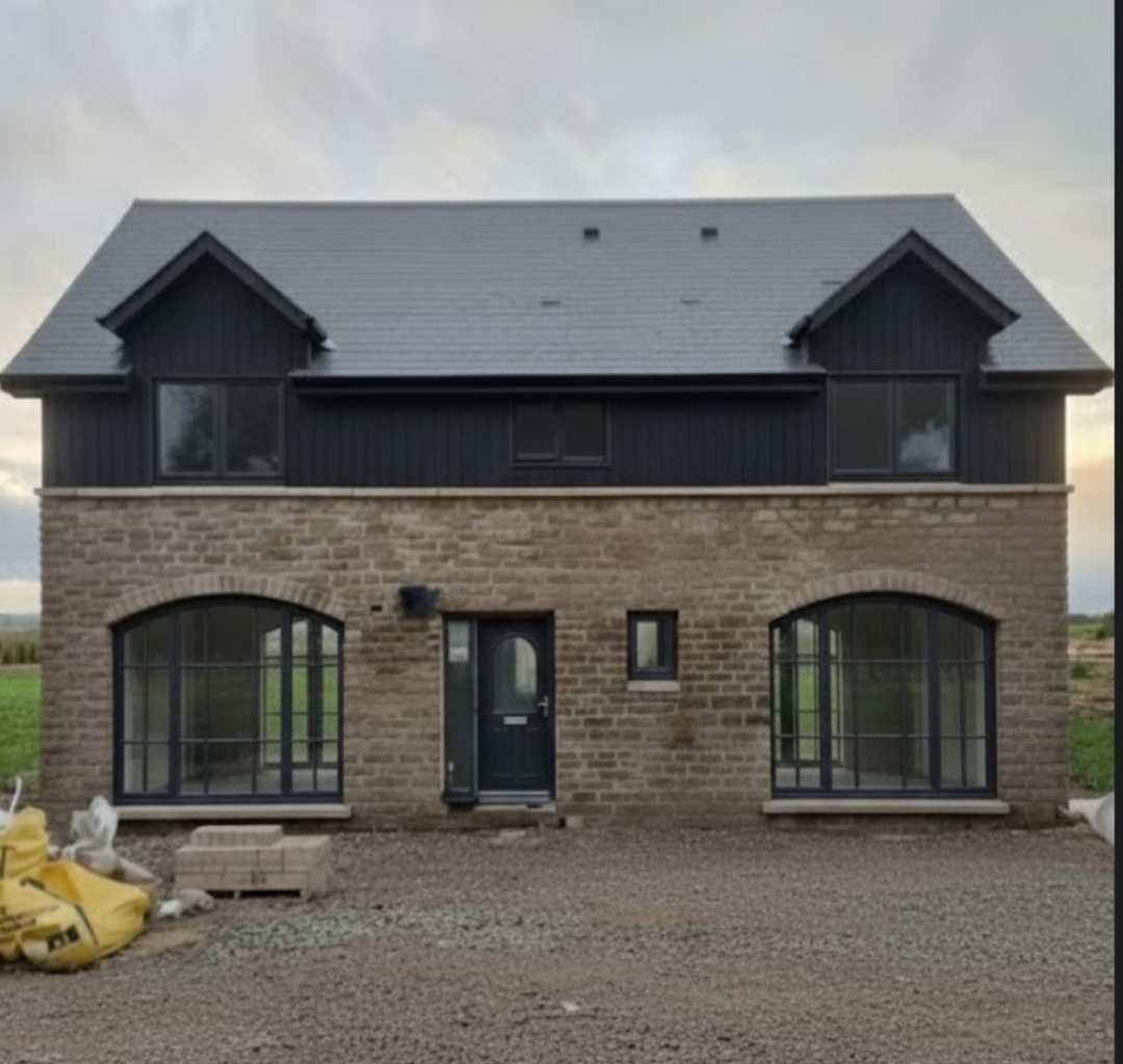

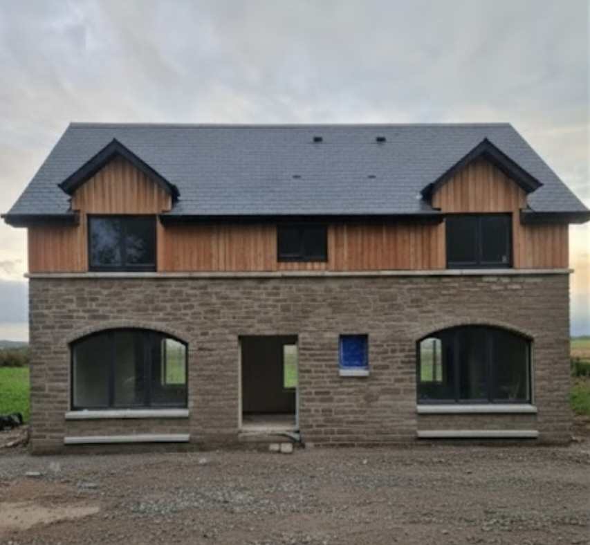

Amateur bob Posted Sunday at 21:35 Posted Sunday at 21:35 Which of the 2 of these looks best the wood or the dark grey/black one? Thanks
Mike Posted Sunday at 21:52 Posted Sunday at 21:52 The wood, especially after it has toned down to a light grey.
DownSouth Posted yesterday at 06:01 Posted yesterday at 06:01 Prefer the black one. I have built a fully black clad house though so am biased towards it. I’d worry that wood will weather differently under those eaves so might end up looking patchy.

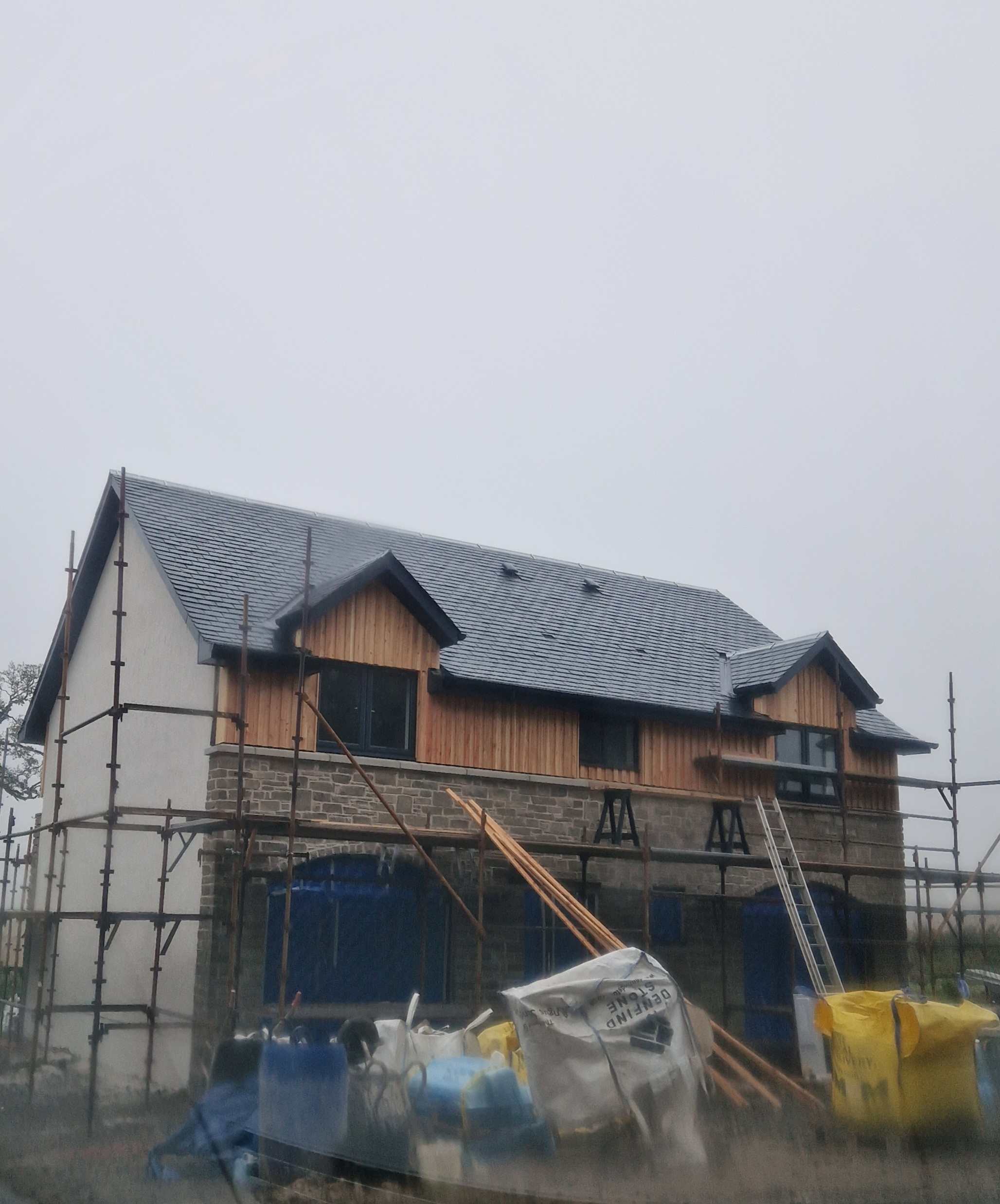

Amateur bob Posted yesterday at 07:49 Author Posted yesterday at 07:49 Ill need to ask builder what sort of wood it is but itll need treated? the wood ones already on i got google gemini to adapt it to the colour builders planning to paint it, im still undecided
Amateur bob Posted yesterday at 07:51 Author Posted yesterday at 07:51 The gable is white if that makes any difference
Nickfromwales Posted yesterday at 08:01 Posted yesterday at 08:01 8 minutes ago, Amateur bob said: Ill need to ask builder what sort of wood it is but itll need treated? the wood ones already on i got google gemini to adapt it to the colour builders planning to paint it, im still undecided The wood ‘type’ should be in your architect’s spec, as I assume the builders get direction / instruction from somewhere? Hopefully it’s something hardy, like cedar. Oh; Opt 1. Black / dark version makes the house too gloomy imho.

Mike Posted yesterday at 11:26 Posted yesterday at 11:26 (edited) 3 hours ago, Amateur bob said: The gable is white if that makes any difference For me that makes a big difference. From your first images it was believable that this may have been a single storey building that had had a second floor added. From an angle that illusion is blown - it now looks like a house with two types of decorative cladding on the front. To regain some visual cohesion I'd probably forget the wood and render the upper portion to match the side, though it's not an ideal solution. Edited yesterday at 11:28 by Mike
JohnMo Posted yesterday at 11:56 Posted yesterday at 11:56 First pic, but treated so it doesn't go grey. Black looks awful, doesn't look finished
Gone West Posted yesterday at 12:11 Posted yesterday at 12:11 4 hours ago, Amateur bob said: Ill need to ask builder what sort of wood it is but itll need treated? Western Red Cedar doesn't need any treatment to stop rot and lasts for around seventy years. It will go grey without any surface treatment, which some people like and some don't. You will find the rain washed areas go grey quicker than the weather protected areas, so can look patchy until it all evens up, which can take years.
Amateur bob Posted yesterday at 12:58 Author Posted yesterday at 12:58 46 minutes ago, Gone West said: Western Red Cedar doesn't need any treatment to stop rot and lasts for around seventy years. It will go grey without any surface treatment, which some people like and some don't. You will find the rain washed areas go grey quicker than the weather protected areas, so can look patchy until it all evens up, which can take years. it was intended to be painting so looks like pine
Crofter Posted yesterday at 13:41 Posted yesterday at 13:41 Having seen the view including the gable, definitely go for the natural wood colour. I'm surprised this isn't a planning condition though?

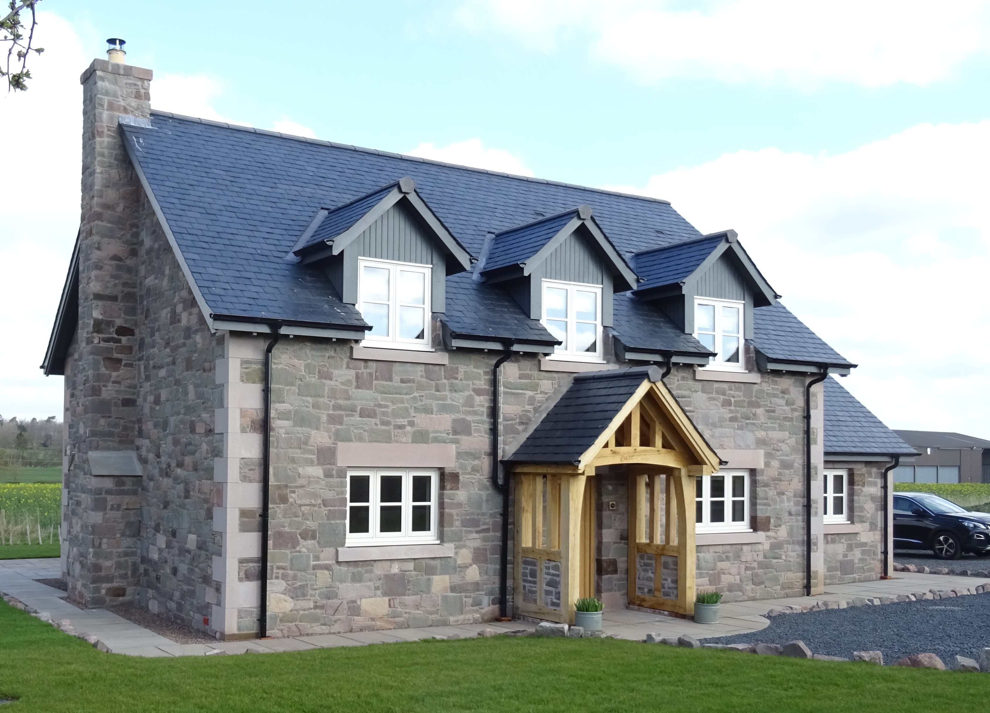

gamestrolley Posted 18 hours ago Posted 18 hours ago Stone right up to the eaves and do away with the gable and domers, simpler is nicer and cheaper

Redoctober Posted 6 hours ago Posted 6 hours ago 11 hours ago, gamestrolley said: Stone right up to the eaves and do away with the gable and domers, simpler is nicer and cheaper Like this I guess. 3

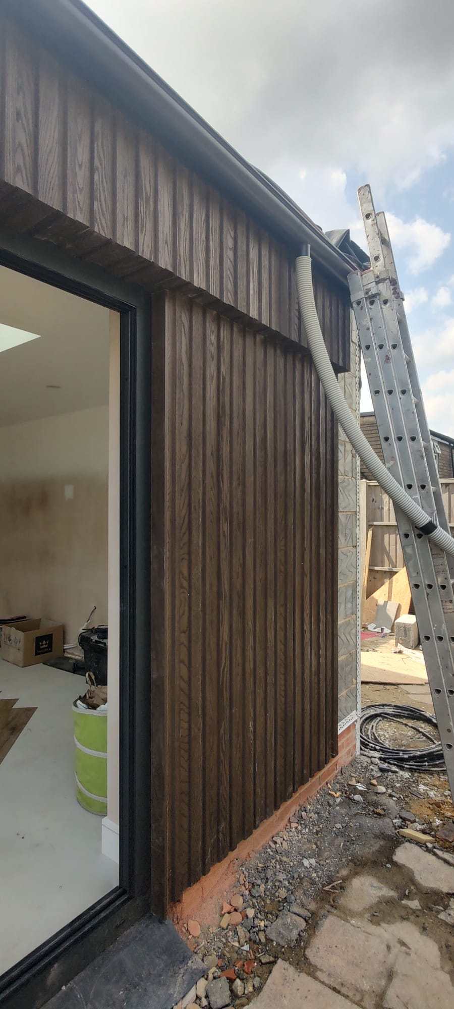

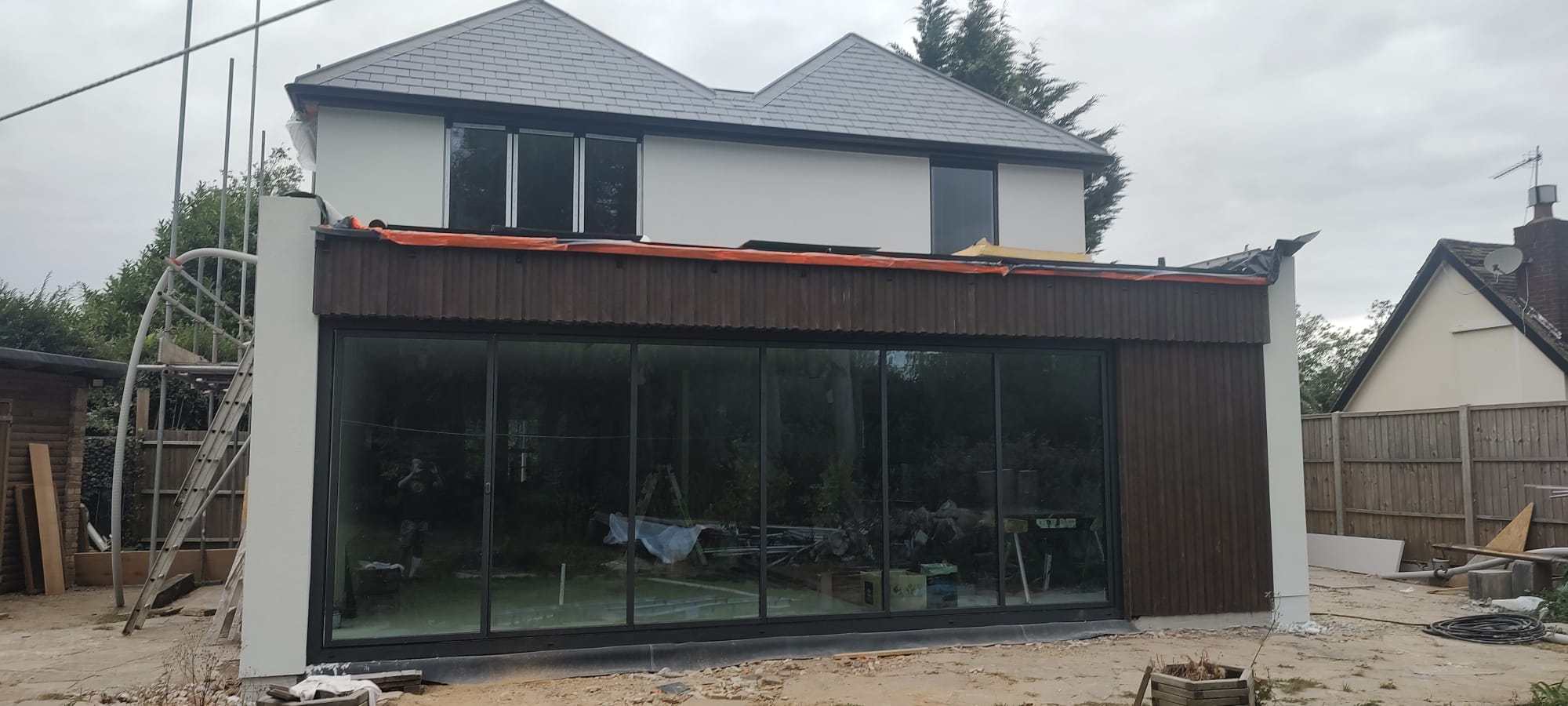

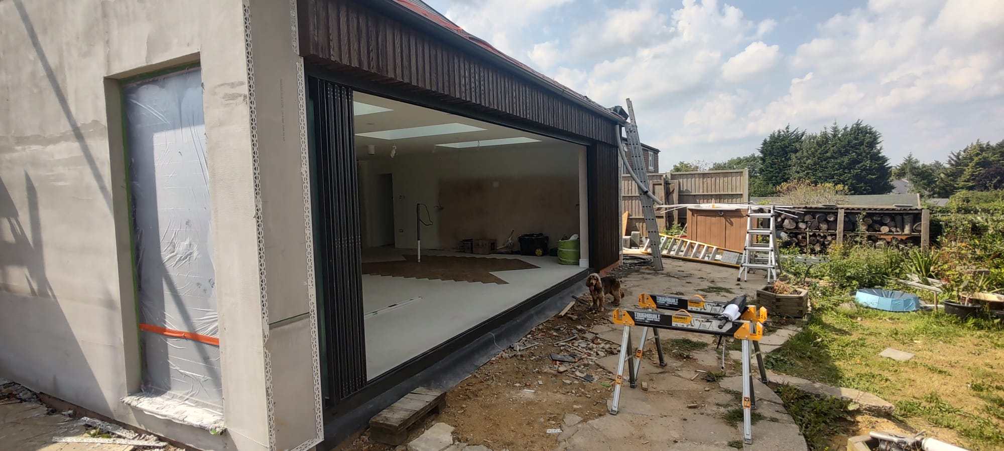

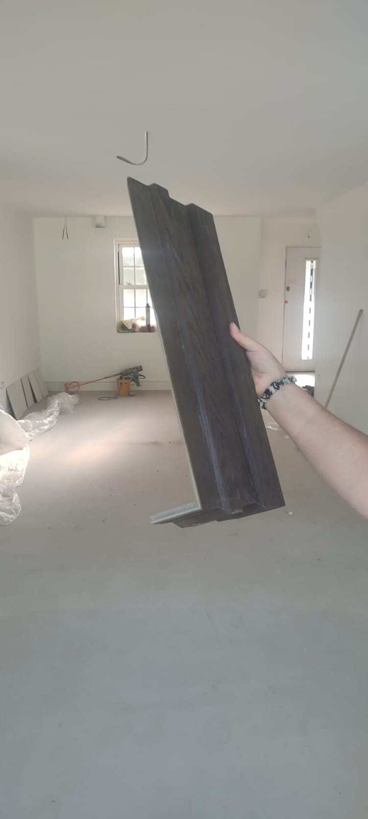

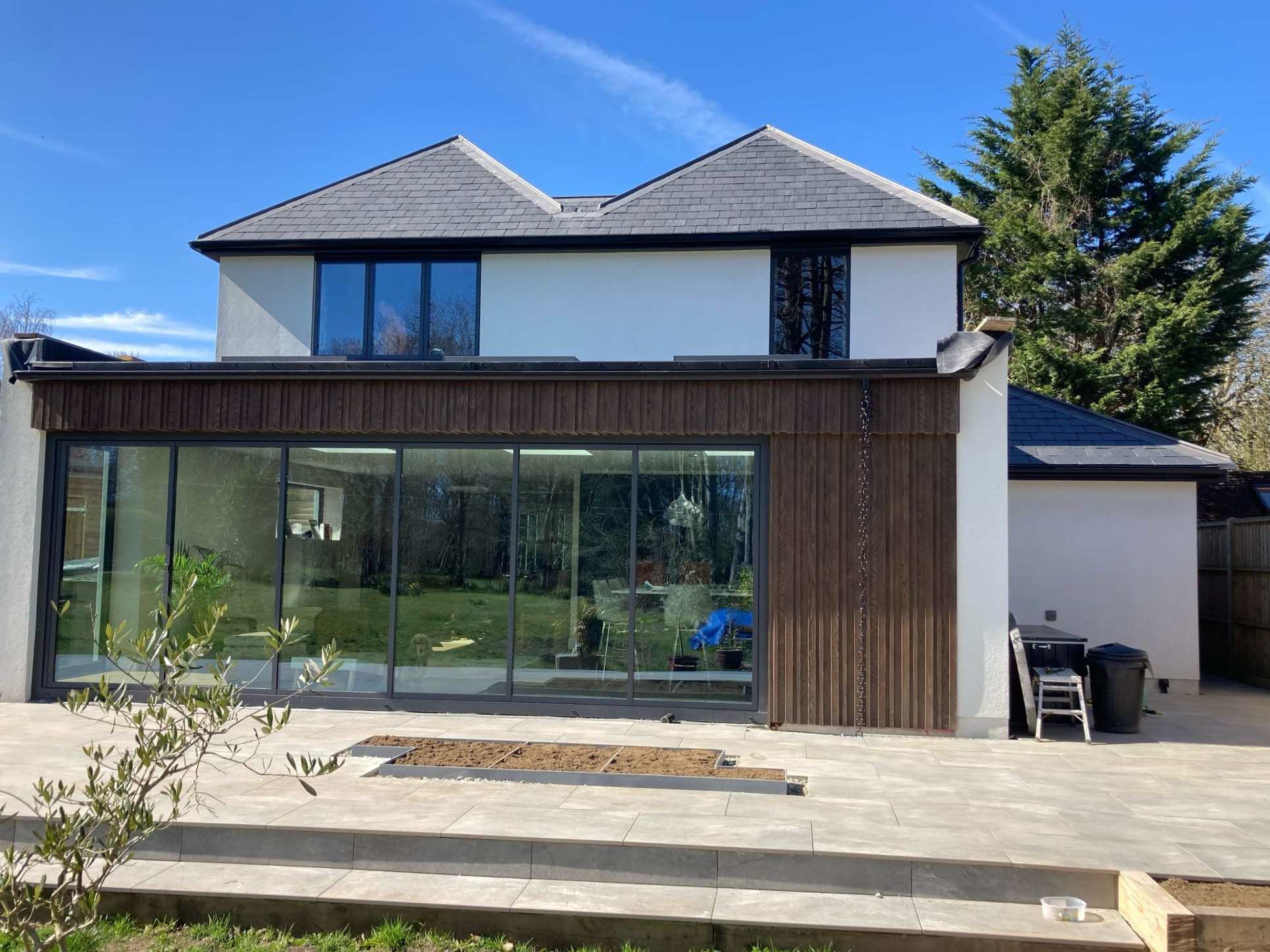

Tetrarch Posted 4 hours ago Posted 4 hours ago If you want maintenance-free then you could do a lot worse than Millboard. I used Cedral on a prevous house (both outside and as a bath panel) and it is a great product, but is definitely "just a concrete board" https://www.millboard.com/en-gb/composite-cladding-collections/board-batten/golden-oak/MCBF360G The millboard cladding is astonishingly realistic, and is really good for mitre-ing. The only downside is that it is NOT cheap. Other cladding boards are available,but when you compare them close-up the Millboard is a cut above. My critical criteria was waterproofing as I wanted to add a rain chain and they do splash a bit. I attach some during and after installation photos Regards Tet

Amateur bob Posted 10 minutes ago Author Posted 10 minutes ago 3 hours ago, Tetrarch said: If you want maintenance-free then you could do a lot worse than Millboard. I used Cedral on a prevous house (both outside and as a bath panel) and it is a great product, but is definitely "just a concrete board" https://www.millboard.com/en-gb/composite-cladding-collections/board-batten/golden-oak/MCBF360G The millboard cladding is astonishingly realistic, and is really good for mitre-ing. The only downside is that it is NOT cheap. Other cladding boards are available,but when you compare them close-up the Millboard is a cut above. My critical criteria was waterproofing as I wanted to add a rain chain and they do splash a bit. I attach some during and after installation photos Regards Tet i should have clarified the wood cladding is already on, just deciding whether to paint it now
