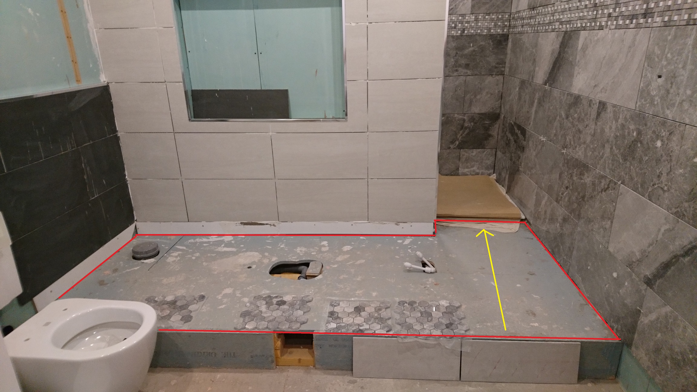

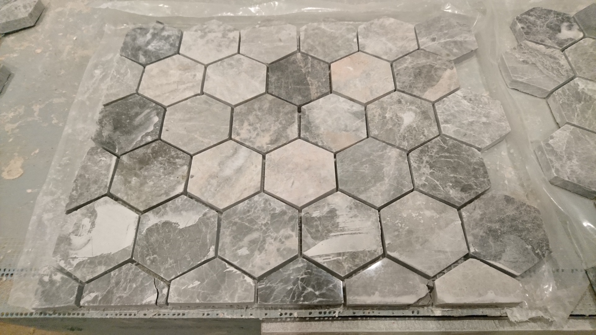

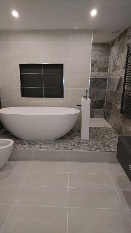

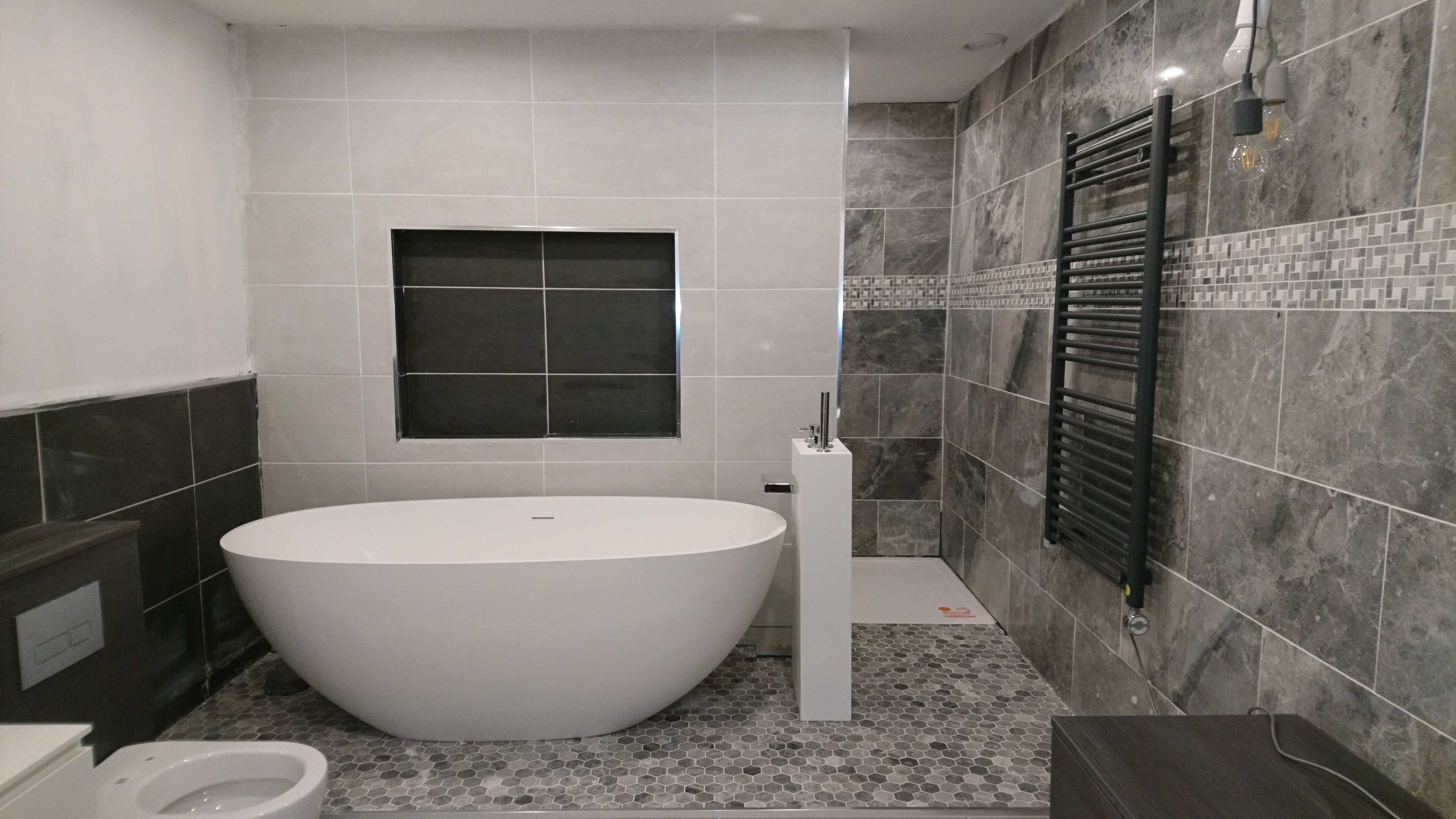

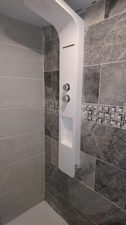

jamiehamy Posted January 10, 2018 Posted January 10, 2018 Okay, I've been putting this off for too long and need to get stuck into it next week to get the first bathroom complete. I've done the walls and fairly happy with the result (The inset to be finished shortly). However, the hex mosaics are troubling me slightly. They are to go on the raised area outlined in red. They are stone. What is the best way to cut them? I have one of these https://www.rubi.com/en/dv-200-1000-electric-cutter-r104 but a trial finds that they are too small really and prone to cracking at the edge. Should I use my angle grinder with diamond wheel in a shallow bath? Will be slow going as I need to trim at least one edge of 'tiles'. How should they be laid to get them as flat as possible? I have mosaic mats - however they are bigger than the 'tile' - and the edges are like the blockbusters board, so should I trim them all slightly small before applying to the back of the tiles and then try lay like normal tiles ensuring they interlock with the right gaps? How do I ensure they a re properly flat and not like the rocky road to Dublin? What order? I'm assuming best to start at the front (nearest the camera) and take my straight edge from that. It's all fairly square I think but any run off would be hidden mostly behind the bath. Trowel - Any special trowel for these ones? Should I aim for a thinner bed for mosaics? I think it's an 8mm notched trowel I'm using at the moment. Adhesive - I'm using BAL Rapid FLex Fibre plus rather than pre-mixed - Topps advised this is best for a large floor area of mosaics. Anything else worth considering or bearing in mind? Hints, tips, pics or encouragment welcome! Thanks, Jamie Thanks, Jamie @Nickfromwales - tagging you as per other thread somewhere else! 1
nod Posted January 10, 2018 Posted January 10, 2018 I’ve the dust free Robi cutter great for cutting slabs We normally use a small angle grinder With a diamond blade 4 inch if you get the continuous blade Not the ones with the cuts in You’ll find you can do quite intricate cuts If the pieces your cutting are very small it’s worth wearing an anti cut glove one hand 1
jfb Posted January 10, 2018 Posted January 10, 2018 i wouldn't use a shallow bath for cutting the tiles unless it was a petrol cutter - just do it dry and make sure the wind is going the right way. put some tape over where you are going to cut to help stop cracking never done hexagonal tiles so don't have any special advice for them! 1
Tennentslager Posted January 10, 2018 Posted January 10, 2018 Never done it with little tiles Jamie but a bench grinder is cheap and great for accurate lines. Depends how beautiful you want it to be? Job looking great so far? 1

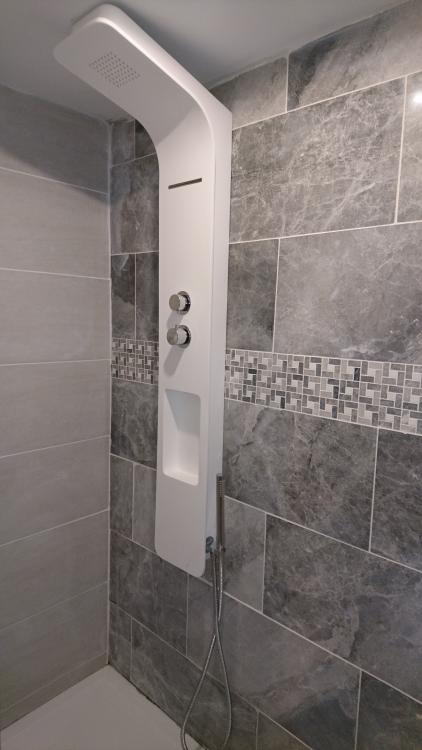

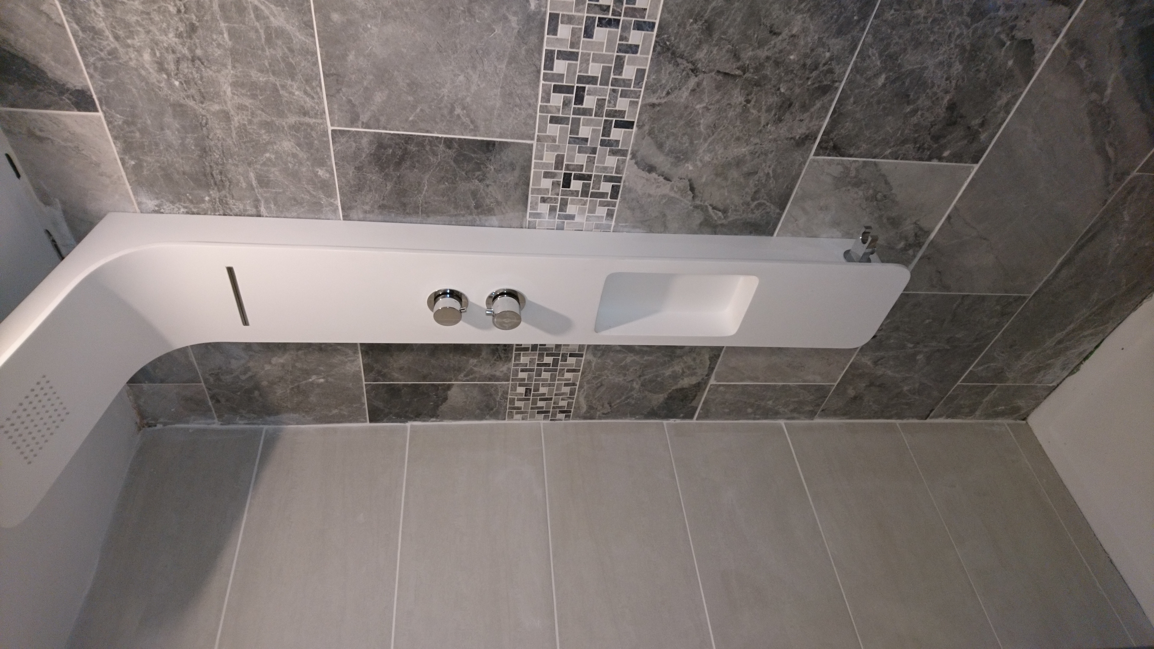

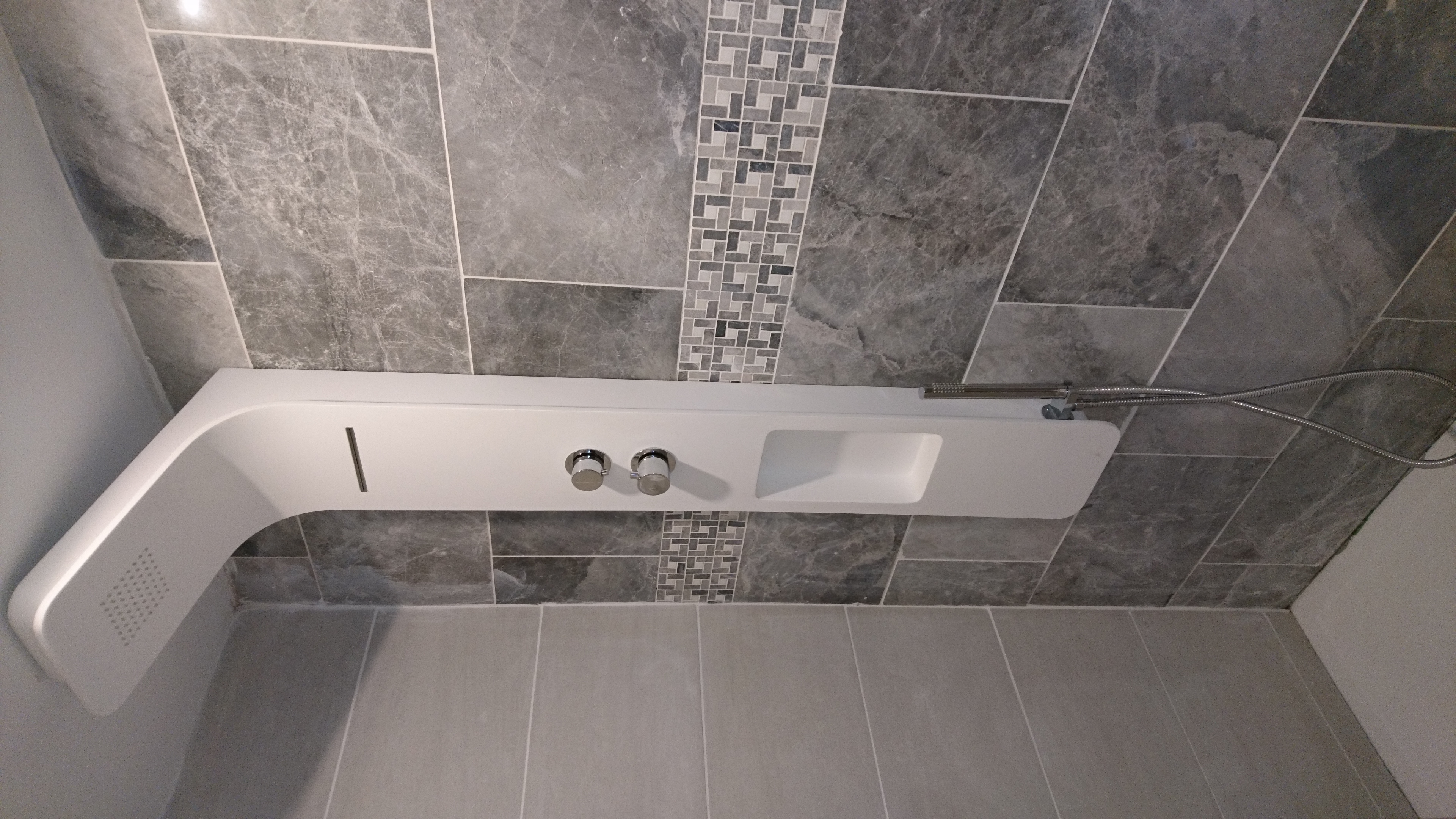

jamiehamy Posted January 23, 2018 Author Posted January 23, 2018 Okay, tiling done. Only two bathrooms to go, but that's us ready for when we move in (planning March). Hex tiles I cut with a diamond grinder. I taped the line I wanted, scored lightly with the grinder right along before then grinding slowly each hex. I used mosaic mats which helped keep them flat nicely. I've got some Ct1 to put round the shower tray and paint two walls, then do a final fit/tighten on everything. This has been quite simply the toughest job of the whole build by far. Looks easy but got to think in 4 dimensions almost, cutting,mixing,laying,grouting ,sealing... We're pretty pleased with it tho. 2
Nickfromwales Posted January 23, 2018 Posted January 23, 2018 I knew if I forgot to give you any tips you'd get better quicker Looks great, and nice feature with the walk in corridor shower. What size is the tray ?

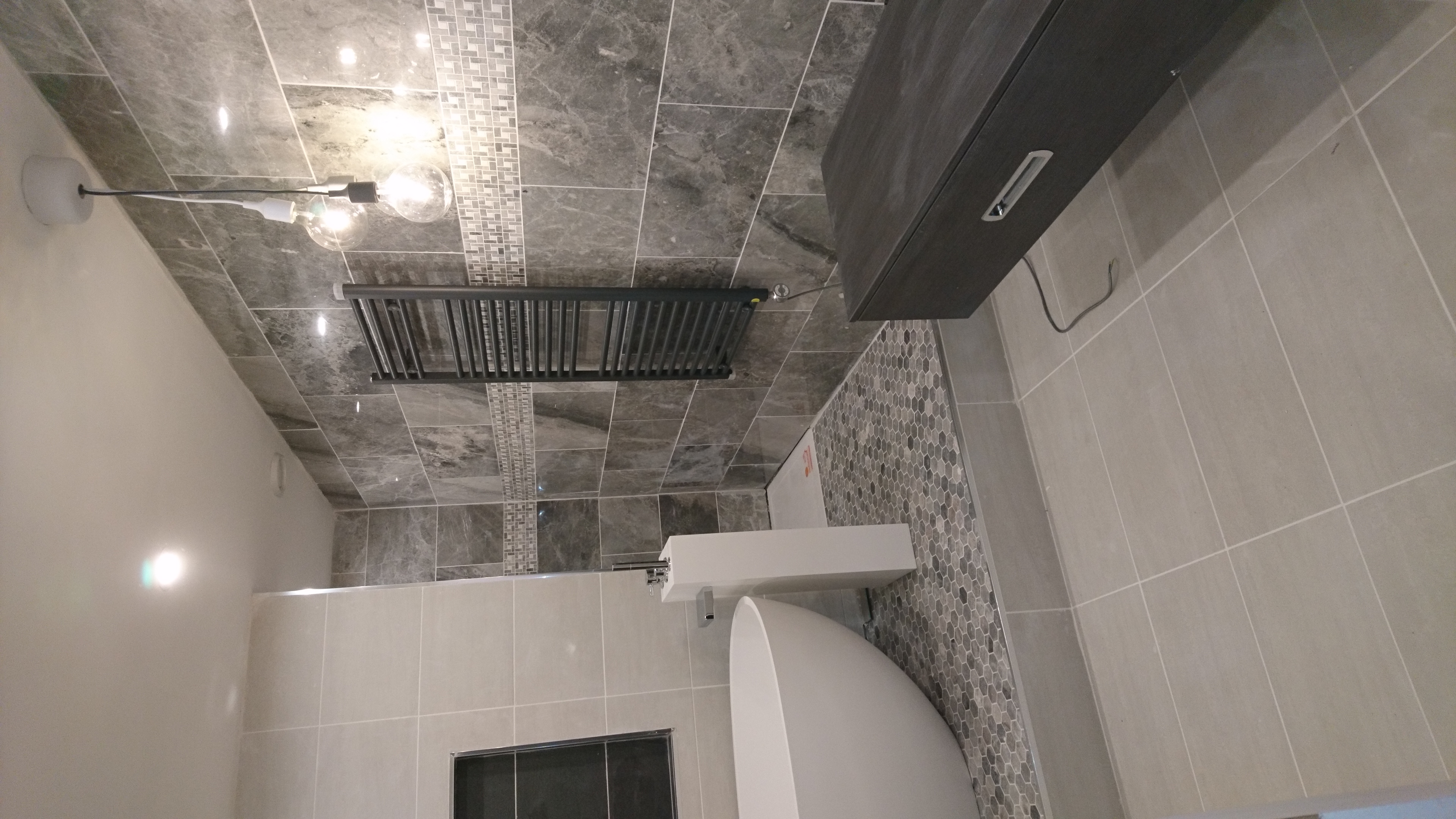

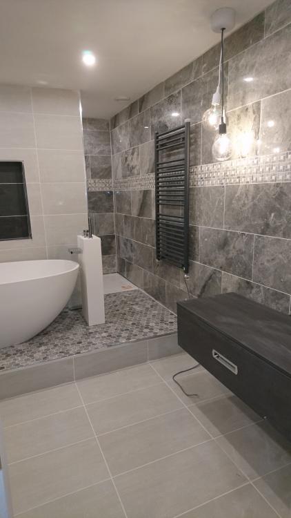

Barney12 Posted January 24, 2018 Posted January 24, 2018 That really is very smart. The Matt black electric radiator is a welcome change from shiny chrome. Can I ask the source? Is that a light fitting to its right? Or have you got the worlds smartest festoon site lighting?
jamiehamy Posted January 24, 2018 Author Posted January 24, 2018 8 hours ago, Nickfromwales said: I knew if I forgot to give you any tips you'd get better quicker Looks great, and nice feature with the walk in corridor shower. What size is the tray ? :-) It's 1200x900.
jamiehamy Posted January 24, 2018 Author Posted January 24, 2018 8 minutes ago, Barney12 said: That really is very smart. The Matt black electric radiator is a welcome change from shiny chrome. Can I ask the source? Is that a light fitting to its right? Or have you got the worlds smartest festoon site lighting? Thanks! I'll check with Craig, he ordered the rad. We have one for our ensuite in Matt White which is really nice. Yeah, light on right - there are bigger bulbs for it to go on later, again, other half ordered it. You can see a pattern here! He orders the nice stuff, I fit it!
Onoff Posted January 24, 2018 Posted January 24, 2018 What are the two "slots" where the wall tiles meet the ceiling behind the shower?
Nickfromwales Posted January 24, 2018 Posted January 24, 2018 51 minutes ago, Onoff said: What are the two "slots" where the wall tiles meet the ceiling behind the shower? Mvhr extract ?

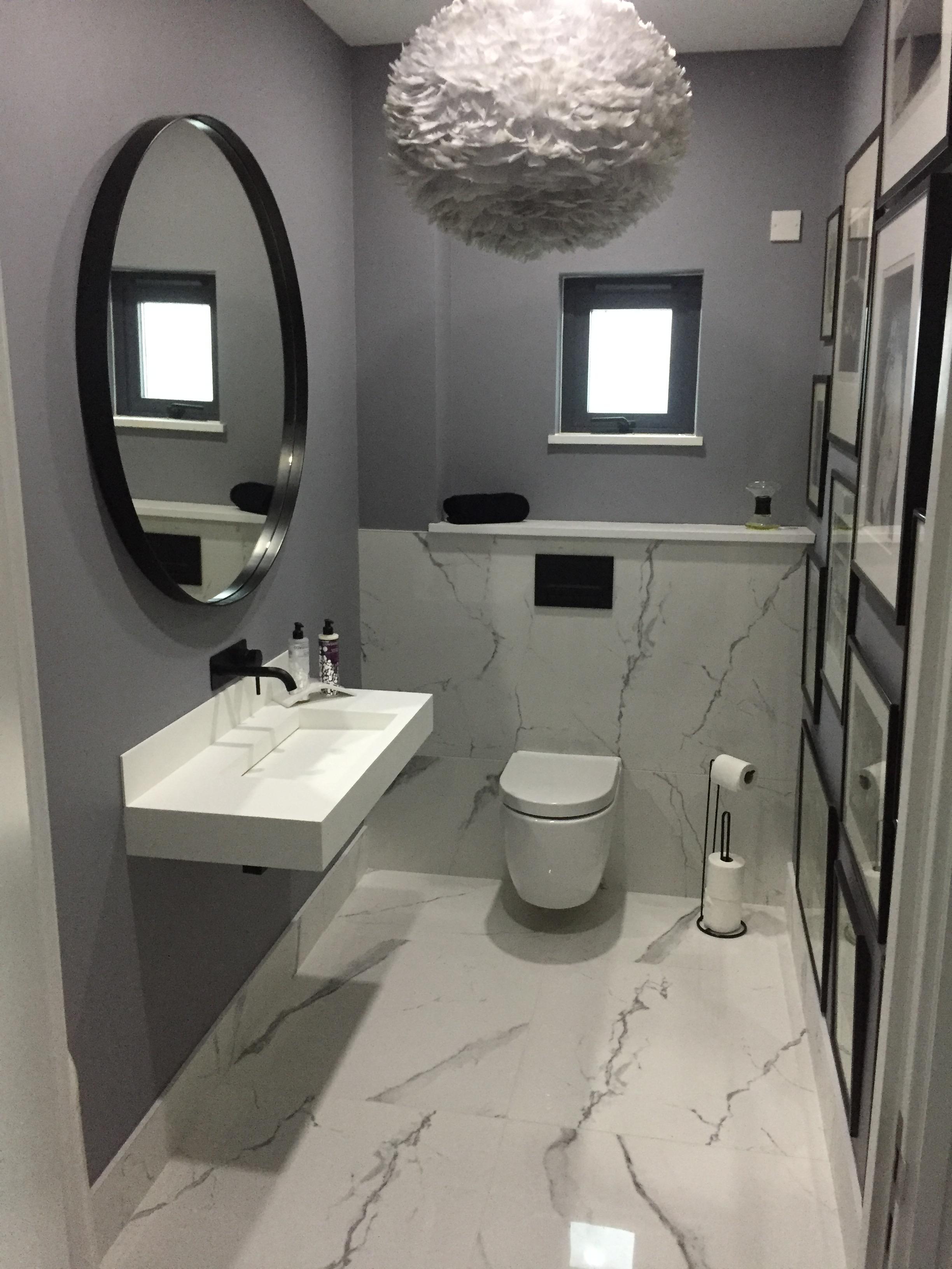

Nickfromwales Posted January 24, 2018 Posted January 24, 2018 1 hour ago, Barney12 said: The Matt black electric radiator is a welcome change from shiny chrome. Agreed, looks uber smart. This is the last one ( that took my arm ? ). Matt black flush plate, trap and tap to go with pic frames, mirror etc. Not bad considering I tiled that with one arm ?. 750x750mm too. I think we'll see a lot more of the black this year. ? 1
Onoff Posted January 24, 2018 Posted January 24, 2018 59 minutes ago, Nickfromwales said: Mvhr extract ? Matches the slot in the shower if so...
jamiehamy Posted January 24, 2018 Author Posted January 24, 2018 10 hours ago, Onoff said: Matches the slot in the shower if so... Ahem, it's gone now... Nothing gets past the Build hub wolf pack! I'd cut the tile a bit short! 1
jamiehamy Posted January 24, 2018 Author Posted January 24, 2018 (edited) Towel rails are Milano Brook,reasonably priced. The lights are Muuto. You an see them better now with the big bulbs. They are on a separate circuit from the downlights and cast a gentle light when in the bath. Edited January 24, 2018 by jamiehamy Typo
