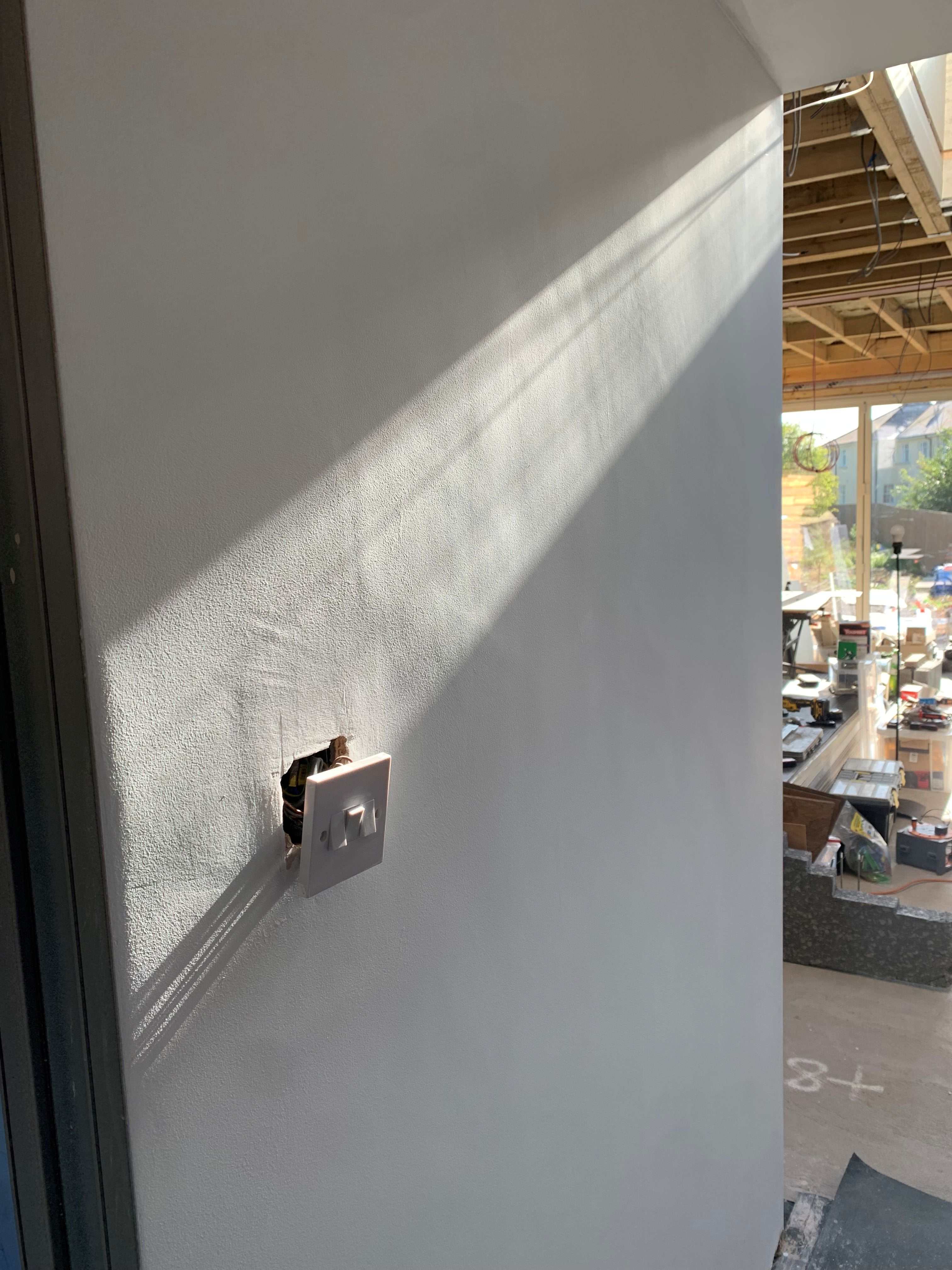

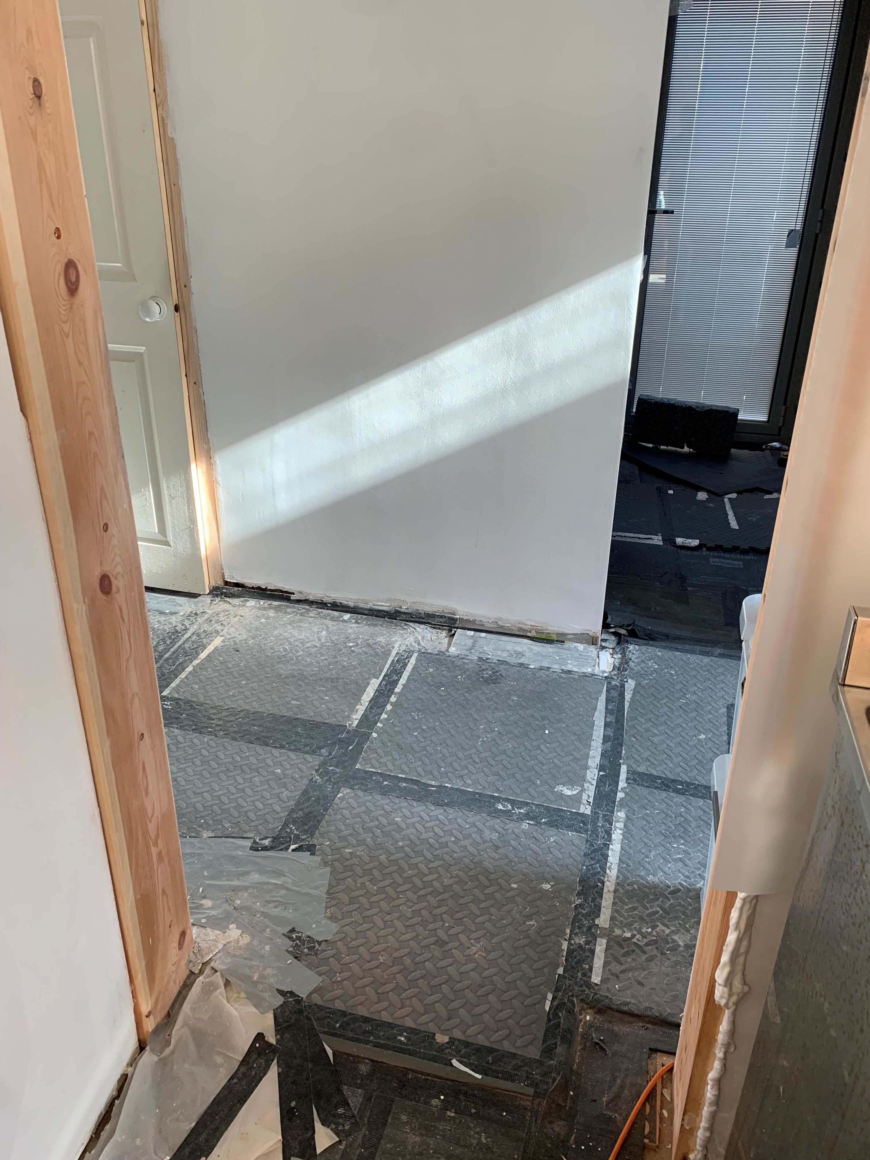

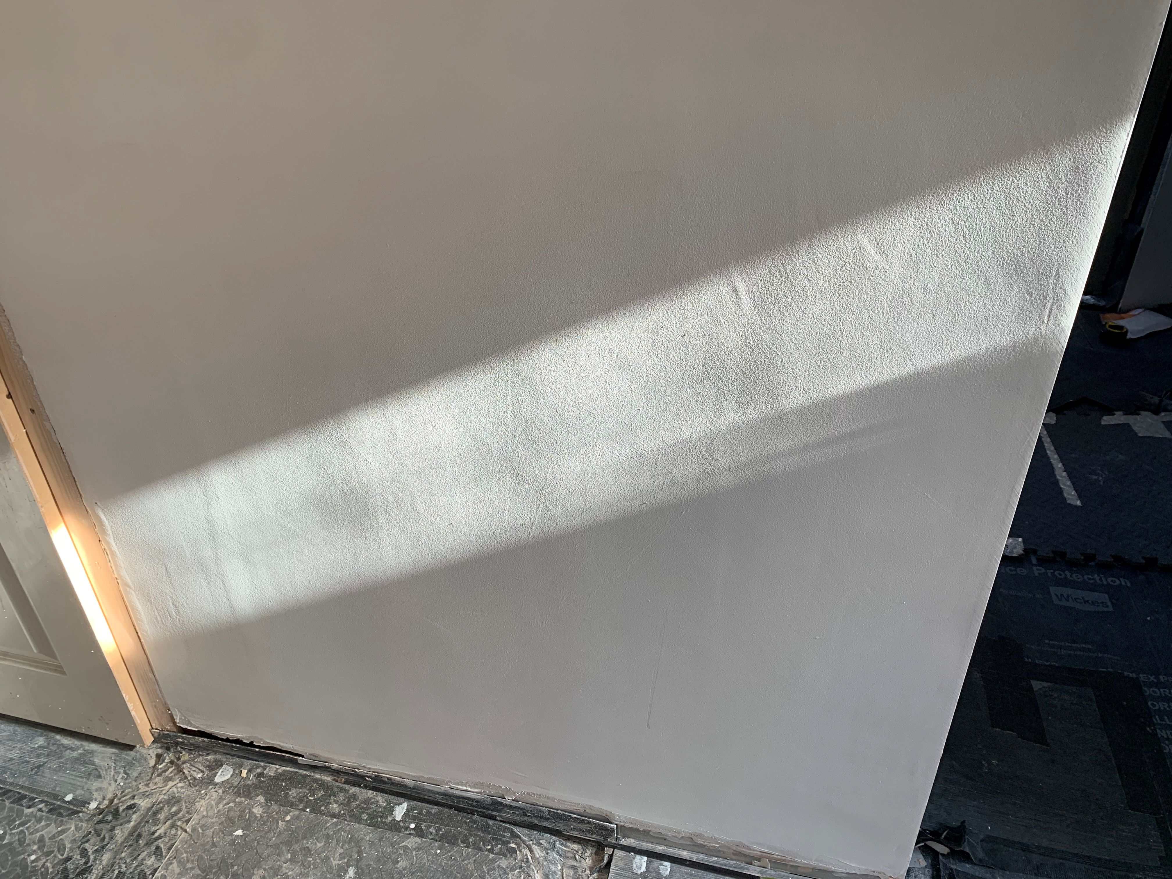

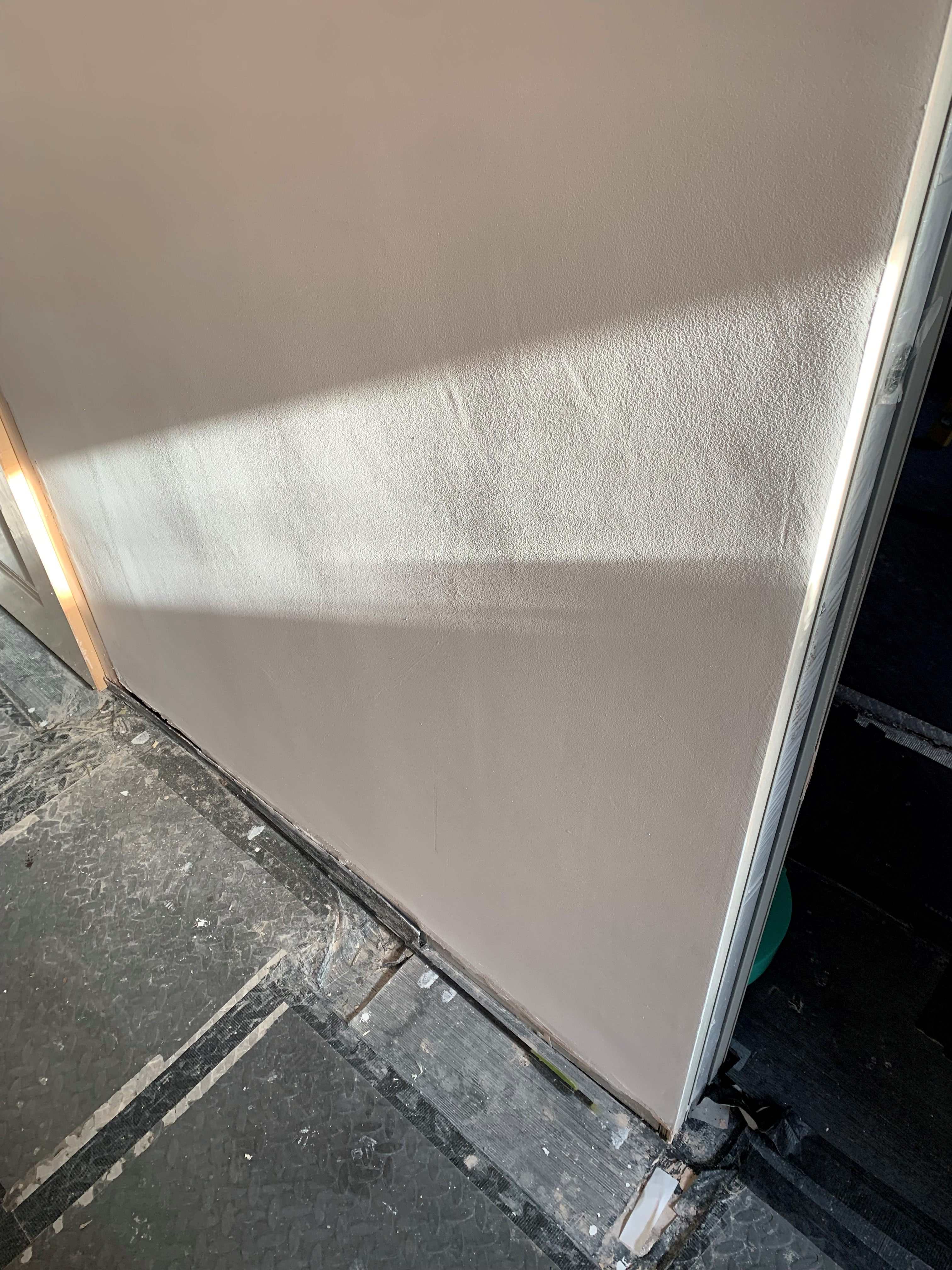

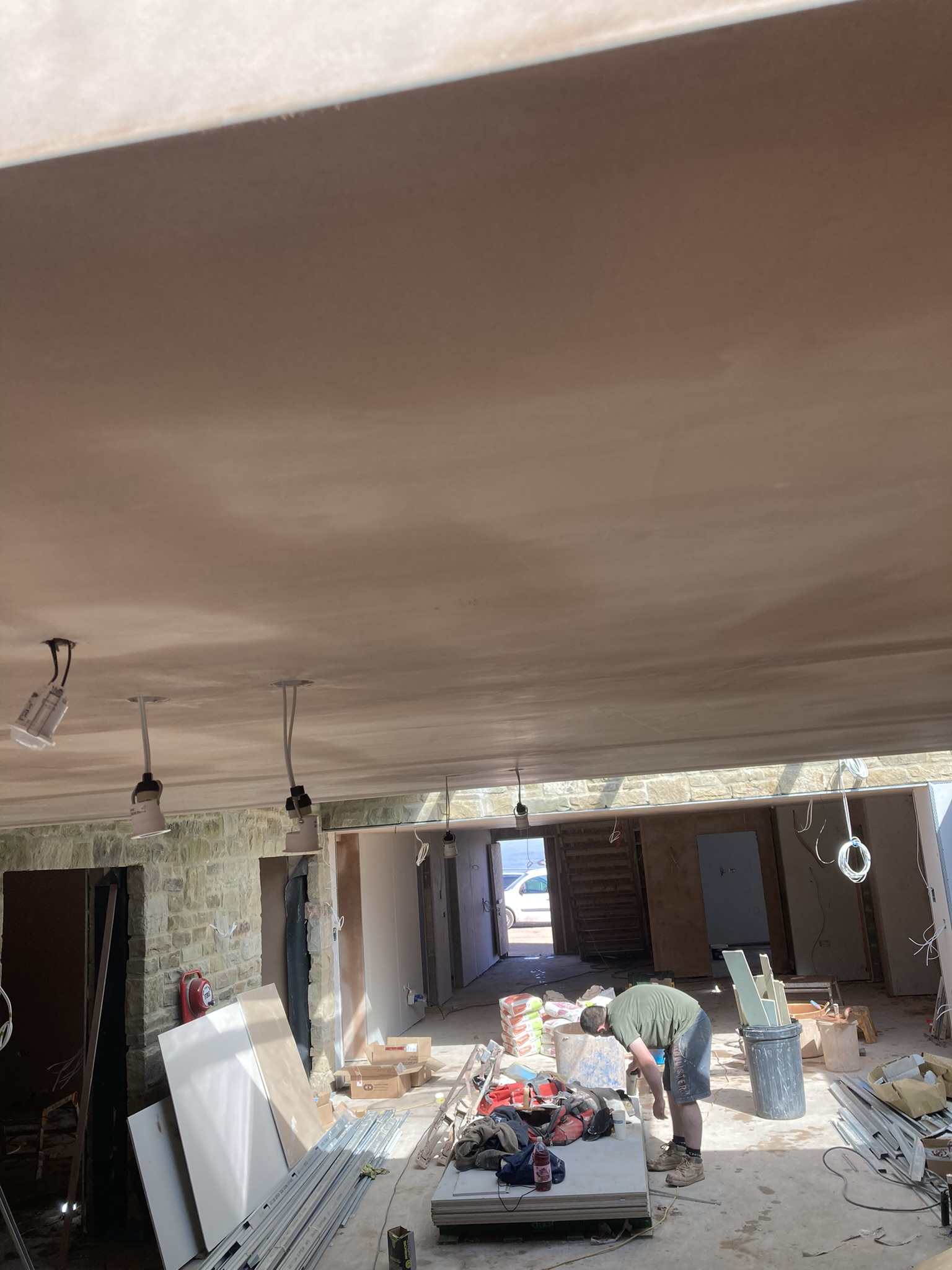

So what type and standard of decorating is needed to deal with shafts of sunlight onto walls ?
This is just mist coated at present and looks and feels to the touch perfectly fine in ordinary light. However once the sunlight shines across it flaws and almost vertical striations show up.
Will this disappear when painted ? Is something particular required to get a good finish ?
Decor1.thumb.jpg.1823196a3a6cbae08b46c080bbf56935.jpgDecor2.thumb.jpg.ef53d93eb0bee991da592c93c61b9cf6.jpgDecor3.thumb.jpg.647cdd8b38d5f19570b7255dabd515ae.jpgDecor4.thumb.jpg.f1ba5a140c35b9264bb14d0892621944.jpg

I've heard it called a level 5 plaster finish though I'm not sure that's entirely the right term in the UK. It's done at the plastering stage not painting stage, though I'd guess you could do a lot of sanding to get there.

We have almost the identical situation on a large wall high up in a double-height section in our kitchen.
My best guess (based on our experience) is that it will be exactly the same when you paint it.
I doubt you'll be able to completely sort it, but you could try some judicious sanding with a long, flat sanding block to knock the high spots off, followed by careful application of scraped on filler with a wide trowel to fill any low bits.
The affected wall in my house is almost east-west, with a large window to the east. In our case, there's only a short period - a few minutes, I guess - on sunny mornings in Autumn where this effect is visible. We decided it wasn't worth trying to do anything about.

Pole sanding will be your friend.
Apply about 5 generous coats of Leyland high opacity Matt white paint and leave to dry for a week.
Then when you sand, the paint acts as a surface filler.
You’ll almost instantly see plaster pop through here and there, where the highest of high points are, and you just then avoid those thereafter.
The more you repeat this process, the better it’ll get.
Don’t sand in one place, you need to do long random strokes.
Good news is you only really see this where the sun is an enemy and not a friend.

Can i be honest. I would be dissapointed if that was the finish that my plasterer left for me. I'd be putting a coat of easy fill over that. Then a large rotary sander with a very fine grit paper to get it better than what it is now. Sorry, if i'm the odd One out.

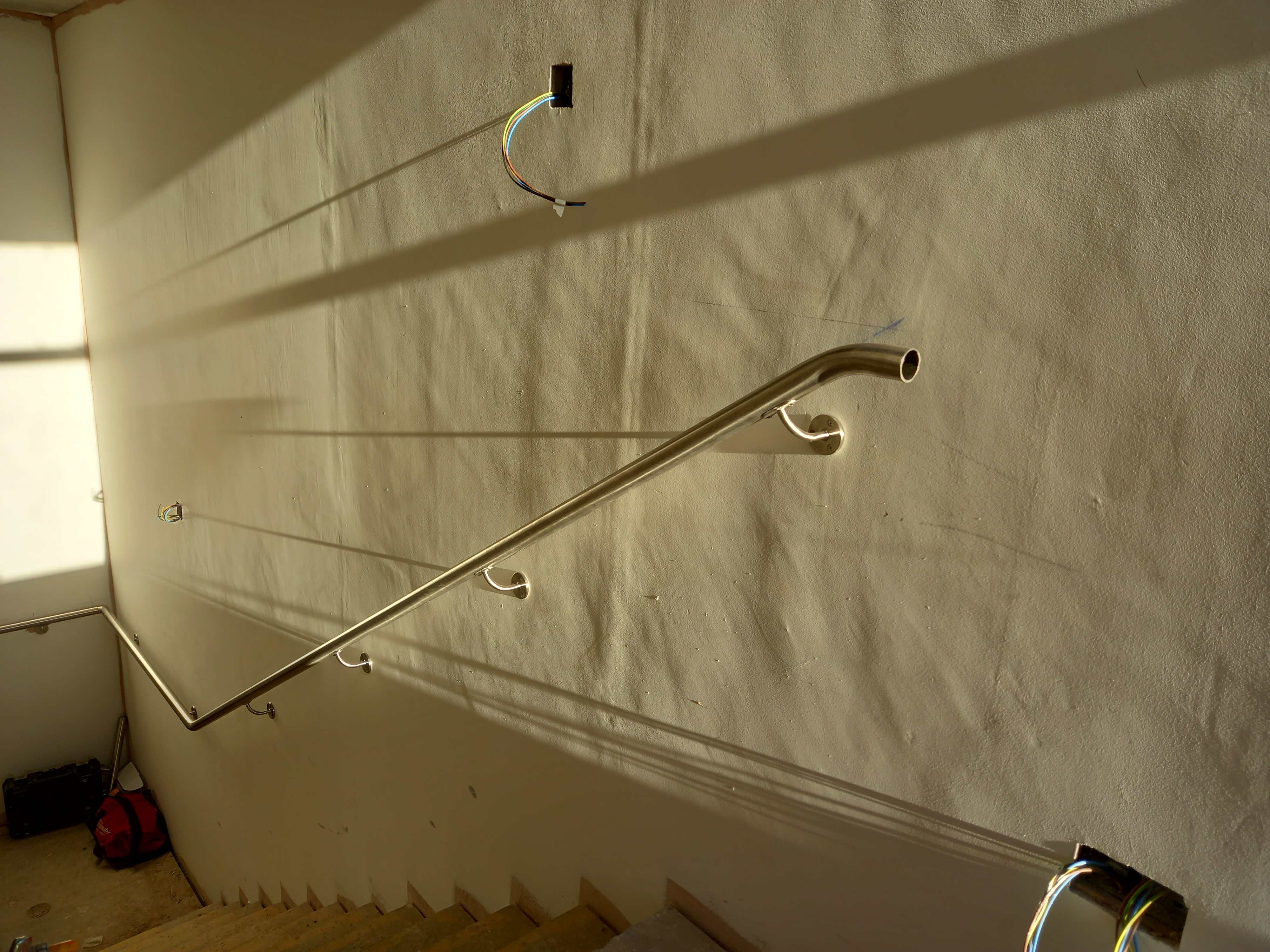

What about this one i seen on a job the other year. It did catch the sun but my God it was rough. 20221215_102914.thumb.jpg.8f2d3d602e2694def90acfdcc53cf7a8.jpg

The big boys get their agents to go round with a bit of copper tube, shine torches up the wall right on the angle and they draw on the wall with the copper all the rough bits. Then a man comes with easy fill and a cordless big makita disc sander and puts it right. It's literally a process of the build with the state of some of the site plastering. Called patchers. Round my way the plastering firms also do the decorating so there's no quibbles about who's job it is. Perhaps @nod does similar?
Posted
It’s really poor skimming Looks like it’s been done with a silly flexi float or speed skim It should be closed off and flat
Heres one I did earlier
It should look and feel flat before it’s mist coated
I've seen better rendering outside ffs.
That's total dogshit.
If those handrail brackets stand off 100mm and their shadow is 2000mm, the shadow exaggerates the imperfections 20 times, so a 1mm deviation or lump shows as if it is 20mm.  I don't think anyone could get this looking good with that light.
Excellent point.
You also see it with the slimmer, perhaps 10mm deep circular plates on the inside of the handrails against the wall. Their shadows extend perhaps 200mm down the wall.

High opacity paint (specifically designed for new plaster) can be pole sanded with relative ease.
I always say to start with a good obliteration, so maybe 2 coats sprayed or 3-4 coats by roller, and then pole sand it back.
Then coat again to cover the bits of plaster that breaks through, on the high points, and examine the wall again (in areas where it matters) and this will yield great results off the bat without getting the filler out.
You use the HO paint as a surface filler, and it’s quite chalky, which gets you to the pint where you can see if filler is actually necessary.
Beware aggressive sanding methods, as they’ll send you backwards not forwards, gouging and troughing the surface making it worse than when you started.
