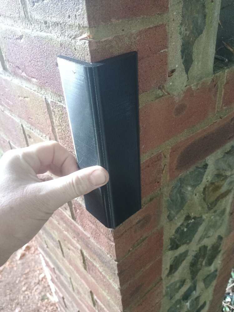

Onoff Posted October 10, 2025 Posted October 10, 2025 Used Everbuild Sika Multi Stick to stick 3D printed, TPU corner protectors onto my gate pillars:
