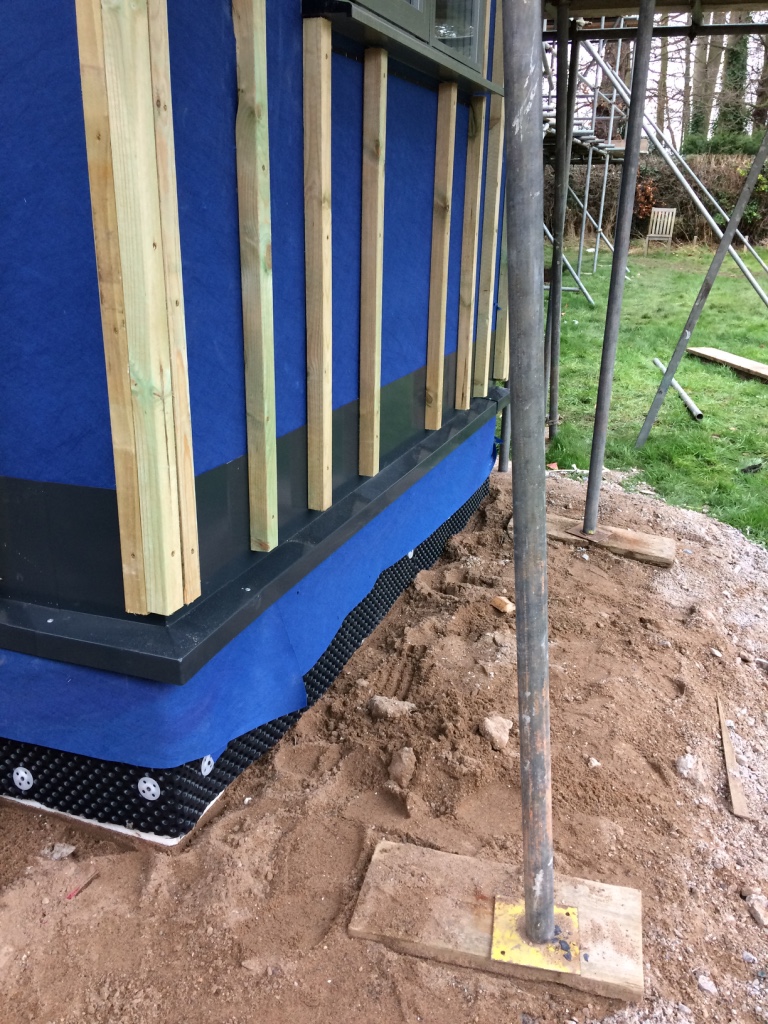

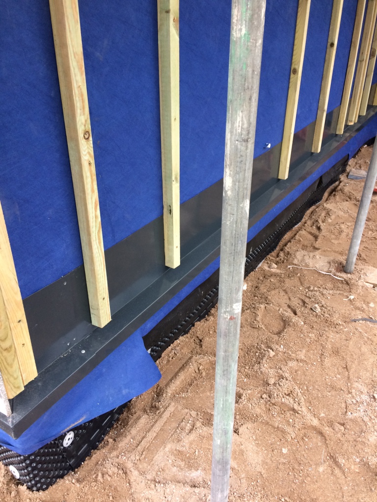

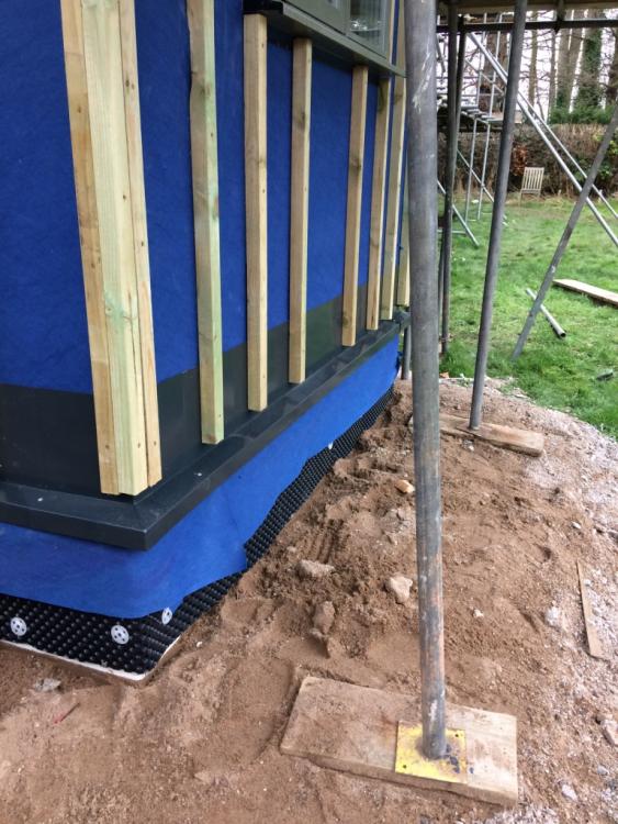

Scotrock Posted January 9, 2018 Posted January 9, 2018 (edited) Good morning all, I am building a house with a frame supplied by MBC Timberframe. I have been very impressed with the service so far. We are not finished yet although the frame is up and my windows and doors are in. Roof covering is also on and the render guys are on site at the moment. We are using Parex rendering by the way. I also had MBC install a passive slab and this made me thing about how to finish the works below ground and up to what will be my finished ground level. if I was building with block/brick i would have installed several courses of them agains the insulation. But since we don't have conventional trench foundations that isn't ideal. The passive slab sits on hard EPS insulation as you probably know. I asked Peter Gray who is my project manager at MBC if he had any suggestions and he told me about a previous installation he had designed for a client. I involves fabricating a trim of powder coated aluminium which is attached to the bottom of the frame with a layer of Geotex waterproof membrane protecting the EPS as this is below ground level. Peter was very helpful, sent me a drawing of it and talked me through the process. I had a local fabrication firm (Barnett Engineering in North Wales) make up the metal. They also made me a selection of inside and outside corners which neaten up the corner element of the trims. The cost of the metal came to just over 2K. I applied the Geotex to the outside of the EPS and then attached the metal trim to the bottom of the frame which was very straightforward to do. I have attached some pics and I hope that this might be of interest to others who are self building! The battens in the pics are the carriers for the render board. if you have any questions, I would be happy to help, and I'm sure Peter would be too. Derek Edited January 9, 2018 by Scotrock spelling! 2 4

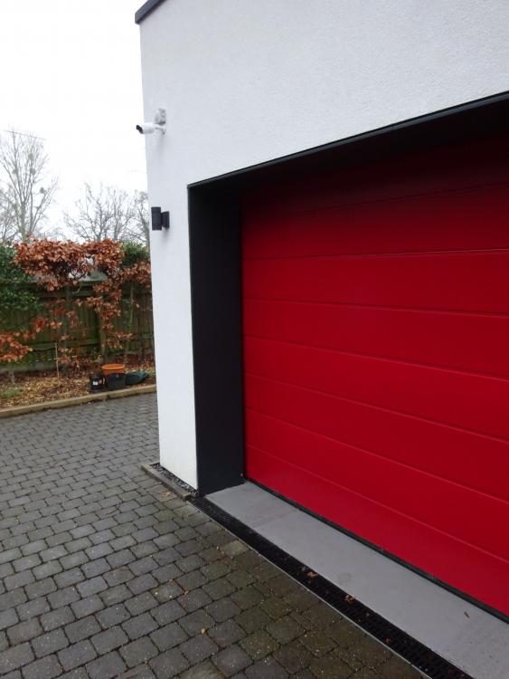

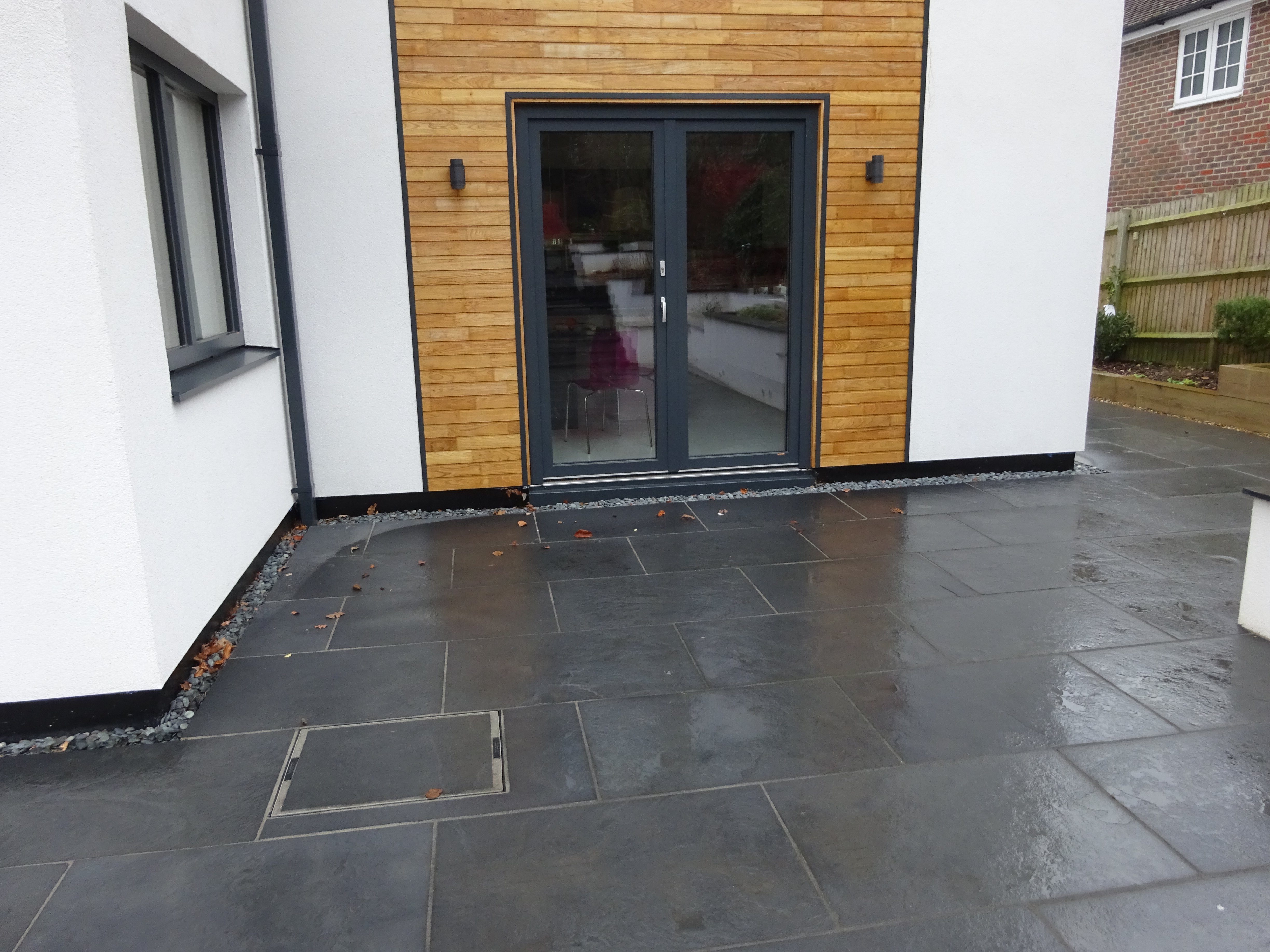

lizzie Posted January 9, 2018 Posted January 9, 2018 Derek, Peter Gray is my project manager and the powder coated trim you referto was on my build. Where is your house?
Scotrock Posted January 9, 2018 Author Posted January 9, 2018 Hi Lizzie My build is just outside Wrexham. Where are you building? We better be careful here.....Peter will be thinking of patenting this solution ?. I only wish I had thought to specify that it is finished in matt powder coat rather than gloss, which seems to be the default finish at my metalworkers. Still, it is a very good solution and my renderers are impressed with it, as am I. Derek

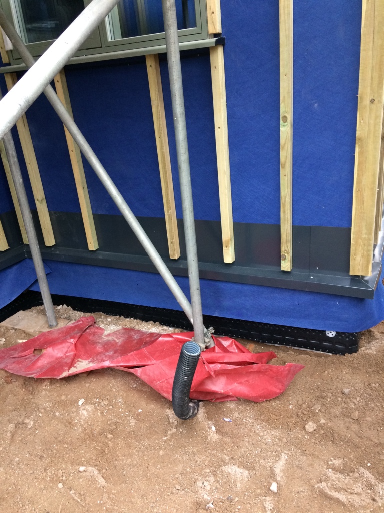

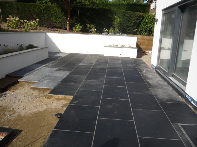

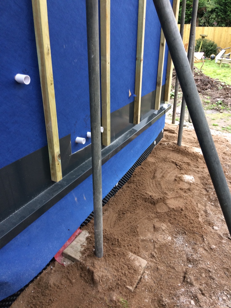

HerbJ Posted January 9, 2018 Posted January 9, 2018 Great job -this is a very well considered detail and I wish I had seen it a couple of years ago when I was building my MBC house. I did ask around at the time and received various ideas. In the end I developed my own approach as follows: I installed an 300mm alumium flashing, it was actually the black powder coated aluminium roll used for seamless gutters but rolled as straight pieces with a seam rolled seam for strength. It seems to have worked out well - it is screwed and stuck to the EPS It was installed to form a flashing from underneath the external rendered finish , going across the soles plate and over the EPS to well below the nominal DPC level at which the extermal paving is installed. See the phot os attached, which should give you an idea. I had this flashiing made by the company that supplied and installed my seamless gutters, but they seem to be no longer installing seamless gutters and are concentrating on aluminium pressings , etc. I had some special aluminium flashings, coated to match the window frames, made for below the french windows/doors, ariund the garage doors etc. I attach some photos, during construction (though it at that stage still covered/protected by the blue external wrapping sheath used by MBC to keep render and other rubbish off the coating the flashing) and some taken today, to show the finished look. T 4

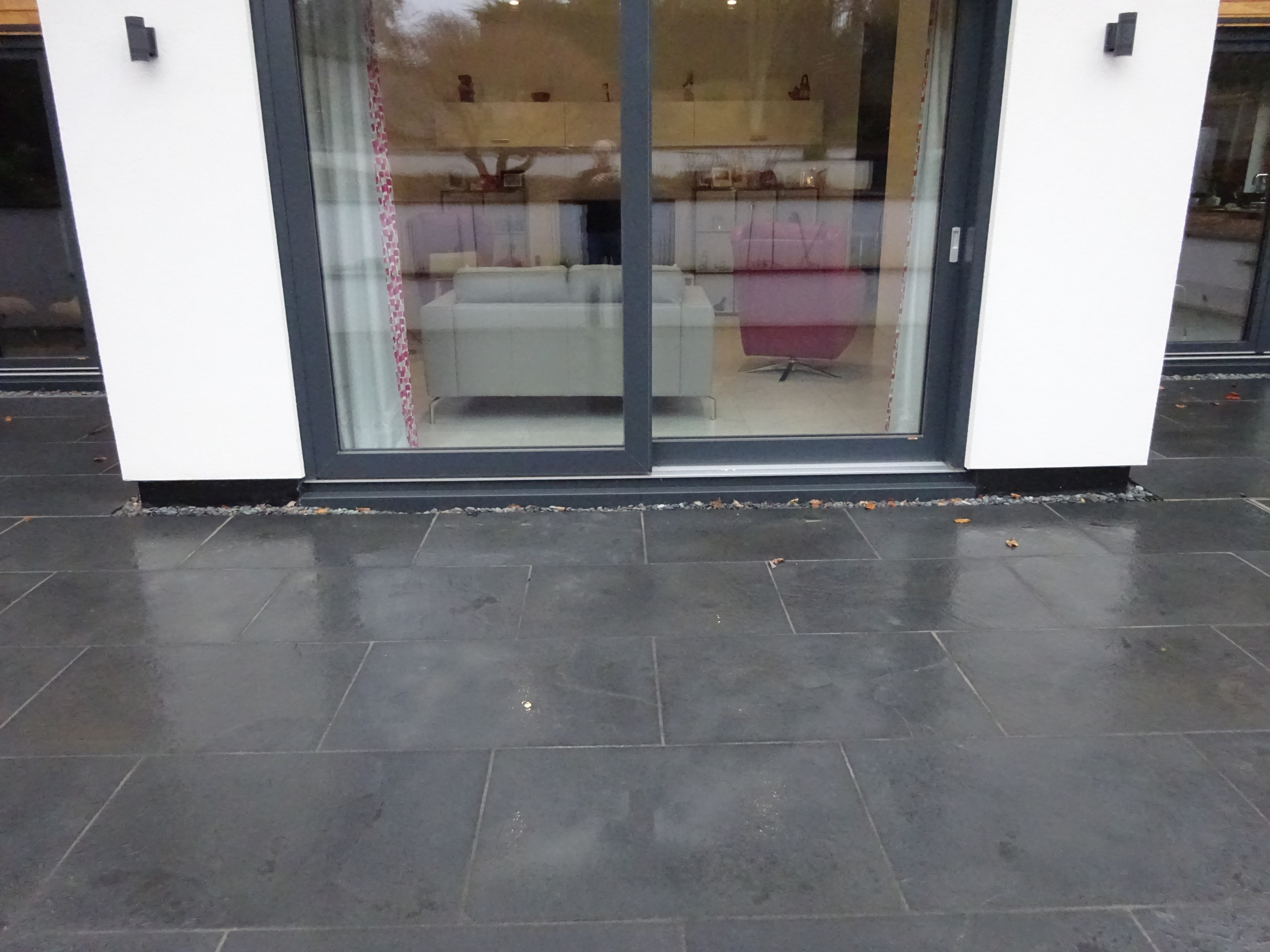

lizzie Posted January 9, 2018 Posted January 9, 2018 On 09/01/2018 at 12:31, Scotrock said: Hi Lizzie My build is just outside Wrexham. Where are you building? We better be careful here.....Peter will be thinking of patenting this solution ?. I only wish I had thought to specify that it is finished in matt powder coat rather than gloss, which seems to be the default finish at my metalworkers. Still, it is a very good solution and my renderers are impressed with it, as am I. Derek Expand Ha ha I think Peter will be alive to possibilities, he is no slouch! There was much debate before finally settling on this as a solution and it works well enough. We did get ours done in a matt finish I was very clear no gloss on anything, think you are right about gloss being default, we are very modern style and gloss would have been wrong for us. Ours looks to be deeper over the EPS than yours it goes down quite a way and yours perhaps higher up the wall. We are part render (alumasc) and part larch clad with internorm 3g aliclad windows and doors. Did you only have Peter helping you for MBC for that part of your build, are you going it alone for the rest? We have been at it nigh on 2 years now and you look more finished than we do LOL We had a lot of issues to get past. Still getting there on some things but light beginning to appear at the end of the very long tunnel. We are on the Warwks/Worcs border near Stratford upon Avon. On the top of the Ridgeway with clear views across nearly 40 miles to the Malvern Hills and home beyond - I am Welsh but South, don’t know your part of the world at all Derek. Kitchen fitting going on at the mo but outside is a nightmare of mud, groundworks not finished yet. 3
Scotrock Posted January 22, 2018 Author Posted January 22, 2018 Hi Lizzie, Looks super. Ours is a cottage look on the outside. We still have to back fill around the house to get back up to ground level so that's why it might look higher right now. Peter only got involved just before MBC laid the passive slab. We had been dealing with Keith in the UK and David in Ireland beforehand. I have been pleased with our timing. We started demolishing the old house on Aug 5 last year. The site was ready for MBC by end August/early Sept. They arrived on Oct 3 to lay the slab and started to erect the house on Oct 17. Since then I have been concentrating on the outside first - slates on, windows in etc. MVHR ducting is in now and all wall penetrations have been made. Render should be finished this week, then temporary guttering can come down for fascias and soffits, the proper guttering up and At Last, the scaffolding can come down!! And then MBC can return to install the insulation and do the airtightness test After that we're on the inside and remaining groundworks and garden. I am project managing it myself and it does help to be there to keep an eye on things. All the best Derek
Scotrock Posted January 22, 2018 Author Posted January 22, 2018 Hi Herb That looks a very neat build. ? Thanks for posting the pics. Derek

MirandaPoth Posted March 8, 2018 Posted March 8, 2018 Really interesting post everyone! We're about to commit to MBC Timberframe and are just checking up on them so-to-speak. I haven't found a bad word said about them yet, and Derek/Lizzie the solution you've got for finishing around the perimeter looks great. Thanks very much for posting details, we will most likely do the same. Can I be cheeky and ask which windows you chose? We're going for the same look as in these pics and are interested in other people's experiences of window firms ...

MikeSharp01 Posted March 9, 2018 Posted March 9, 2018 Those trims look realy good @Scotrock how did the joins work. Were they welded / lapped and sealed somehow or was the underlying geo membrane doing the waterproofing at the seams?
