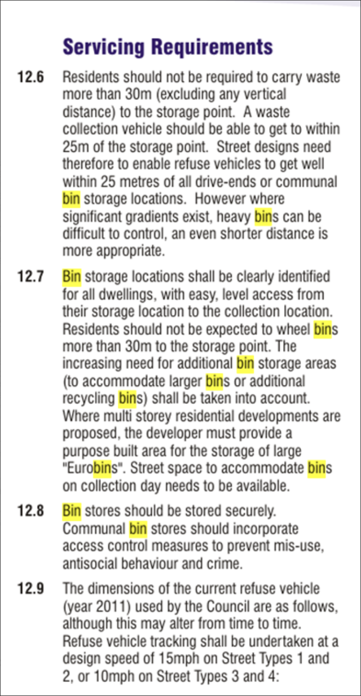

ProDave Posted January 21 Posted January 21 I don't get this bin storage lark. Our bin store is round the back of the house, where it is convenient for us to put rubbish from the house into them. The night before bin day, we wheel the approporiate bin to the front of the house and place it adjacent to the road for collection, then bring it back afterwards. I don't see what relevance this is to the planners where your bins reside when not awaiting collection?
-rick- Posted January 21 Posted January 21 4 minutes ago, ProDave said: I don't get this bin storage lark. ... I don't see what relevance this is to the planners where your bins reside when not awaiting collection? As the number of bins we need goes up the amount of space available to store them becomes a problem. While you both have the room and are concientious plenty of others either can't be arsed or space is an issue and that leads to bins being left in the street. I'd also guess that plenty of 'disgusted of Tunbridge Wells' type complaints about how unsightly bins are even if they aren't cluttering up the pavement. One of those rules that matters greatly to a small plot in a city but seems a bit overkill on a large plot.
Russell griffiths Posted January 21 Posted January 21 It’s 240m from my front door to the bin collection point, why does it matter where they are kept. it’s all this bollox that makes this country an utter shambles.
Oz07 Posted January 21 Posted January 21 As I've said before on here I nearly come a cropper with this. Looked at a plot down narrow drive over 90m long. I don't even think you can mitigate with sprinkler over this length. I left it for the vendor to get me in writing off building control that they would approve. They never did and the plot is still for sale. Don't assume bco will sign it off because planners said ok. Bco is technical and concerned with safety, planners aren't. It's a lot of money to spend to fall at final hurdle.
Cheesus Posted January 21 Author Posted January 21 (edited) Appreciate the feedback on both points. Firstly, reference bins - this is the relevent part of local planning policy I am told: With regards to fire engine access, this is the (fairly) recent application that was approved: https://planning.wakefield.gov.uk/online-applications/simpleSearchResults.do?action=firstPage Below is copied and pasted from the decision notice (I understand the manual for streets remains unchanged in relation to this): It is also noted that the proposed dwelling would be around 74m from the public highway and exceeds the recommended pumping and carrying distances for a fire appliance/refuse vehicle. The submitted highway statement states that it is proposed to install a fire sprinkler system within the new dwelling to negate the need for a large fire appliance to access the site. This satisfies the requirements in manual for streets. As noted with regards to outline consent 13/01088/OUT, it is recommended that this be secured by condition. Google earth shows this house as now built, obviously we don't know if there are any ongoing issues with BCO or not. Edited January 21 by Cheesus

Cheesus Posted Thursday at 19:19 Author Posted Thursday at 19:19 As promised, we now have the pre planning consultation report - mitigation for the lack of fire engine access by way of a sprinker system is fine. The sticking point is the wheelie bin access though..... I am waiting for my planning man to come back with a plan of action. All other aspects of the provisional application were fine with the slight amendment needed to a window. There is room for a bin on the access road but we don't own the road so not sure if this is an option. The report: The Highways Officer has advised that there is a need to ensure that fire and rescue appliances can get within 45m of the proposed front door – the proposal to install a fire sprinkler system in lieu of suitable access is considered acceptable. Consideration must be given to arrangements for refuse collection. The site is located approximately 85m from the adopted highway, and the bin pull distance would exceed the lengths recommended in Section 2.27.02 of the RDG Pt 1 (45m) or Section 12.7 of the Street Design Guidance (residents should not be expected to wheel bins more than 30m from the storage point). There does not appear to be room within the access road for a convenient bin storage area, nor is there room within the access for a Council waste collection vehicle (the 11.2m Phoenix 2 Duo) to reach the site in a forward gear and then turn to allow access onto xxxx in a forward gear. It is noted that the existing collection arrangements for the properties at nos xx and xx xxxx also exceed the recommended pull distances for refuse bins, however this would not in and of itself present a suitable justification for the proposed arrangement – these dwellings were erected prior to the adoption of the relevant standards and requirements.
