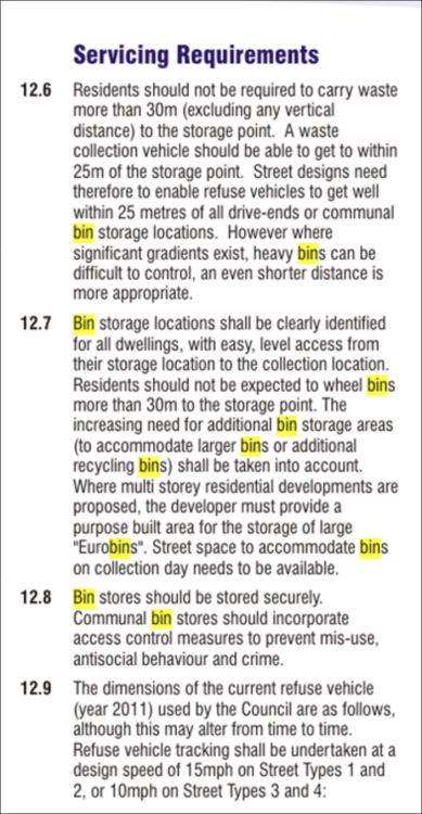

I expect there is a much simpler solution to this but I've seen someone on youtube build little motorised trolleys for their bins to take them out front. If you get stuck on this then something to consider.
Having said that the one I've seen was based on a guide track and simple motors. If you don't own the road and can't alter it then you'd need something more sophisticated (and the more sophisticated the more difficult I guess it would be to get approval).
I'd guess all you need is for something to make it easier for a less able person to move the bin.

    Just to give those who have contributed to the thread an update - we have proposed to the council we would make good potholes in the unmaid road and provide a electric cart & charger and this was

Thanks, the MasterMover looks like it could fit the bill. No idea how the planning office would police it, we're hoping to self build and would be more than happy to drag the bins ourself but I suppose we can have one if it's the difference between getting planning or not.
Just to add a bit more context, this was the emial exchange that followed the report:
Highways have come back with the following:
“Specifically on the bins, it wouldn’t be a “Highway Safety” reason, I’m not sure we could back it up sufficiently if challenged at appeal.
It is however a major amenity issue and possibly discriminatory for those with disabilities. The applicant’s proposal that residents can just drag the bins 80+ metres is heavily reliant on the person being physically able to do so; essentially a restriction for the dwelling to only be available for those who are fully able-bodied. Even then it would still be inconvenient.”
I would be minded to agree with that position. Whilst the proposal would not be severely harmful to highways safety contra to Para 116 of the NPPF, I do think there would be grounds for a recommendation of refusal on the basis that the bin pull distance would be very inconvenient and contrary to Section 2.27.02 of the RDG (Pt 1), Section 12.6 of the SDG and Policy LP56(j).
Based on what they say, maybe it would be sufficient to provide storage space/charging connection for an electric assistance device to move the bins, without actually committing to purchase one?
Yeah, that's what I'm thinking. It's the only issue / potential issue against the development so hopefully some mitigation would get us over the line. It's not like there are other issues and it would be the straw that broke the camels back so to speak. I appreciate your help, we'll explore the possibility of looking to design something and incorporate as and when the time comes for our application.

Thanks for all the comments, I am waiting for my planning consultant to come back to me but is it generally possible to build a bin store on the small grass verge that borders the access road? Around halfway down the track there is a grit box at the side of the road, up against a wall - whilst there is no footpath as such down the unadopted road and it is a dead end I can't see us being allowed to stick our bins there however nice the store we build looks?

Just to give those who have contributed to the thread an update - we have proposed to the council we would make good potholes in the unmaid road and provide a electric cart & charger and this was their reply:
"I think that would probably be acceptable on balance. As we’ve said previously, the question is whether the refuse collection arrangements would amount to significant harm to residential amenity – if there is evidence that the issue has been considered and addressed in some manner, then a case could be made for approval despite be contrary to guidance. The provision of a pull-cart and improved surfacing would likely meet the tests for the imposition of conditions. In short, I think we would have a difficult time refusing the application on these grounds if a pull-cart and improved surfacing were proposed and conditioned."
