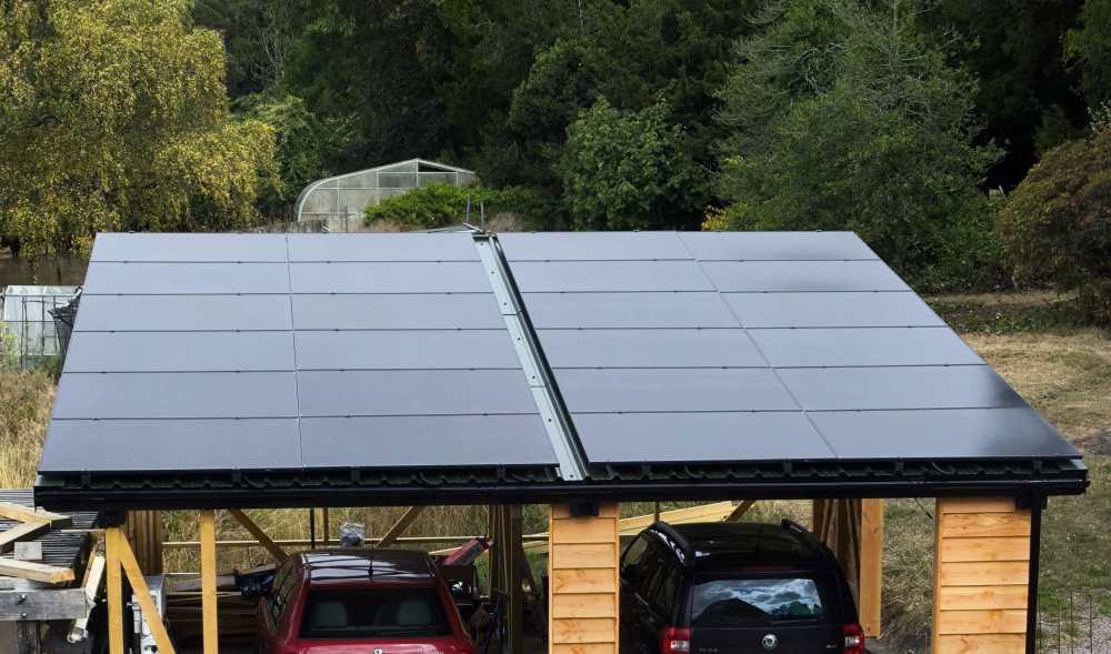

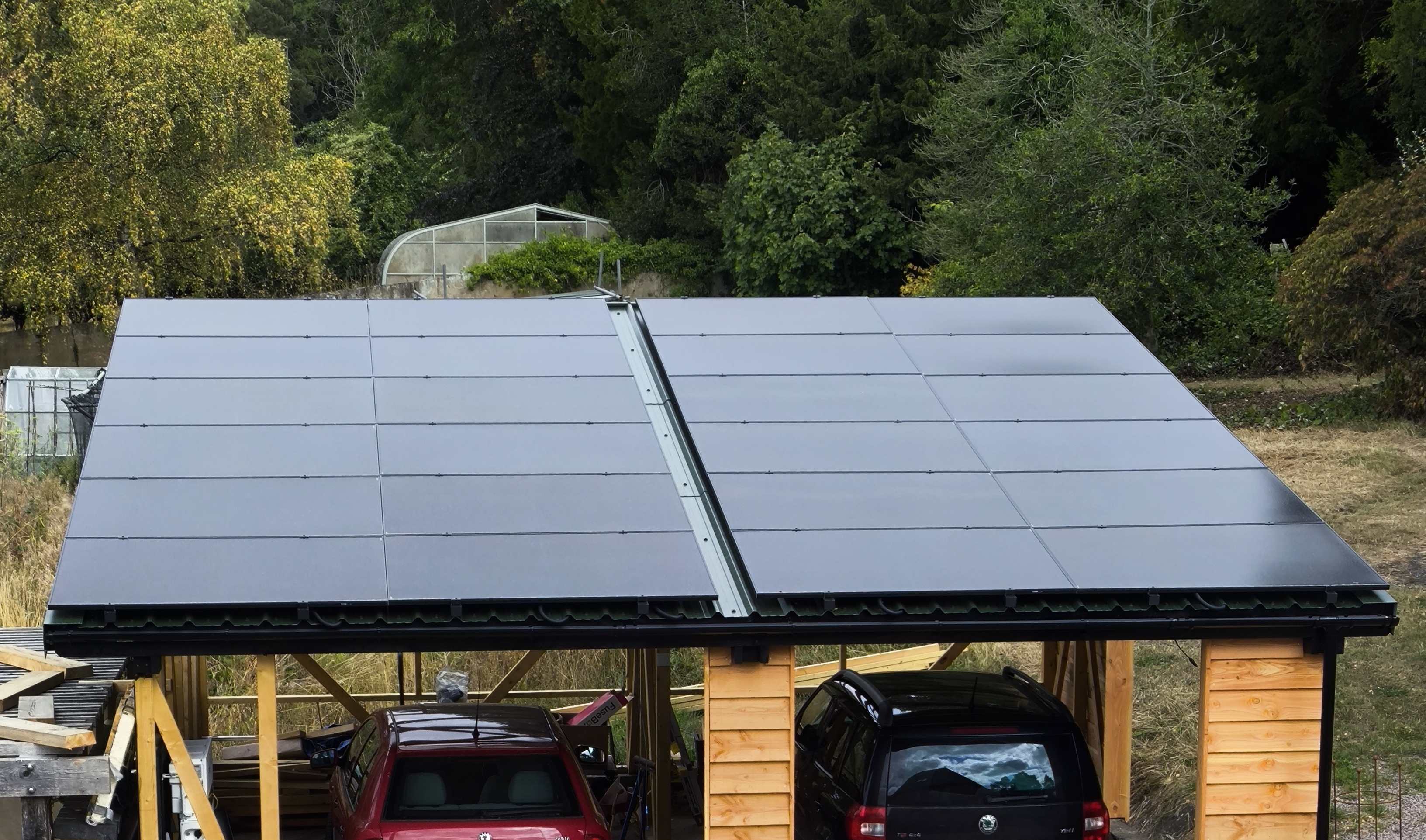

I wanted to do the same (make a roof out of the panels for cost.
I went round the houses so to speak) with things like GSE trays and even rubber stripes between the panels.
In the end I used trapizodal metal roofing (think industrial unit) as the waterproof layer.
It seemed the easiest way to ensure watertightness. It's light (less than 25kg including panels and mounting rails), robust, easy to work on (no cracking or knocking tiles) and pretty long lasting. Industrial metal roofs easily last 25 years, often 30 or 40 (lots of units built in the 80's are still knocking about). The primary aging mechanism seems to be UV damage to the Pvc coating (don't get the painted finish) and that will be helped by the UV shading the roof.
I didn't put a roof membrane under (because it's a carport) but you could easily.
Then there are a number of systems that use self drilling and tapping screws (the same as used to mount the metal panels to the purlins) to mount little sections of aluminum rail or you could use full length sections (just costs a bit more). The panels then just mount as normal. The total standoff from the top of the trapizodal roof profile is about 50mm to the top of the panels.
Of course it depends a bit on your roof design (complex hips and valleys or curves etc are harder) and overall aesthetic (work well on a modern building, not so much on a stone cottage in thr cotswolds)

32 minutes ago, Alan Ambrose said:
@Beelbeebub - that looks very neat, how are the panels mounted to the metal roofing there?
Thank you.
I used a mini rail system. I can't remember the exact make, but I'm very similar to this
https://midsummerwholesale.co.uk/buy/k2-pitched/k2-mutlirail-10-with-screws
Fastensol and Renusol do similar.
Basically short bits of rail with an epdm pad underneath.  These get screwed to the top flat bit of the roof profile allowing the standard mounts to clip in. Effectively you are using the sheet metal profile as the rail itself. It was very easy to put up, especially as the sheet metal roofing was easy to walk on.
I made (3d printed) some end caps to give the exposed rail ends a nice finish. I could stick some skirting round to neaten stuff up but I don't think I will have any bird/pest issues and it does allow for better ventilation.
Visually being able to line up with the edges makes a difference.  There was a fair bit of discussion about this as the guidelines talk of 400mm margins and the like but nobody could really find out exactly why. The best explanation was wind lift, so we took extra care to make sure everything was well fastened down and there was a good load path to the heavy foundations.
It's part of the Microgeneration Installation Standard (my emphasis):
5.8.7   Solar PV modules should not be mounted within 400mm from any edge of a domestic roof unless specific measures are taken to:
    • Resist the increased wind uplift forces in the edge zone through additional fixings and, where necessary, additional roof timbers for those fixings
    • Ensure ridge-tiles remain secure
    • Ensure rainwater run-off patterns are not affected
    • Ensure build-up and shedding of snow cannot cause injury or property damage
    • Reduce nuisance from wind noise
https://mcscertified.com/wp-content/uploads/2021/10/MIS-3002_Solar-PV-Systems-V4.0.pdf
   •• Reduce nuisance from wind noise
Yes
We took each point in turn
Wind lift (my main concern) - the location is very sheltered and the fixing method provides a very direct load path from the panels, via the shee metal to the main structural timbers, which are in turn specifically fixed down to resist wind uplift (in this case from the sheet metal)
Ridge tiles - sheet metal mono pitch roof so not a concern. Even in a duo or hipped roof, the ridge flashing are screwed down rather than mortared on as a tiled roof, so no danger of them coming loose from turbulence.
Rain and snow - care was taken at the eaves to make sure the run off the panels didn't 'over shoot' the gutter. Basically the lowest edge was stepped in about 2 inches. As there are gaps between the panels the runoff from the upper panels tends to fall through onto the metal roof anyway. Snow wise, other than making sure the dead load of the snow is fine we didn't worry. Snow is fairly rare here and the low pitch of the roof means there is little chance of big slabs sliding off to damage anyone/thing
Wind noise - we get plenty of wind noise from the trees, there is little chance of wind noise being a regular problem. Any structure can generate noise in specific conditions. It's just a case of making sure those conditions are not the common ones.
The 400mm rule of thumb is not a bad thing for retrofit to tiled roofs. But it shouldn't be allowed to become a golden rule for all circumstances - especially roofs specifically designed with solar in mind.
