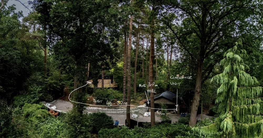

Nickfromwales Posted Sunday at 11:39 Posted Sunday at 11:39 6 hours ago, Great_scot_selfbuild said: Thanks @Nickfromwales we have lots of metal clad sockets for charging already and the people on site are all part of the same team at the moment. The challenge I’m trying to wrap my head around is where the builder would have this temporary connection positioned as the cable pops out of the ground exactly where it needs to rout up and into the plant room - if we install a temporary cabinet, CU and sockets there, then it’ll be right in the way. I’m wondering if a generator may still be needed if there’s plug-in tools needed until we at least have the cable up and in the footings of the house. If you have 230v power already there, and there’s more than 1 breaker feeding them, then I’d just have all the 110v stuff plugged in as and when required. Leave the trannys outside and just run 110v leads to the point of use. 110v can be extended for miles, 230v not so much. Have one tranny dedicated to lighting, and then invite trades needing 110v to arrange their own portable tranny and that’s usually the end of it. The only time I see these multiple outlet, fixed 110v banks is on commercial sites. I’ve not seen one on a domestic site in ages, and last one I saw was on a huge site. These are mostly for when there’s a huge amount of demo and major construction. We did a basement dig out and underpin last year and for the ground workers we just bought 2 standard portable 110v units which was suffice for the breakers, 3 storeys of temp lighting, power tools etc and all fine; we put a 230v CU in with 3x 32a RCBO’s feeding 2x 13a metal-clad double sockets each and nothing tripped afaik. 1

Great_scot_selfbuild Posted yesterday at 15:46 Author Posted yesterday at 15:46 On 24/08/2025 at 12:39, Nickfromwales said: If you have 230v power already there, and there’s more than 1 breaker feeding them, then I’d just have all the 110v stuff plugged in as and when required. Leave the trannys outside and just run 110v leads to the point of use. 110v can be extended for miles, 230v not so much. Have one tranny dedicated to lighting, and then invite trades needing 110v to arrange their own portable tranny and that’s usually the end of it. The only time I see these multiple outlet, fixed 110v banks is on commercial sites. I’ve not seen one on a domestic site in ages, and last one I saw was on a huge site. These are mostly for when there’s a huge amount of demo and major construction. We did a basement dig out and underpin last year and for the ground workers we just bought 2 standard portable 110v units which was suffice for the breakers, 3 storeys of temp lighting, power tools etc and all fine; we put a 230v CU in with 3x 32a RCBO’s feeding 2x 13a metal-clad double sockets each and nothing tripped afaik. We have our consumer unit at the garage (point of mains electricity arrival). I could be wrong, but I don't think we have more than one breaker as there was a discussion about multiple circuits in the garage and we decided more than one circuit there was overkill (background - if we have a chest freezer there then we didn't want it cutting out if use of tools in the garage caused the power to trip, but then again I'd know about it as I'd be in the garage and would be able to reset and sort it out, so we didn't really need two separately protected circuits). See attached photo (need to get one of the CU with the cover lifted up, as I'm not sure whether there is an RCBO (would that be standard to install? it didn't come up in discussion - electrician is good and understood our needs, but ultimately I didn't know what to ask. We have plenty(!) of sockets in this garage - are you saying we could plug yellow 110v transformers in here and run them as far as we need? (from a power/current perspective, dealing with the safety of leads separately (we could ty-wrap cables to the fencing that leads up to where they may be used, as a possible option).

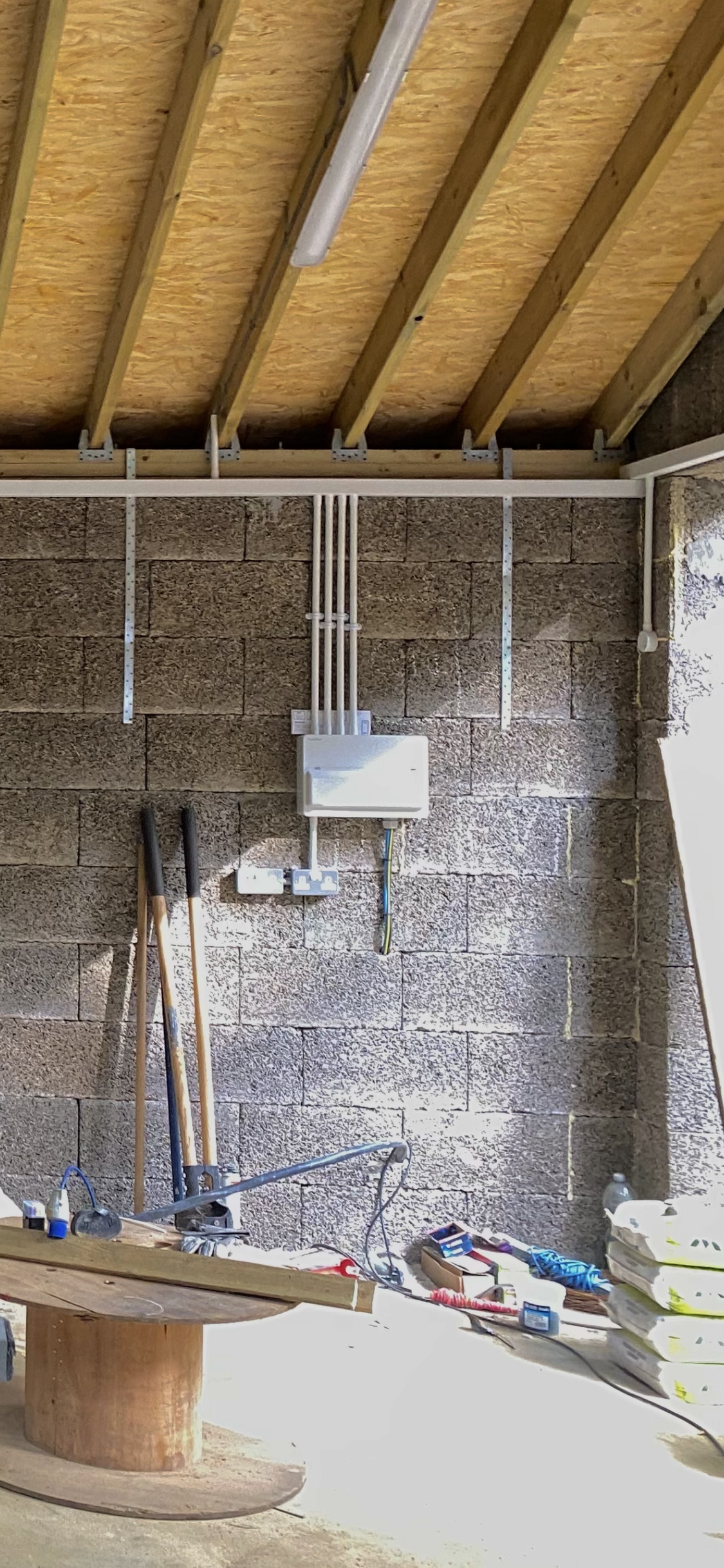

Nickfromwales Posted yesterday at 16:29 Posted yesterday at 16:29 42 minutes ago, Great_scot_selfbuild said: We have our consumer unit at the garage (point of mains electricity arrival). I could be wrong, but I don't think we have more than one breaker as there was a discussion about multiple circuits in the garage and we decided more than one circuit there was overkill (background - if we have a chest freezer there then we didn't want it cutting out if use of tools in the garage caused the power to trip, but then again I'd know about it as I'd be in the garage and would be able to reset and sort it out, so we didn't really need two separately protected circuits). See attached photo (need to get one of the CU with the cover lifted up, as I'm not sure whether there is an RCBO (would that be standard to install? it didn't come up in discussion - electrician is good and understood our needs, but ultimately I didn't know what to ask. We have plenty(!) of sockets in this garage - are you saying we could plug yellow 110v transformers in here and run them as far as we need? (from a power/current perspective, dealing with the safety of leads separately (we could ty-wrap cables to the fencing that leads up to where they may be used, as a possible option). How far away from there > house?
Great_scot_selfbuild Posted yesterday at 17:56 Author Posted yesterday at 17:56 1 hour ago, Nickfromwales said: How far away from there > house? @Nickfromwales approx 50m from the CU, or 40m from nearest 3-pin socket. Could run a direct line over the protected tree gap and save quite a few metres though. Photo to help set the scene.
Nickfromwales Posted 19 hours ago Posted 19 hours ago 5 hours ago, Great_scot_selfbuild said: @Nickfromwales approx 50m from the CU, or 40m from nearest 3-pin socket. Could run a direct line over the protected tree gap and save quite a few metres though. Photo to help set the scene. As the crow flies plz?

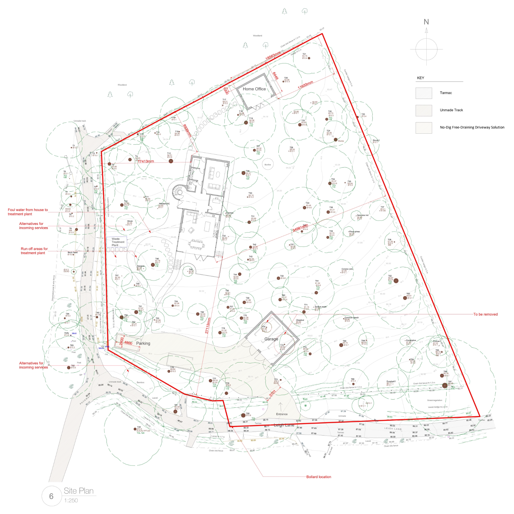

Great_scot_selfbuild Posted 12 hours ago Author Posted 12 hours ago 6 hours ago, Nickfromwales said: As the crow flies plz? Here's a site plan view
Nickfromwales Posted 1 hour ago Posted 1 hour ago 11 hours ago, Great_scot_selfbuild said: Here's a site plan view I think you need to get a decent 230v supply over there first as last tbh. Leave 5m of slack at the house end, coiled up at your then TBS, and uncoil to move it to the room it'll reside in for eternity as the build progresses. That's just too long / adverse a run to be taking extension leads etc back/forth.

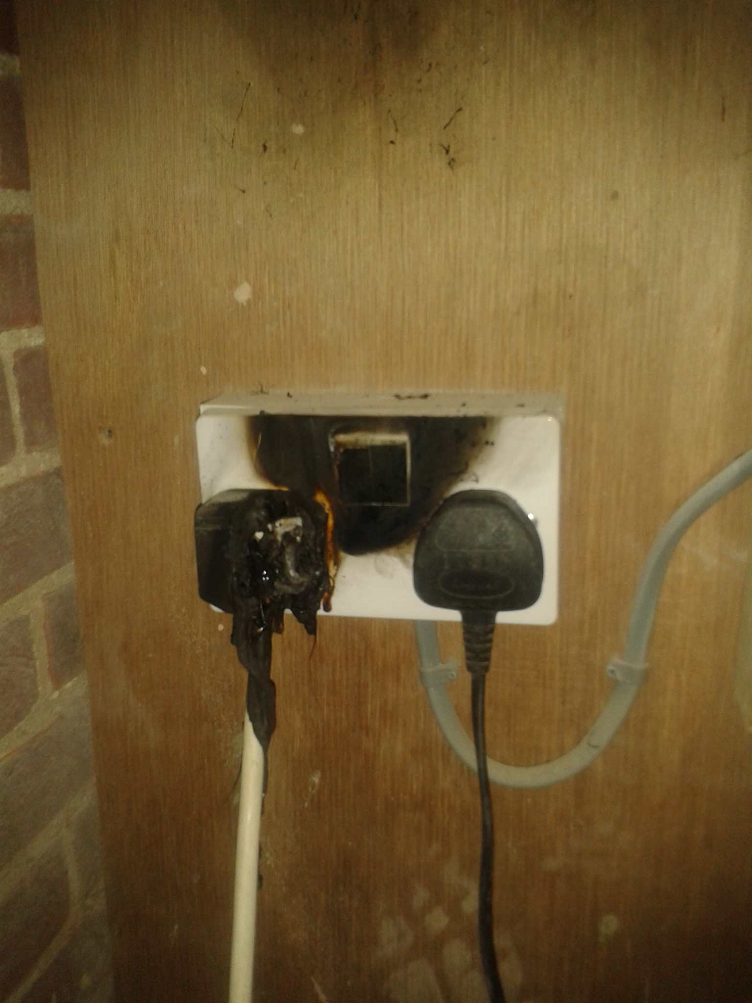

FuerteStu Posted 40 minutes ago Posted 40 minutes ago On 22/08/2025 at 23:39, Nickfromwales said: It's got a 13a plug though, hasn't it..... lol.😘 And this can happen when 5 people are plugged into splitters and extensions..
