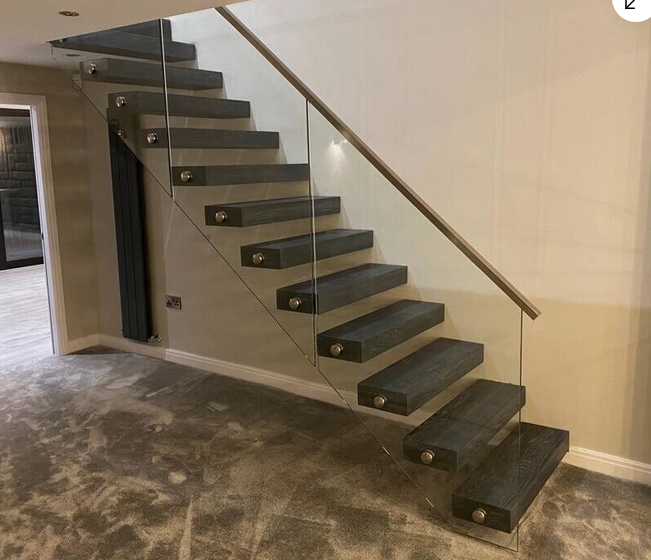

flanagaj Posted August 15, 2025 Posted August 15, 2025 We are planning on having a floating staircase and the TA has not made any mention in the drawings to BC. I assume it will require a SE to see what make up the wall which the treads will be mounted to, needs to be. Just not sure whether a single skin 7N block wall would suffice or even a single skin brick wall. I want the stairs cantilevered from the wall as opposed to having a single central spine below the treads. Has anyone installed such a staircase and if so, how was the mounting wall constructed?

Russell griffiths Posted August 15, 2025 Posted August 15, 2025 Whatever you think it needs over engineering Massively I witnessed a large staircase that had a complex curve in it nearly twist off the wall as the temporary bracing was removed. there are some serious forces at play with cantilevers, and there would be nothing worse than a bouncy staircase. steel support structure buried in the wall for me, or a 140mm solid block wall. 3
markc Posted August 15, 2025 Posted August 15, 2025 A lot depends on the balustrade. If the handrail and infil (assuming glass) is designed as load bearing the cantilever is drastically reduced and a block wall would be ok. If the treads are true single cantilever’s then you are into reinforced wall territory. A bespoke stair company will have SE’s they work with regularly. 1 1
Nickfromwales Posted August 15, 2025 Posted August 15, 2025 Defo 120x 50mm steel box section uprights into a 5” ‘stud’ wall, with same for header and footer, if you want longer treads and for it to be bombproof. Glulam or 3” trimmer for head of stairs can be swapped out for a steel, if it isn’t already spec’d in steel for eg, to allow this to all be welded / mechanically connected so the best result of all. We’ve had an excellent steel fabricator and welder on site this week sorting a knackered roof out, and the results are fantastic and quite cheap for what you get. Day rates for a welder vs chippy aren’t wildly far apart (max £100 a day difference) and they get a lot done quite quickly by getting stuff cut and made up off site, then it’s just install / clamp / weld / bingo bango. Steel is not super expensive, so worth finding out what it would cost to do this in metal afaic, and then know you never need to worry / revisit ever again. Steel opens up an entire new world of possibilities, where’s other materials such as wood have huge limitations; a lot of wood finished stairs need metal spines anyways. 2

Tony L Posted August 15, 2025 Posted August 15, 2025 6 hours ago, flanagaj said: Has anyone installed such a staircase and if so, how was the mounting wall constructed? No, but I'm planning this (that's if I have any money left when the build nears completion). I discussed my plan with my SE, & my drawings show standard 7N blocks laid flat - so my wall that the stairs will hang off is 215 thick (+ finish) rather than 100. 1

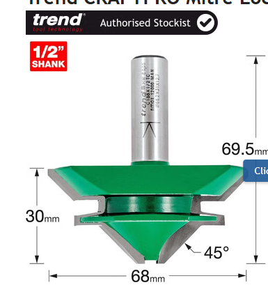

flanagaj Posted September 2, 2025 Author Posted September 2, 2025 I am thinking of paying these for a design (Contact & Services - Home Design Tutorials Ltd). I am struggling to find an SE who can do the calcs and their design service will be useful when sending out the quotes to local fabricators. TBH there is no reason for a floating stair case to cost a lot of money. It's a joke what some of these companies are charging. Take for example, the oak treads. They can be manufactured using a mitre lock bit and a router table and oak. If you have access to a router table, saw bench and a planer thicknesser, you could save a fair chunk making them yourself.
