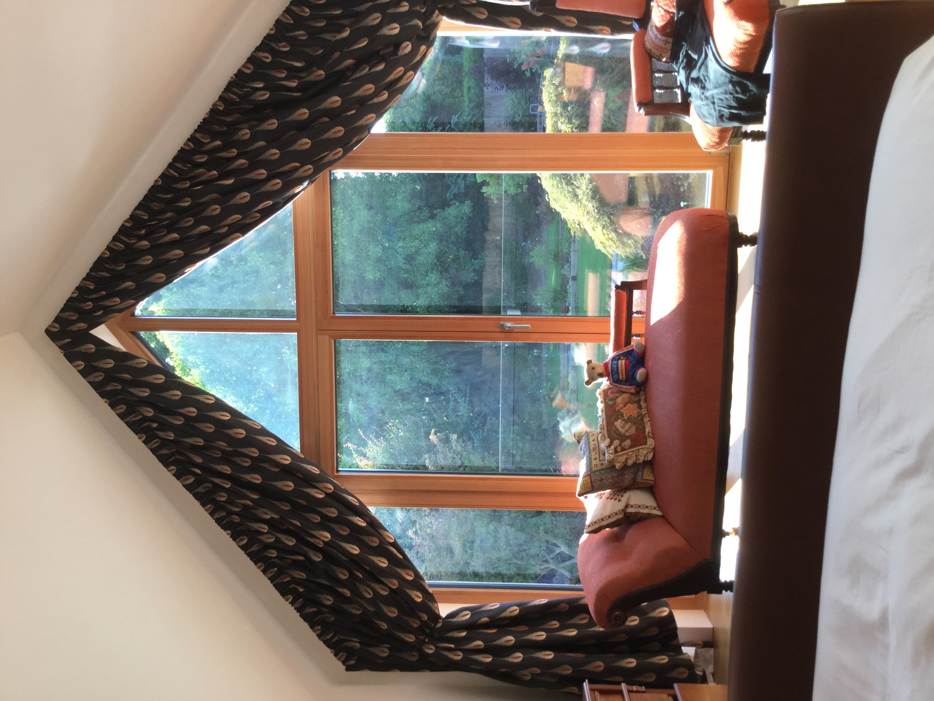

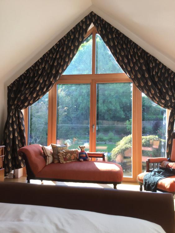

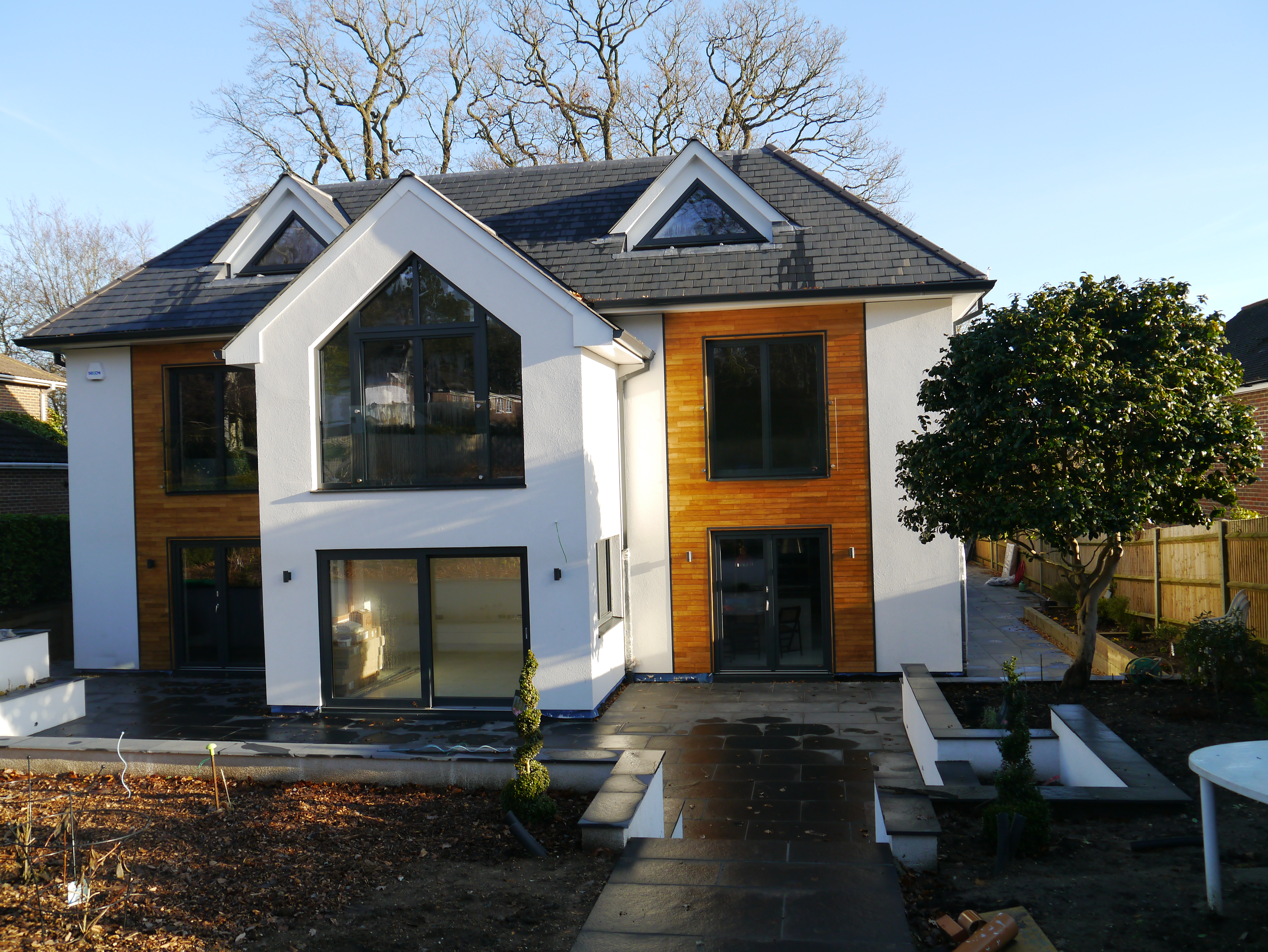

HerbJ Posted January 5, 2018 Posted January 5, 2018 +1 to juliet balcony. We incorporated them in all of our bedrooms. We used 12mm toughened glass and they balconies are nearly invisible, inside and outside. 3

HerbJ Posted January 5, 2018 Posted January 5, 2018 I looked at various sources of supply, including online websites who seem to specialise in juliet balconies and there is a lot of choice of style and specification, including toughened/laminated glass. The ,main problem is that the glass was very heavy and required a tower/lifting equipment to install. My build was nearing completion and I had limited labour and no lifting equipment at site. So in the end, I went to a local glazing supplier, who we had already used for several other elements, and they supplied and installed the balconies for a reasonable price that was extremely (more) competitive with anything on-line. They checked the dimensions before ordering the glass , have installed dozens of similar juliet balconies and I didn't have to organise labour and equipment or cooordinate delivery and installation. The invoice was zero rated for VAT As @Ian points out there are various specifications of glass to be considered, depending on the precise purpose of the balcony. I agree that for commercial purposes the correct specification may be toughened & laminated glass but each and every application should be properly considered and selected on its specific use and location. After careful thought and looking at the alternatives, I decided that our juliet balconies would be rarely used and never in a situation where there was likely to be several people on a large balcony with a high probability of forces on the balcony that may lead to failure. So, we I selected and specified the toughened glass option with input from the glazing company, though I did not consider "heat soaking" at that time - it may have been a sensible addition and in fact we have used such glass for another application for colour. I did seek my BCO's prior approval for the specification of glass and fixing method proposed. 1

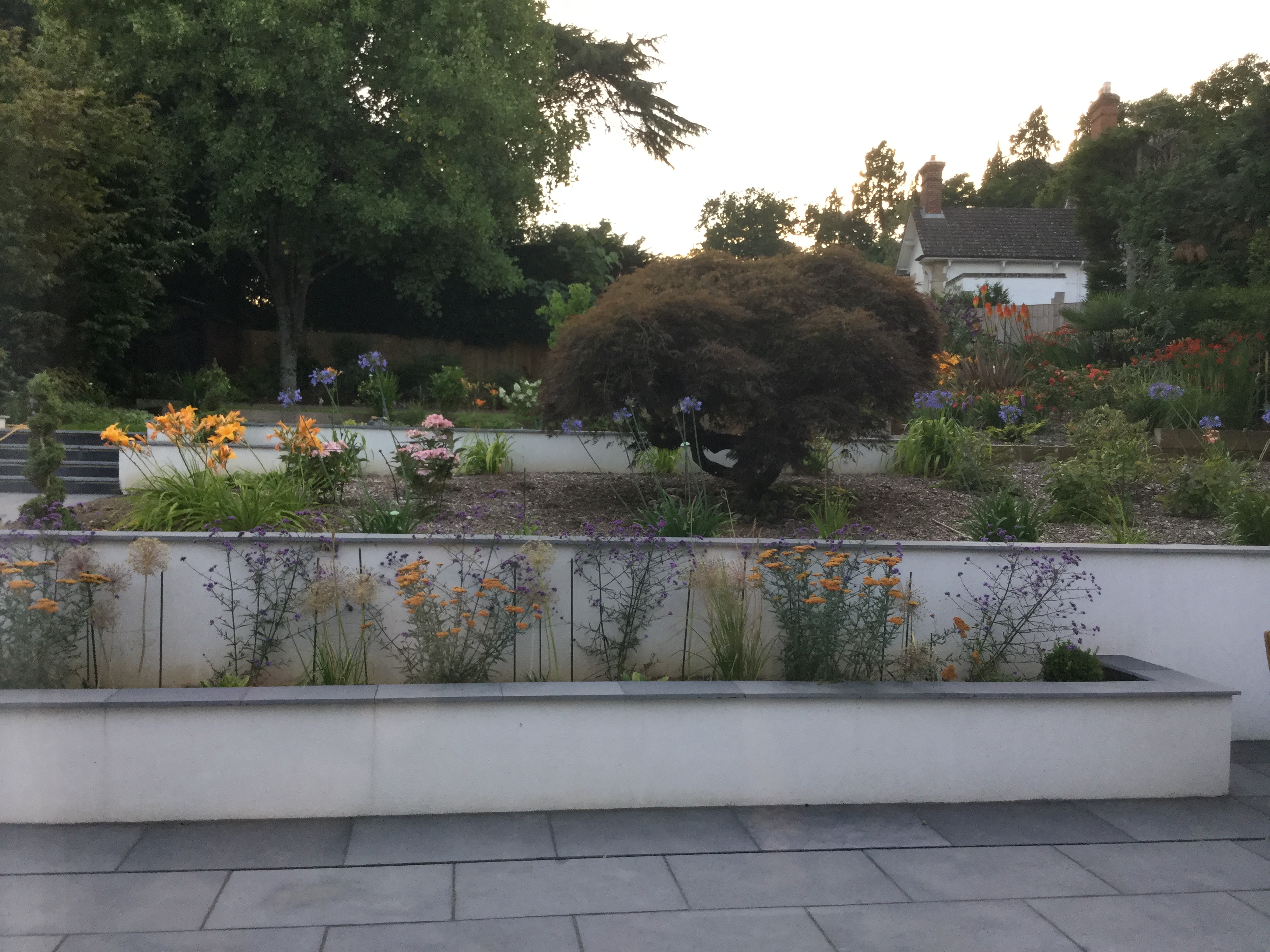

Ferdinand Posted January 6, 2018 Posted January 6, 2018 (edited) 17 hours ago, HerbJ said: +1 to juliet balcony. We incorporated them in all of our bedrooms. We used 12mm toughened glass and they balconies are nearly invisible, inside and outside. @HerbJ What is the low walled area on the right, please. A pond? Ventilation for a basement swimming pool? Looks interesting. Edited January 6, 2018 by Ferdinand

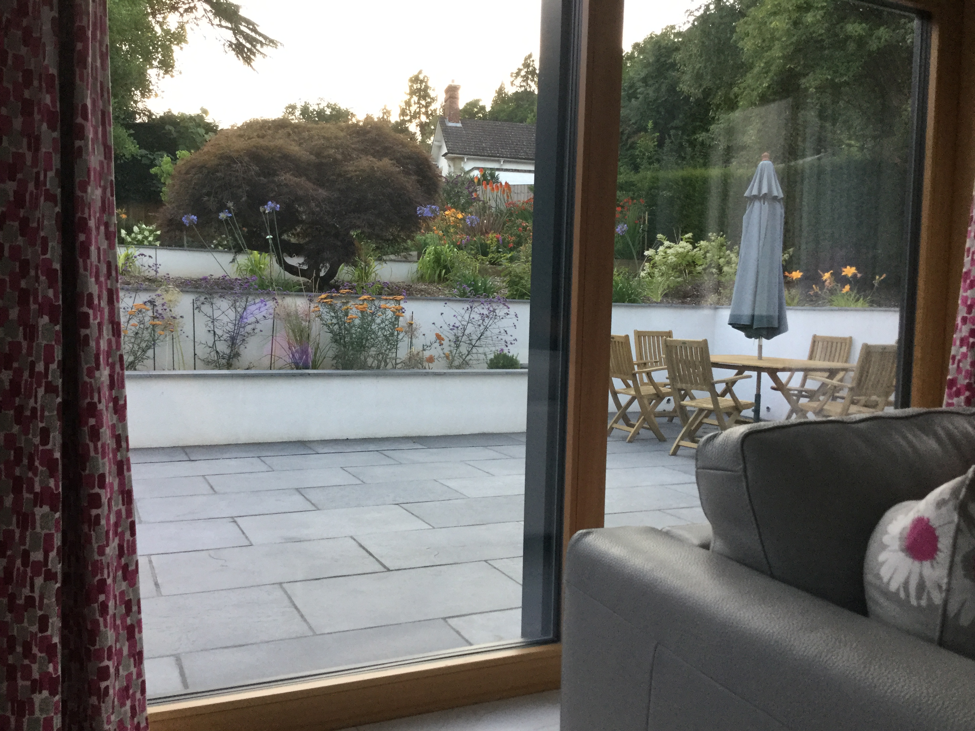

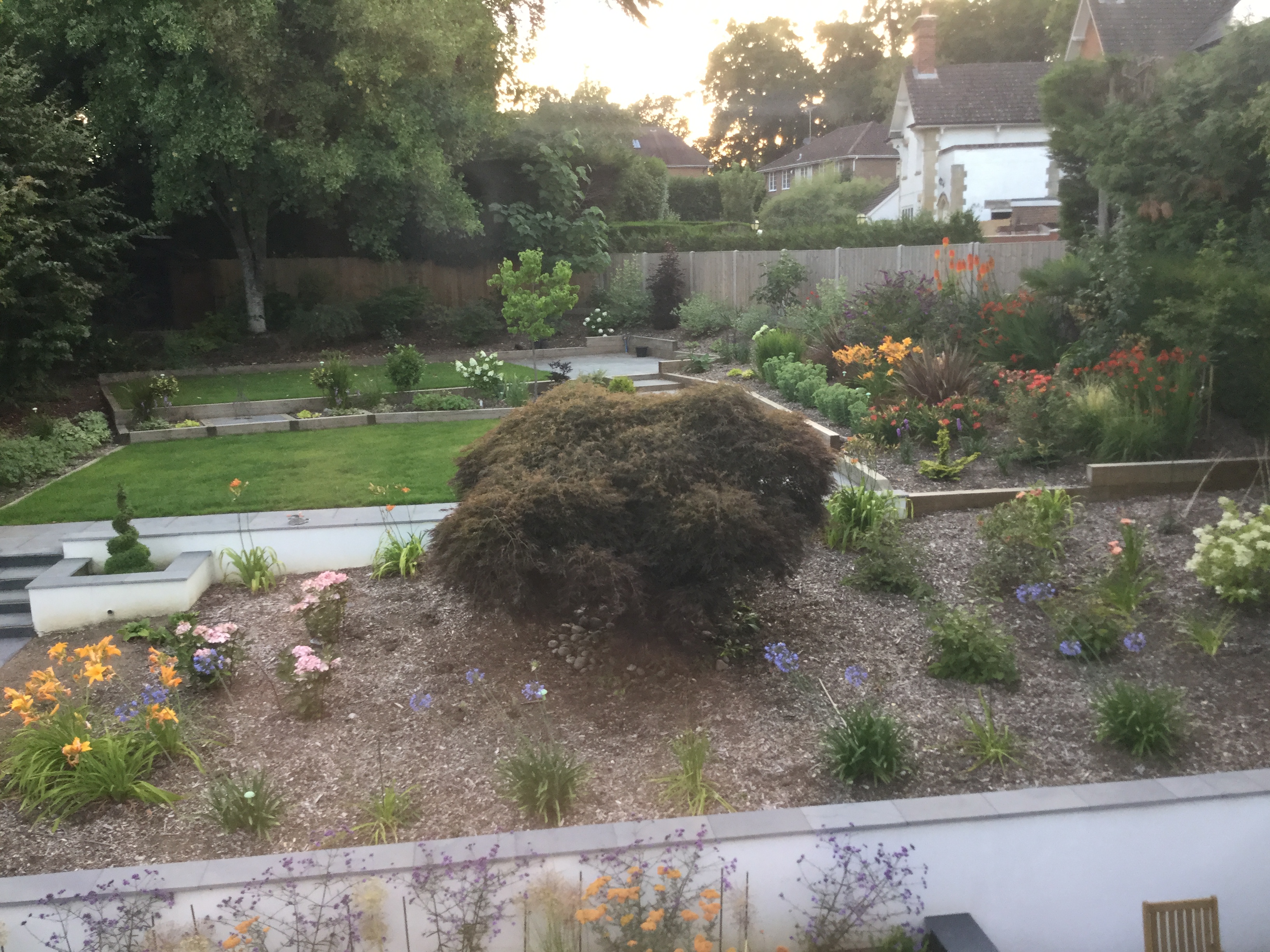

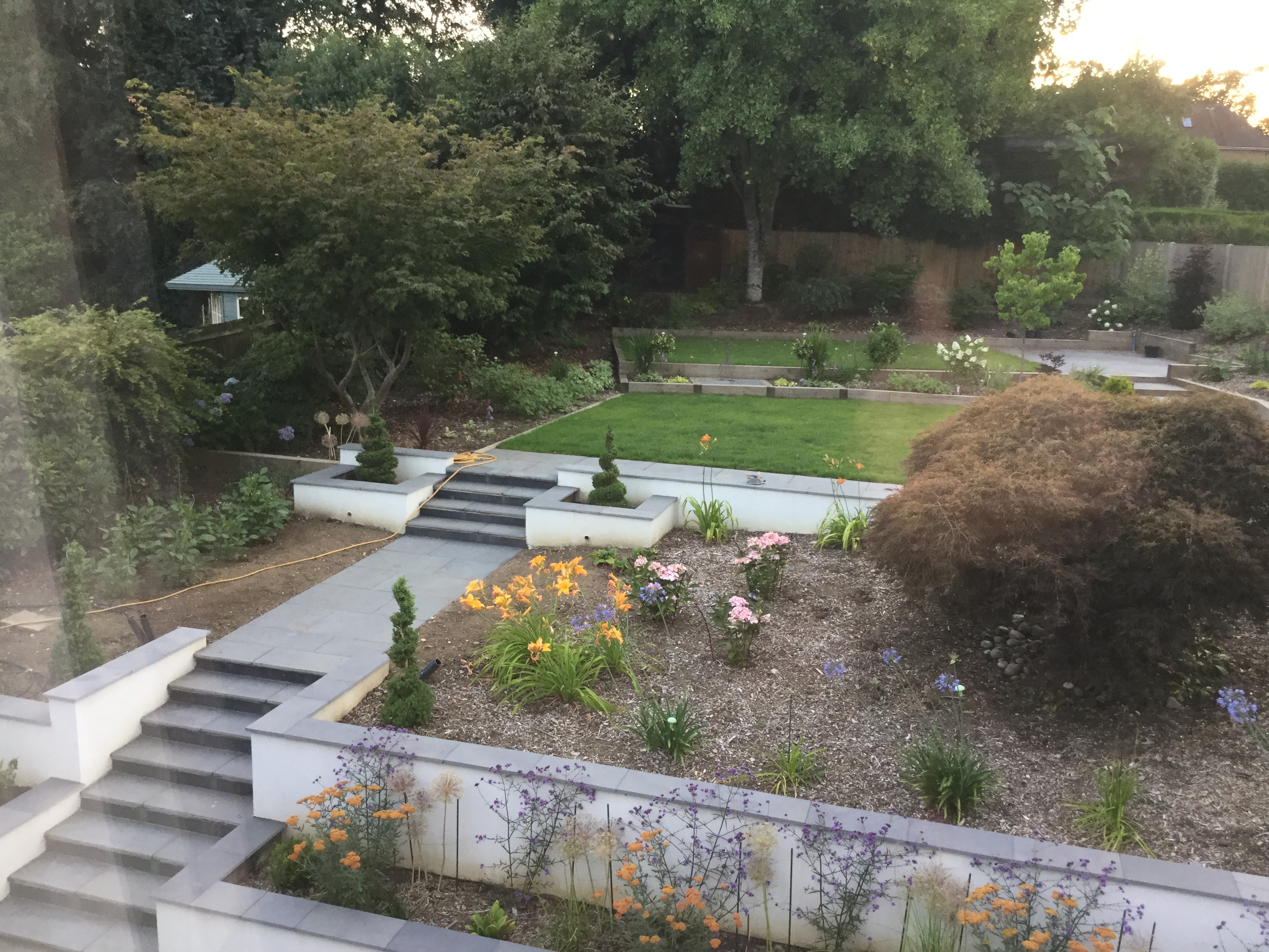

HerbJ Posted January 6, 2018 Posted January 6, 2018 It's just low level planter to give a bit if interest to the terrace. These are a few photos I have to hand, one from the Master Bredroom ( shown in the earlier photo) and a couple the Family Room immediately below. We had a fairly large hard landscaping job to complete, which was not obvious from the overgrown garden that we bought - the site rises nearly 4m from the road to the back fence and drops about 0.5m (at the front) to 1m (at the back) right to left as you look up the garden. Topographic survey was invaluable for planning and design, as we had a lot of very nice specimen trees, shrubs and established hedges that we wanted to retain and the garden was planned around them. My wife, Yvonne, is the gardener, and planted the garden mostly with cuttings and shrubs from our old house and this house ( taken before the plot was cleared for landscaping and groundworks). The garden was almost completely planted whilst the house was being built and the little bit of lawn was completed after completion. The house and landscaping were set out with the house, using GPS coordinates.
