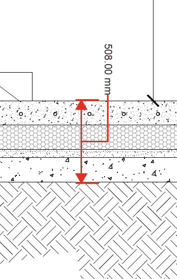

flanagaj Posted September 9 Author Posted September 9 (edited) I was just looking at invert levels again today and as the soil pipe run is 28 metres from the first inspection chamber. The invert levels are as follows. 1:40 - 1340mm 1:60 - 1110mm 1:80 - 990mm This is because the first IC has an invert of 640mm. I don't think I can do anything about that as the slab floor make up of concrete/insulation/sand blinding/harcore is 500mm, add 110mm and you are at 610mm. I assume that the soil pipe has to go under the type 1? The reason for my post was that I was considering going with the Graf pumped option as it would mean the 8m * 4m field that I need to excavate will be 500mm higher than if I went with the gravity outlet option. Just wondering whether the pump will be loud. Edited September 9 by flanagaj

flanagaj Posted September 10 Author Posted September 10 1 hour ago, Russell griffiths said: You want your first ic as high in the ground as possible, if your bathrooms are on an outside wall this is easier, if a bathroom is in the centre of the house it will get deeper as you cross the house. I agree, but if the sub floor structure is as follows, then the soil pipe needs to be buried below the layers in the diagram below? This will then dictate that the invert of the first IC 28 metres from where the tank will be located?
Russell griffiths Posted September 11 Posted September 11 Depends what distance this pipe is traveling across the house if the bathroom is on an outside wall you can lift the pipe up in the layers, it doesn’t have to be under the type 1. if the bathroom is in the middle of the house you need to consider the structure of the floor above the pipe. lift the house higher 1

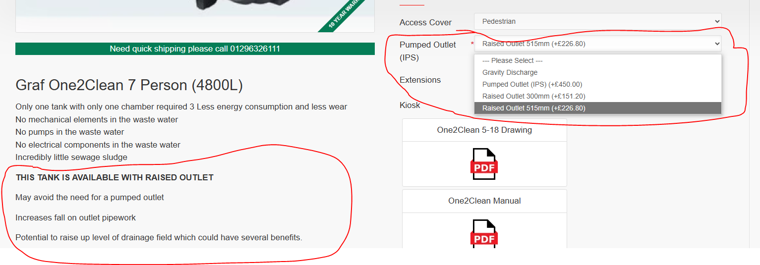

flanagaj Posted September 12 Author Posted September 12 The problem is now resolved. Graf are pretty useless when it comes to their online documentation and the various configurations of their tanks. It was only when I came across a web site selling them, did I realise that there are actually 4 outlet configurations. Every other site just lists the tanks as 'Gravity' or 'Pumped' outlets. So you can raise the outlet by either 300mm or 515mm with the standard lift system that comes with the tank. I was just about to hit buy on a pumped tank. Having a raised outlet helps as it means it puts my drainage field above the fast draining chalk layer and into the soil layer that gives me a > 12 Vp reading. This not only saves a huge amount of excavation, but also having to put a 700mm sand layer underneath the drainage field to increase the Vp so that it meets the criteria.

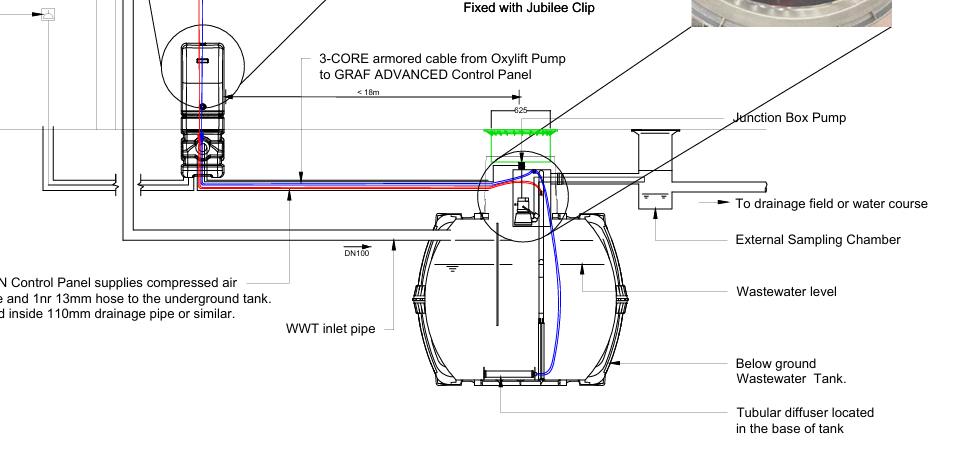

flanagaj Posted September 13 Author Posted September 13 (edited) In case anybody reads this thread in the future as they too want a raised outlet, here is the drawing that I finally received from one of the Graf reps. A picture speaks a thousand words. One2clean with Raised Outlet_ Specification.pdf Edited September 13 by flanagaj 2
