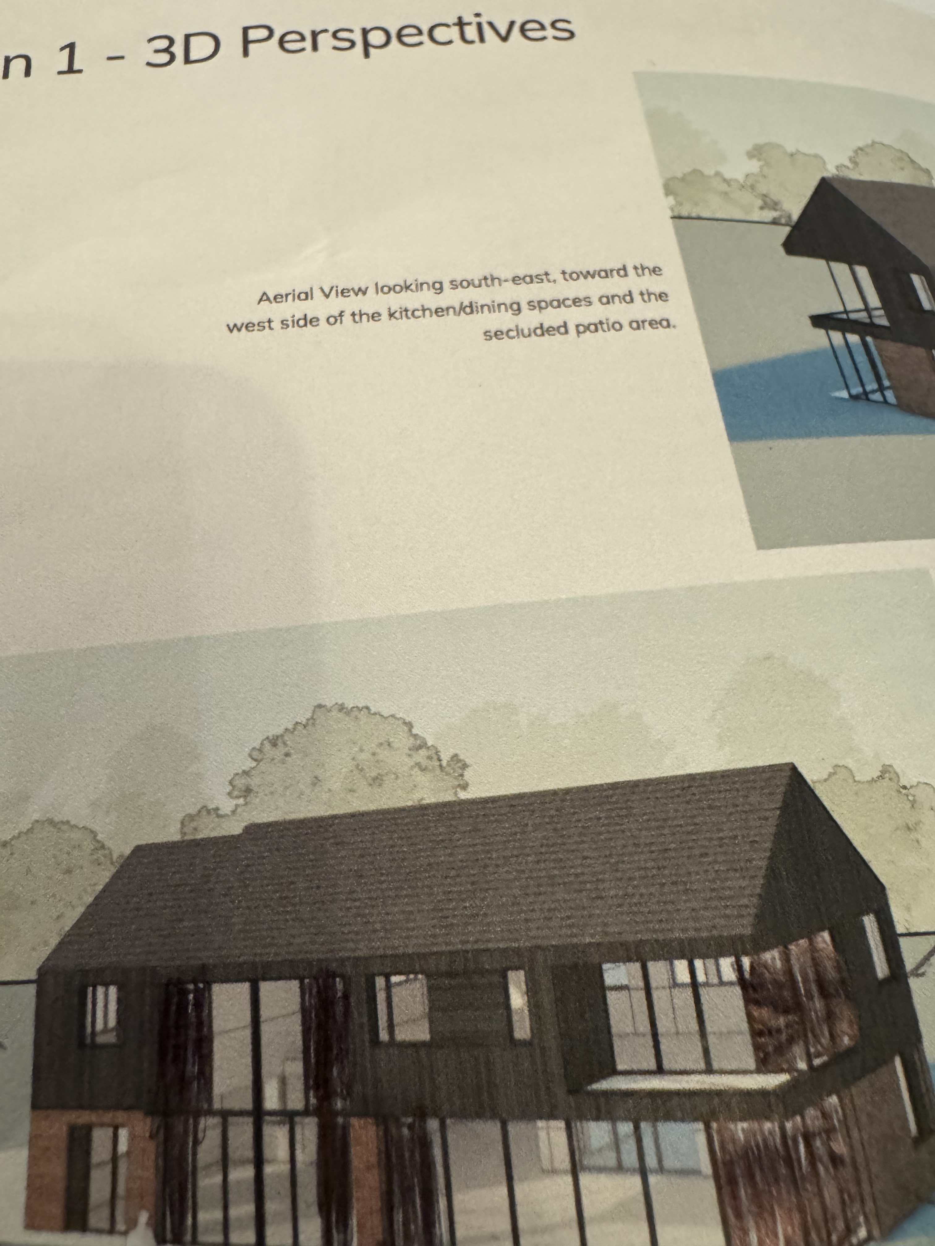

jack Posted August 3 Posted August 3 13 hours ago, Benpointer said: Too much glazing imo. Overheating, heat loss, where to place furniture, privacy, structure (how's that east corner actually going to be built?), aesthetics... But... Surely the joy of self-build is that within reason we each get to have the house we want, not the house some builder thinks we might want? Just make sure it is the design you want, not just the one that happens to be approved for that plot at the moment. Project management: I was a PM for 20+ years before I retired (in finance, not building, admittedly) but I am finding PMing our own self-build reasonably stressy and challenging. Fortunately the buzz is outweighing the worries for me at the moment but if you aren't used to managing complex projects with a lot riding on them, think very carefully before diving in. Finally, this thread is very interesting - from people who have been there: +1 to all this. For reference, our house is almost exactly the same size as yours. We project-managed our build 10 years ago, but we had the benefit of using one provider for the foundations and timber frame. There were definitely some very stressful periods, mainly around poor (sometimes laughably so) workmanship and how that would be handled by the trade that did it. It's certainly doable, especially if you're well-organised and thick-skinned. We have similar amounts of glazing in our kitchen diner and it's one of my biggest regrets. Lots of glass can work okay if the space is big enough to allow furniture to be positioned well away from the glass. In our case, the space is something like 6 x 5.5 m and there's nowhere to put furniture without it being up against a window or sliding door. If I were doing it again, I'd get rid of most of the floor to ceiling windows and replace them with large ordinary windows on low walls (roughly table or back-of-sofa height). I'd also also replace the 5.5 m long slider with a pair of french doors with windows either side. 1

jack Posted August 3 Posted August 3 10 minutes ago, Roof said: Thanks for the comments can I asked who done your timber frame MBC Timber Frame. Irish company, but I think they have a factory somewhere in south west UK. I used them over 10 years ago, but several on here have used them more recently. Copy and paste this term into Google search: "mbc site:buildhub.org.uk" 10 minutes ago, Roof said: do you use special glass You can use glass with lower transmission values (i.e., it's designed to let less light through). A better idea, imo, is to build in some sort of external shading. We have electrically operated external venetian blinds on some windows, which are very effective, but there are other options, like shade cloth. You can get them built into concealed boxes at the top of the windows, so they're more or less invisible when not in use. You might end up with some visible guide rails on very wide windows, but they're pretty discreet. Not the cheapest option, but then neither is installing the amount of glass you're planning! I don't have any photos of my house on BuildHub, but plenty of others have shared. The MBC search above should show some options.
SteamyTea Posted August 3 Posted August 3 With that much glazing I would think it would be very hard to pass Part L of the building regs, that is before worrying about Part O. If an architect designed that, they need to be taken into a kiddies science lesson and re-educated.

jack Posted August 3 Posted August 3 6 hours ago, Roof said: Thanks for the advice I’ll have a look on there website there may be a way I can make some of the glass smaller If the plot you're looking at has full planning permission for that house, you might consider re-applying for permission for something that will be cheaper to build. Even with the cost of another architect, you could potentially end up saving money overall with a cheaper design. How long does the current planning permission have to go until it expires? If it's still got a fair bit of time to run, you could easily get permission to get something else built without risking the existing permission expiring. 6 hours ago, Roof said: can I ask how long your build time was thanks Just over a year from demolition to moving in.

Roundtuit Posted Tuesday at 20:58 Posted Tuesday at 20:58 I like glass, but maybe half of it. Dispensing with the dual aspect corner bits will simplify things and reduce structural complexity. You can still have the views, but through smaller apertures. 3
