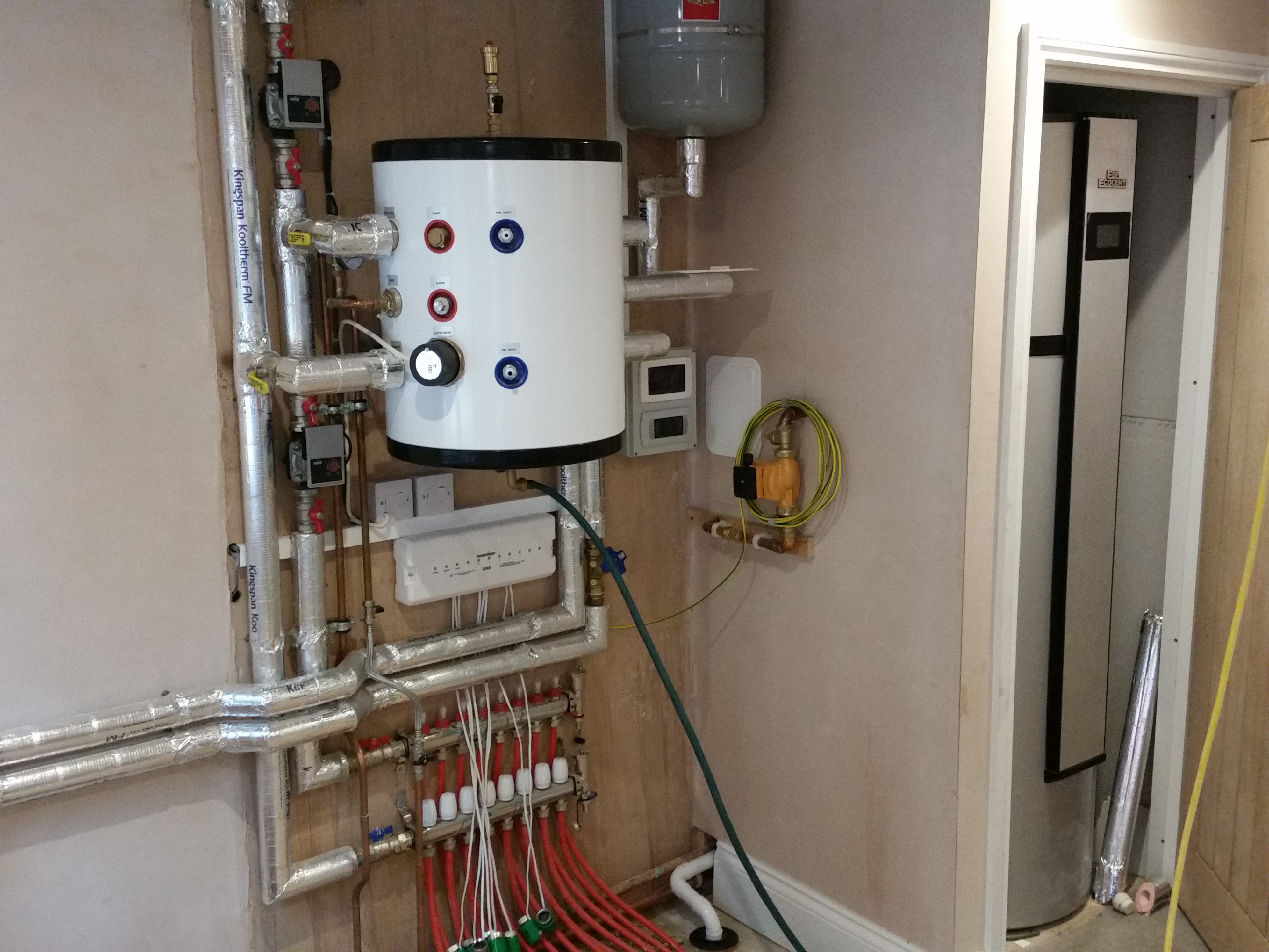

The Ecocent was switched on Today
Some of you may remember my other thread from the old site, we have opted for the ecocent maxi for our DHW needs, well today was the day that they started turning everything on, and I waited for the drop in temperature and the realisation that we had made the wrong decision but I am pleased to say so far it all seems to be working well, I asked when he was going to switch it on as I had been out but he pointed out it was already running, the noise was non existent and the two temperarure sensors that I had never changed from the 20 degrees C that the house is at at present. There is no heating in the house the ASHP and MVHR are all being done over the next week but so far so good as all the comments made be worry about the ecocent.

Thanks Martin, they switched on all the units today (ASHP, MVHR and the Ecocent) with our electrician today and everything worked fine they are back over the course of the next week to clean the UFH loops and refill with water/glycol, adjust the flow rates on the MVHR and hopefully we will be good to go. We are hoping to be in by 2nd July.

So one week in and it is working really well, the house is maintaining a constant temp or 21/22 degrees, we have been running the HW to drain the tank and re heat and are seeing now temperature shifts, the noise from the unit is no existent as well, so definitely a good options for the summer months we will have to see what the winter brings, but so far running the water at 52 degreess seems to work really well.  Next week will be the test when we move in.
