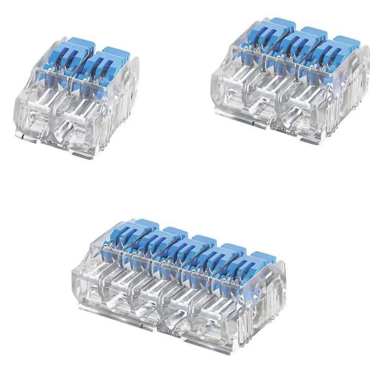

Kelvin Posted July 25 Posted July 25 23 hours ago, saveasteading said: Nice idea. But that was the easiest bit. A really sharp knife helped too....must check I didn't do damage with it. For connections inside the boxes I've used old-fashioned screwed terminal strips. Would modern lever connectors be better? I see some at screwfix are a fraction of the cost of the bigger name wago. I like the idea of getting second shots at it too, ie the lever releases. The wago's I used once were push-in and perhaps fixed. I'm thinking I will buy a better and bigger box today, and lever connectors. The push in Wagos can be re-used. Twist the cable from side to side while pulling.

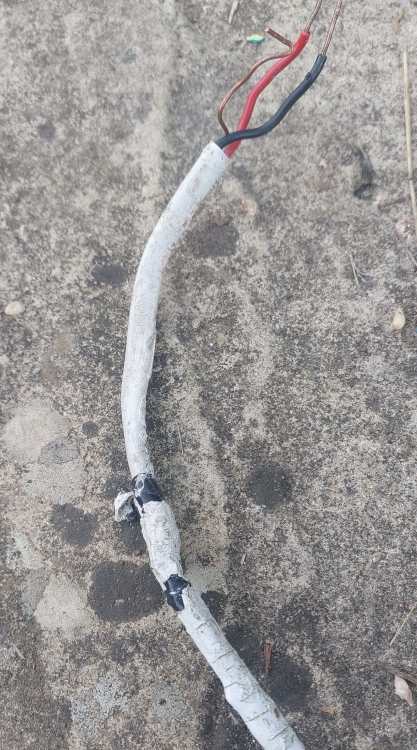

saveasteading Posted July 25 Author Posted July 25 1 hour ago, ProDave said: insulation tester. Could it be that the old cable has failed in flexing it? It has been there for the over 30 years I've lived here. I was going to change it later but perhaps should do it now.
Nickfromwales Posted July 25 Posted July 25 20 minutes ago, saveasteading said: Could it be that the old cable has failed in flexing it? It has been there for the over 30 years I've lived here. I was going to change it later but perhaps should do it now. How many cores is the SWA?

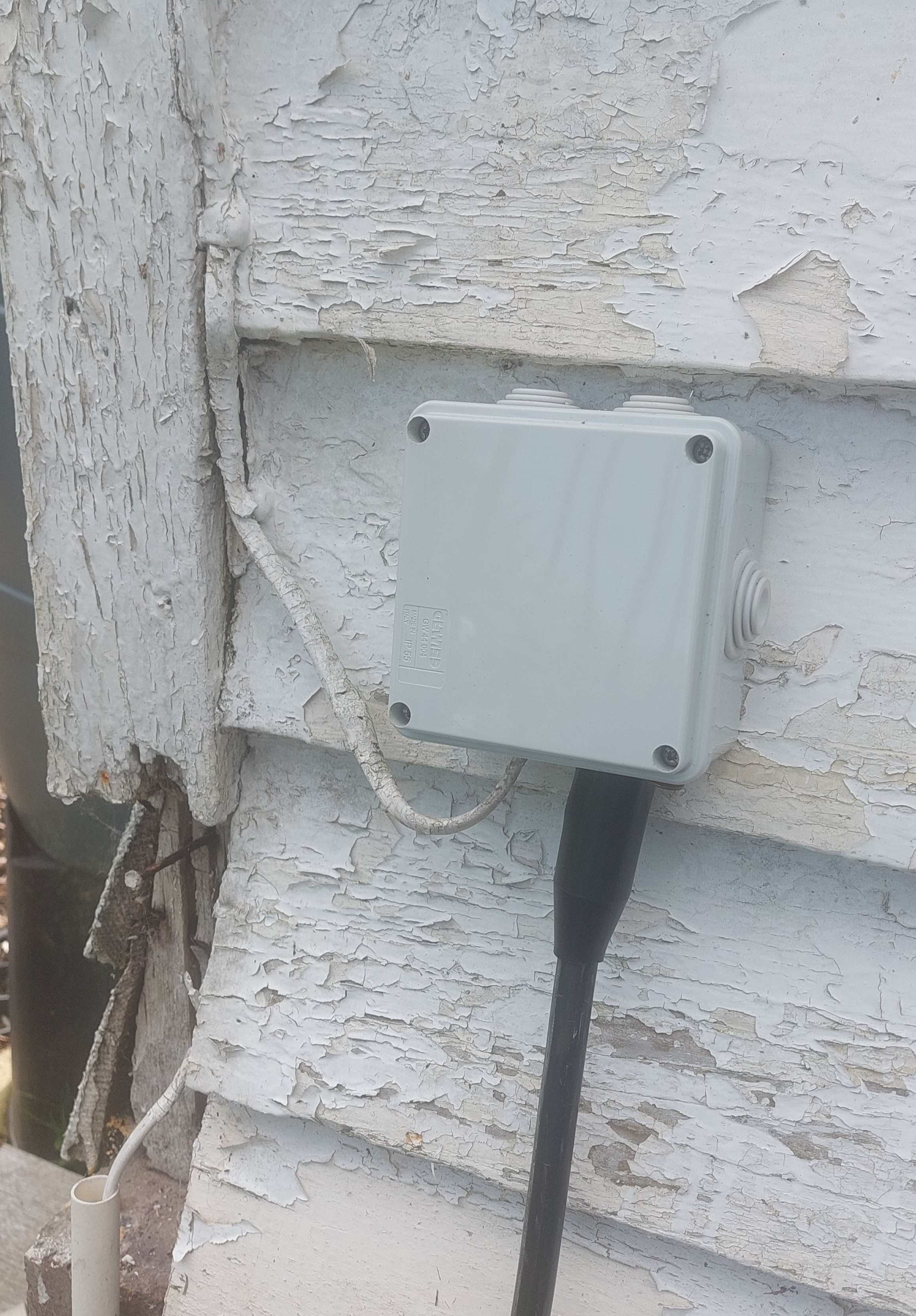

saveasteading Posted July 25 Author Posted July 25 This is the old cable, coming from the attic, then was into the conduit bottom left. It did feel a bit stiff as I bent it around, but attributed that to many layers of gloss paint. BTW I am aware that the wall needs painting and the corner needs a new block. The sun is doing a good job in exposing an ancient layer that was painted over dirt, well over 30 years ago i think, so I'm letting it. The cladding was about 1930 and still has a resinous smell when cut. It's been overpainted thrice in my time here. The first by professionals who i think only prepped when being watched.. some failed in a few years. The second time by 3 steel cladders waiting for the next job... lasted well. Third by me in lockdown... and that has stayed put too. I'd like to make the corner with 2 splays out of one block of wood, rather than rectangular with 2 wedges added. But it would be a big lump of wood and I'm not sure I have the skill. Hence years of not getting round to it.
saveasteading Posted Saturday at 06:47 Author Posted Saturday at 06:47 10 hours ago, dpmiller said: that T&E? I'd be replacing that.. I am. I thought I'd do it in stages. For my education, why is T & E wrong in principle?
Onoff Posted Saturday at 07:48 Posted Saturday at 07:48 58 minutes ago, saveasteading said: I am. I thought I'd do it in stages. For my education, why is T & E wrong in principle? UV from sunlight degrades the sheath is the main thing. You could run a line of conduit and put it in that.
saveasteading Posted Saturday at 08:31 Author Posted Saturday at 08:31 Yes I've even got the conduit ready. The existing cable ran underground for 25m then up a pole to a 500W. That must have been pushing its capacity. floodlight. I changed that to 30W. It now supplies an electric gate which is quite low power. I'm thinking an outside socket would be a sensible addition for gardening but perhaps also car charging..... slow only. So I'm thinking the cable should be bigger than smaller. 2.5mm T&E ?

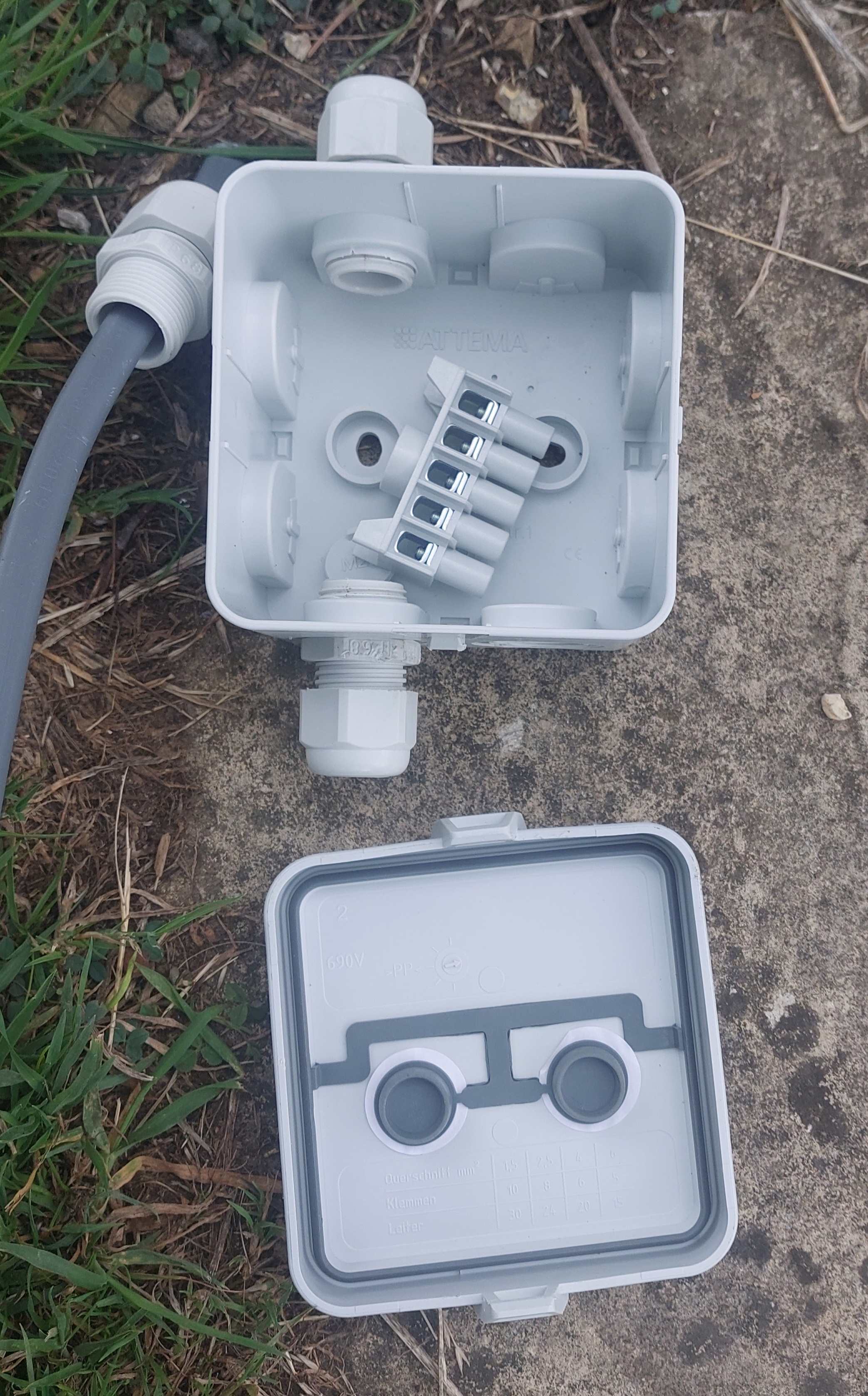

saveasteading Posted Sunday at 15:12 Author Posted Sunday at 15:12 (edited) For interest. I've found this connection box in my stores. It seems to be very classy with 3 screw-in sleeves with integral and tightening seals. The box back is completely in one piece of moulding, and the holes are made by tightening in the sleeves, whence the knockouts break off. Also a connector block. It is made by els Spelsberg, and also labelled Attema. New names to me but the build quality (and attention to detail) is astounding. There are also 2 sealing grommets stuck to the front plate, presumably to seal the screw holes. I cannot figure out what the rubber strip joining these grommets and extending to the rim seal is for? PS. Ive found it is available at SF for £8.99. But it is described as "unbranded". Edited Sunday at 15:16 by saveasteading PS
Nickfromwales Posted Sunday at 16:08 Posted Sunday at 16:08 55 minutes ago, saveasteading said: I cannot figure out what the rubber strip joining these grommets and extending to the rim seal is for? Sacrificial, as it's part of the manufacturing process where the material is injected. 1

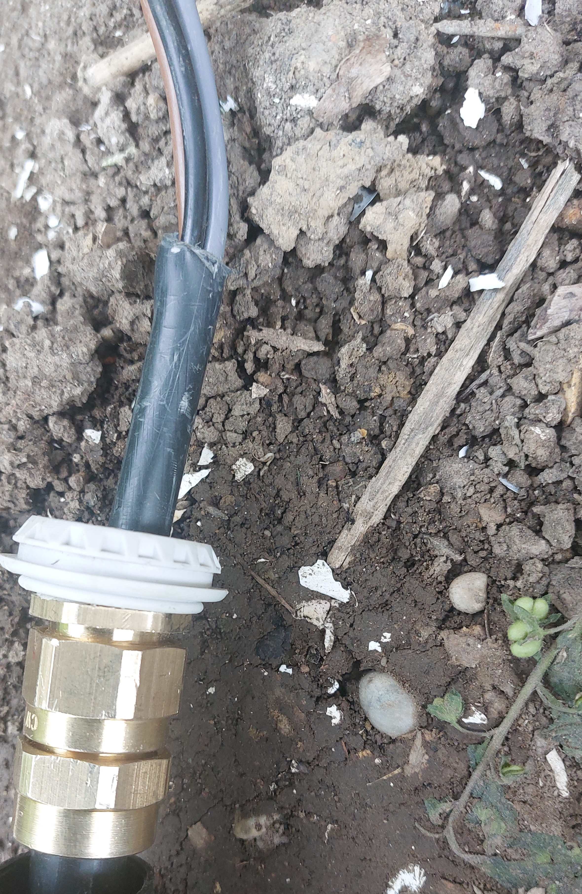

Nickfromwales Posted Sunday at 16:16 Posted Sunday at 16:16 57 minutes ago, saveasteading said: It seems to be very classy with 3 screw-in sleeves with integral and tightening seals AKA cable entry / stuffing glands. I use these exact same boxes on outdoorsy stuff, and like the fact the lids are click on / off. I always set the box in place, drill the fixings holes, and then remove. Then I apply a bit of CT1 to the holes and put the box back in place so the screws go through wet CT1 for belt & braces; even more so if the box is subject to driving rain. Apply just enough so that it gets displaced and comes through the fixing holes. You'll notice the 4 square tabs that are visible at the centre of each side. Ironically, these are drain holes, and you should punch out whichever one is the lowest point of the box, when mounted. This allows any water or moisture to escape in the event of some getting in there, howsoever. Basically so the box cannot slowly fill with water /moisture over time. I also seal 3 sides around with the same clear CT1, but never do the bottom edge, for the same reason so that any water that gets behind can run down and out. 1 1
