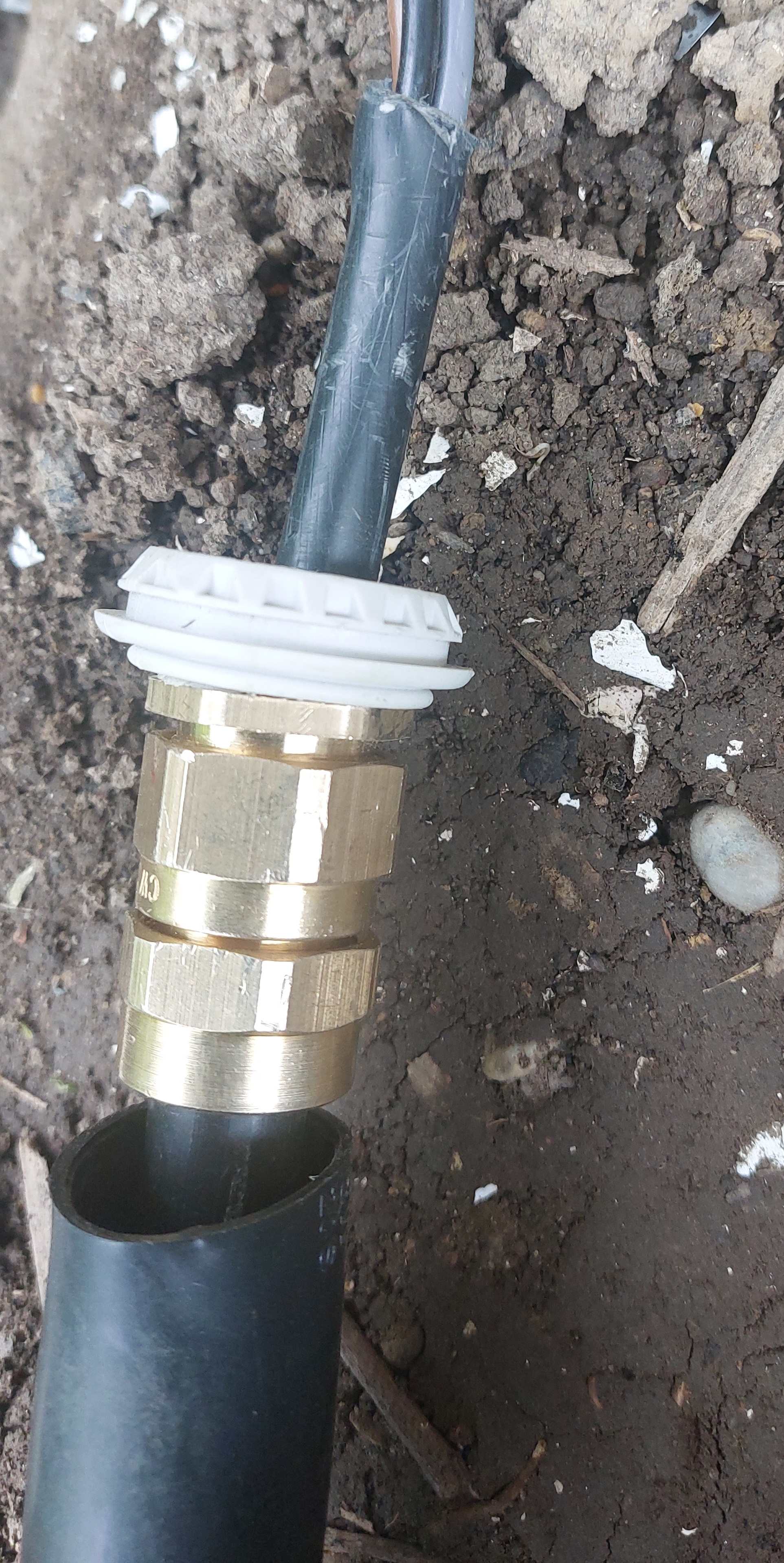

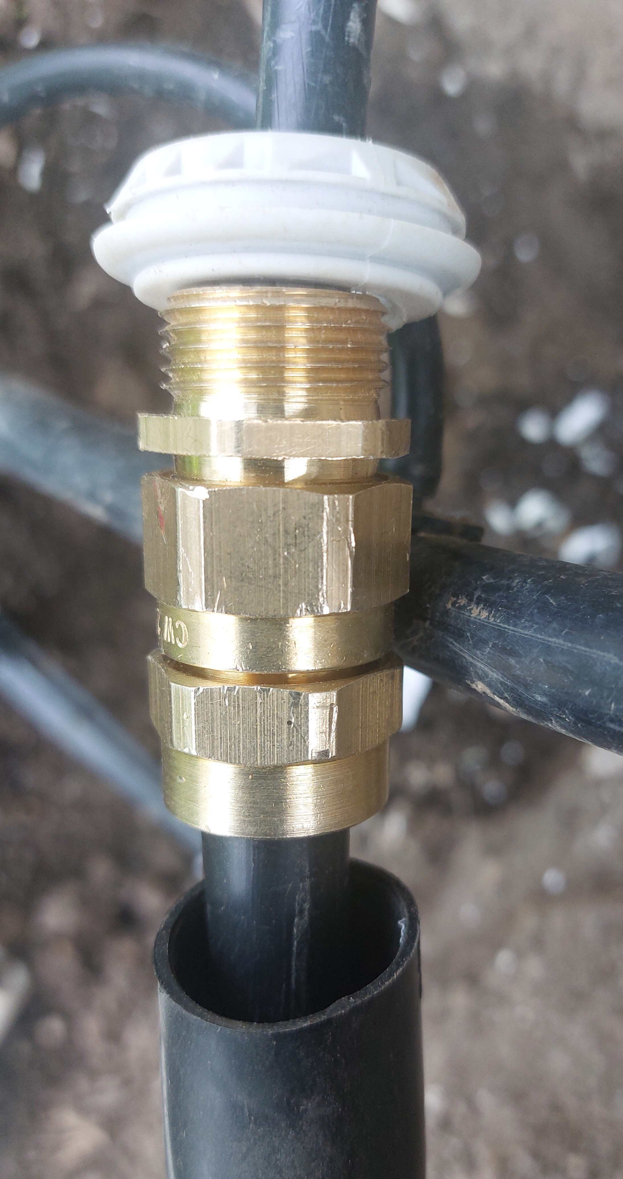

saveasteading Posted July 23 Posted July 23 My first time hands on with SWA. I've done one end of this cable into an existing box. Slow but successful. At the other end the grommet is deeper than the thread and I can't tighten it. If I take the next diameter off the grommet for depth, the fixing goes straight through. The grommet doesn't compress either. Am I doing something wrong or is there a trick?

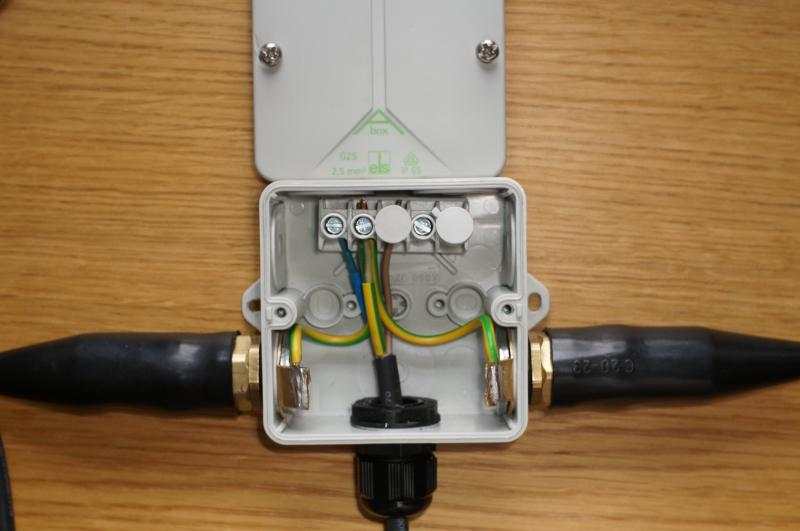

JohnMo Posted July 23 Posted July 23 You don't put the metal gland through the grommet. A different junction box would be easier. You need a 20 or 25mm hole and the gland gland goes directly into JB More like this 1

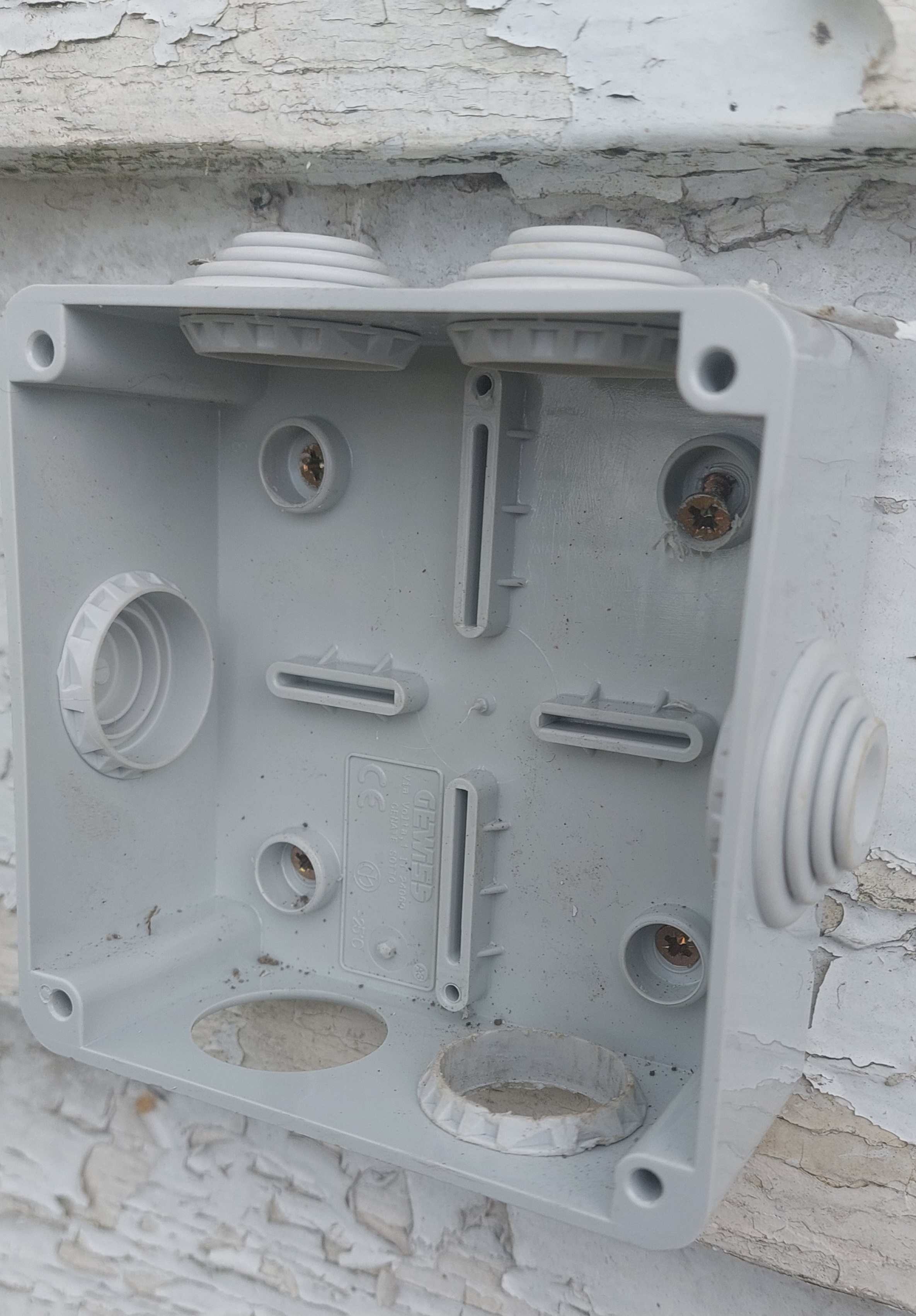

saveasteading Posted July 23 Author Posted July 23 So it's the wrong box, made for multiple cable sizes and the hole is too big? I see in your pic, there is a grommet for the small cable. I've a thought. The cable entry is at the bottom and has the supplied shroud so water won't get in. A couple of washers might suffice as tightening surfaces. 1

garrymartin Posted July 23 Posted July 23 Not that it will help now, but going into a plastic box, potentially outside, I'd always go with the correct sized Storm gland... https://www.electricpoint.com/swa-storm20s-lsf-armoured-cable-glands-m20-20mm-ip68.html 1
TerryE Posted July 23 Posted July 23 @saveasteading YouTube is your friend here. There are lots of howto videos; watch a few. One trick that's important is making sure that you cut the SWG sheath neatly and to the right length. You need to mark the snip line and use a decent pair of wire snips that are man enough for the wire gauge. I don't know if its the recommended way but I have an old fashioned adjustable pipe that rated up to 28mm copper. I just cut the outer PVC sleeve with a knife as a guide, then do a dozen + turns to finish cut into the SWG to notch it. Doing it this way keeps the wire well clamped for the nothing I then cut back the outer sheath to the notch ring and then fatigue break the SWG wires around the notch; cut back the outer to size according to the fitting instructions. Slide the other cover and locking ring over the wire before rolling around the centre 4 / 4 core to flare the wire sheath so than the gland can easily slide into it. As I said look at the videos. After a few fitting, this only takes a few mins mad you will end up with neat jobs like @JohnMo's.

saveasteading Posted July 23 Author Posted July 23 Thanks all. Ill have a proper read through later. The earth tags just about work in getting a fix, but it's not tight. The existing box I now see has these fixed size pop- outs as described and the same make as the photo. ....hence the first one went well. The second one is a proper outdoors box from my stores.. def not so good. Probably from Homebase sale 10 years ago. The cable I've replaced looks like bell wire. its amazing it worked so long underground. I've cut it where it runs up the wall, and will later replace it Into the house. It's also quite brittle But I've connected it. But the power tripped when I turned it on. Grrrr I'll give it a look at tomorrow and hope to see where the short is. It shouldn't be difficult but it's all tight for space in the box. Any ideas why swa has grey wires not blue? Have I done anything silly? Brown to brown Grey to blue Earth or bare wire to black.
