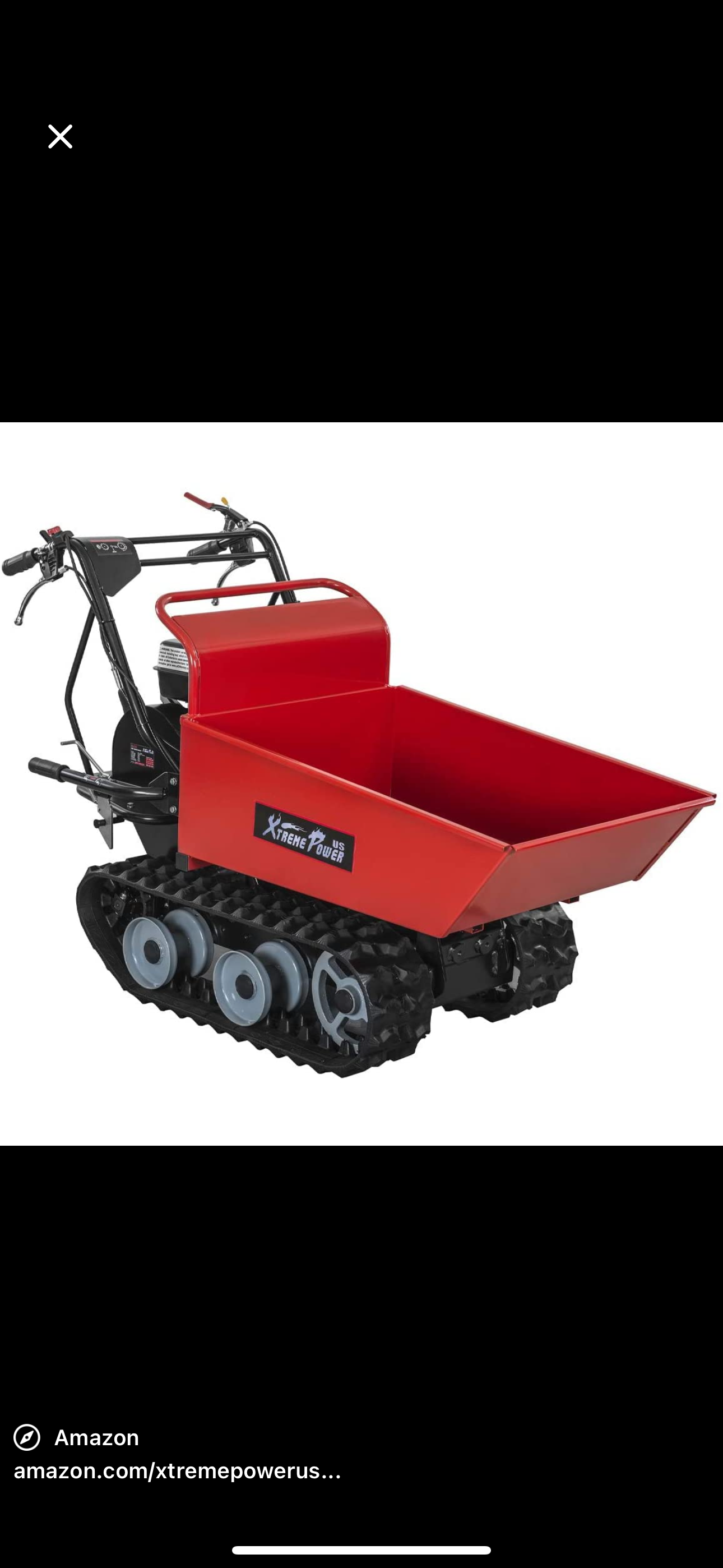

Pocster Posted July 14, 2025 Posted July 14, 2025 Maybe ? Literally last week saw something like this . The guy was able to stand on a platform at the back and the bucket could be raised to empty into a skip . Depends on width and what turning space you need to get through your house . 1
Tetrarch Posted July 14, 2025 Posted July 14, 2025 1 hour ago, Claire O said: This measurment is very helpful... I will measure all the doors next time I am there. It's not just the width, the excavator tracks may do a huge amount of damage to the floor and the length will determine whether it can navigate your maze (and how long it takes) Regards Tet 1
Pocster Posted July 14, 2025 Posted July 14, 2025 1 hour ago, Tetrarch said: It's not just the width, the excavator tracks may do a huge amount of damage to the floor and the length will determine whether it can navigate your maze (and how long it takes) Regards Tet True . Could put osb down I.e make a nice path for it protecting the floor . More of an issue would be any turns required and indeed how narrow passages are … 1
