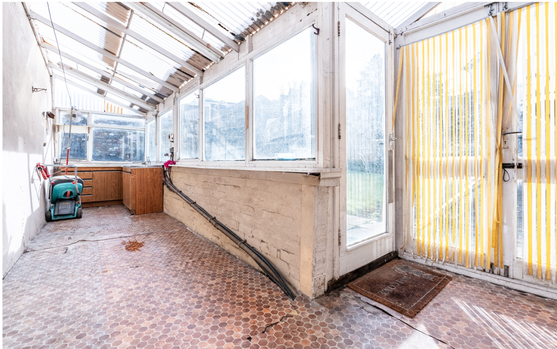

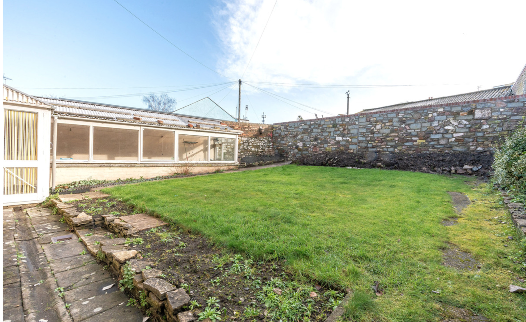

July 13, 20251 yr Hey all, looking for some advice on garden soil removal. We’re buying an old Georgian house, and because of budget constraints, we can’t do everything at once. We're prioritising the inside first—rewiring, plumbing, new kitchen and bathrooms. The garden has no side or back access (only through the house), and there’s an old conservatory out the back. We’ve decided to keep it for now as a teen hangout—just clean it up a bit with some paint, lino flooring, and remove the old cupboards. Long-term plan is to knock down the conservatory, take out the retaining wall, and dig back the raised garden to build a bigger conservatory and create a patio area below the lawn. That would mean shifting a lot of soil. One builder suggested that even if we can’t afford the garden project yet, we should think about removing the soil now—before we renovate—because getting a digger through the house later won’t be possible, and doing it all by hand would be a nightmare and super expensive. Problem is, we don’t have the money for that right now, and removing the soil now would leave the garden pretty messy with nothing to finish it off (no retaining walls, no landscaping, no proper drainage). So I’m wondering: Has anyone had to remove a lot of soil through a house without a digger? How bad was it? What did it cost? Any clever workarounds? Thanks in advance—any tips much appreciated!

July 13, 20251 yr 22 minutes ago, Claire O said: there’s an old conservatory out the back 22 minutes ago, Claire O said: Long-term plan is to knock down the conservatory, take out the retaining wall, and dig back the raised garden to build a bigger conservatory and create a patio area below the lawn. That would mean shifting a lot of soil. Assume with the conservatory removed you get side access again. Knock it down, prior to rebuilding do the soil, and bring hard landscaping materials. Going through house is nonsense. Or get creative on what you can do without removing materials from the back. Bet that conservatory is a melting hot this time of year, and colder than a cold thing in winter.

July 13, 20251 yr Author . In a few years, I was hoping for something like this.... its a lot of clearing of soil to create any patio to fit a table....

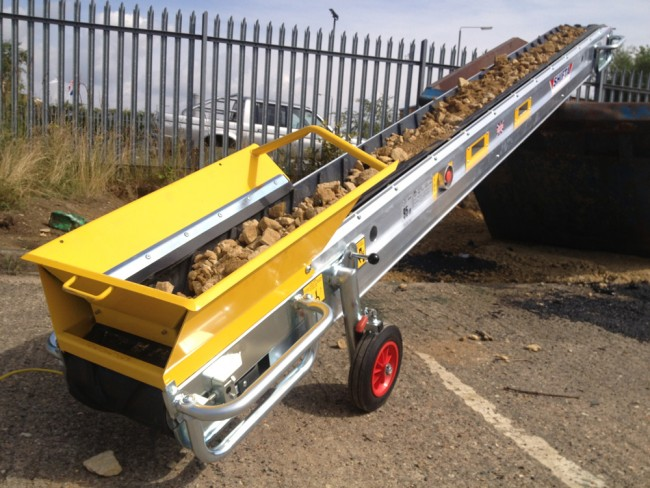

July 13, 20251 yr Can't see it costing £30K to be honest. As mentioned earlier, if you have somewhere out the front to move it to for collection by a grab lorry, and assuming you can create a fairly straight exit run through the house, I'd be getting the builder to hire some soil removal conveyors. Set as many as needed up in series through the house, fill them in the back garden and have them depositing to the front. A week's hire for a 4.5M one is about £200-250, so depending on how many you would need, less than £1000 probably with no filling and emptying of bags - either straight into a skip or on to a front garden for grab lorry collection.

July 14, 20251 yr Author 14 hours ago, garrymartin said: Can't see it costing £30K to be honest. As mentioned earlier, if you have somewhere out the front to move it to for collection by a grab lorry, and assuming you can create a fairly straight exit run through the house, I'd be getting the builder to hire some soil removal conveyors. Set as many as needed up in series through the house, fill them in the back garden and have them depositing to the front. A week's hire for a 4.5M one is about £200-250, so depending on how many you would need, less than £1000 probably with no filling and emptying of bags - either straight into a skip or on to a front garden for grab lorry collection. Interesting idea... I will mention this to the builder but with the back garden, to the kitchen, to the hall, to the front entrance to the front garden, then I might need 5 or so of these, so my question is - do they connect well to each other?
July 14, 20251 yr Author 16 hours ago, Onoff said: Careful you don't lower or raise your garden to the point of it causing issues on the boundary. We've had walls leaning and gardens slipping on here and it gets very acrimonious. Its already low next to the house, but quickly raises a couple of fit from the house, and on a gradual incline the entire grassed area... I wont be lowering anything below the current lowest point which is the same level as the house.
July 14, 20251 yr Author 16 hours ago, Roundtuit said: Does it have to come out? Can't you level off where the patio will be and put the soil behind your new retaining wall? If we were willing to raise the last tier, I suppose we could move some of it to the highest tier. I hadnt planned on raising any parts though as it is already quite high compared to the house.

July 14, 20251 yr 23 minutes ago, Claire O said: do they connect well to each other? They don't connect per se. The soil will travel uphill at an angle and will then drop off onto the next one. If you Google "soil removal conveyors", there will be lots of photos and videos showing how they operate.
