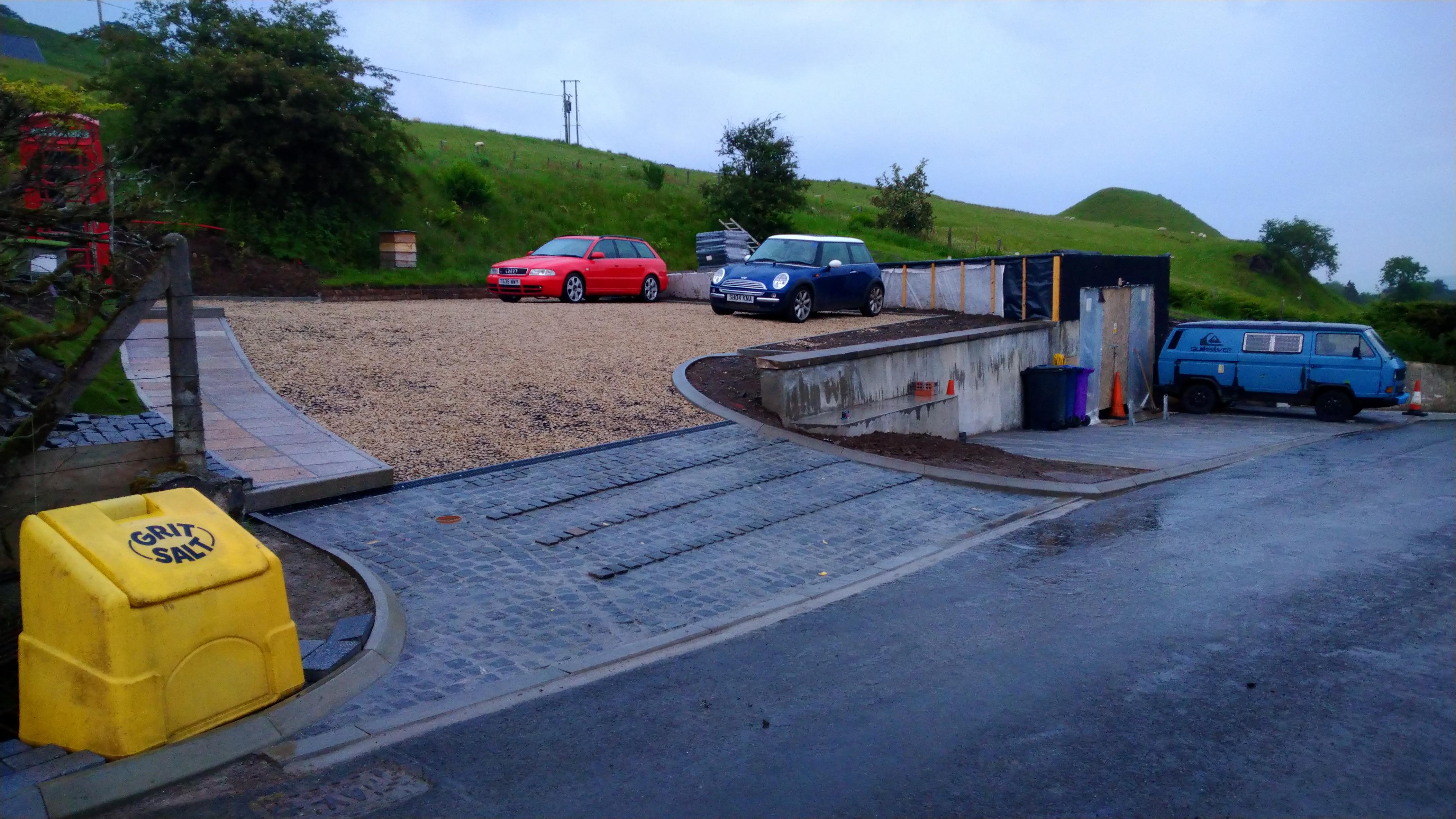

jamiehamy Posted June 20, 2019 Share Posted June 20, 2019 We've just had our driveway finished with Bodpave. Very grippy. Was super easy to put down once the levelling was done. Quite a bit of it showing, going to give it time to bed in and maybe put some more chips on top. 2 Link to comment Share on other sites More sharing options...
Jeremy Harris Posted June 20, 2019 Share Posted June 20, 2019 Really like the K6 telephone box. I've wanted one for years, but SWMBO vehemently opposes the idea every time I've suggested it. 1 1 Link to comment Share on other sites More sharing options...
jack Posted June 20, 2019 Share Posted June 20, 2019 42 minutes ago, JSHarris said: Really like the K6 telephone box. I've wanted one for years, but SWMBO vehemently opposes the idea every time I've suggested it. We seriously considered having one in our house, possibly set up as a bar. Hard to justify the cost at the time though... Link to comment Share on other sites More sharing options...
jamiehamy Posted June 20, 2019 Share Posted June 20, 2019 12 minutes ago, jack said: We seriously considered having one in our house, possibly set up as a bar. Hard to justify the cost at the time though... Plus the weight considerations - 750kgs! All the parcels go in there and we also have a letter box. Camera keeps and eye on everything. 3 Link to comment Share on other sites More sharing options...
