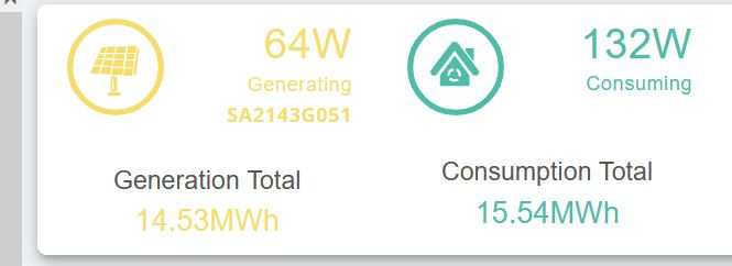

Simon R Posted July 18, 2025 Posted July 18, 2025 10 hours ago, SteamyTea said: Still an expensive way to supply power. Large scale solar is so cheap, compared to domestic scale, you can't really compare the two. Yes, but given the time its going to take to upgrade the grid and do all the other work required for storage it's still worth 'acting local, thinking global' if you can afford it. With an 9.2kWh battery and 3.6kW inverter installation net consumption from the grid is just a megawatt since 10/2022 when the system was installed. Exports to the grid help reduce the need for gas generation....yes, piddling amounts but it helps. It's not all good as my solar will be exporting at times when other cheaper solar sources are available and I'll be drawing from the grid on cloudy days. Generation pricing is currently wrong and needs to be fixed basing it on gas pricing with the current generation mix is just wrong.
SteamyTea Posted July 18, 2025 Posted July 18, 2025 37 minutes ago, Simon R said: With an 9.2kWh battery and 3.6kW inverter installation net consumption from the grid is just a megawatt since 10/2022 when the system was installed That is impressive. But not wanting to dampen things, you have also paid for a better insulated house, a heat pump (I assume) and probably tough out the odd days with thicker jumpers. But it does show that a lot can be done, relatively affordably.
