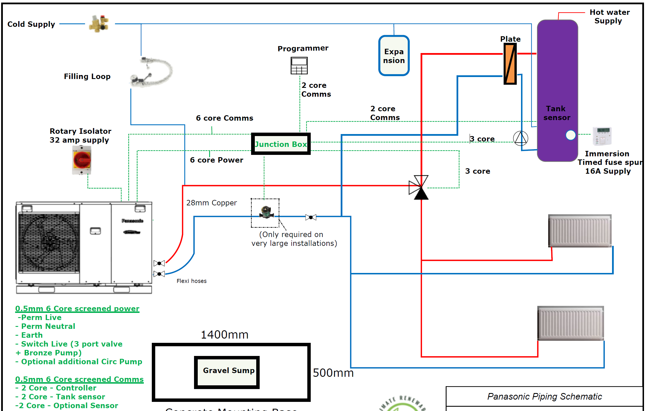

July 13, 20251 yr Glad to see interest in the plate heat exchanger! There is a circulation pump 'behind' the plate to stir it all up. schematic of our system below. Also worth noting that non-coiled cylinders are upto 30% more efficient than coiled ones. It all adds up right.
July 13, 20251 yr 9 hours ago, Nickfromwales said: Most modern UVC's have very low standing losses, and we are advocates here of a bit of oversizing so the stored temp can be around 50-550C, further reducing losses. Good advice if it's a thermal store for DHW though. 52C max from the heat pump worked out best CoP for me. Free overnight electric and excess solar drives it to 80C via immersion.
July 13, 20251 yr On 11/07/2025 at 08:43, Dave Jones said: not so, ,I have plate and the ASHP is the only pump in the loop. There's a circulation pump for the secondary/cylinder side of your PHEX in the schematic you've not long posted????
July 13, 20251 yr 26 minutes ago, Dillsue said: There's a circulation pump for the secondary/cylinder side of your PHEX in the schematic you've not long posted???? Bronze too by the look of it.
July 13, 20251 yr 1 hour ago, Nickfromwales said: Bronze too by the look of it. So someone knew what they were doing...
