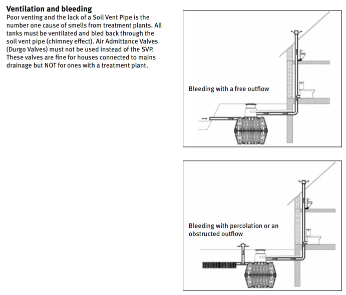

MortarThePoint Posted June 25, 2025 Posted June 25, 2025 Looking at Part H I see a conflicting pieces of information: So which is it, 32mm, 50mm or 75mm? I understand the need for a large diameter if it is to allow air into the stack and there is no AAV as it has to provide a reasonable flow of air as the waste water rushes through the lower pipes. Even so, air moves much more easily through a pipe than water does. I was planning to just have an Durgo/AAV, but think I need an SVP to allow positive pressure from my sewage treatment plant (STP) to vent. Any such venting from the STP would have low flow rates and could therefore go though a narrow pipe (to a roof tile vent). Even 20mm pipe would be plenty big enough I don't fancy a 75mm pipe going up the bathroom wall and a 32mm one would be much more acceptable. Can I plead the case if I have a Durgo/AAV for the high flow inlet requirement?

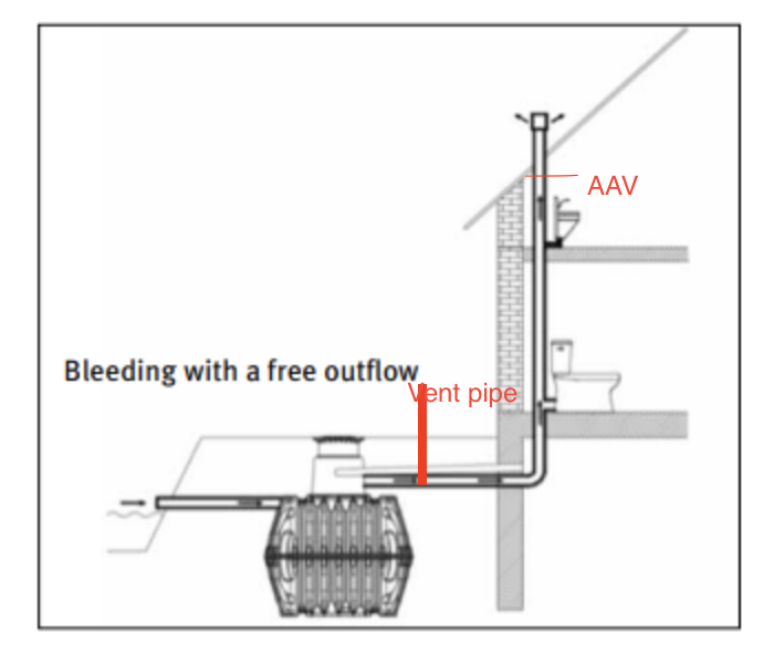

Nestor Posted June 25, 2025 Posted June 25, 2025 I have a vent pipe about a metre before the treatment plant main inlet and an AAV just above upstairs WC. Did not want a vent pipe penetrating the building. BC happy with that. 1

MortarThePoint Posted June 25, 2025 Author Posted June 25, 2025 5 hours ago, JamesP said: I have a vent pipe about a metre before the treatment plant main inlet and an AAV just above upstairs WC. Did not want a vent pipe penetrating the building. BC happy with that. I have already been including AAVs at the end of all my significant branches (before any vertical sections of 110mm pipe so that should satisfy any negative pressure requirement (i.e. stop traps from being sucked out). I understand that septic tanks need a low level inlet and high level outlet so as to create a flow though of fresh air, but a STP has a pump so any outlet I would expect to be OK surely. Maybe not one of the BioRock type or spinning disc ones though, but I'm not considering those. I am considering Graf One2Clean and Marsh Ensign systems. The Graf looks to have significantly cleaner effluent, easier to have granular backfill rather than concrete and also has a non-continuous pump which saves energy. They do talk about having a 'chimney effect' though which I assume is to prevent smells coming out of the low level pipe.
Nickfromwales Posted June 25, 2025 Posted June 25, 2025 7 hours ago, Russell griffiths said: Vent your STP at the tank, run a vent pipe out from the tank and up behind a shed or behind some shrubs, there is no smell from mine whatsoever. Done this for 2 other jobs, no issues, no smells, and only AAV (Durgo's) inside the house with zero roof penetrations. 1

Nestor Posted June 25, 2025 Posted June 25, 2025 4 hours ago, MortarThePoint said: I may end up plumbing the detached garage just for this reason. Will probably be grateful of having a sink in there too I have just done this, WC, shower, sauna and a kitchen sink. We have a Vortex TP, simple but functional design with an air bubbler. Its about 30 metres from the house. No penetrations through the building as @Nickfromwales mentioned. Scrappy image below.

Kelvin Posted June 26, 2025 Posted June 26, 2025 (edited) 19 hours ago, MortarThePoint said: I may end up plumbing the detached garage just for this reason. Will probably be grateful of having a sink in there too Exactly what I did. I have an SVP out the garage roof, AAV in the roof void, and another SVP after the tank. No smells. No penetrations through the house and a clean roof with no unsightly pipes coming out of it. Graf system. Edited June 26, 2025 by Kelvin 1
