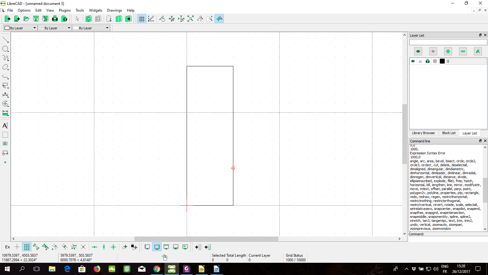

LouiseSJPP Posted December 26, 2017 Author Posted December 26, 2017 Given the replies so far, I've picked up on a 2D package, again the open source one, LibreCAD, an AutoCAD clone. I'll start the laying out in this, perhaps using FreeCAD 3D to rough out a few shapes to see how they look at an early stage, then going to physical models when the design is shaping up. Thank you all for your advice Louise

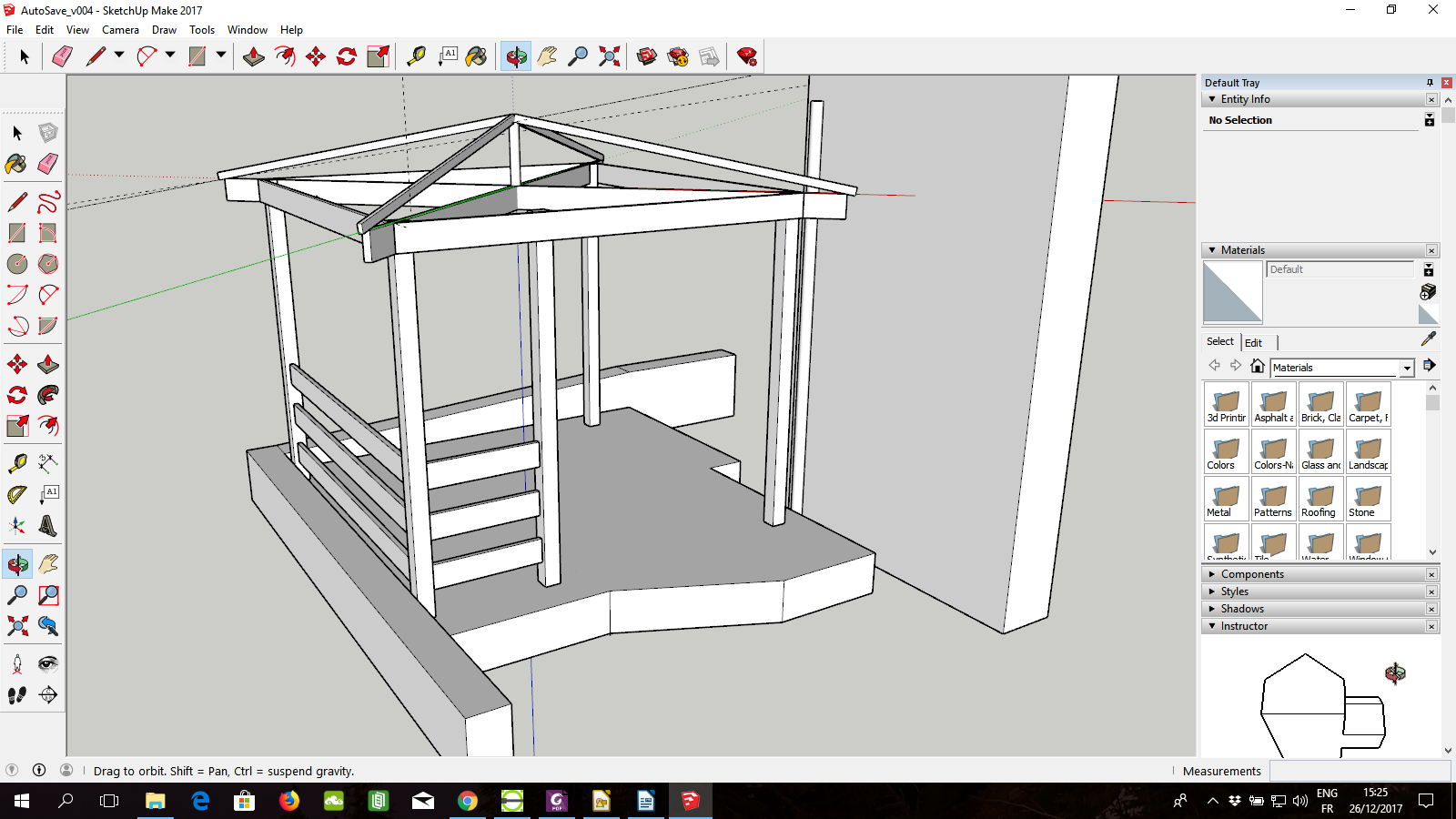

Guest Alphonsox Posted December 26, 2017 Posted December 26, 2017 I did our 3D designs using Sketchup. The main problem with this package I that it is superficially easy to use. I had problems until I sat down and went through a set of architecture/building based tutorials, at which point everything started to make a lot more sense. I’m not sure what you mean by “less than robust” and “assumed constraints”. It is a widely used package and very flexible.
Onoff Posted December 26, 2017 Posted December 26, 2017 1 hour ago, LouiseSJPP said: Given the replies so far, I've picked up on a 2D package, again the open source one, LibreCAD, an AutoCAD clone. I'll start the laying out in this, perhaps using FreeCAD 3D to rough out a few shapes to see how they look at an early stage, then going to physical models when the design is shaping up. Thank you all for your advice Louise Is LibreCAD as close a clone to AutoCAD as Draftsight is? Coming from AutoCAD I was using Draftsight in literally seconds.
LouiseSJPP Posted December 26, 2017 Author Posted December 26, 2017 23 minutes ago, Onoff said: Is LibreCAD as close a clone to AutoCAD as Draftsight is? Coming from AutoCAD I was using Draftsight in literally seconds. It was years ago since I last saw AutoCAD, but the command line approach looks very familiar:

LouiseSJPP Posted December 26, 2017 Author Posted December 26, 2017 (edited) 1 hour ago, Alphonsox said: I did our 3D designs using Sketchup. The main problem with this package I that it is superficially easy to use. I had problems until I sat down and went through a set of architecture/building based tutorials, at which point everything started to make a lot more sense. I’m not sure what you mean by “less than robust” and “assumed constraints”. It is a widely used package and very flexible. I did a practice piece a while ago, a pergola design. The sloping wall at the back was a huge problem to create. It was done in segments, but each time I tried to add the third and final segment, I'd get part of it going hollow, becoming a series of faces rather than a solid. There seemed to be no way to control it. The feeling I got throughout was lack of control, not enough tools, too much simply hoping it would do what I wanted. Edited December 26, 2017 by LouiseSJPP
Onoff Posted December 26, 2017 Posted December 26, 2017 LibreCAD looks much, much more basic compared to Draftsight. Tbh even using Draftsight I find myself wanting to do 3D and it's very limited. You can for example EXTRUDE but then can't SUBTRACT solids etc. If you import a drawing created in Draftsight into AutoCAD the latter throws a hissy fit. Can't remember if it's Solid Edge or Works I want to look at as it can generate interactive PDFs.

Guest Alphonsox Posted December 26, 2017 Posted December 26, 2017 1 hour ago, LouiseSJPP said: I did a practice piece a while ago, a pergola design. The sloping wall at the back was a huge problem to create. It was done in segments, but each time I tried to add the third and final segment, I'd get part of it going hollow, becoming a series of faces rather than a solid. There seemed to be no way to control it. The feeling I got throughout was lack of control, not enough tools, too much simply hoping it would do what I wanted. Try grouping things - Sketchup works best if you assemble larger blocks from smaller elements. In this example I would group the base, the top, and the ladder sections as separate elements then assemble.

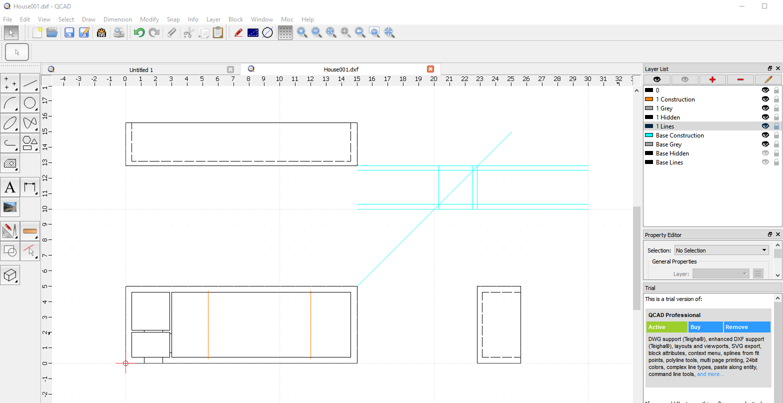

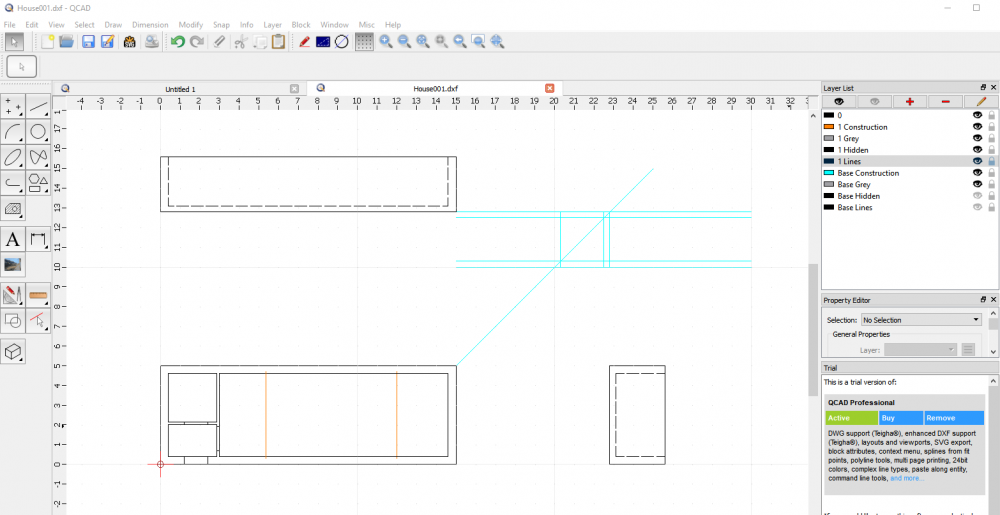

LouiseSJPP Posted December 28, 2017 Author Posted December 28, 2017 I was doing so badly with the different CAD packages, I began to wonder if it was me the problem. In desperation, I looked around for yet another package, last ditch attempt. I came across another open source package, QCAD. I downloaded it and opened it, and began drawing. No need for tutorials, everything was laid out ready to use. The manual is well put together, and easy to dip into for detail. Maybe it''s just that this package suits my workflow, but I found QCAD to be a refreshing chnage after all the recent frustrations. It's not free, the trial version runs for 15 minutes at a time, but the price is low, 33 euro here. Whether I'll use FreeCAD or physical models to add to the 2D I'm not sure yet, but for now, the log jam is released and I can begin a creative process Louise
PeterW Posted December 28, 2017 Posted December 28, 2017 QCAD is very nice and the only reason to go pro edition is to get some of the plug in tools. It’s currently running on my Linux desktop and I find it really easy to use too.
