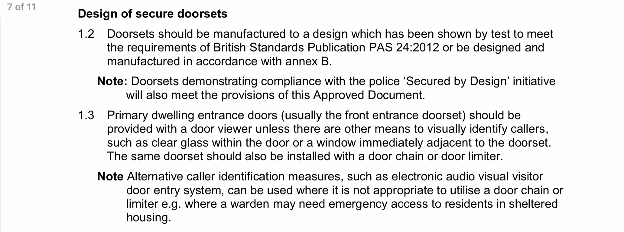

Hi All,
My front door on my new self build will be solid with glass side panel on either side which will be obscured. I’ve been told by window surveyor that I have to have a spy hole unless I have clear glass. I raised the question with them if a ring door bell can mitigate the need for a spy hole however they are not sure. Can anyone provide any clarification? Thanks 😎

Wow, it is always a surprise to find another building reg, that you haven't observed. My inspector didn’t seem to care about front door spy hole, nor the security chain.
Is this actually a building reg? My door supplier never mentioned it. The answer is YES.
It gets worse, apparently the DDA Compliance (Disabled Discrimination Act) dictates the height of the spy hole. Sometimes you will need to fit two to comply, eek!
Here is the passage from Approved document Q:
@Berkshire_selfbuild, you will be alright with a Ring doorbell.

But, as often in bregs, note  " should" , "or other" etc.
"Alternative caller identification measures" might include a letter box to shout through.
Tell bco you are fitting a Ring and get his aok.
And doubt your window surveyor, whatever one of them is...should be expert and clearly isn't expert or on your side.
Doesn't the Note (as posted by @Nick Laslett ) cover what you asked.
Your door bell is an audio visual entry system. I really wouldn't ask anyone anything, just say no to your salesman and move to the next topic.
