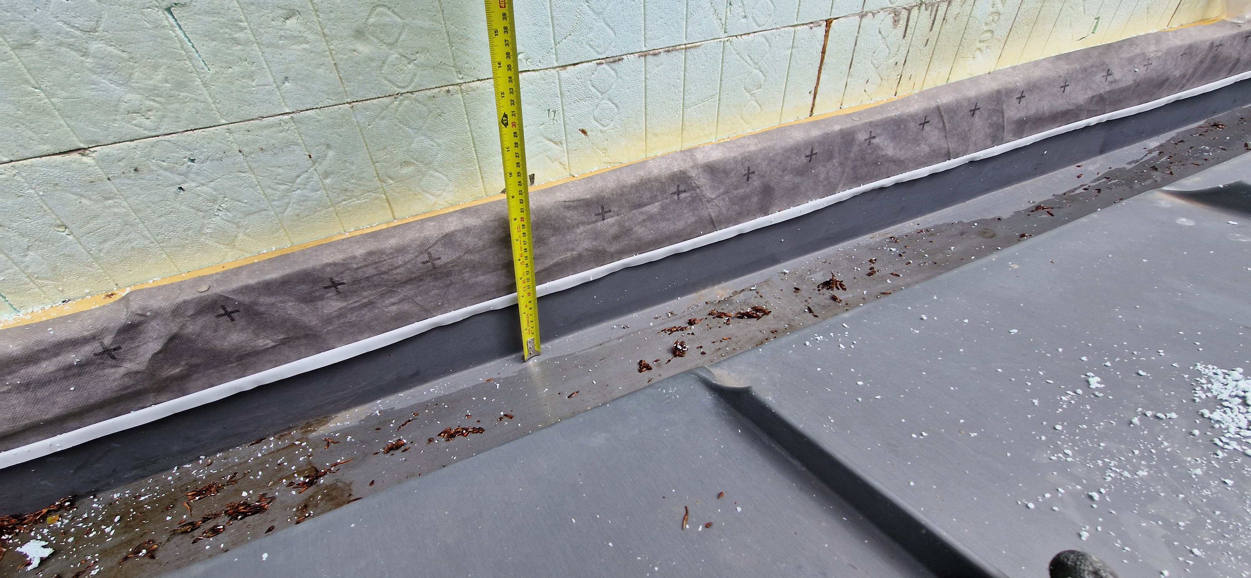

Mulberry View Posted Tuesday at 20:14 Posted Tuesday at 20:14 Some of you know the woes we face with our Zinc Roof. The first major contractor on site and it all ended in disaster. You can read more about it here. It's trundling slowly down the legal pathway and is likely to take a long time because the contractor is simply not cooperating at all. But I need to be able establish a plan to progress as it's causing me a lot of anxiety. The house build is my occupation and to not be able to move on at any pace is giving me a sense of failure and not helping my self esteem at all. I'm finding bits and pieces to do, but we certainly face ANOTHER winter in the Caravan after SWMBO saying that Christmas 2024 was the last she'd do in the Caravan. In a nutshell, we paid £20k for an Architectural package that got us to RIBA Stage 4a (Building Regs Plans), but the relationship with our Architect broke right down towards the end of that and, in some ways, we were glad because it was the biggest stressor. However, I do attribute the lack of an Architect as to why the roof went the way it did. Had I known how hard our roof would be to detail and how many worrying elements we would be stuck with, we would have pushed back. But what would that have meant for the design we were overall happy with and we had planning approval on? Maybe a total redesign. So we went for it, we trusted an expert who assured us that any missing details would be taken care of by their "superior experience". He had so much to say about how it wouldn't have mattered if the Architect had detailed it, they know best where Zinc is concerned. We felt confident. Cutting a long story short, I honestly think the whole lot heeds to come off and a different system used. VM Zinc just don't offer a nice detail for rooflights in a 5° Monopitch without a tonne of solder. My question is, what did we do wrong? Should we have had an Architect produce a full set of technical details ahead of tender? Should we have relied on a specialist installer but with drawings to sign off before work started? I'm trying to foresee how to get out of the hole we're in because the problems have to be fixed, regardless of the court outcome. The advice I'm seeking is not about what to do with the legal stuff, but how we can get things moving on site again. Should I be trying to get another Architect or Architectural Technician onto the project to re-design and detail the roof? Or can I rely on a metal roof installation company to provide the full detail package within their quote? In essence, I need to know that a good outcome is guaranteed because it feels hard to commit to the big ticket items (Windows etc) without knowing where we stand and that the design can even be roofed reliably. I also realise that if we go any further with the internal works (Insulation/UFH/Screed), the scaffolding for the re-roof might then have to be a top-hat (££££££££). A part of me knows that we eventually need to take the original Architect to court, but with the roof action going on and the project as a whole, there's no way I can contend with that at the moment, even though I know that if it was to swing in our favour, the outcome could mean an answer to all this mess. Hoping for some rational and practical help from the good chaps and chapesses of Buildhub!

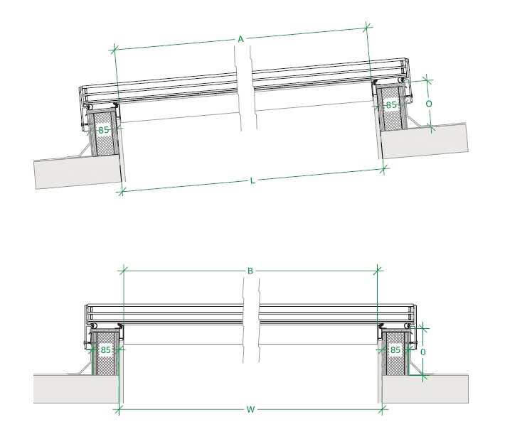

Mulberry View Posted Wednesday at 21:07 Author Posted Wednesday at 21:07 14 hours ago, Russell griffiths said: Are you unhappy with the whole roof, I thought it was a couple of upstands around a window that where being difficult. The initial problem was the way the upstands were detailed, preventing £11k worth of Velux rooflights being fitted and this is quite serious in the sense that the only real way to remedy it is to raise the upstands, but this is a monstrous job that would involve cutting the VCL even if it was practical to achieve. As time has gone on, other defects have emerged. There is a lack of any expansion room behind the rooflights, which, I am told is pretty serious. Especially as one of them has 11m of Zinc above it with a potential expansion of 15mm+ over that length. There is also an integral 5m long box gutter with only 100mm upstand along it's length, which, according to VM Zinc should be 200mm. The box gutter went in first, so it can't be remedied without drastic work. 1

Mulberry View Posted Wednesday at 21:46 Author Posted Wednesday at 21:46 4 hours ago, Mr Punter said: Zinc roofing has become fashionable but decent zinc roofers are few and far between. With rooflights, you often need to solder. I would stick with what you have, get the facias, flashings and gutters on and the rest of the outside complete with scaffold away before the end of summer. Get a new zinc roofing contractor and get your windows and doors ordered and fitted. The roof, for better or worse, is mostly finished. Sub-standard, but finished. There are no fascias to go on, what few gutters we have are on and the scaffolding was taken down in December (Nearly 4 months after the Zinc contractor left the site), after us having paid £4000 in over-charges to keep it up in the hope that the original installer would work with us to remedy the problems. Windows and doors are next on my agenda, we're close to a window order, so I need to focus on the issues that are preventing that.

Russell griffiths Posted Thursday at 09:52 Posted Thursday at 09:52 Write a list of the bits you think will not work and let’s go through them one at a time. I personally think you have a few problems that aren’t really as bad as you think. why do you think the box gutter won’t work, because it’s too shallow to contain the amount of water that’s being distributed to it. have you been up there and studied it in a heavy storm. gutters are not normally the problem, it’s the lack of out let’s draining the gutters, so if it’s filling up beyond capacity, then it needs another outlet. have you bought the roof windows, if not can you not change the design to fit the upstand you have. 2
Mulberry View Posted Thursday at 11:52 Author Posted Thursday at 11:52 1 hour ago, Russell griffiths said: Write a list of the bits you think will not work and let’s go through them one at a time. I personally think you have a few problems that aren’t really as bad as you think. why do you think the box gutter won’t work, because it’s too shallow to contain the amount of water that’s being distributed to it. have you been up there and studied it in a heavy storm. gutters are not normally the problem, it’s the lack of out let’s draining the gutters, so if it’s filling up beyond capacity, then it needs another outlet. have you bought the roof windows, if not can you not change the design to fit the upstand you have. The box gutter is pretty big. Its about 5m long, 350mm wide and has a 1:60 fall along its length. Its outlet is 200mm wide into a hopper. I happened to be on the roof yesterday for the first time since the Scaffolding came down at Christmas and noticed that there was a large amount of tree debris in the gutter, so I swept it to the end in readiness to remove it. It was raining at the time, and not particularly hard. I got briefly distracted, but in the hour or so I was gone, the 'dam' of debris had caused the gutter to fill almost up to the 100mm seam. VM Zinc themselves say that if the fall was 3°, then the upstand could be lower, but otherwise it needs to be 200mm. They ignored the photos and dimensions I sent to them and allowed the installer to reassure them that everything is compliant. It makes no sense. The area of roof I'm standing on to take this photo is about 100mm higher the adjacent upstand, yet only 350mm away. We had the roof windows here on site when the Zinc team arrived. They ignored the installation manual (which to be fair doesn't provide specific Zinc detailing) and I still have the Velux flashings in packaging in my site office because their 'solution' apparently wouldn't require them. Velux insist they have to be fitted. Sadly the movement action of the "top hung" window runs to a VERY tight tolerance and by allowing 4-5 layers of Zinc to exist between the upstand and hinges, will effectively move the whole window back by an amount that will probably cause it to foul the upstand as it is opened. I have a report written by a specialist installer organised by Velux that highlights this issue. The hinges pivot at the bottom, so this removes the ability for many of the 'fixes' that others have suggested, such as running zinc 'skirts' around them. I've had almost a year now of trying to crunch this in my brain to solve it. Velux told me I needed to provide at least of 100mm of net upstand height, I provided 145mm (theoretical), but stacked materials and general building 'sloppiness' have resulted in around 120mm in reality, so 25mm was lost somewhere during the installation. The Zinc installers proposed workaround would result in 60mm from the roof deck to the first ingress point, VM Zinc expressly say that's not enough. I say that I do not accept they'll be able to achieve their proposed design at guarantee 60mm, it's far too technical and if the end result is 50mm or even 40mm, then it makes the situation worse. Even the fixed window is a problem because the Window itself lays onto the upstand and 'drapes' over the edges. By design, it is then screwed to the upstand and these screws will penetrate the Zinc and prevent the expansion movement it needs. The screw holes will only be about 50mm off the roof deck because the overall upstand height doesn't meet the dimensions shown here, again due to the stacked materials and weak adherence to tolerances.
Russell griffiths Posted Thursday at 12:18 Posted Thursday at 12:18 What is at the other end of the gutter, can you put in an additional outlet, so one at either end. don’t worry about the fall that’s pretty irrelevant it’s about getting that water out of the gutter. 1
Mr Punter Posted Thursday at 13:20 Posted Thursday at 13:20 Regarding the gutter, if leaves and debris are allowed to build up there will be an issue, no matter how big the upstand, especially as this is not an external gutter. Do you have a regime to inspect and clear the debris? I had issues with Velux and a zinc roof, partly caused by the architect specifying 2 rooflights for which we did not have correct planning that we subsequently had to change and bodge with inevitable leaking. A right PITA. None of this should stop you cracking on with the rest of the build though.
