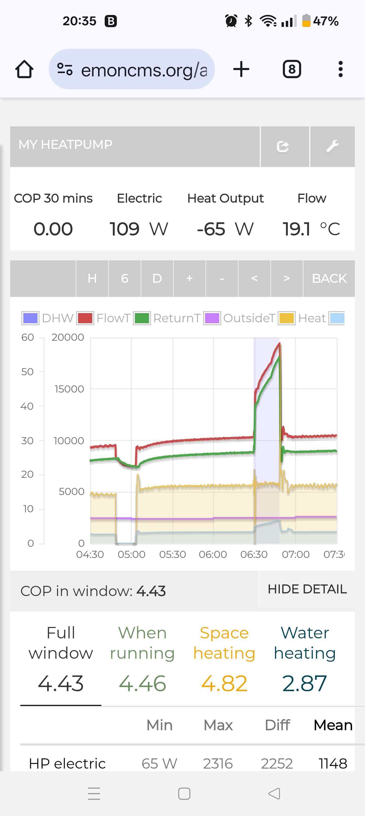

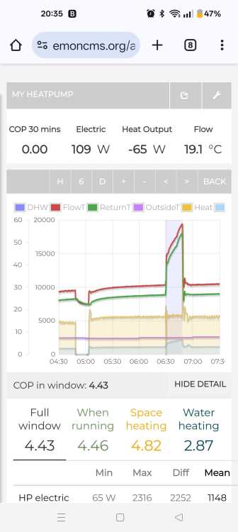

Your cylinder is heated slowly over about 40 minutes, heat pump output temperature slowly increases over the heating period, you should be getting a CoP of about 2.5 to 3.5 depending on heat pump and outside temperature.
Your UFH should be getting a CoP of 4 to 5, maybe 6 at times, that's the difference in high temperature flow and low temperature.
This is mine from the other week. The big peak is DHW heating, the other sides is UFH. The red is flow temperature and green return temperature.
Screenshot_2025-05-11-20-35-07-35_40deb401b9ffe8e1df2f1cc5ba480b12.thumb.jpg.99fa2c83155b21832428fa186d5bd278.jpg
