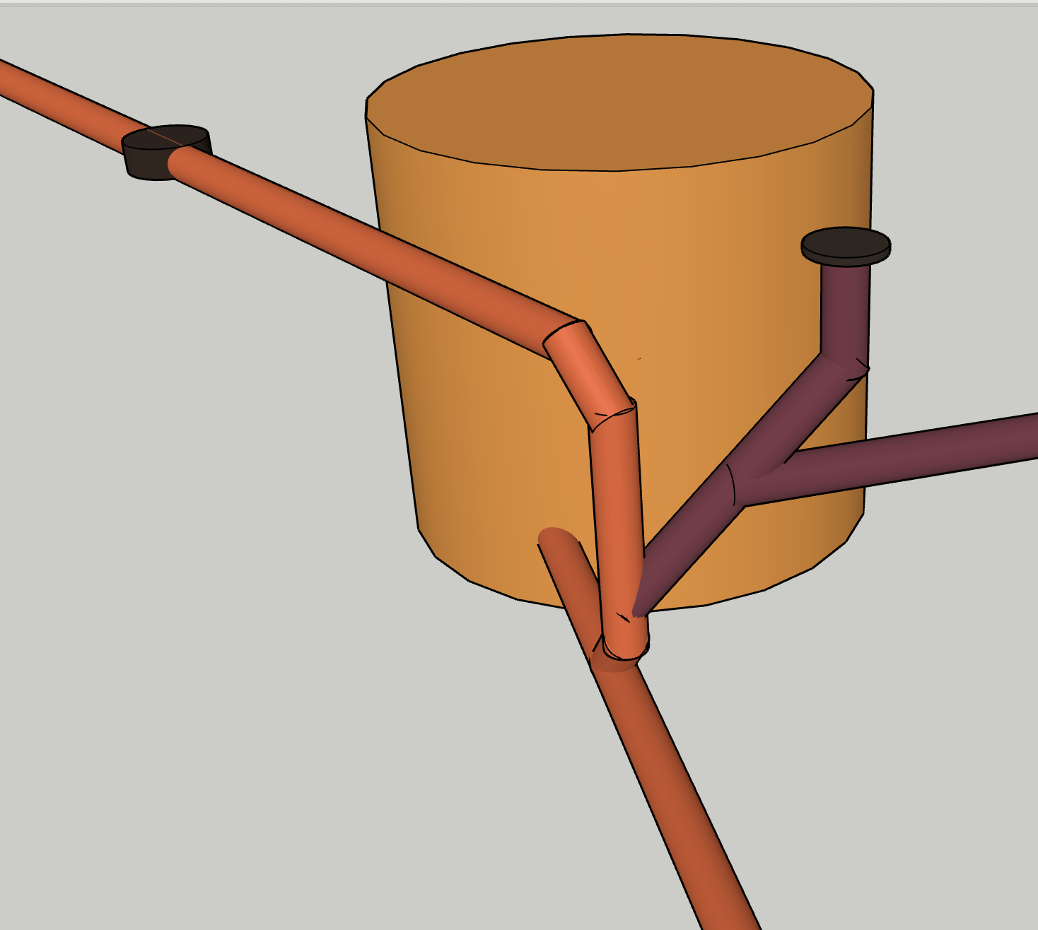

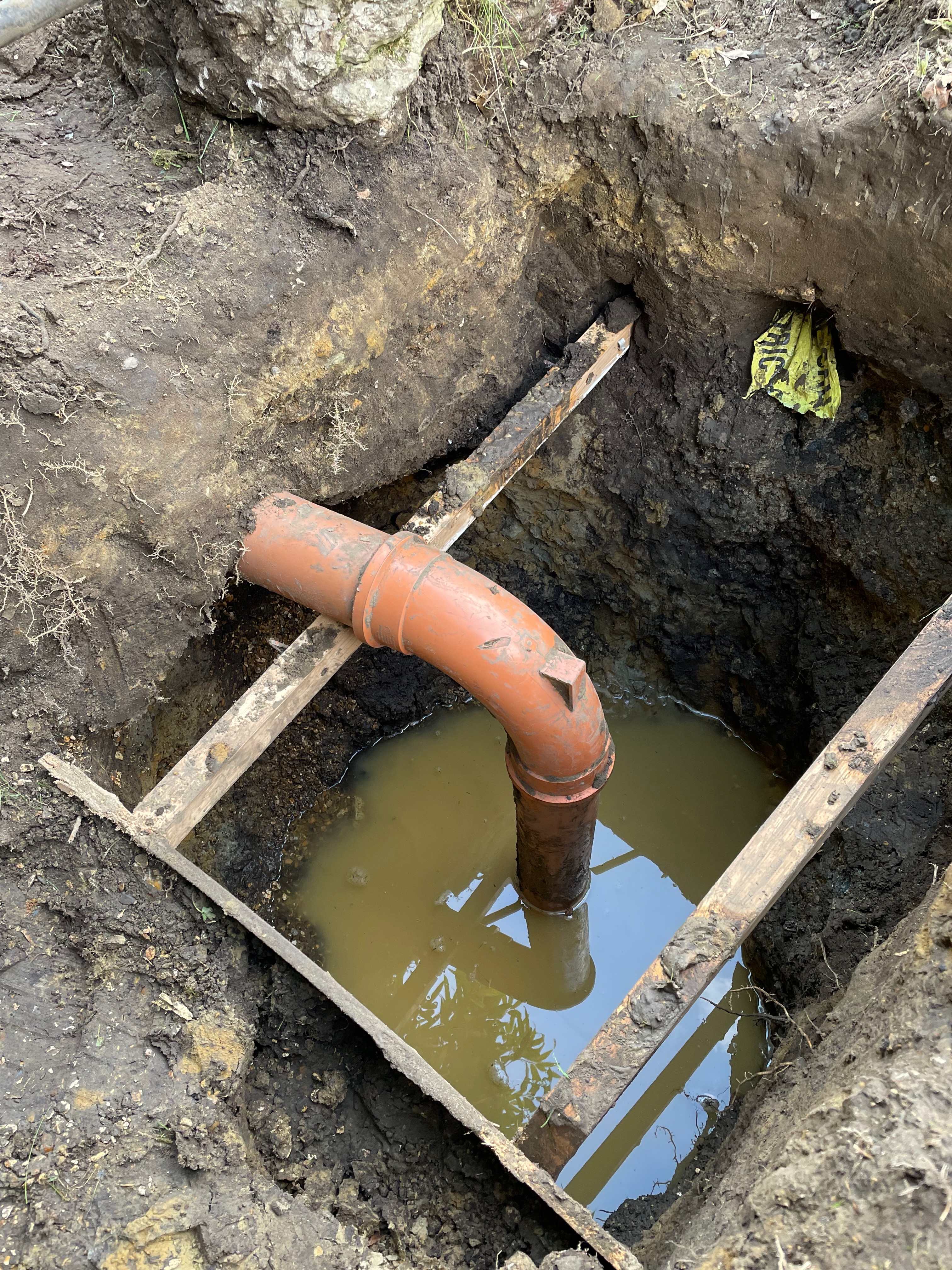

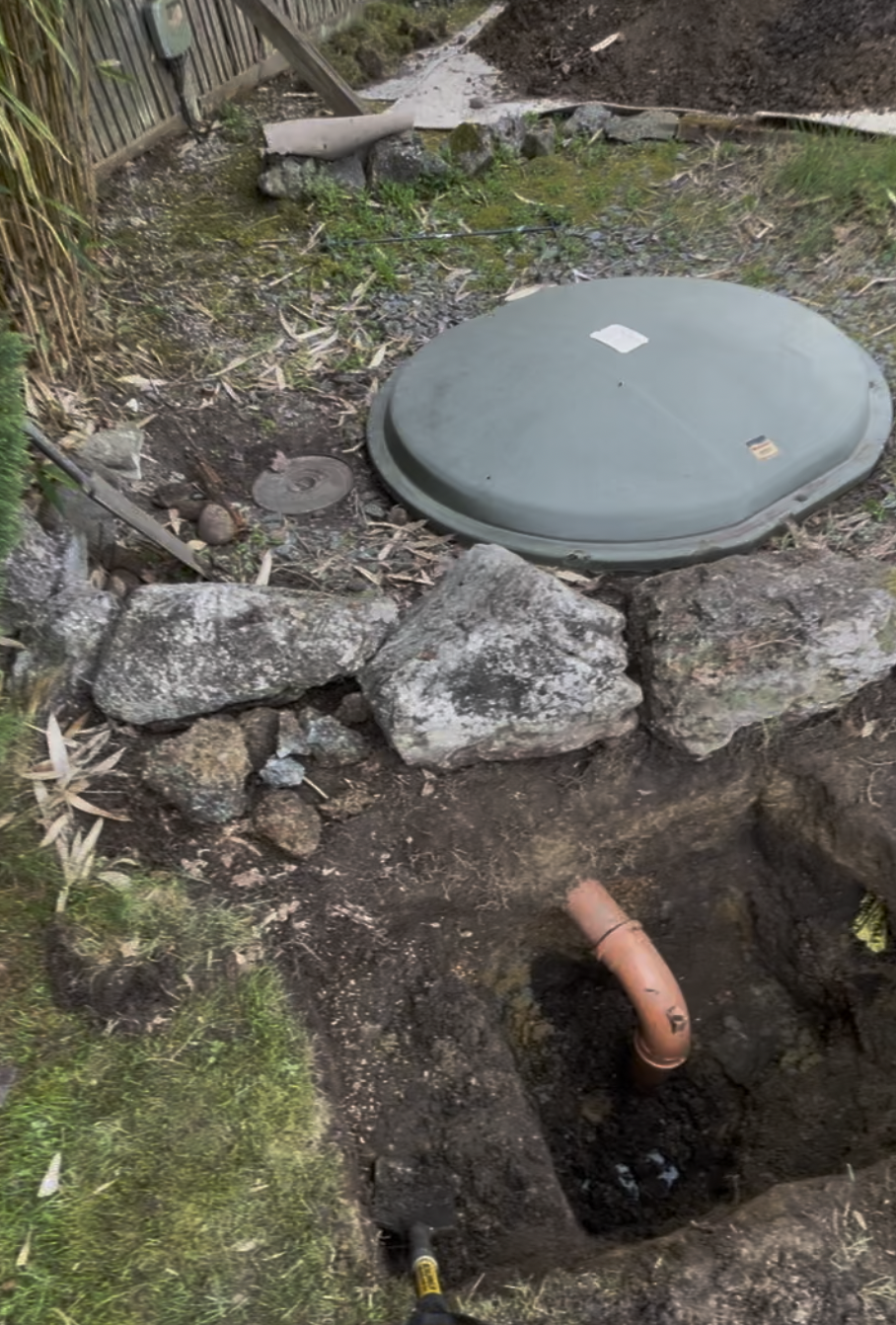

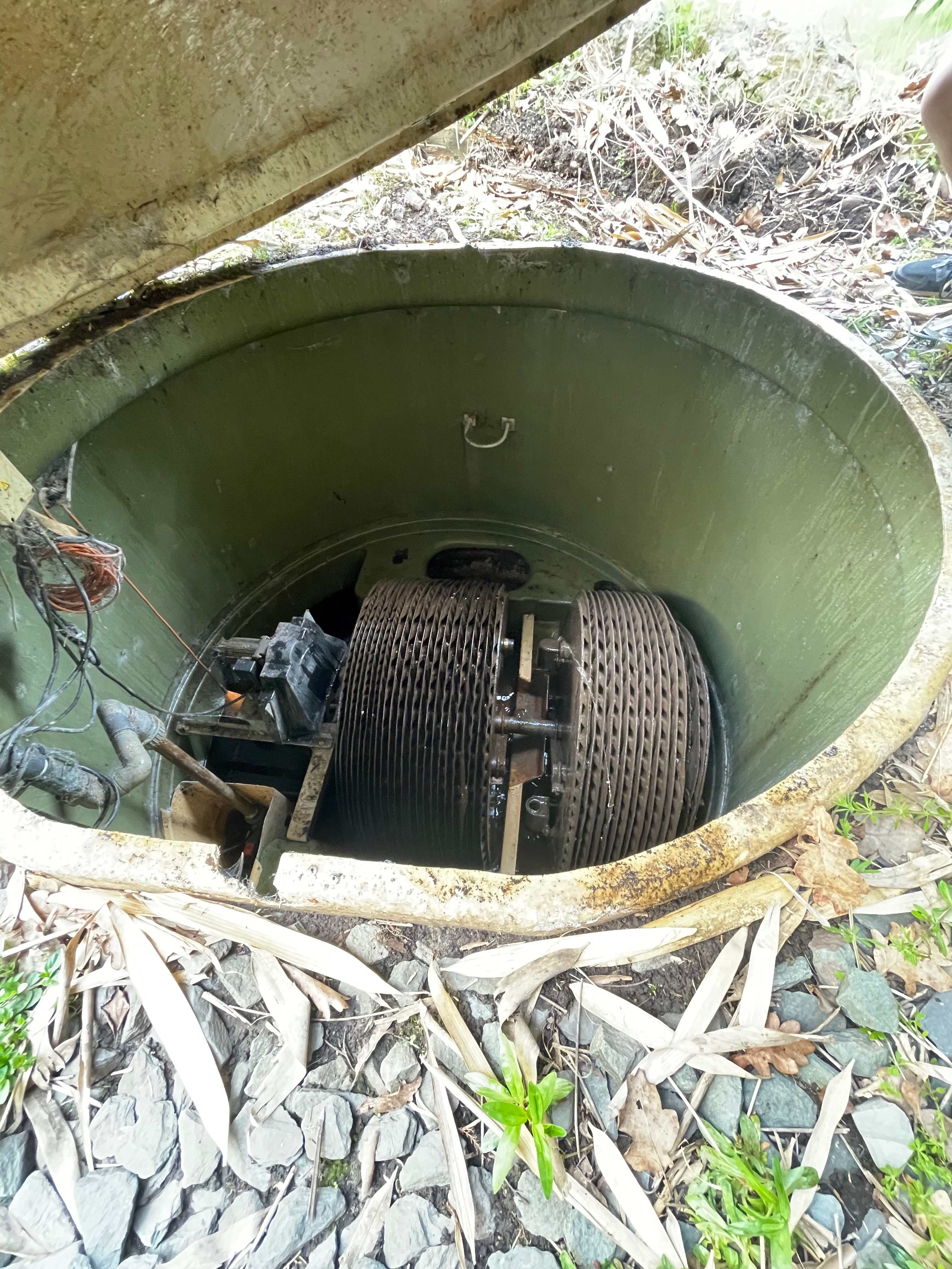

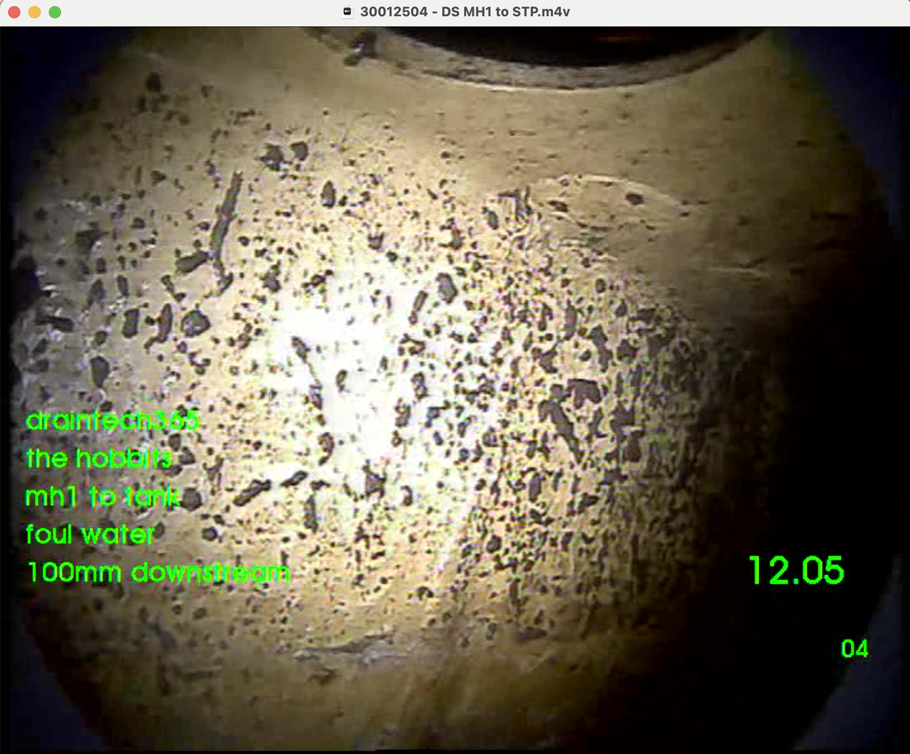

I'm in process of running a new drain at front of house for a new upstairs bathroom. I've dug out where it needs to connect to and got a rough idea of what I hope to do now. I've got the building inspector coming at end of week but wanted to check views here first.
As you can see from attachments the connection is very close to the Sewage Treatment plant (STP). The inlet to this is around 1.3m deep where the main line from back of house runs. There is also a separate drain connection that runs alongside this and drops vertically which comes from garage.
Unfortunatley it seems like they have bedded it partly in loose concrete and it's proving hard to easily excavate under the pipe to get an inspection chamber base in. So in the sketch I've shown in the dark colour pipe my proposal instead with an extra rodding point as well (if necessary). The new connection is a straight run about 15 metres and will have an inspection chamber and the main existing drain. also has an inspection chamber about 12 metres away. And the drain from garage also has an inspection chamber about a metre away next to STP.
Also, yes I'm pretty sure the water is ground water and not a massive leak from the STP. I recently moved in to house and had all the drains surveyed and they all seem fine.
So, does my proposal seem ok?
Thanks

Underground pipes that are not adopted are very rarely queried by building control.
You have made provisions for rodding which is good, they will probably just want a pressure test once finished, especially considering the presence of groundwater after such a long dry spell.
Technically it all looks ok, but I’d be worried about how low your new Y branch is connected and how low the new horizontal pipe run is, as the level of ‘product’ in the STP could rise and come to backfill into that new pipe and settle / block it. I’d want that as high as the existing run.
If the level in the STP has got that high then there is something seriously wrong (blocked outlet) and the original VERY low inlet pipe would be completely swamped and blocked long before that.  If that original low level pipe has never given trouble, then the new higher one is not in danger.
There’s a lot of gravity to support the lower one, but if the levels of the unfavourable don’t / won’t get up to the new level then rodding access should be enough insurance I guess.
I don't understand the diagram.  I thought the tank inlet and outlet would normally be towards the top of the tank.

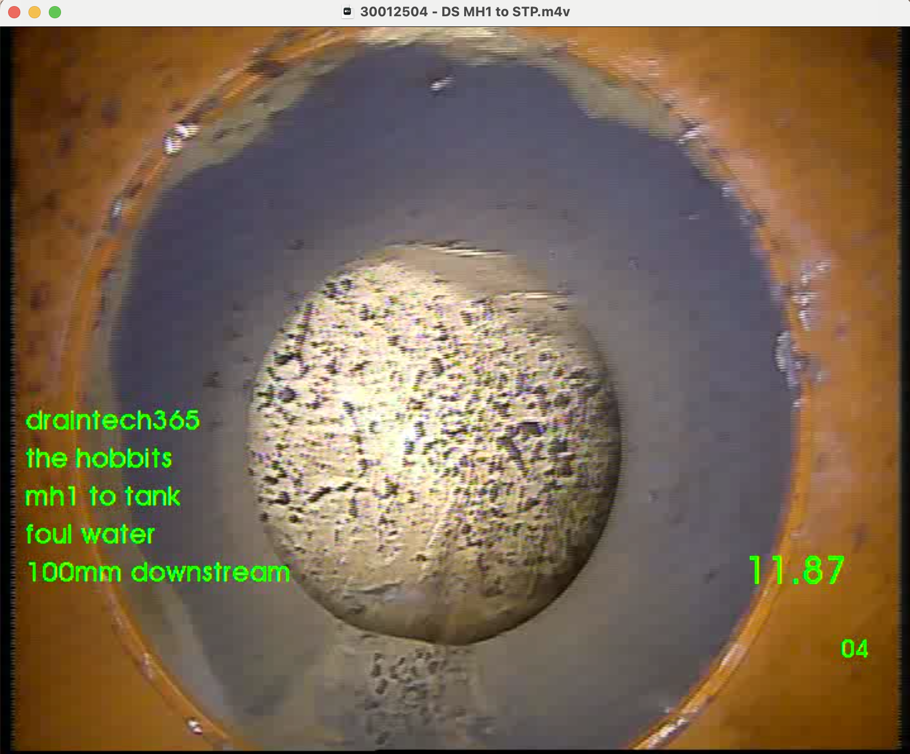

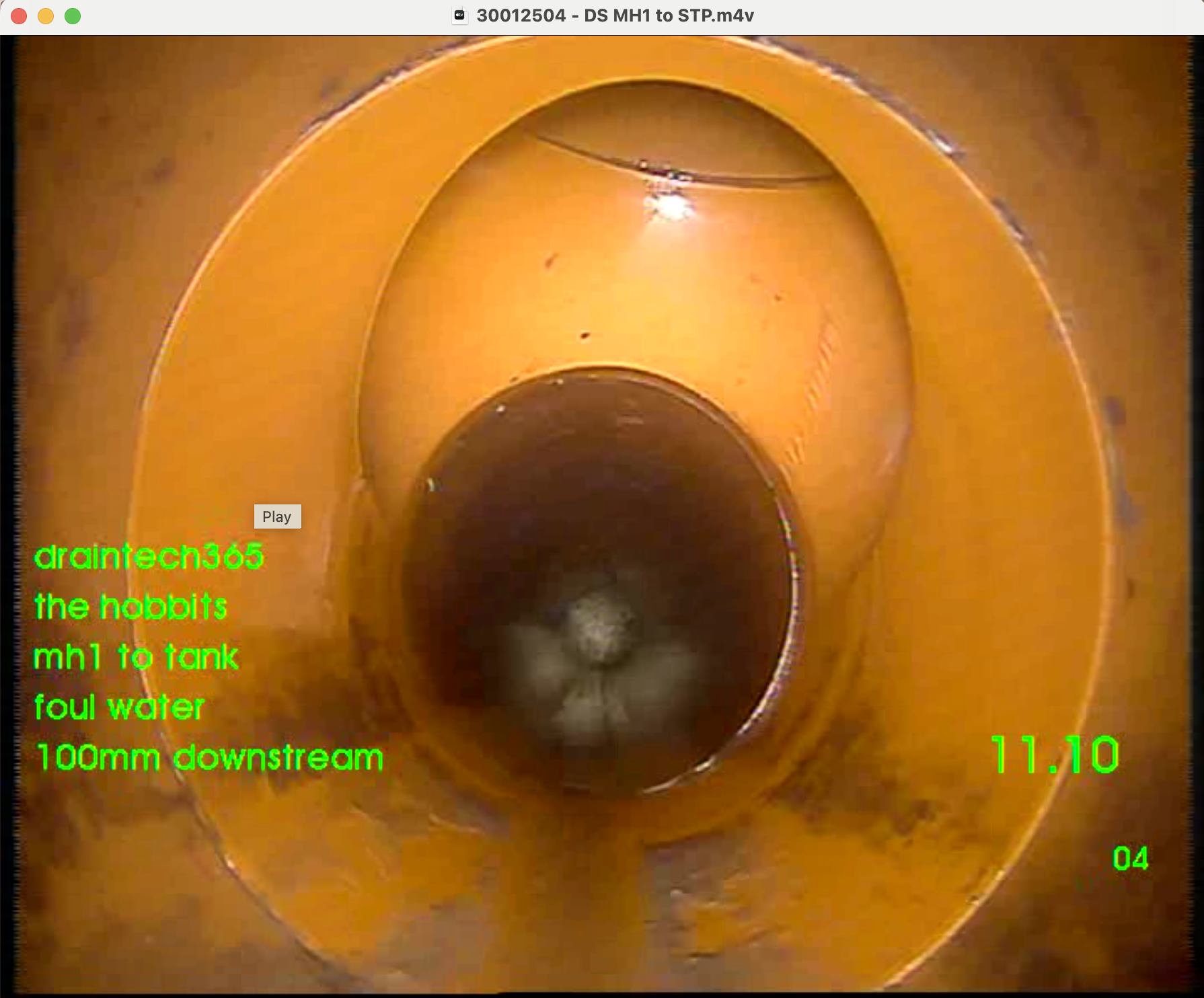

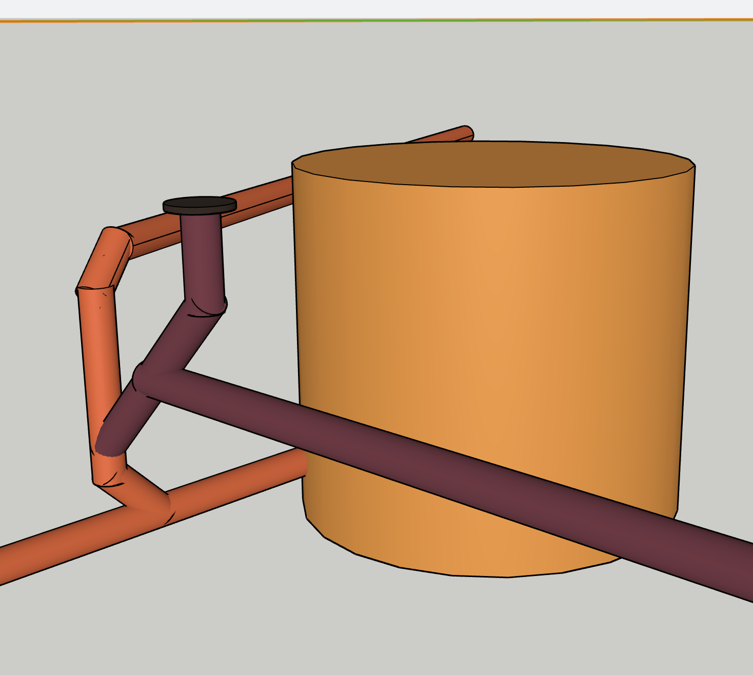

Thanks all for replies. I only recently moved in, but I did have drain surveys done and everything seems intact. See attached a few photos where you can see the vertical drop and then where it enters STP.
I haven't determined exact levels yet, so the branch may be able to go higher. Is it worth considering making the run more like 1 in 50 to get the branch higher?

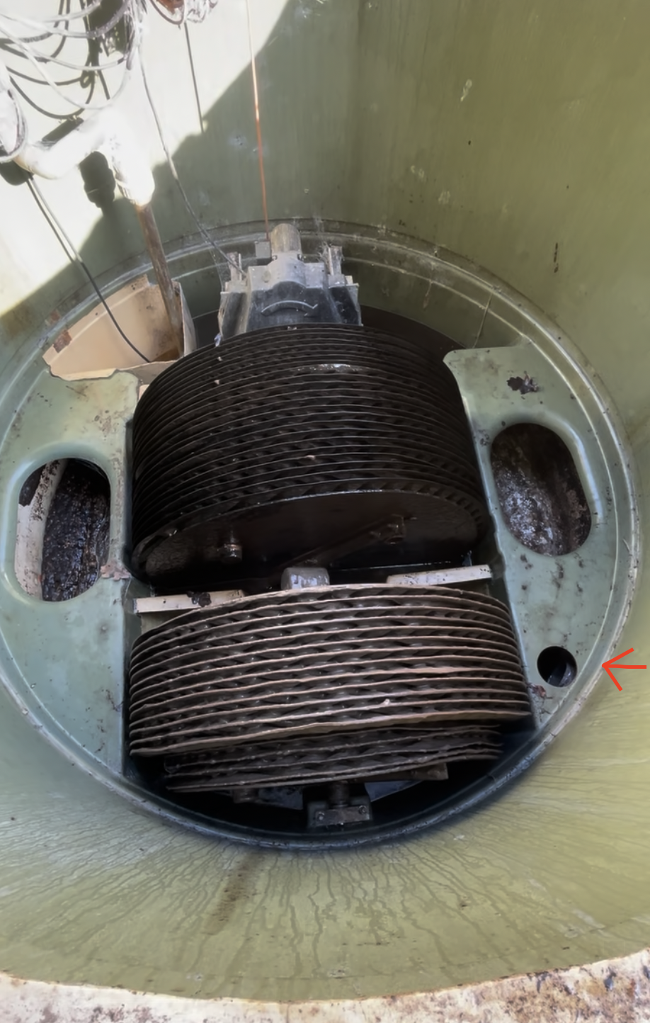

It is not normally that deep. There must be an extended neck for it to be that deep.
Likewise, as the levels in the STP surely would be above the bottom inlet (outlet) as per the pic. The pic doesn't really correlate well and doesn't appear to show the vertically dropping pipe into it?
I'll admit to being a bit lost when looking at the photos vs the SketchUp stuff? @d438a1?
So looking at photos on internet for biodisc, I think the inlet is at the correct height relative to the machinery. It's just set down a lot lower than maybe it ordinarily would be and I guess essentially has another riser (or neck if that's what you meant @ProDave?  on top to get to ground height. I think the reason it's set so low is that the primary drainage comes from back of house and all the way around side. So it's probably a good 30 metre run in total before it gets to STP. Apologies I thought I'd sent a photo of inside orignally. See attached now. Arrow shows the inlet.

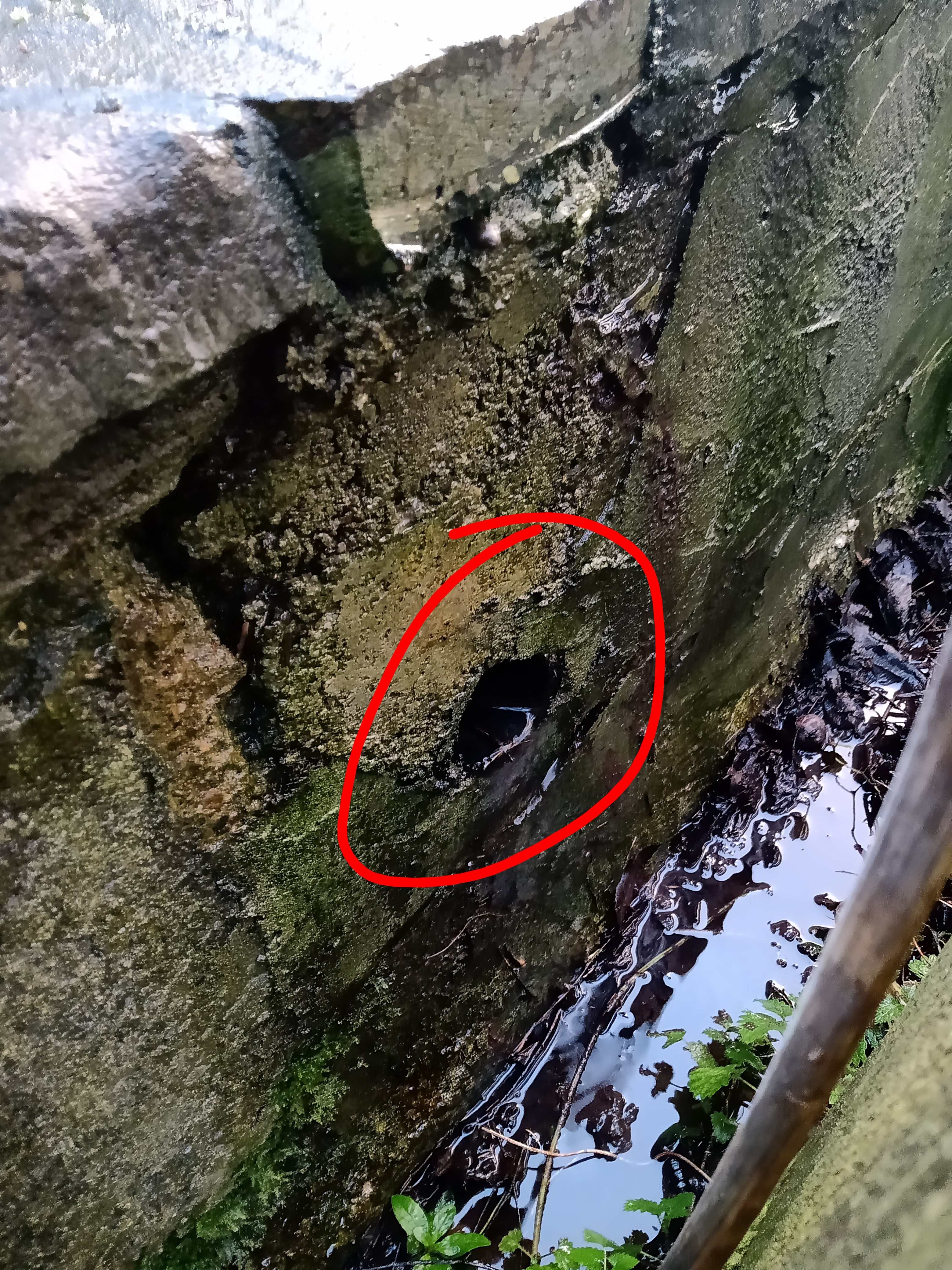

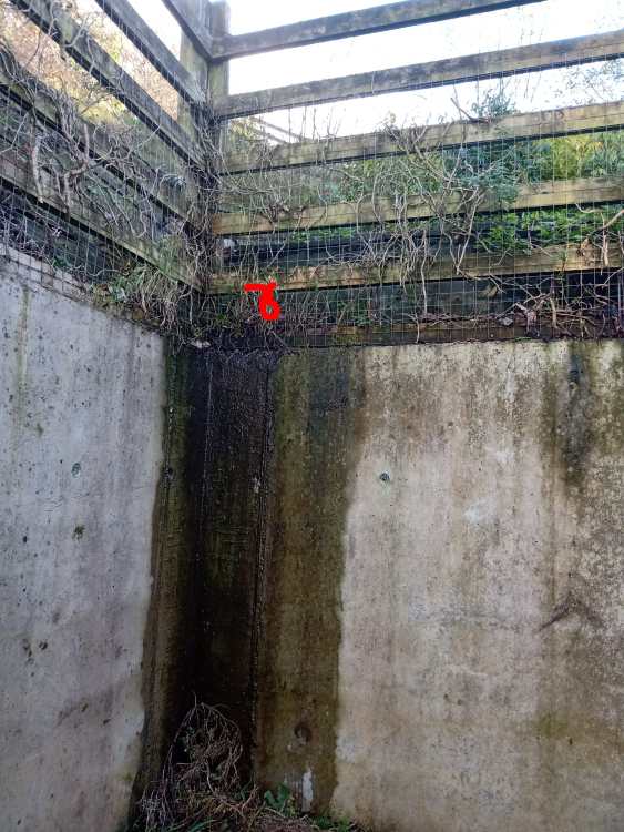

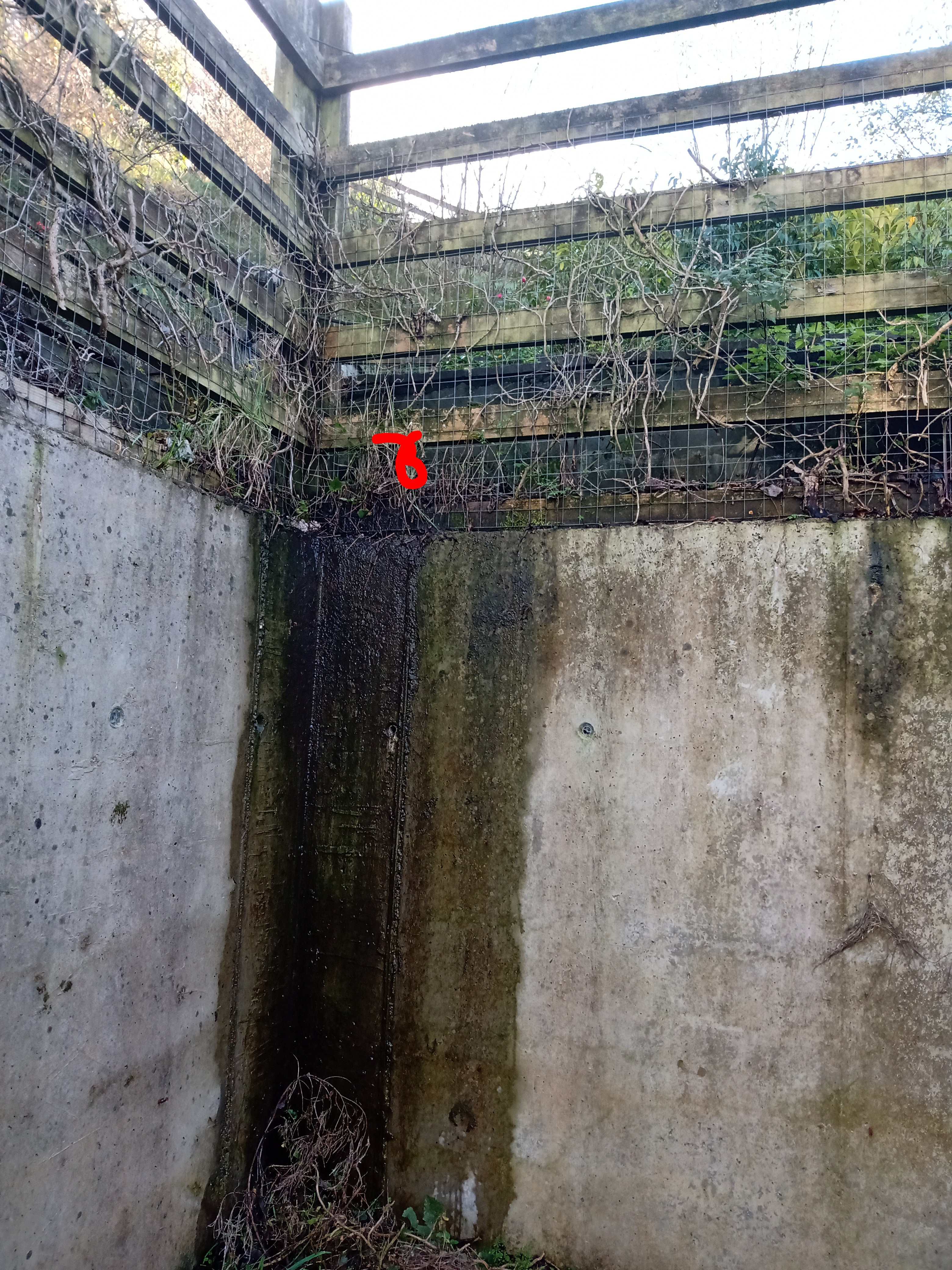

I have the 3 inch pipe that drains to nowhere in the patio above my house that I bought. There is a drain pipe near by to the right of the pipe on the photo but wondering what would be the best way to attach a pipe to this wall without having any leaks where the wall meets the pipe?
That’s just a land drain which lets the water through the wall that would otherwise look to erode the wall or the ground under it, in order to escape.
These usually just dribble down and a ditch / drain carries the rainwater away.
Not sure you can easily / effectively connect a pipe to this as is. It would likely need a new piece of plastic drain pipe through that dwarf wall and for you to carry that on to the drain.
Thanks, ok it sounds like I need to sort the drainage on the hill above the drain as recently it is like a non stop torrent coming out of it and making the place look a mess as can be seen in picture. I know we have had a lot of rain lately but can't be looking at that much longer. Also I have added another picture where I have outlet pipes in the middle of retaining wall itself. Is that also for getting rid of excess water behind the wall?
Edited by slystallone
Yup. The second pic looks like someone’s poor attempt to relieve the trapped water. Looks like it’s just had a drill put through it.
These drainage outlets need to be 40mm waste pipe minimum and be kept clear.
Defo needs addressing properly but you’ll always have this runoff.
Working out how far down you can make the holes would help, as the lower the better, if you can do fewer larger holes, but smaller ones (32mm or 40mm) would need to be high and low to cope.
That is a blockwork wall with render so its surprising it is resisting the water so well.
I'd suggest drilling new holes that are the perfect size to accept a standard plastic pipe hammered through to the other side. 40mm dia or so?
then you might need to seal any gap so that the water uses the pipe.
perhaps at 1m or or 1.5m or so centres and 300mm ish off the ground.
If the new pipes extend about 150mm they will spout or dribble clear of the wall.
so if the wall is 150mm  thick use  300mm lengths of pipe.
Through the blocks would be the tidiest job as drilling though the beds might open up more cracks.
This will also relieve lots of pressure and the wall is likelier to stay put.
where the water goes next is up to you.

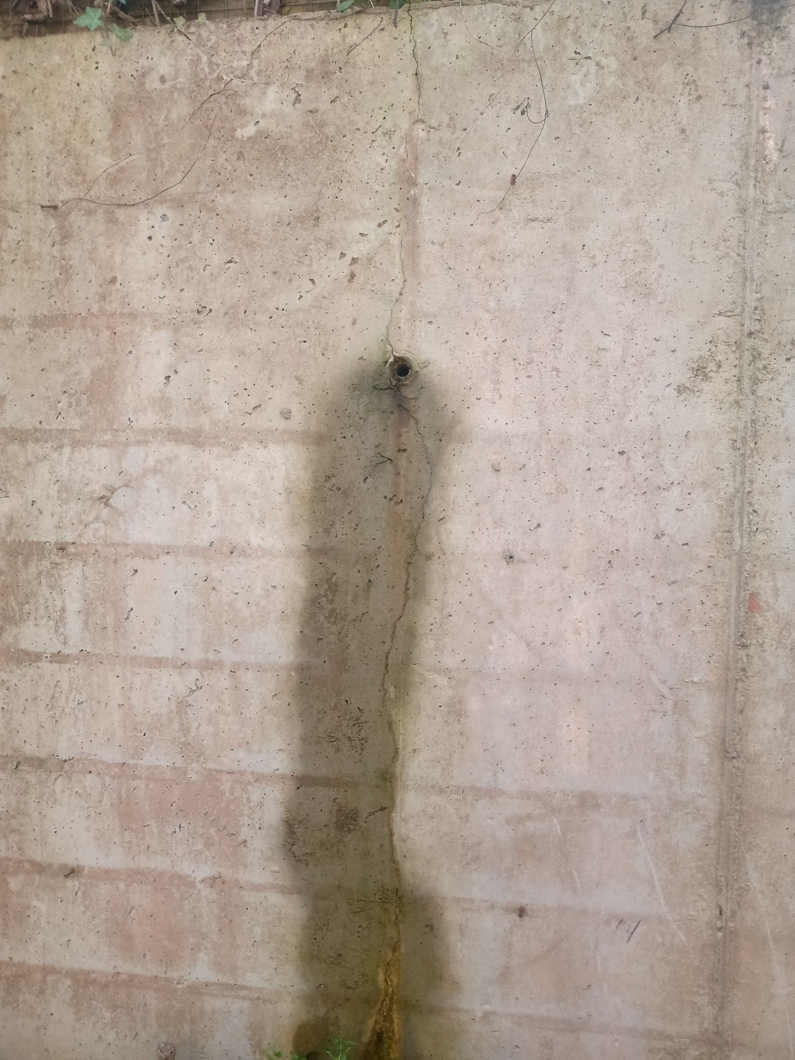

How would you sort the cracks that have appeared,for example, under the outlet in the picture here
What do you mean by 'sort'? You can patch them in render or whatever is already on the wall, and/or paint the whole wall etc for appearance.
But the vertical crack is probably structural, so releasing water pressure is the priority. Drill a few holes asap.
The worst point for stress is about 1/3 up, but you can drill anywhere below that for immediate benefit.
If you can drill even one hole, even only 12mm diameter or so, we will learn if the wall is solid, the thickness, whether water rushes out etc

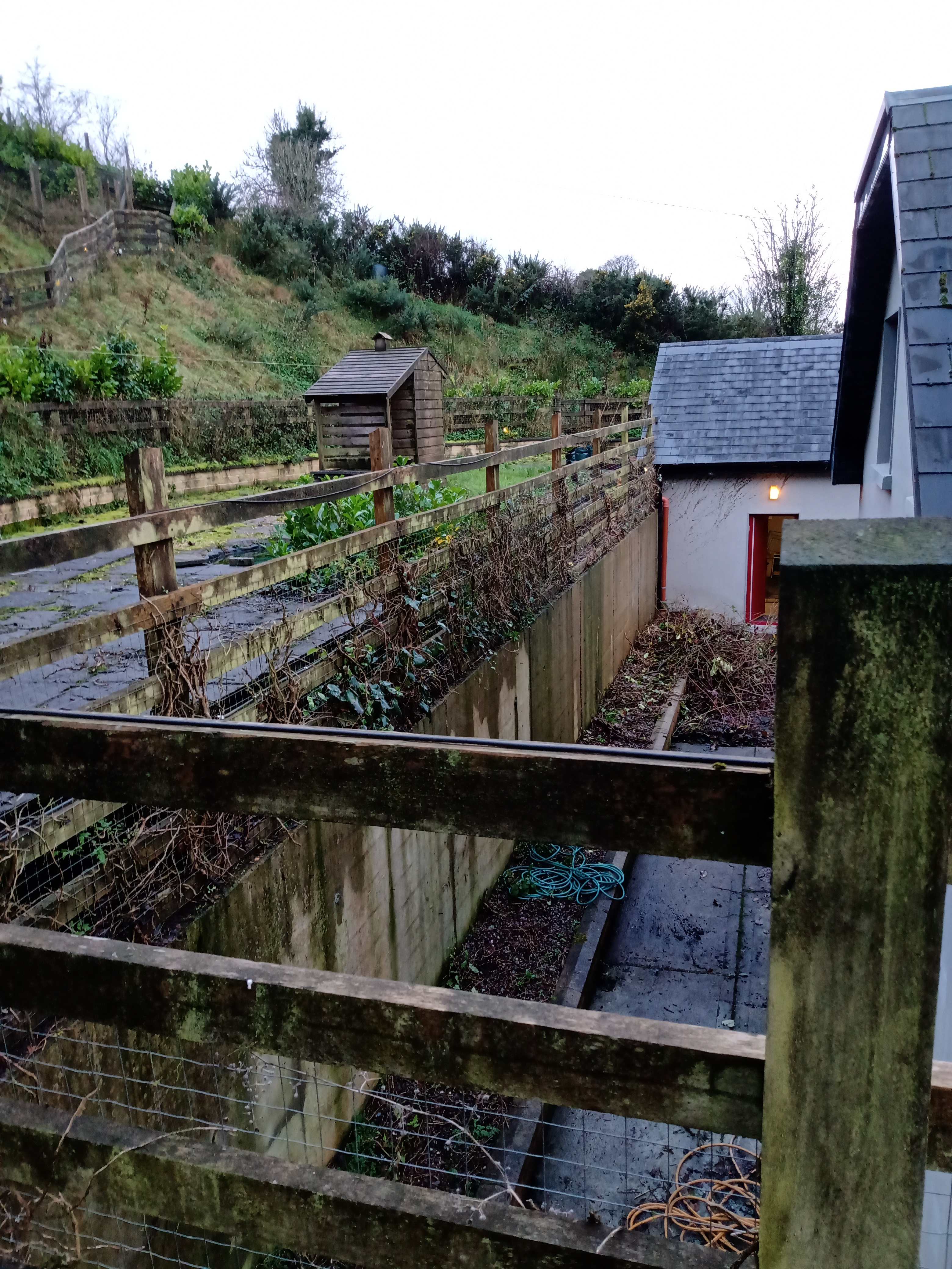

@slystallone what is the purpose of the wall? eg supporting a cutout in a hillside between your land and a neighbour.
do any other properties have similar?
Is the wall vertical?
9 hours ago, saveasteading said:
It appears to have horizontal beds and vertical joints similar to block size.
could be plank faces I suppose, and the holes might be formwork tie holes rather than drainage.
But that is heavy Engineering capital E. which is expensive and therefore less likely.
It is a retaining wall as the land behind the house is very steep so it is supporting a cutout

If water gushes out I am in serious trouble no? Who would be right type of tradesman to call to suss this out?
To do this right you really need to be excavating behind the wall and installing drainage to take the water away rather than through the wall. A pored wall of that size really should have had the drainage installed, any chance there has been other work at the ends possibly blocking the drains?
Drilling holes will reduce pressure and water level but then you will be managing the water on the good side of the wall - with pipework
If water gushes out you are relieving the pressure.
The problem you will have is a temporary flow of water which should later slow.
If it dribbles out ditto, but then we know the issue is less severe.
Is the wall poured concrete or block? That is something you'll find soon enough in trying to drill.
You appear to have a dam rather than a retaining wall.
If it is properly designed in concrete then I would have expected a drainage system.  So it's more likely a bit diy.
If it is blockwork then any builder can drill holes. If it is concrete then they can hire a core drill.
There are other Engineers on here so second opinions will be welcome, including whether you should have a consulting Civil or Stuctural Engineer look into it.
