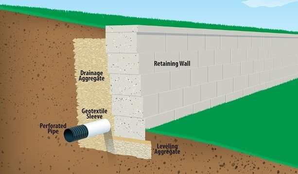

A professionally designed wall would have drainage behind it including at the base, so that water never builds up.

To do this right you really need to be excavating behind the wall and installing drainage to take the water away rather than through the wall. A pored wall of that size really should have had the drainage installed, any chance there has been other work at the ends possibly blocking the drains?
Drilling holes will reduce pressure and water level but then you will be managing the water on the good side of the wall - with pipework
What kind of drainage would be behind the wall if it was done in the way you mention rather than through the wall?

Can you give more details on what that drainage would look like behind the wall please?

Hi @slystallone, the wall shoulld have the soil side waterproofed with a perforated pipe running around the bottom “French drain” style and backfill with pea gravel, pebbles or similar to allow any water behind the wall to go down into the perforated pipe and then away around the side.
idea is to take any water away to prevent the wall from being a Dam and being subjected to water pressure. It would be worth doing a bit of digging at the wall ends to check for any existing drainage that may have been blocked etc.
failing that you are looking at water management which means a lot of digging or back to cutting holes in the wall and then collecting the water to take it away in visible pipes on your side,
Exactly so.  The former would cost £10k for a job half done. And is it your land?
Holes £500. A heavy duty core drill with diamond core cutter can be hired for £150 or so.

Doubtful. £500 for the gravel. Add pipes, membrane, digger, and the earth has to be taken away.
Anyway, how deep and where would you take a drainpipe?

@slystallone if you do that, where can you take the drainpipe from the end of your new trench?

I have been presuming you might dig out 600mm to 1m and have  a pipe at the bottom of that, so water would run to an end and from there you need to take it elsewhere or it won't drain the area. What is on e land you took the photo from? ie to the inside of that fence. Is it your land?
And is there more retaining wall between the fence and the house?
Not wanting to be rude but it's always worth checking... are you following the logic of building a drain and getting the water away from behind the wall?
