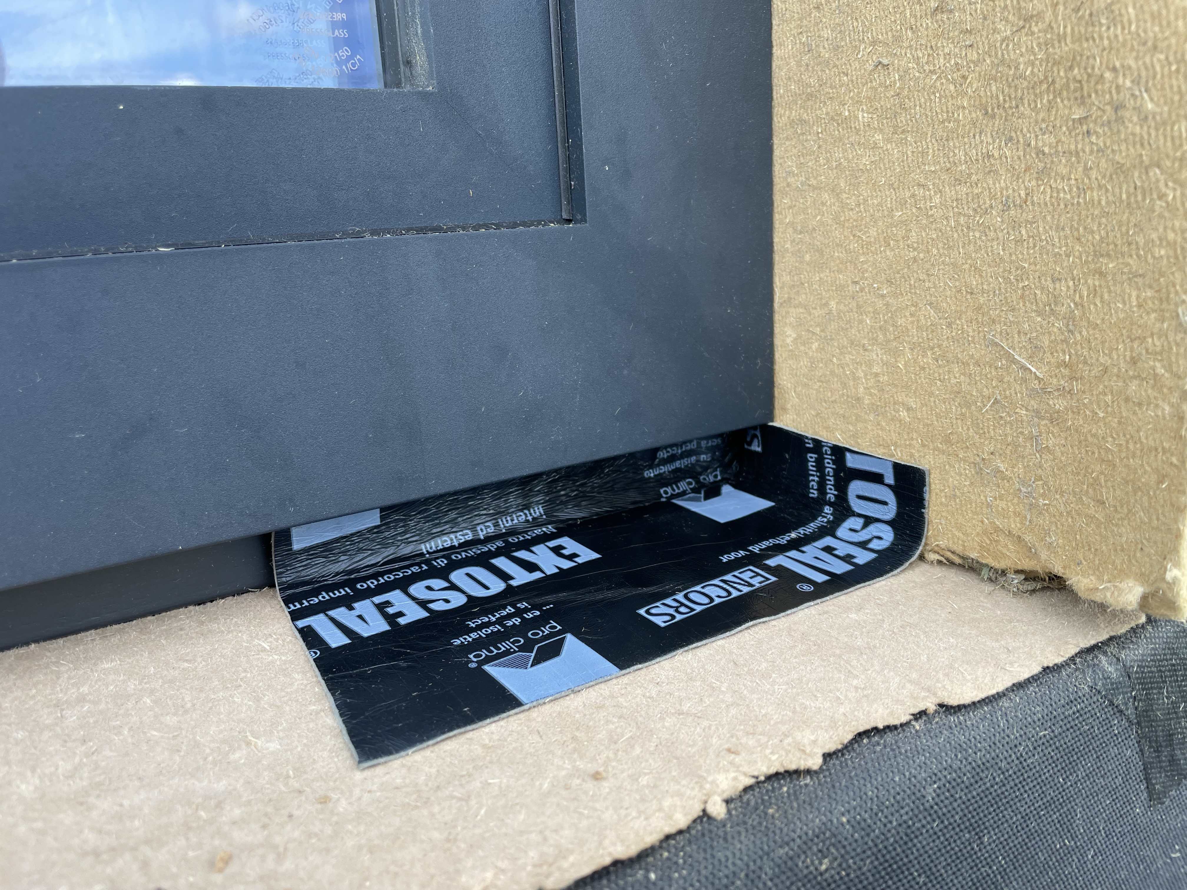

gavztheouch Posted June 7, 2025 Author Posted June 7, 2025 Anyone else have a similar wall build up to me and how did you weather proof your windows before cladding. Here is a mock up of one of my windows. I have insulation pushed into the reveals, the outer aluminium face is cut back to allow 35mm of external wood fibre to fit in there against the wood portion of the window. On the sill I have made a tapered wood fibre fillet. This will be primed so I can cover the still with flashing tape and also stick to the bottom edge of the window creating a pan in front of the window to shed water. The metal sill is meant to then fit into a grove under the window. All wood fibre will covered in membrane of some sort my walls are made from 45x245 timbers and I have 60mm external wood fibre. There is a black membrane on the outside and then I have 50mm battens to which I will clad with an open rain screen.
craig Posted June 7, 2025 Posted June 7, 2025 You should have an aluminium window cill, it should have been fitted at time the window was installed and before rendering ideally.
