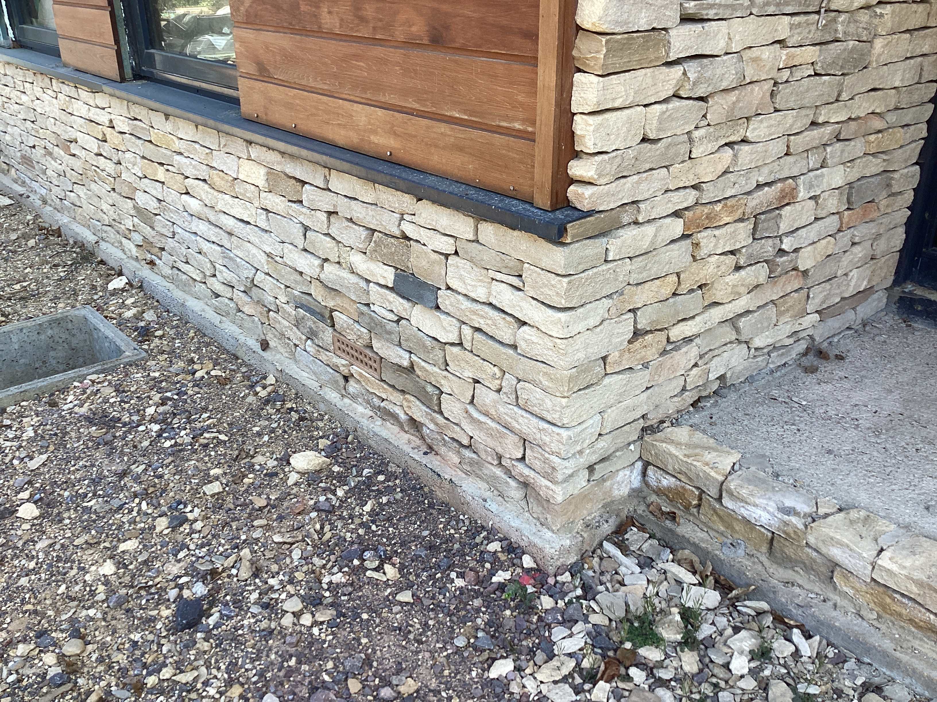

image.thumb.jpg.3469dc4610d6681df99c51504443a7e6.jpgWill this create a large shelf that you will need a flashing over.
on an eps block I rendered onto the eps with a waterproof render with mesh included, then left the surface very rough.
then laid natural stone bedded in exterior slip adhesive and stuck back to the render with the same slip adhesive, stainless screws and stainless brackets bedded in every third course.

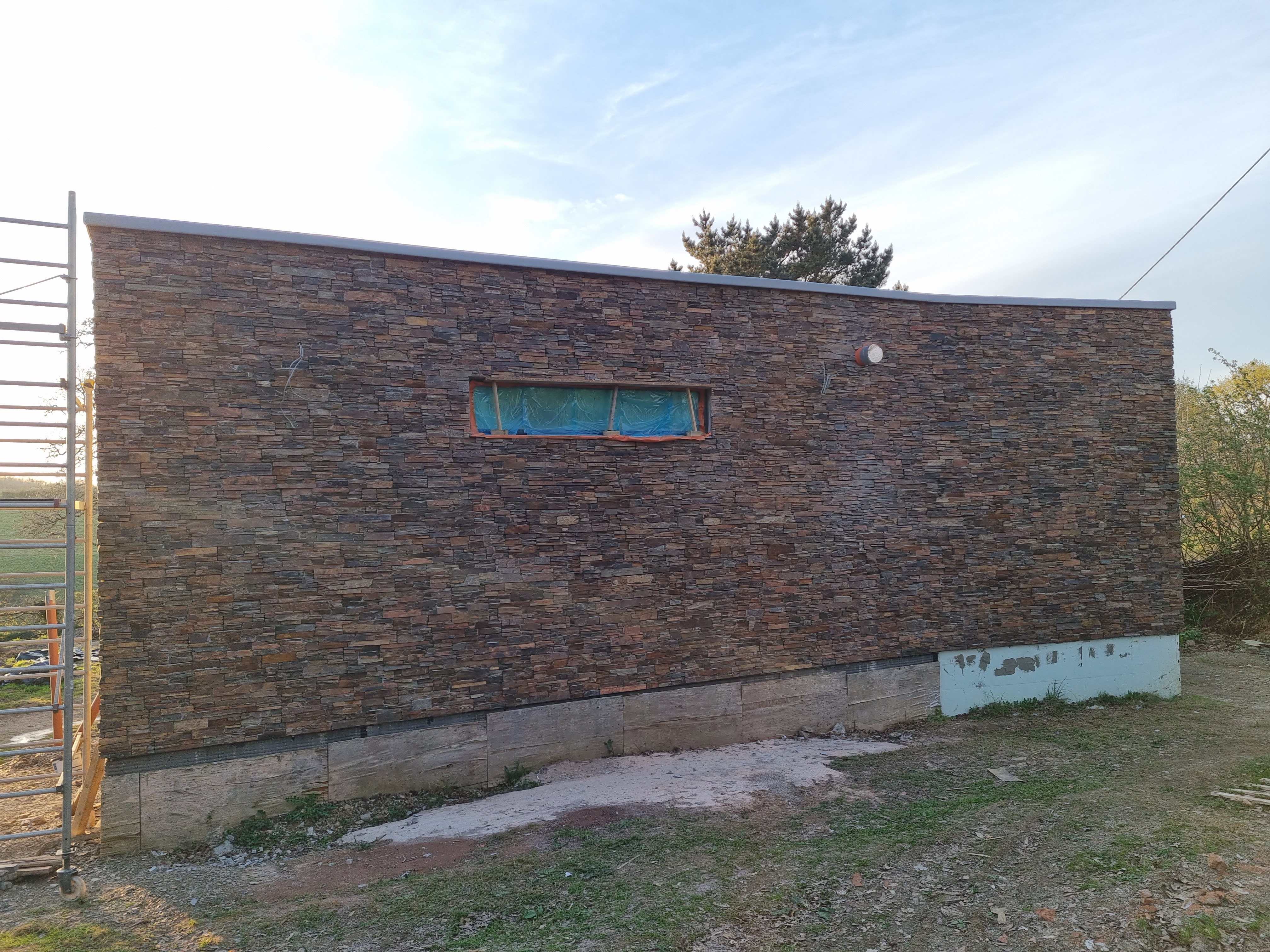

I am just in the midst of stone cladding onto Nudura (EPS ICF).
First it was screeded using Duravit and embedded mesh, and then roughed up to allow the adhesive to key into it. This seems to be the essential step for any "hard cladding" such as stone panels or flints or the stonework as pictured above by Russell.
The  adhesive (Sicher Kerami plus) came in 25kg bags to be mixed onsite with added water. It's much like tiling a wall - apply adhesive to wall, trowel in vertical grooves, "butter" the stone cladding, affix to wall. Above 2.4m you have to mechanically fix these as well
Result:
For flints I suspect the mix would be a little thicker and you would want to do the bottom row, let it set off and then do the next row.
  • Like 1

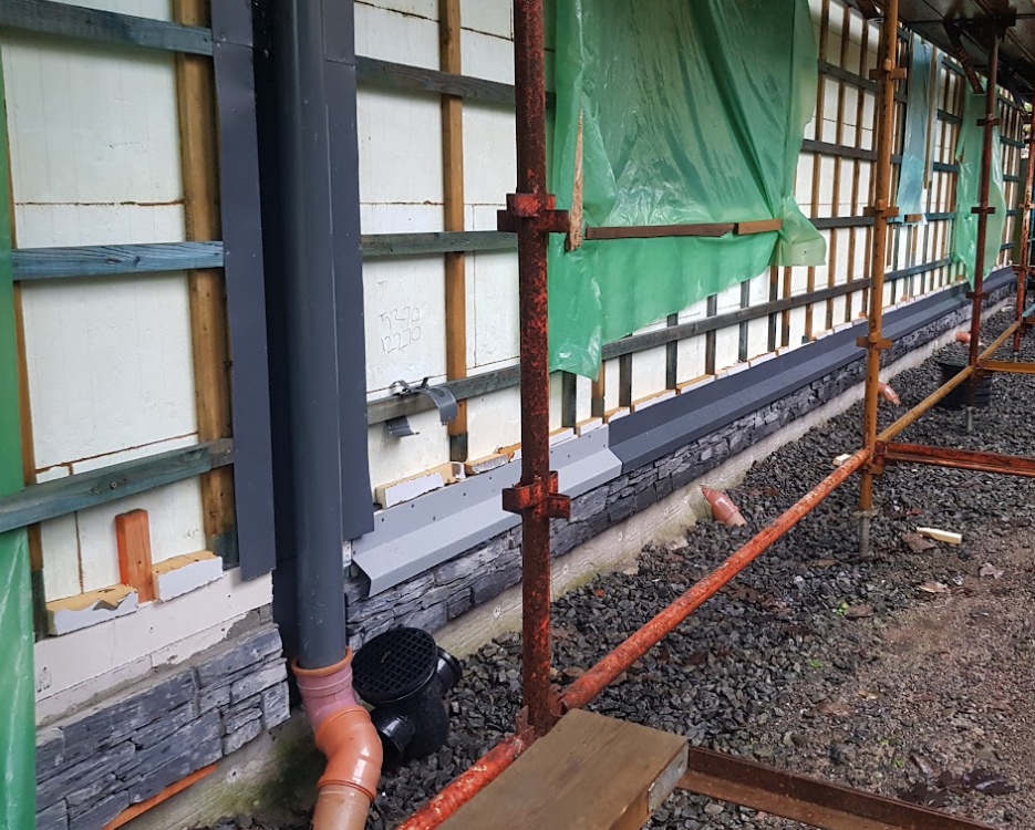

I screwed backer board to the battens. This maintained an air gap at the bottom to ventilate the cladding above. Then fixed a steel mesh to stop 'things' getting up behind the cladding. I screwed temporary battens to support the slate and provide a consistent line (you can just see this on the left of the downpipe) then removed them later. My slate panels had clips prefabricatred into them for a mechanical support, not technically necessary in my case but I still found them useful. Ignore the downpipe connection, that was a temp setup whilst we waited for the correct pieces from lindab to arrive.
image.thumb.png.80e48b9bf5d7f67da0a293f68a445e26.pngimage.thumb.png.631694e404bced92fc4cc6ede83f9ef8.png
  • Like 1
