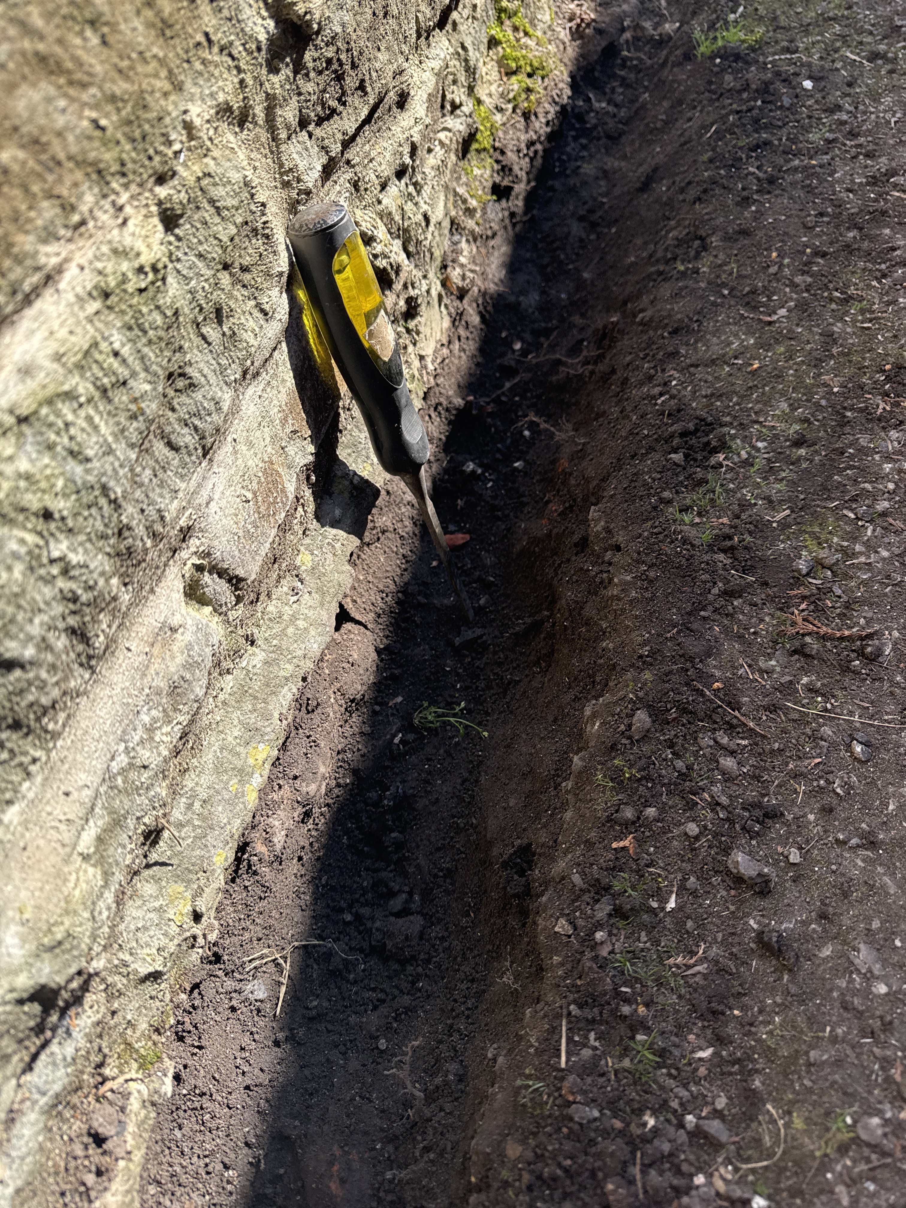

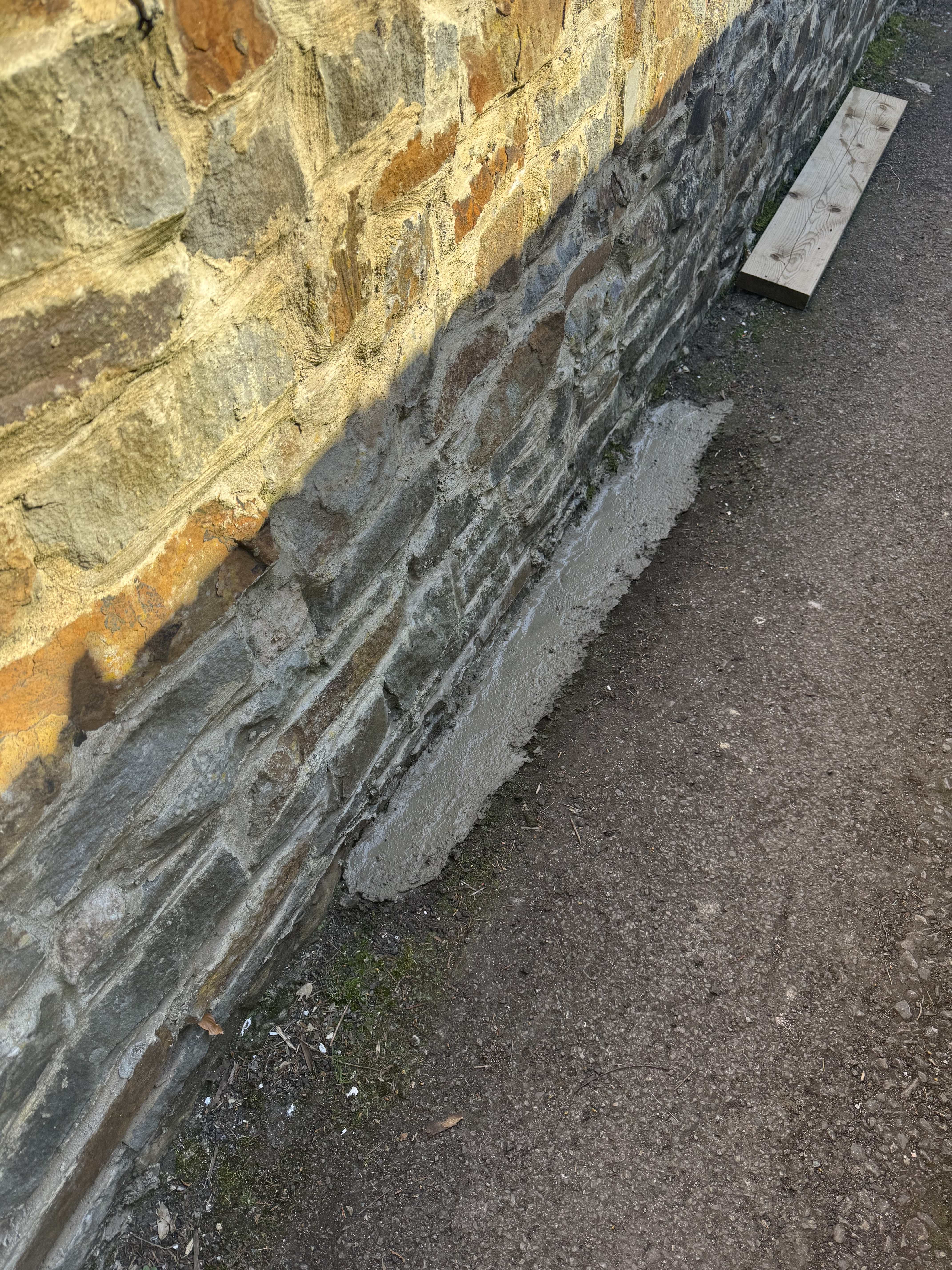

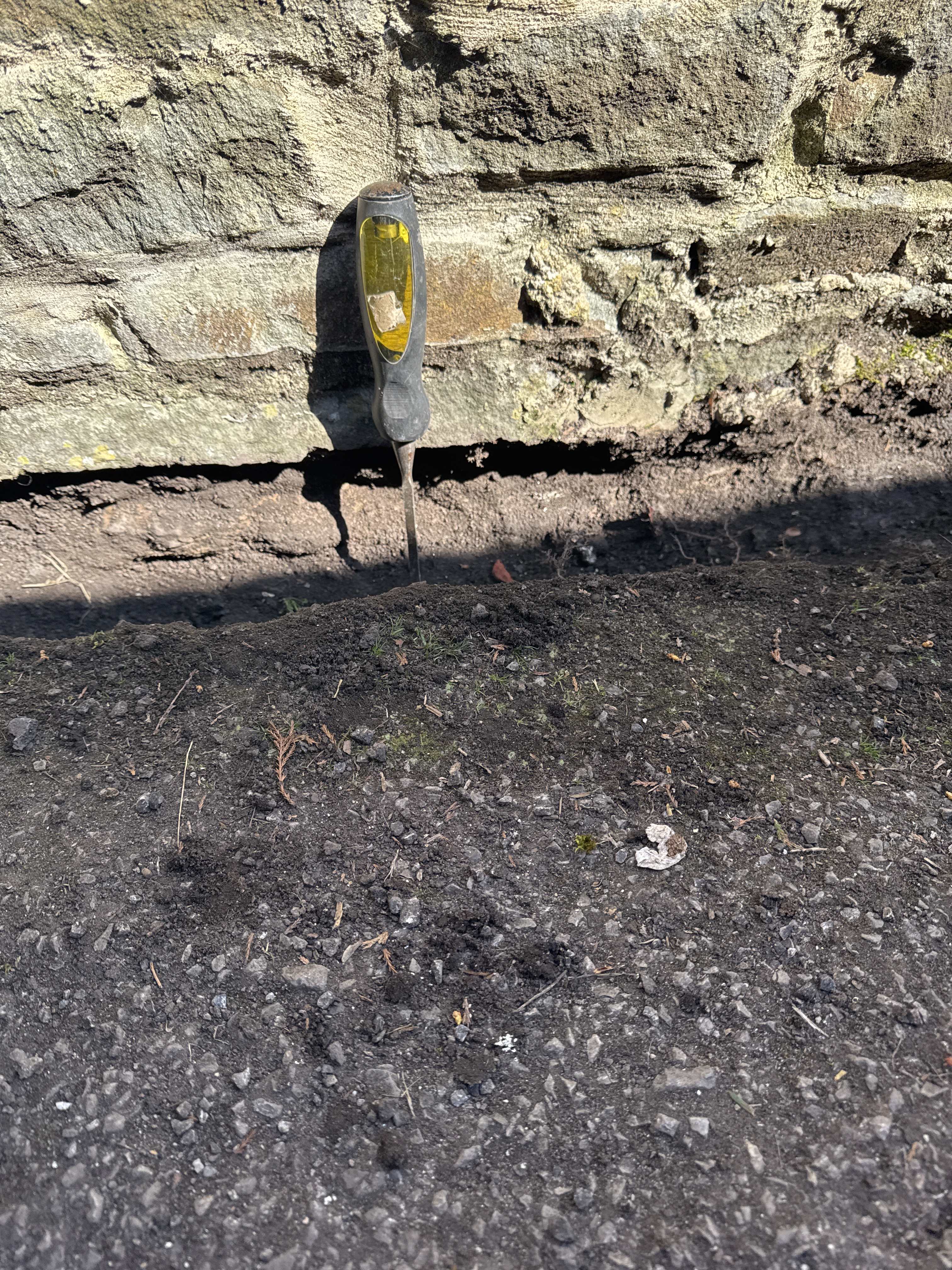

Pocster Posted April 1, 2025 Posted April 1, 2025 So after 2 yrs I decided to dig up the lane . The leak if you remember is running over the slab and in . Expecting to find great holes I found nothing . The only thing of note is the ground is really crap ( almost soil ) in this trench and I’m hoping that’s simply the issue . I can’t go much deeper as I can’t go too wide as the lane is needed for access . Just dig a bit more and pour concrete in ??

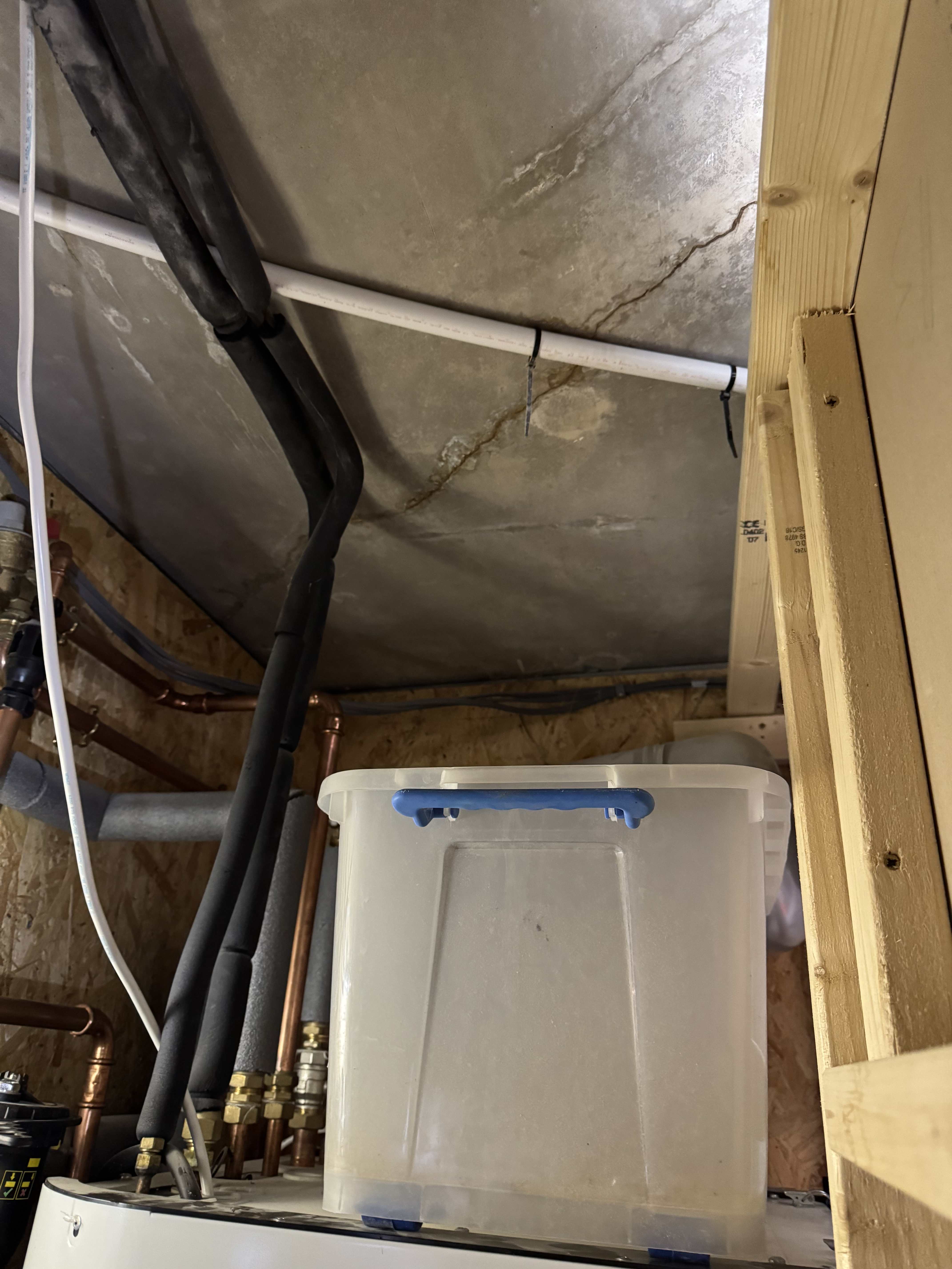

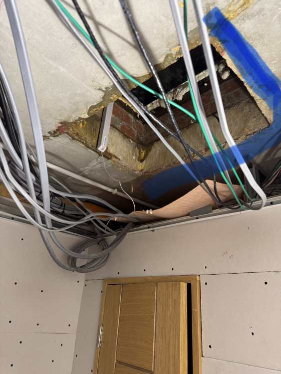

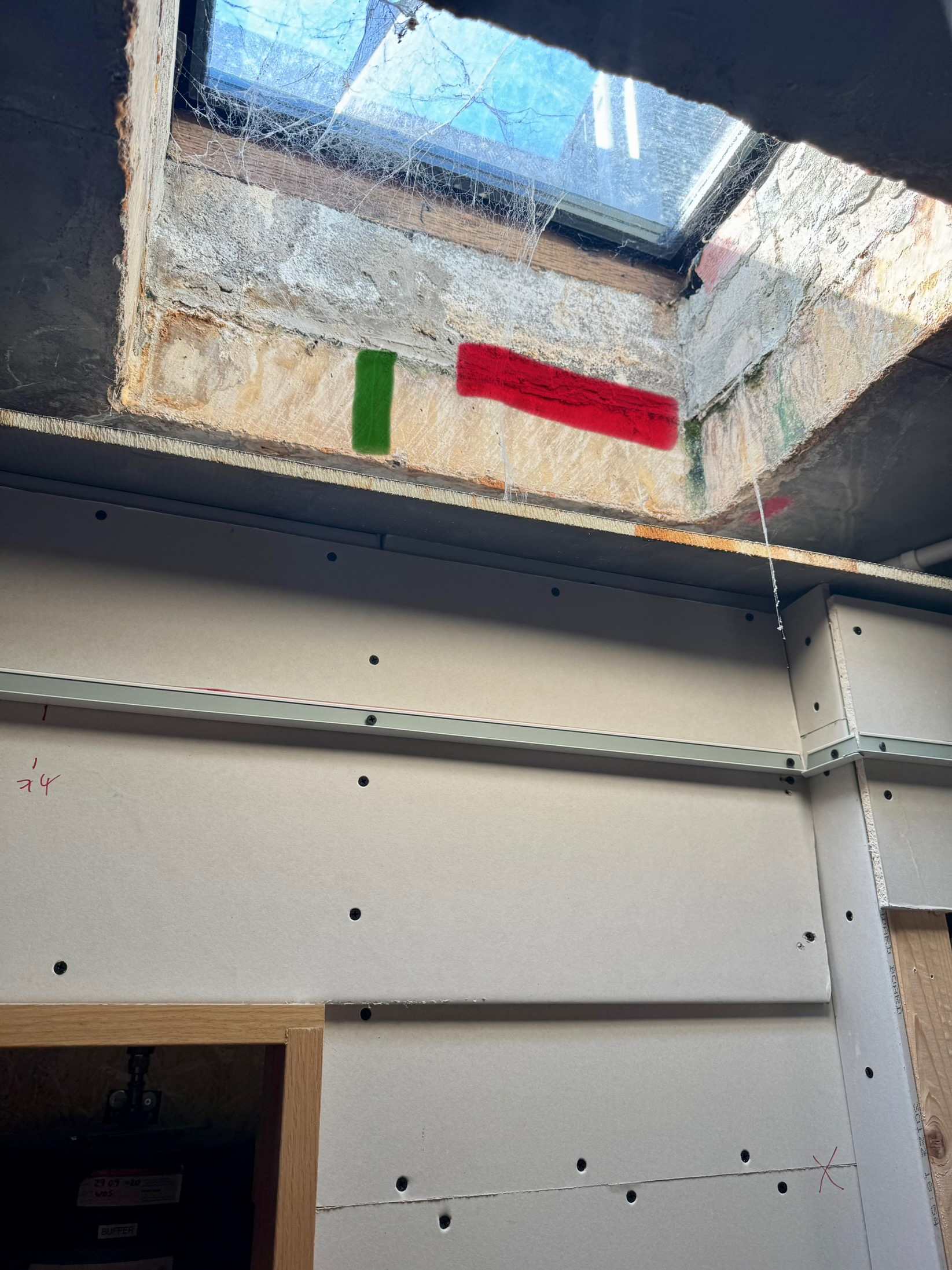

Pocster Posted April 1, 2025 Author Posted April 1, 2025 I know no one knows ; including me ! So here’s the leak on the inside . Coming in on the red line . So over the slab , not the upstand . Assuming wall in lane is sat on the slab . Green line shows depth of slab - 14cm . I guess I’m not going to find how it’s getting in but I am tempted to fill the trench with concrete with the plan being the rain then runs away from the build rather than straight through the ground and in .

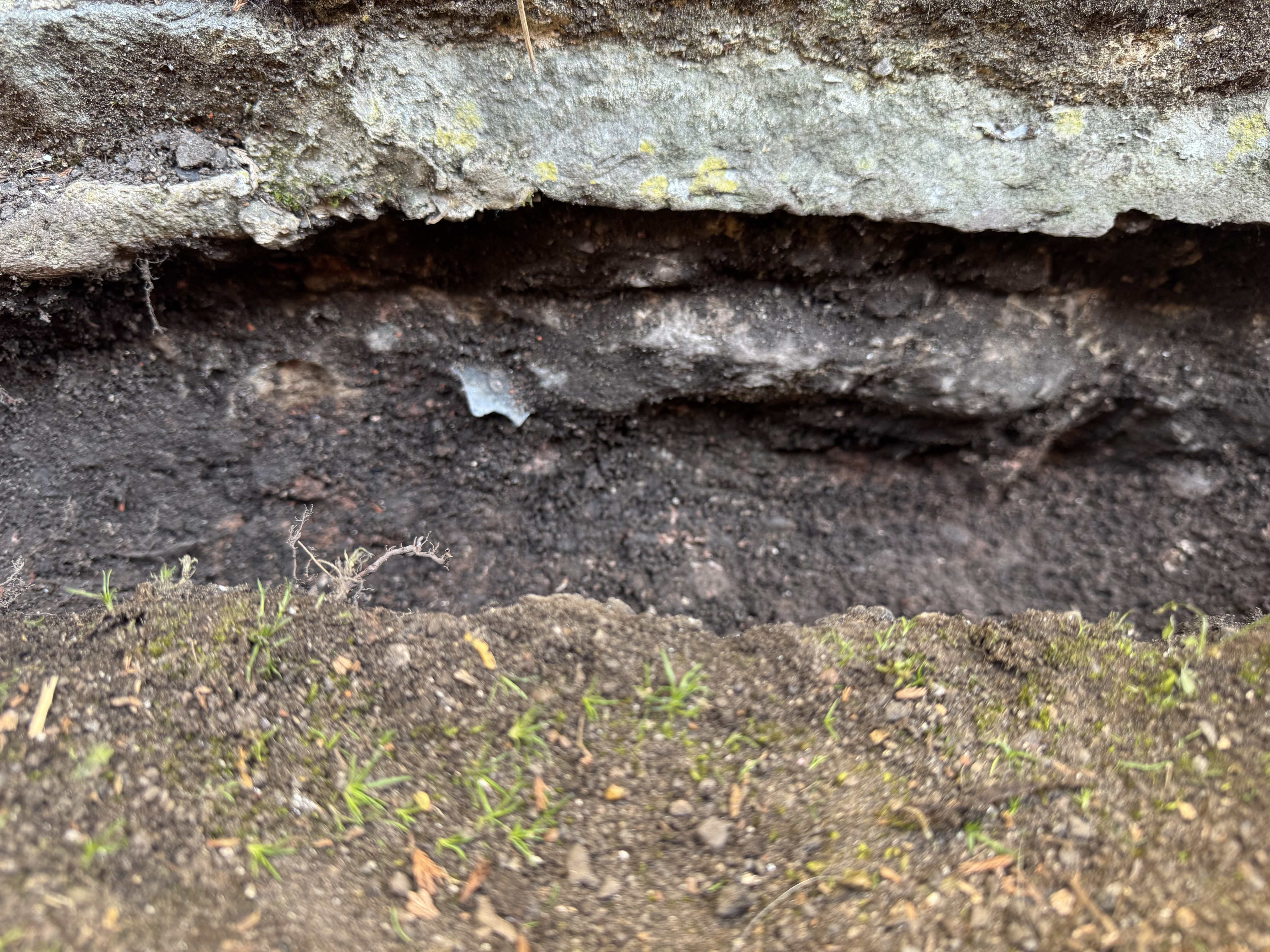

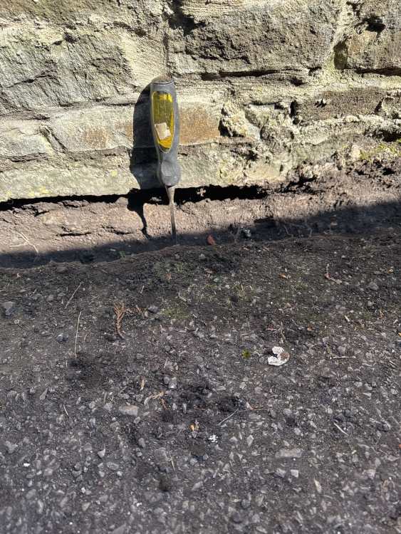

Pocster Posted April 1, 2025 Author Posted April 1, 2025 I know ! Almost impossible to give advice on . So went a bit deeper . Hitting hardcore now - presumably the lane . Going to mix cement and fill it in

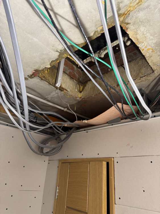

crispy_wafer Posted April 1, 2025 Posted April 1, 2025 So ingress between the slab and upstand. Any way to expose outside the junction of the slab and where the upstand has been poured onto it, and then tank the bejesus all round it?
Pocster Posted April 1, 2025 Author Posted April 1, 2025 31 minutes ago, crispy_wafer said: So ingress between the slab and upstand. Any way to expose outside the junction of the slab and where the upstand has been poured onto it, and then tank the bejesus all round it? No . Upstand doesn’t leak . upstand is timber . Roof above is not leaking - tested this . Hard too see in the photo but the slab has a slight crack it after pouring . So water is tracking in via that route . When very rarely have masses of rain even seen it push across the ceiling to the other glazing skylight and come through in the same place I.e on slab under upstand water is tracking in from that lane 100% certain - because a few years ago I put a hose on that wall and it rained inside . Filled it in now - just wait for rain !!

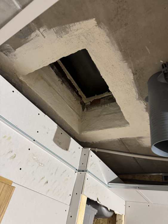

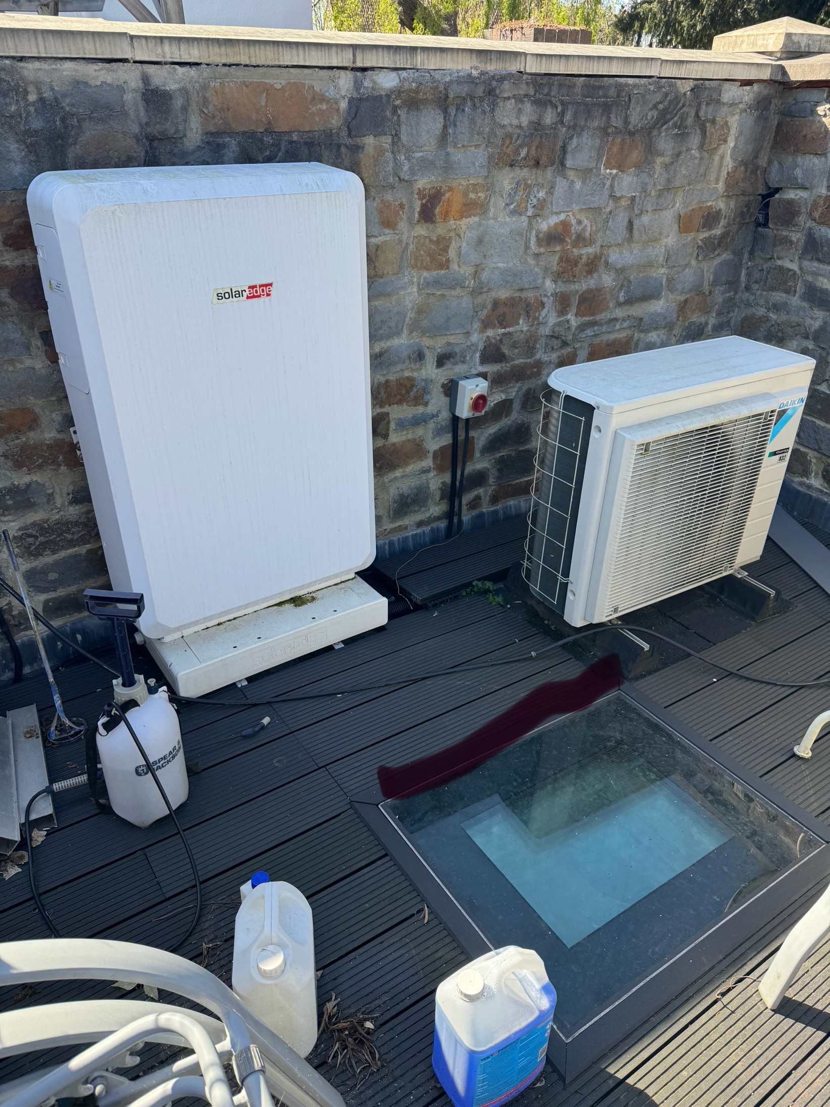

Pocster Posted April 1, 2025 Author Posted April 1, 2025 @crispy_wafer Works finished for the day as its 3pm So this is the glass unit above ground . Coloured line is leak side . The trench I’ve dug is otherside of the wall . That crap ground was coincidentally directly parallel to the window . Fingers crossed I guess !!

Pocster Posted April 1, 2025 Author Posted April 1, 2025 12 minutes ago, Eric said: Where does the ASHP drain go to 👀 Just onto the roof .

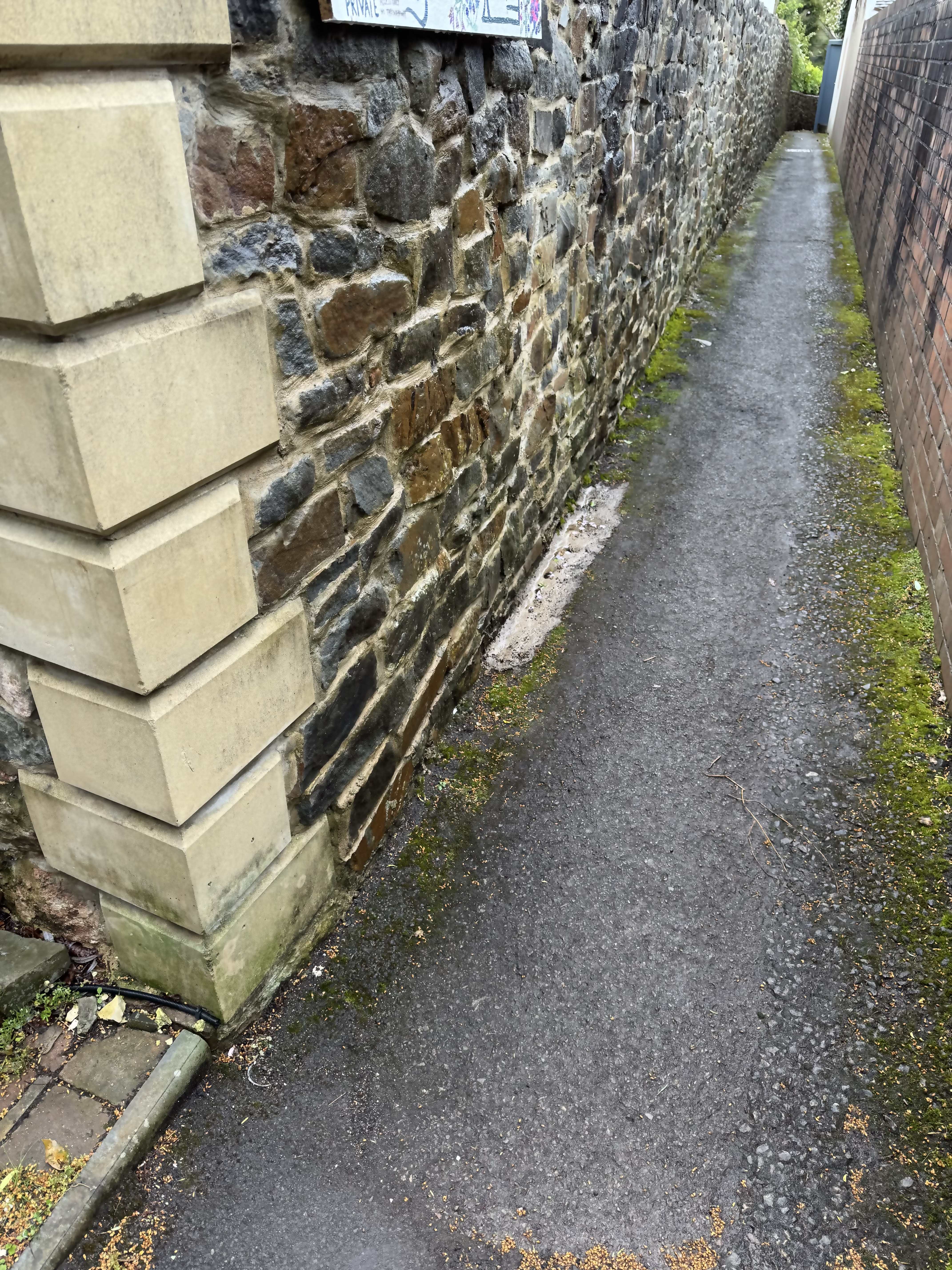

Pocster Posted April 16, 2025 Author Posted April 16, 2025 Had plenty of rain still leaks ! Could dig the trench the other side of my previous cementing I.e towards front of the lane . But not optimistic !

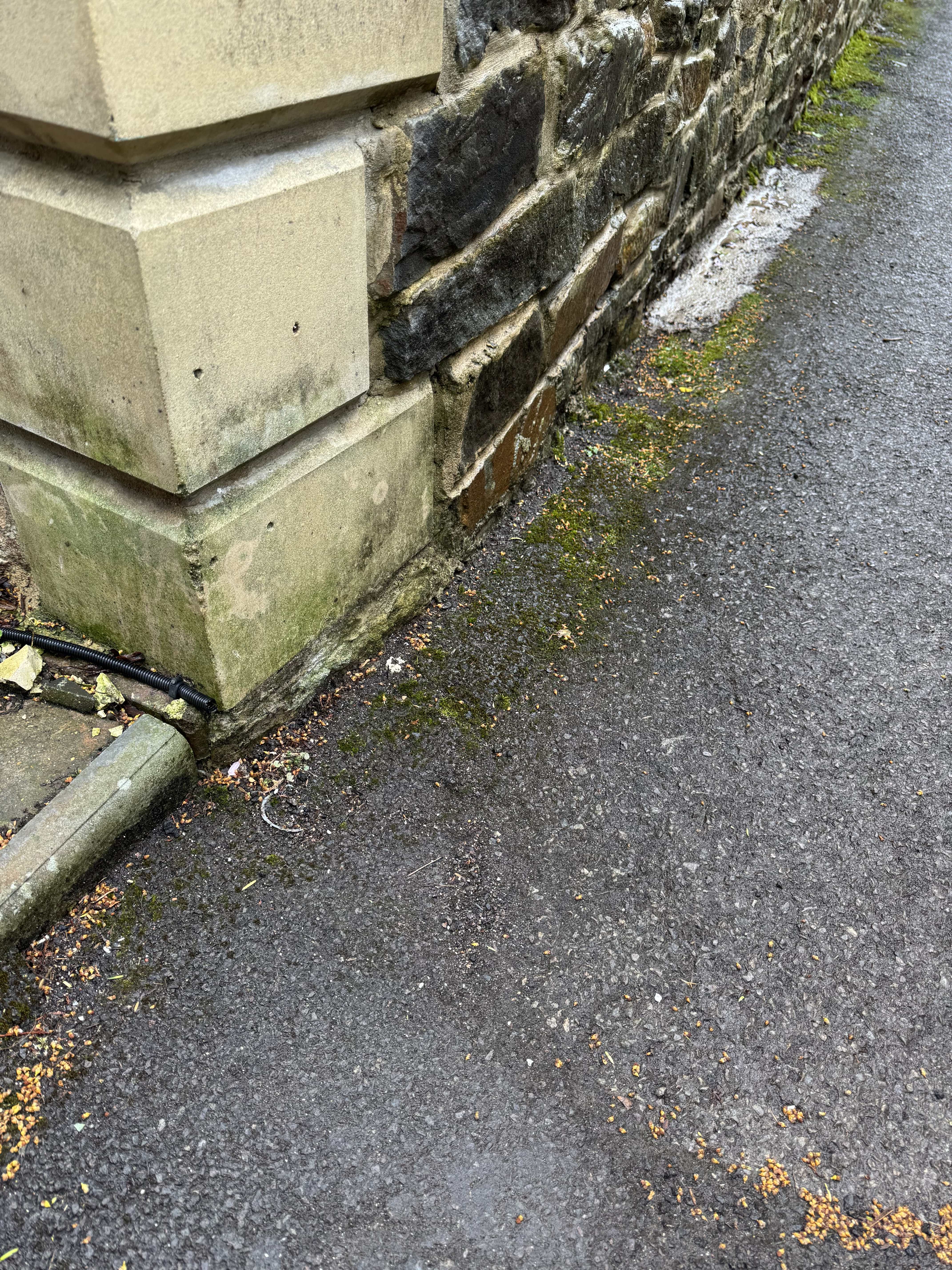

Pocster Posted April 16, 2025 Author Posted April 16, 2025 This track mark runs towards the front of the property I.e towards those quoins . Maybe it’s coming in from there rather than the side …??
Pocster Posted April 16, 2025 Author Posted April 16, 2025 My preferred ‘solution’ is not to bother chasing my arse to find how the water gets in but simply manage it - like the entire basement does anyway . My issue is how do I make a waterproof ‘box’ that goes into the walk on glazing upstands that directs water into the dimpled plastic membrane that is attached to the ceiling …
ProDave Posted April 16, 2025 Posted April 16, 2025 Your work in the lane, is really just trying to use the lane as a "roof" to keep ALL water off the actual slab below it to hide the leak. As @crispy_wafer says you need to excavate around the offending window and seal the joint between slab and upstand to death.
Pocster Posted April 16, 2025 Author Posted April 16, 2025 7 minutes ago, ProDave said: Your work in the lane, is really just trying to use the lane as a "roof" to keep ALL water off the actual slab below it to hide the leak. As @crispy_wafer says you need to excavate around the offending window and seal the joint between slab and upstand to death. Nope The rain has pushed across to the other window in a storm . So the water will run somewhere . Last thing I want to do is ‘block’ it from the inside because where will it run then ? That’s what worries me ….

Pocster Posted April 16, 2025 Author Posted April 16, 2025 I think when the weathers better I’m going to sand bag that lane entrance and hose the floor there . So the water runs down the lane . The lane is simply my likely suspect . Then if no leak ( !!! ) try and isolate the corner wall and quoins and hose there . Be nice to artificially reproduce the leak
