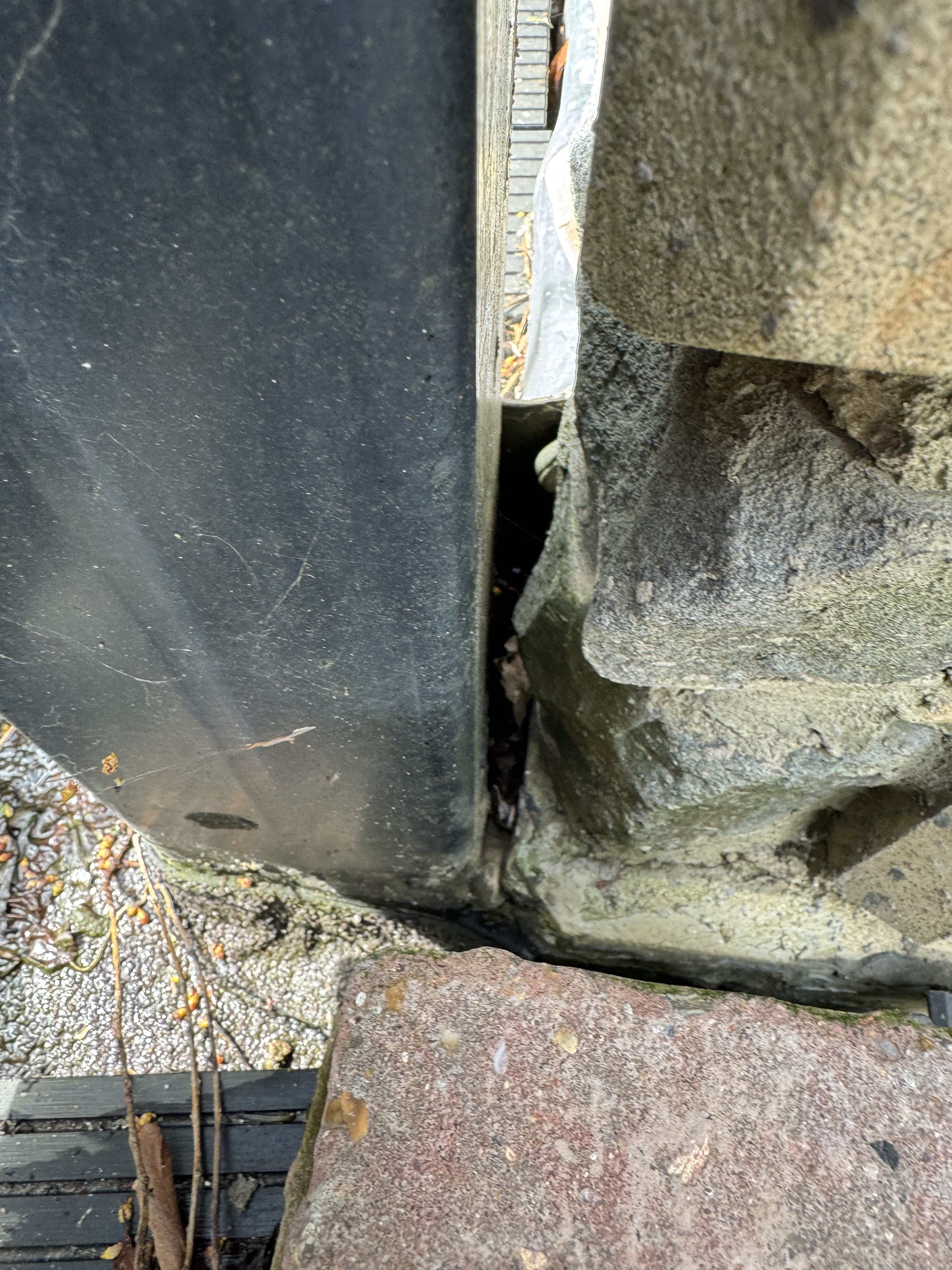

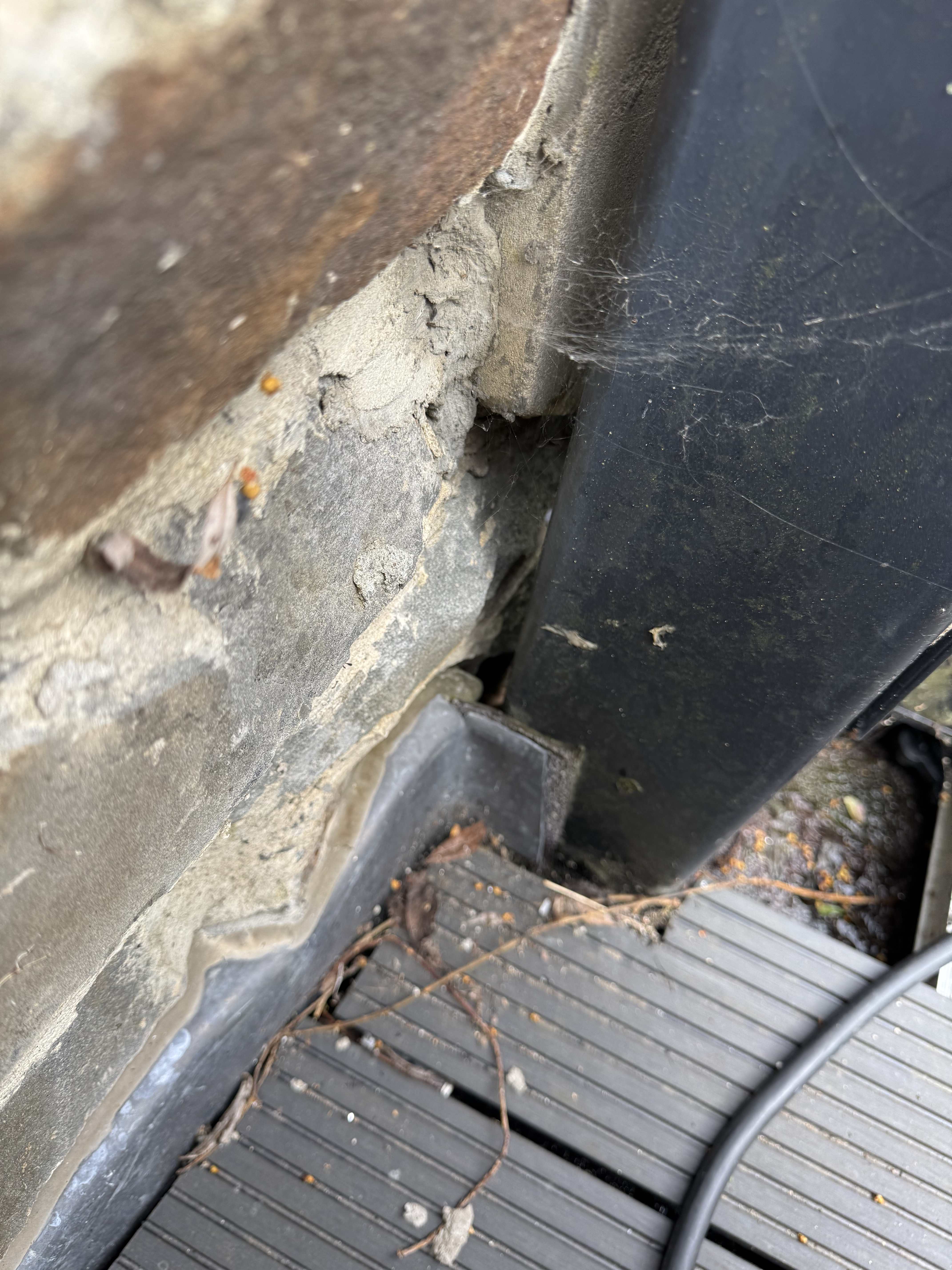

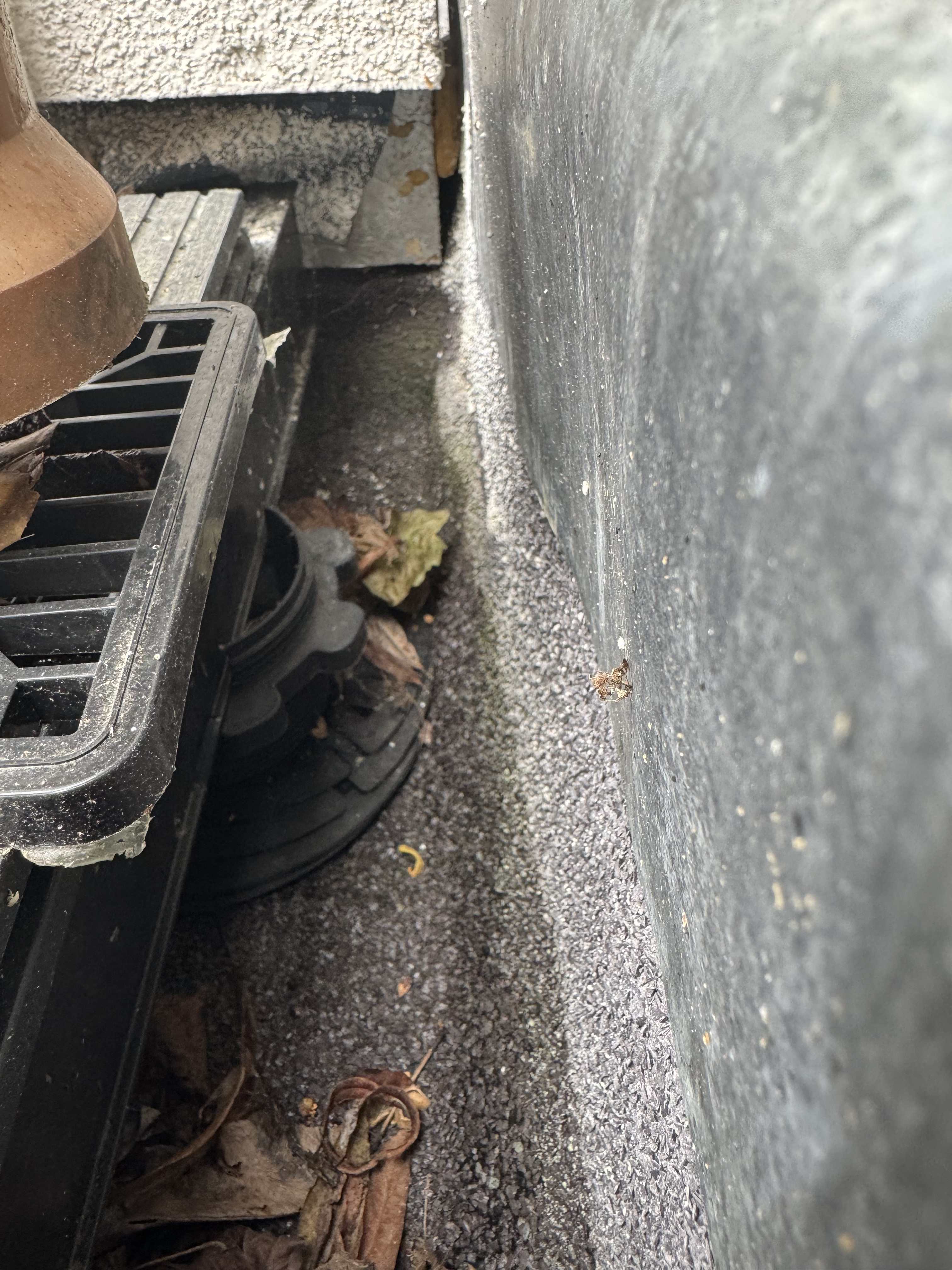

So as it’s now stopped raining decided to move crap out the way outside and look for anything obvious . Did find this gap behind the gate post . You can see the water proof roof ends at the post .
Need the leak to dry out and then I’ll tip a water can of water in that gap ….
Ordered a cheap iPhone endoscope ( yes @Onoff broke the old one from over use ) . Be interesting too see exactly where this gap leads anyway .
I vaguely recall this gate post was very tight to the build I.e I had to dig out some of the external insulation to the below ground section to get it in …
Photo from the otherside
Another ‘ possibility’ 🫤

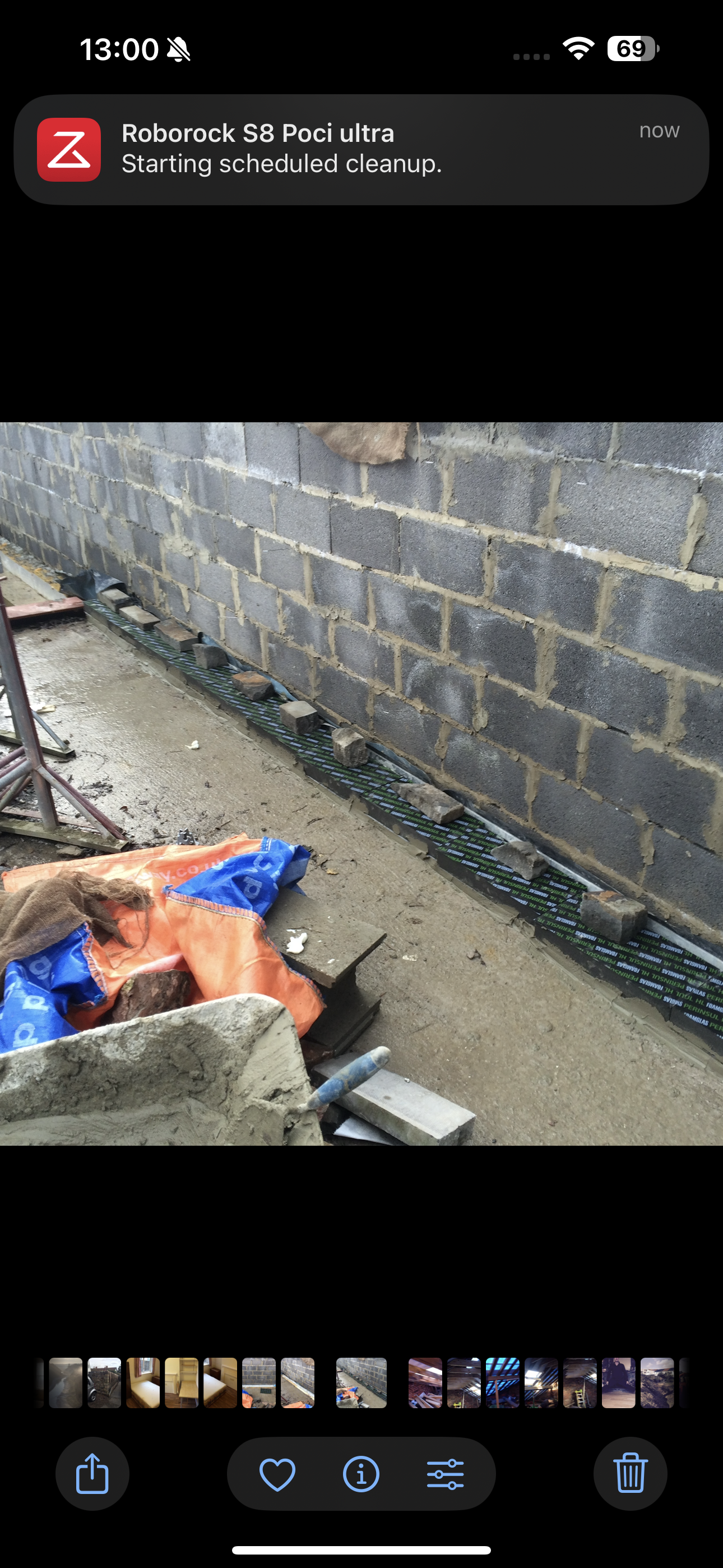

So I decided to trawl back through years of photos looking for that wall edge construction .
i remember now there was an issue where the stone wall on the inside at this point would sit on the external insulation .
So the SE designed a metal bracket to hold the stone but I had to put special I.e expensive thermal bricks ontop .As this part is different just wondering if the issue is there …
Edited by Pocster
Water round the gate post to start with. We await with baited breath
lol !
it hasn’t rained since early morning .
So I could see it leaking through this morning as expected .
Waited until about an hour ago . Though not dry in the upstand the drips were less . So I tipped some water behind the post ….
It’s dripping now . But that’s not a conclusive test of course !
I really need some sun and zero rain and then the inner upstand is bone dry .
Test again then …
Weather this week looks pants - so will have to wait .

Hasn’t rained for a day now .
So went out and tipped a watering can of water into that gap 30 mins ago .
Nothing on the inside …. Just want too see 1 drop - but nothing . I guess it might take time to soak through the blockwork , here’s hoping .
Got my endoscope .
Been sticking it in every hole I can find .
No joy ( well joy , but not found the source of the leak )

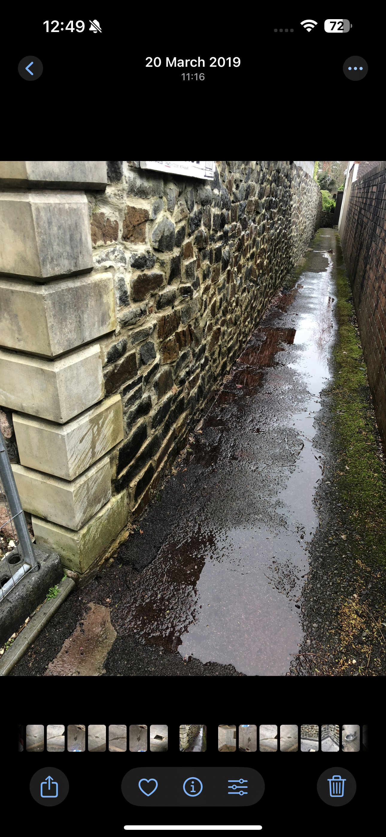

Yeah I tried that before .
I put a load of red down the lane - none came through . My assumption was maybe it wasn’t enough constant water I.e rain .
I really just want to put water somewhere ( on a bone dry day ) and make it come through .
It never leaks under light rain only heavy .

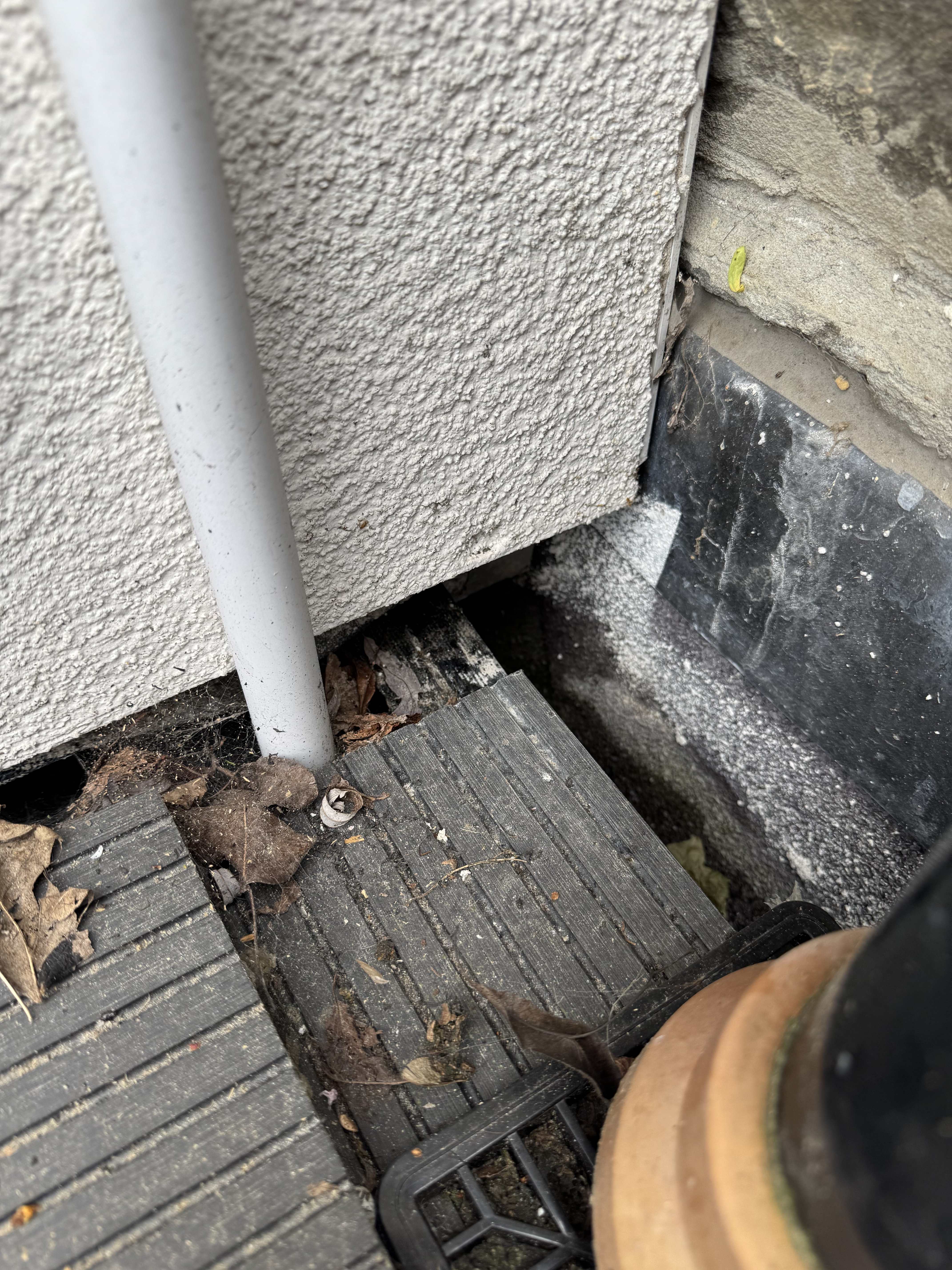

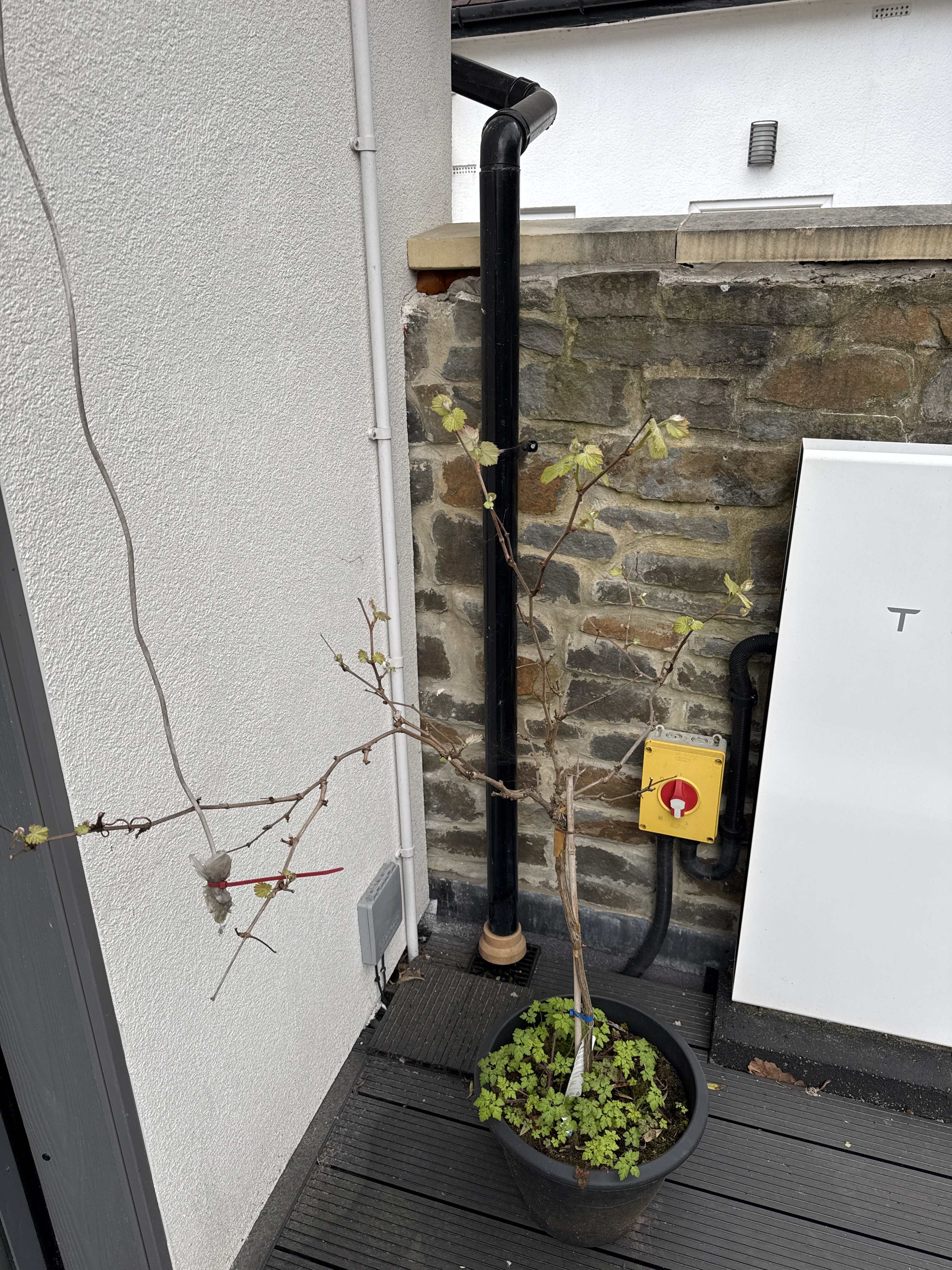

My next suspect is this down pipe - but to run all that way ( past other walk on glazing unit ) and come out at the front one seems highly unlikely .
But I’ll stick a 90 on it ; a 3 metre pipe and direct the run off away from the corner .
Perhaps when it rains heavy it pisses down the pipe and splashes up ‘n under the roof …. I.e under the white render
Running out of ‘possibilities’ … 🫤

Here’s the red I did down the lane years ago .
Looks like I murdered someone - but it isn’t a conclusive test anyway
Drizzling all day - no leak .
I’ve noticed this before - needs to be substantial rain to cause leak . Kind of suggests not the lane .
I did find this corner where roof flashing meets build . With the down gutter nearby perhaps it runs back over the roof with heavy rain …?
