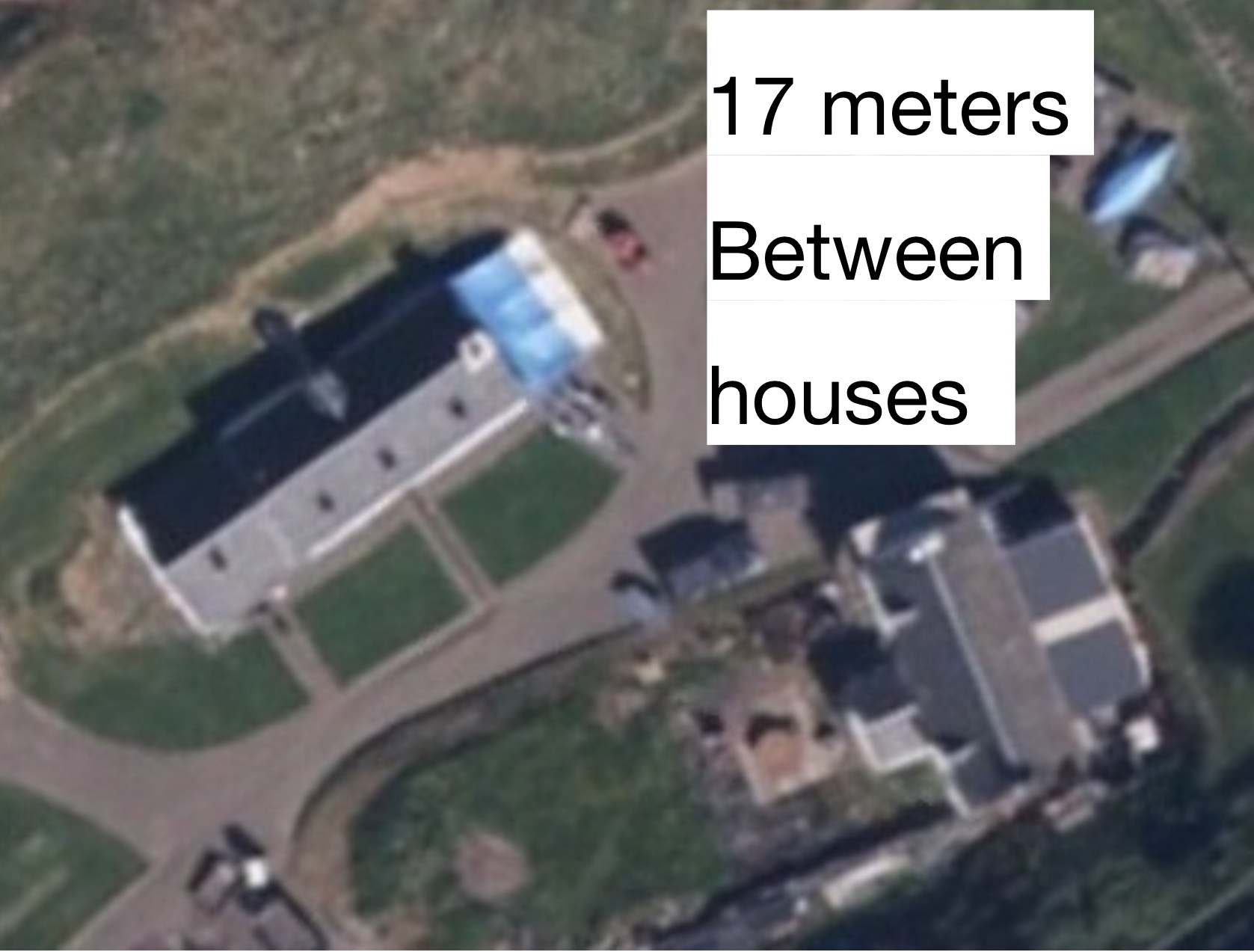

Ok as i said i am totally committed and ready to listen carfully.  Space wise there is all the area under the stairs and the abillity to plum anywhere round the inside  perimeter of the building both upstairs and downstairs. The only available space upstairs is on the landing / hallway by the upstairs back fire exit where i intended to put a laundry cupboard. There is a small false roof at the very top of the roof to hide future mvhr pipework.
The realisation of the possibility that i can use the heat  pump for both upstairs and down will provide me with the determination to adress the cold feature walls, ie. just get on and insulate them... but thats another story.
Cottage on the left of the photo and main house on the right
Ok, happy days. If I seem ? mph it's because I am ;).
Good that you can fit large radiators in, as that'll work well with the ASHP. The bigger the better and that'll allow the flow temp for heating to stay low.
Good that the stove air supply comes from outside, just make sure the stove is airtight as possible / good door seal etc.
The reason I asked about how long your keeping it / how close is it was that I was going to suggest a single communal system which would reside at the main dwelling and feed the cottage via an umbilical supply trench. That's out the window as your too far away.

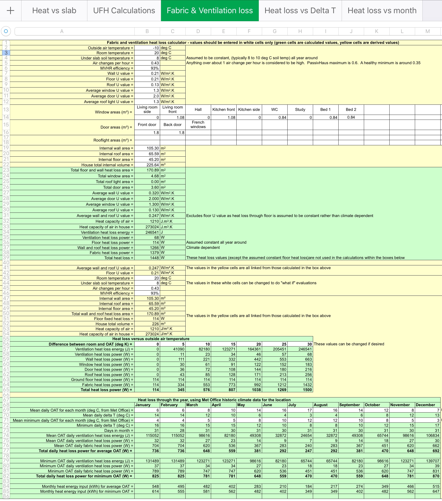

1. The pitched roof in the rooms in roof are at 0.15 W/m²K (this is just from a calotex calculator)
2. There is considerable scope to improve the doors......  velux windows upstairs and doule glazed hardwood sash downstairs.
3. The upstairs walls are 0.21 W/m²K (calotex calculator) ground floor 0.21 W/m²K
The area i need to address is the stone walls downstairs, stripped back, repointed and painted white to brighten the place up, its been fine as a summer house but for us to live in it over winter and to get the most out of the heat pump i will need to re do the studwork and insulate with rigid insulation rather than the origanal bit of rock wool stuffed in hear and there.
Mr Smarts has put together a heat loss spreadsheet but i was wondering if  @JSHarris or @PeterW or anyone on here had one that was better as a template before i venture out information that may be better presented.  As always thanks.
@JSHarris has a really good one on his blog. I’ve got a simplified version but I’ve got to say the one Jeremy has is better and more accurate.
Your options on walls are varied but I would really look at that floor and try and get some insulation plus UFH into it as it will work much better with the ASHP.
 'Tis here: http://www.mayfly.eu/wp-content/uploads/2017/01/Fabric-and-ventilation-heat-loss-calculator-Master.xls
Lots of people here have used it.
Great i will get in about it. Thanks
My aim is to try and gather the information required to identify the heating requirments for my cottage, this is my first attemp to fill in the spread sheet, i will go back over it and double check  all the numbers but i am hoping that people familiar with this set up would be able to comment on potential mistakes i have made and other more wide ranging observations. Most of the U values are taken from the calotex online calculator, they do not take into account and internal coverings such as osb, plasterboard or wood panelling. My next step will be to gather all the information on individual room sizes, only 5 including the upstairs landing / hall. Equiped with heating requiremnts and room sizes i hope to be able to then learn how the heating system may be developed.

Ok edit.... i have no idea how to get the spread sheet from my ipad to here without a screen shot, i am a dinosaur with computers..... help.
