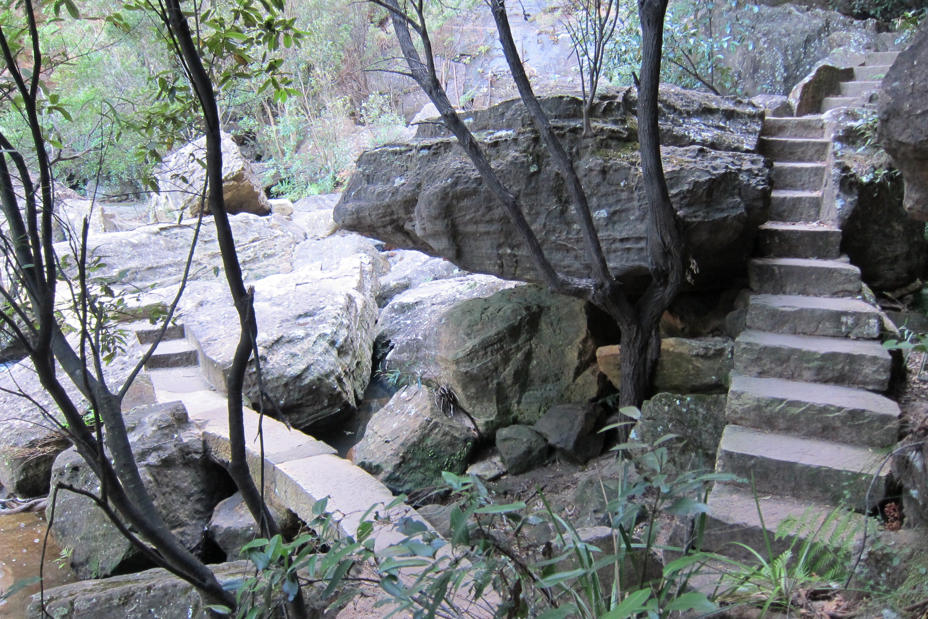

@PeterW i geuss i am always over engineering things...... comes from spending a lifetime  building stuff that has a life expectancy of hundreds of years..... photo example. Unless its “bomb proof” i start to worry...... just got to get over it as best as i can. My idea with the 6mm ply was to try and get a slightly more robust feel to the floating floor. Whats your opinion..... i can take it.
