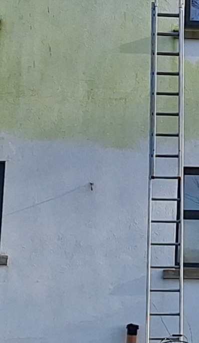

cwr Posted January 22 Posted January 22 Hi folks Any recommendations for something to spray on render to get rid of green algae? It's a white thin coat Weber render. Plenty of trees near by so guess I'll be doing this every couple of years... Thanks
ProDave Posted January 22 Posted January 22 I spray with diluted bleach from a spray bottle. Best done when you are expecting rain shortly afterwards to wash it off. 1
saveasteading Posted January 22 Posted January 22 4 minutes ago, ProDave said: from a spray bottle Or a garden weedkiller in a garden spray, as they can usually scoosh further. . Do NOT use a pressure washer or you could lose the render.
nod Posted January 22 Posted January 22 pick a dry day Dilute 3-1 Spray on Pump sprayer or what ever you have Let the rain do the rest 1
cwr Posted January 23 Author Posted January 23 Thanks for the replies and suggestions. I had tried diluted bleach but it had no effect, it may have been too weak a mix though.
