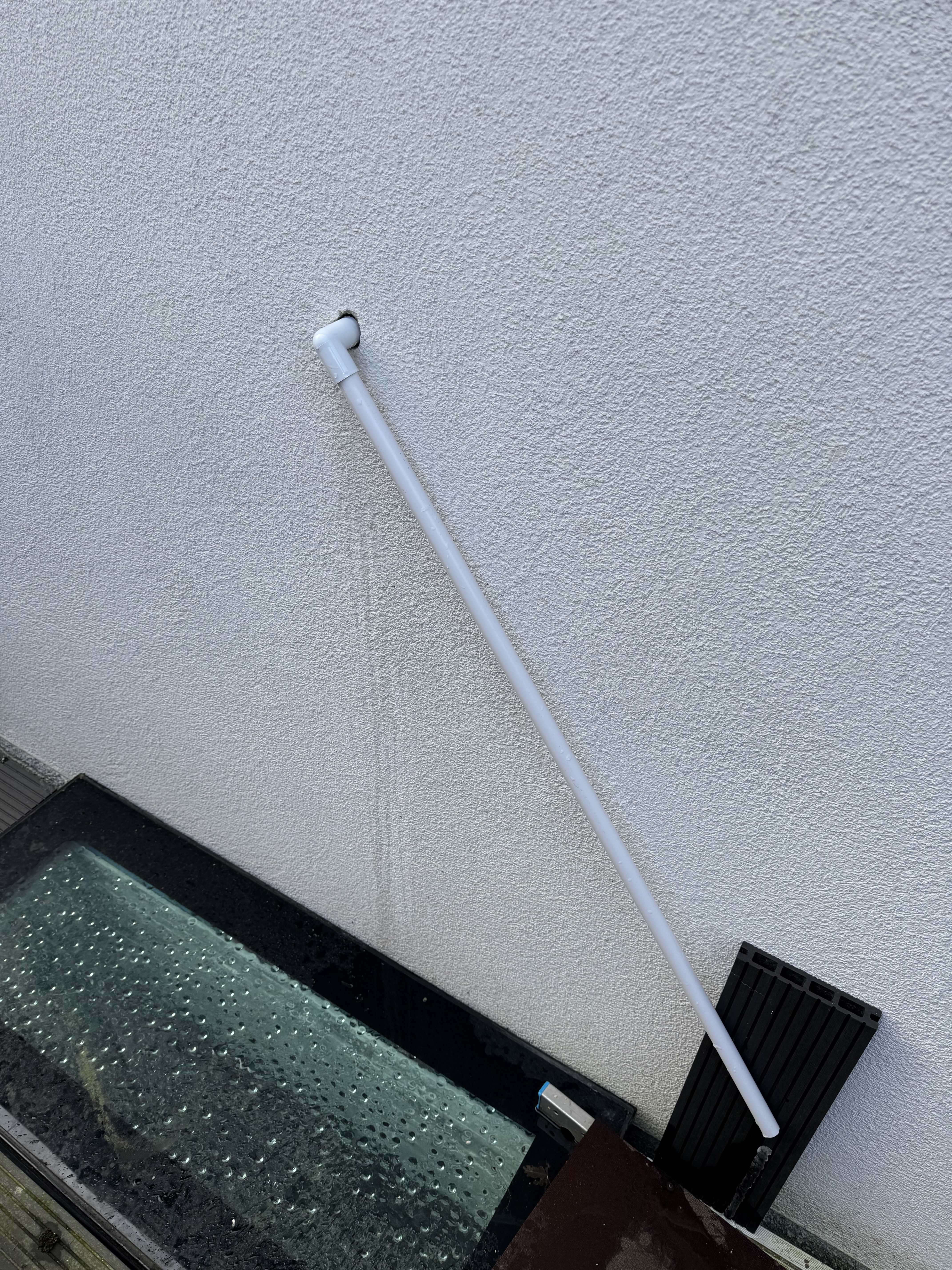

Pocster Posted 7 hours ago Share Posted 7 hours ago Solved one problem to create another 🙄 The overflow pipe runs from my mvhr condensation drain so is pretty busy . Didn’t really want the water just landing on the ground outside and freezing so added a 90 - which I think has now cracked due to freezing water . I could externally insulate pipe but then I’d need to box it in . Maybe the pipe just comes out the wall and an air break / tundish ( technical words ! ) before going into a down pipe ( angled like this but no 90 ) . Any better solutions ? Link to comment Share on other sites More sharing options...
Onoff Posted 7 hours ago Share Posted 7 hours ago Seal up that hole around the pipe for a start where it goes through the wall. Then insulate: Â Â Link to comment Share on other sites More sharing options...

Pocster Posted 6 hours ago Author Share Posted 6 hours ago 20 minutes ago, Onoff said: Seal up that hole around the pipe for a start where it goes through the wall. Then insulate:   Yeah but it looks mung . What insulation is that ? - maybe a white version … Link to comment Share on other sites More sharing options...

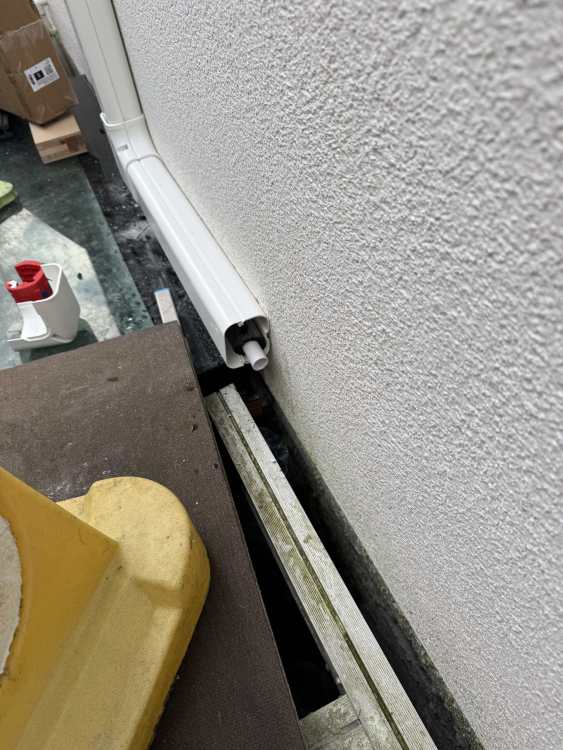

Bramco Posted 2 hours ago Share Posted 2 hours ago 1 hour ago, Pocster said: then larger white pipe over the lot Why not use white square section downpipe with the pipe inside and some lagging shoved in.  1 Link to comment Share on other sites More sharing options...
Pocster Posted 2 hours ago Author Share Posted 2 hours ago 3 minutes ago, Bramco said: Why not use white square section downpipe with the pipe inside and some lagging shoved in.  Yeah - worth a look Link to comment Share on other sites More sharing options...
