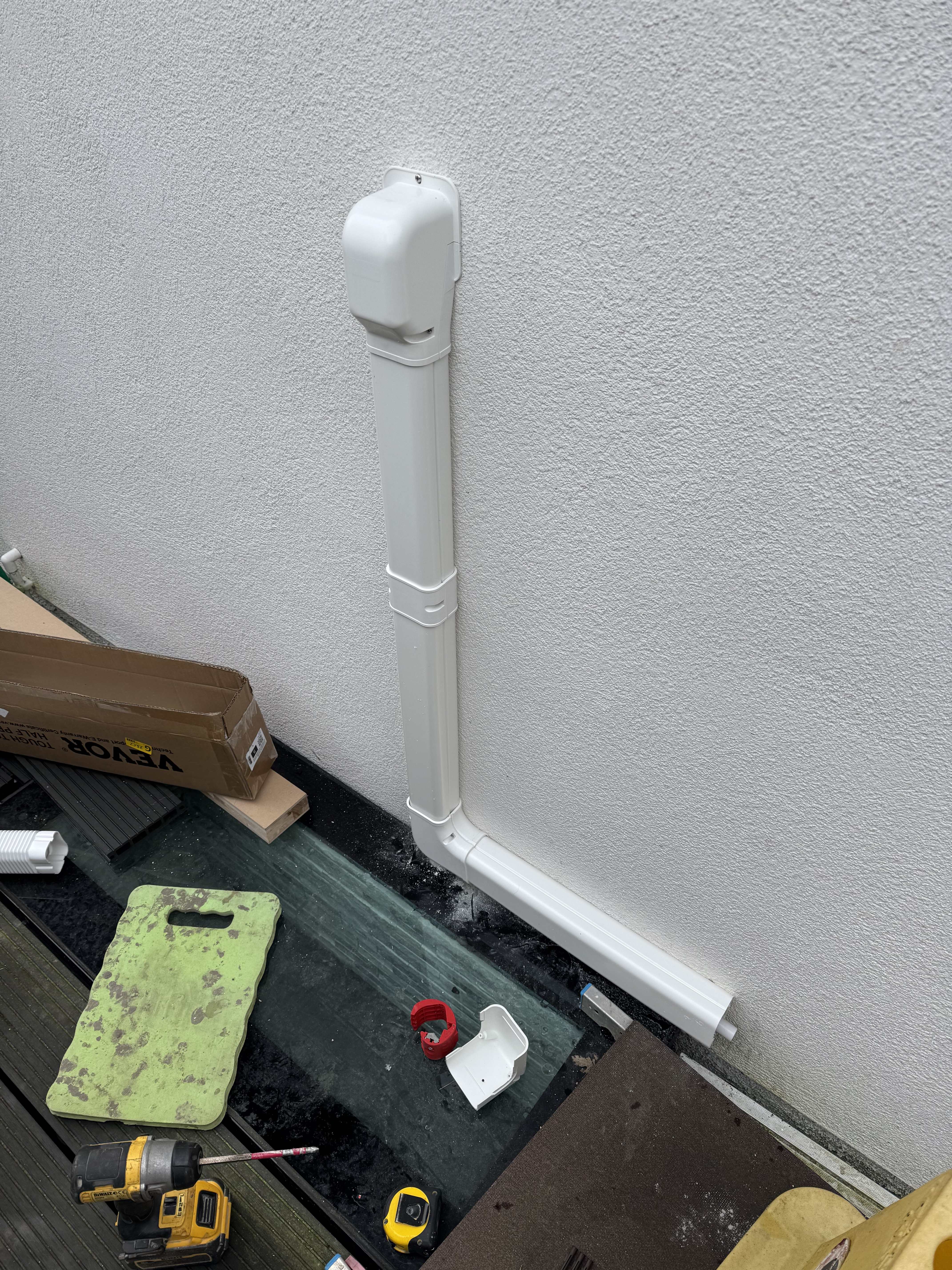

This outlet design will cause probs, IMO.  The horizontal run will cause standing water which will start to freeze from the drip, building up and then block.  Perhaps a case of aesthetics over fitness.  🫢
Posted
Well my friend ! You can just see it in one of the earlier photos that the trunking is straight vertically and horizontally but the actual overflow pipe is slightly on an angle vertically ; meaning that final horizontal part of the pipe has a fall ….

These sorts of trickle overflow are often turned down into a small stone chip or fine gravel soak-away at ground level, maybe the size of a plant-pot or bucket.  The pipe should be insulated to ground-level.  I am not sure where you live in the UK, but the ground very rarely freeze much more than the top few cm where I live in Northants even in the worst cold snaps, so this approach takes the water away without leaving puddling with can freeze and cause a slip hazard.

Not a problem for me . The pipe there is over half a meter above ‘my’ ground . As an underground dwelling there’s a massive void down the entire side of the building . So drainage a non issue .
TBH I like it visible . I did consider taking it further vertically . This way I can see water coming out or potentially freezing .

Neat job but I agree with Terry. That’s still going to freeze. You would have had to cut it slightly short of the trunking and insulate it to the end of the pipe or, as suggested, continue it into the ground and insulate to ground level. My water pipe comes out of my borehole in free air then down into the ground. I intended backfilling the area around it with earth which would have covered the pipe and stop it from freezing. However to do that required some landscaping so I never got around to it last year. Instead I insulated the pipe as best I could with a very slight bit of pipe left exposed. This  worked until we had several days of -5°C and it eventually froze. This year I backfilled with earth as originally planned and it’s been fine so far. I’ve also fitted a heated cable down the ducting which I’ve not had to use yet.

Are you suggesting just cutting the small non insulated end of the white pipe off ? I.e easiest option ?

 This a good idea if you want to guarantee that it doesn't freeze.  if you lag down to G/L and use a small soak-away as @Kelvin and I suggest then you probably would only need to turn it on for the few days over winter when there is a sustained hard frost.  We don't have this prob since we vent ours internally into the foulwater stack system using a McAlpine In-Line Vertical NRV (these are designed to allow these and similar overflows to  be fed back into the FW system).

I did think of a pipe heater but thought it was overkill for ( as you say ) maybe a few times a year . I’ll just pour hot water over the casing if I need too - possibly next winter 😊

Yes but leave it for now and see if it does indeed freeze just keep a beady eye on it.

Just don't forget to check if you do have a long cold snap as letting this freeze and backup will be a total PITA.

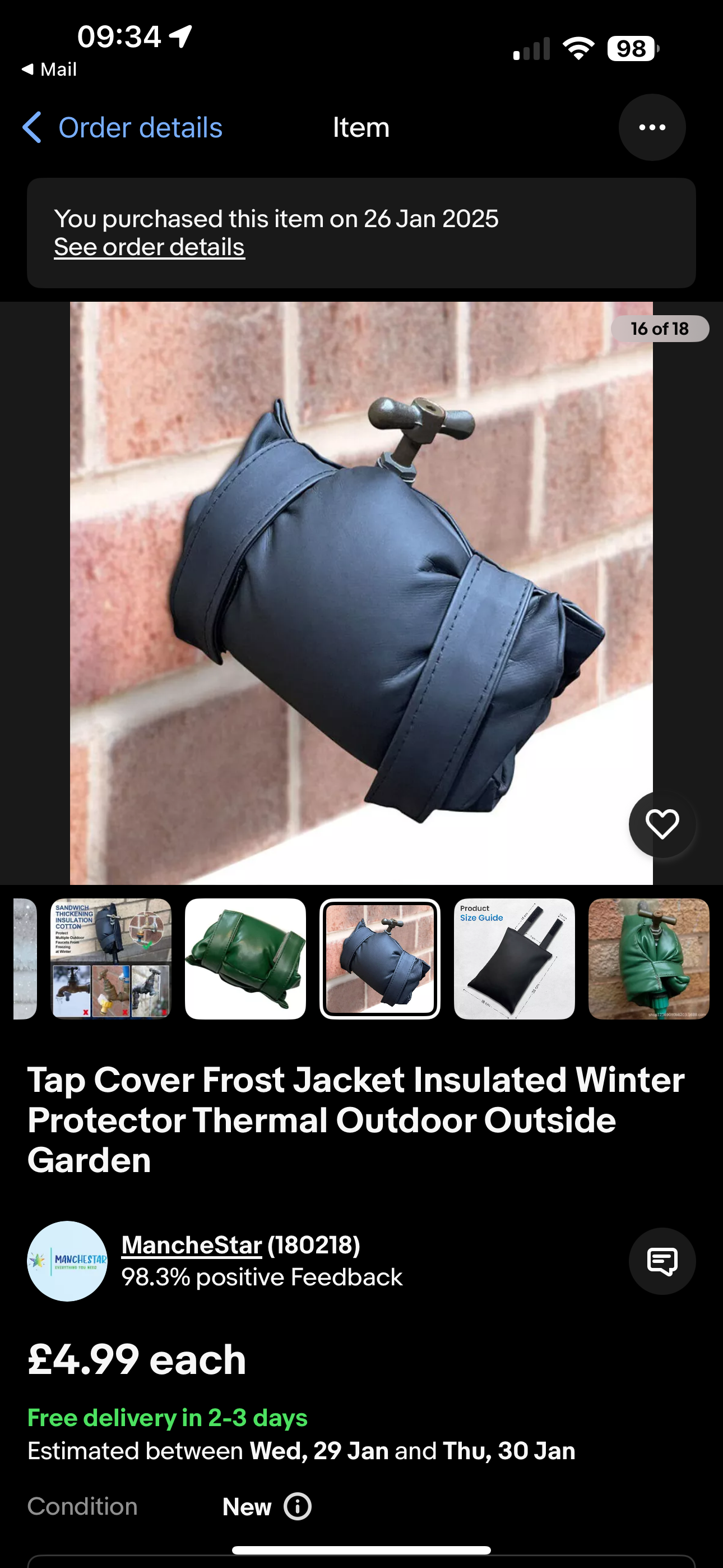

Even though my outside tap riser is pretty-well lagged, this thread has reminded me that I should a nice very lagged booty covering the tap itself.  Thanks @Pocster

I have an outdoor tap also so should do the same !

Only if you use it over the winter. I don’t tend to use the outside tap much through the winter so shut it off and drain the water out of it.

Yeah ; it gets used rarely in winter . But I ordered anyway ( peace of mind )
Then it’s also another “ job “ to fix it ( 10 second jobs can turn into half a day for sure ! )
