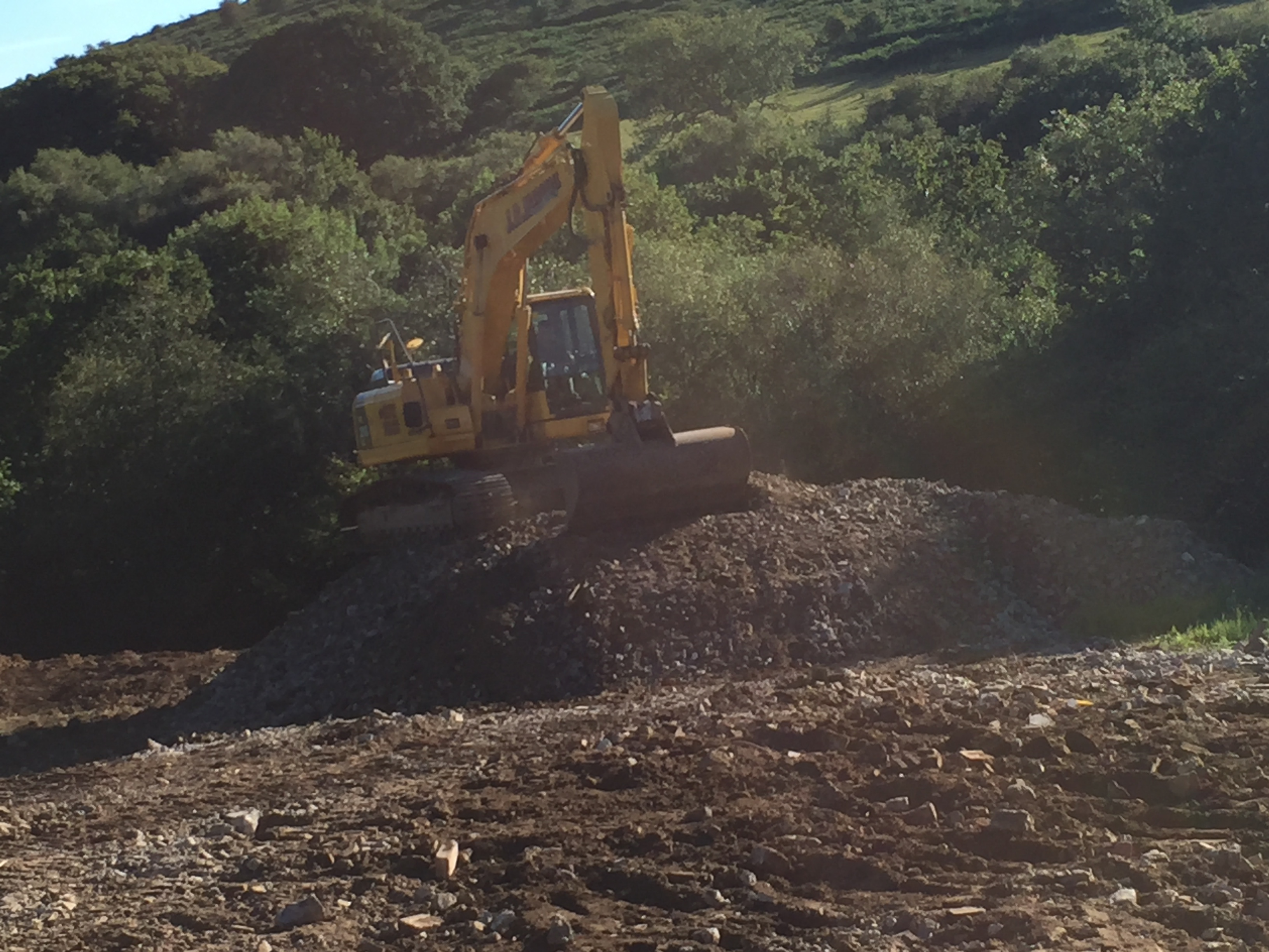

Barney12 Posted November 26, 2017 Share Posted November 26, 2017 (edited) We crushed the old house. (3 bed detached Brick and block). I used my ground works guy (effectively a man and digger!!) and hired in a crusher. We had to use a small unit due to access issues. Ours coped fine with soil, no issues at all but it was dry and stoned, I would imagine clays would be another story. Crusher cost me £1,200 for the week. I never worked out exactly how many tonnes we had but it was ALOT! Total cost of demolition and crushing was £5k. Just to reiterate what @dogman said. They are bloody noisy! Heres a picture of a 20t digger sat on our hardcore pile. Edited November 26, 2017 by Barney12 Link to comment Share on other sites More sharing options...
