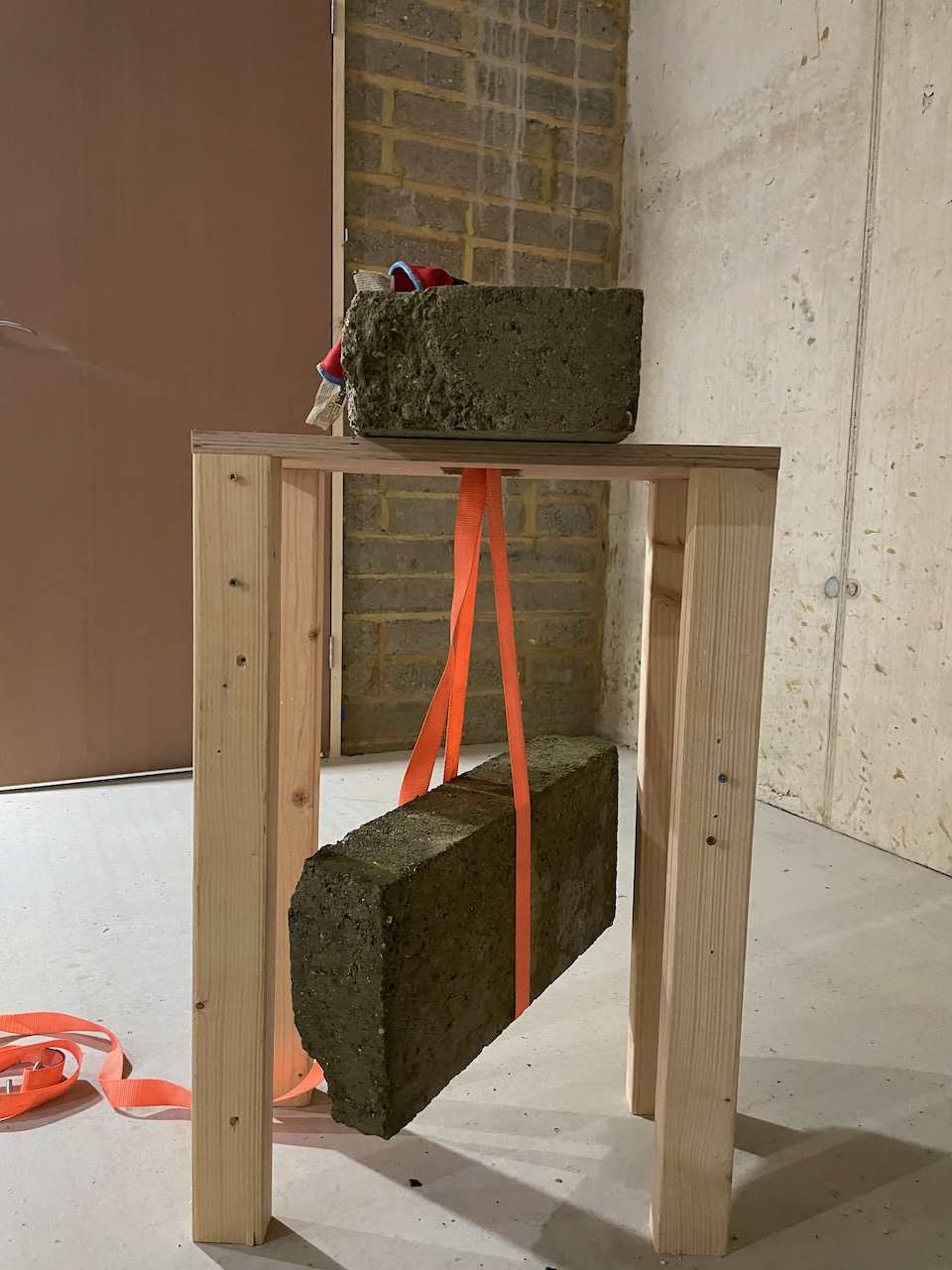

so experiment number 1 is a success as far as i can tell. it's not budged a mm and has been hanging with that weight for 72hrs. so i think i will be fine using the 5mm SDS bit.

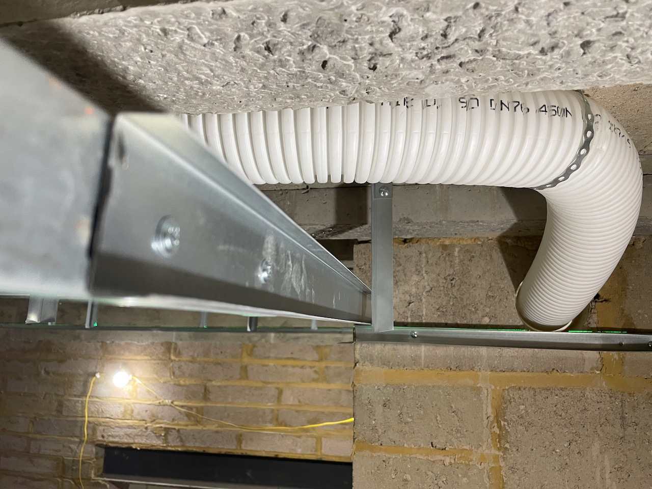

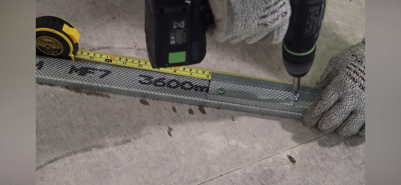

@nod looking for a bit of advice please. when extending the MF7 primary channel on the MF ceiling BG says to do it like this.
so the pieces are back to back. but this causes an issue for me as I've already attached the hangers to the ceiling in a nice straight line and so the hanger is now on the wrong side to attach to the MF7! e.g.
do you move the hanger so it's on the other side (a pain as I've already hung them) or can I put 2 pieces of MF7 the same way around butted up to each other and use another piece of MF7 on the other side to joint the two pieces together? obviously adhering to the 150mm overlap so the joining piece is 300mm long. hope that makes sense!

Just an observation to the  picture The joint is wrong The pieces should butt together Both facing the same way with a 300 piec clipped over with eight pan heads holding it in place
The hanger can be fixed directly to the joint 3.6
